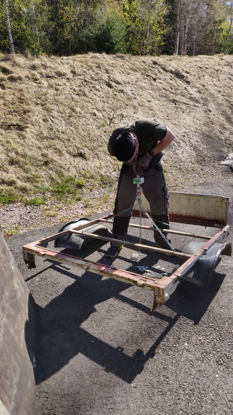

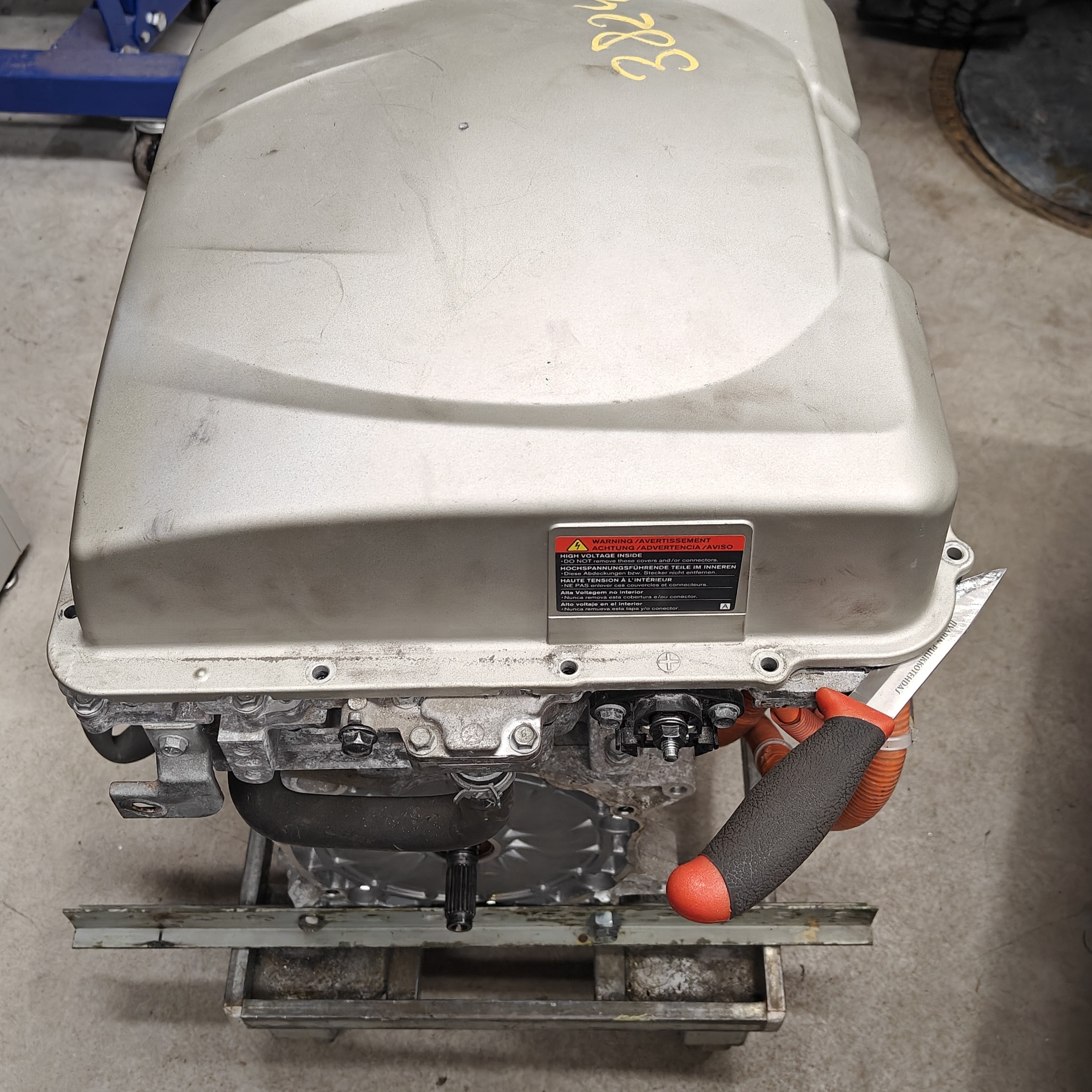

Some goodies came in yesterday!
Got the motor stack and battery in the shop now. Looks like I got most of what I is needed. The heater? cable/connector seems to be the only thing missing. Anyone have a part number for this cable so I can find this easier online?

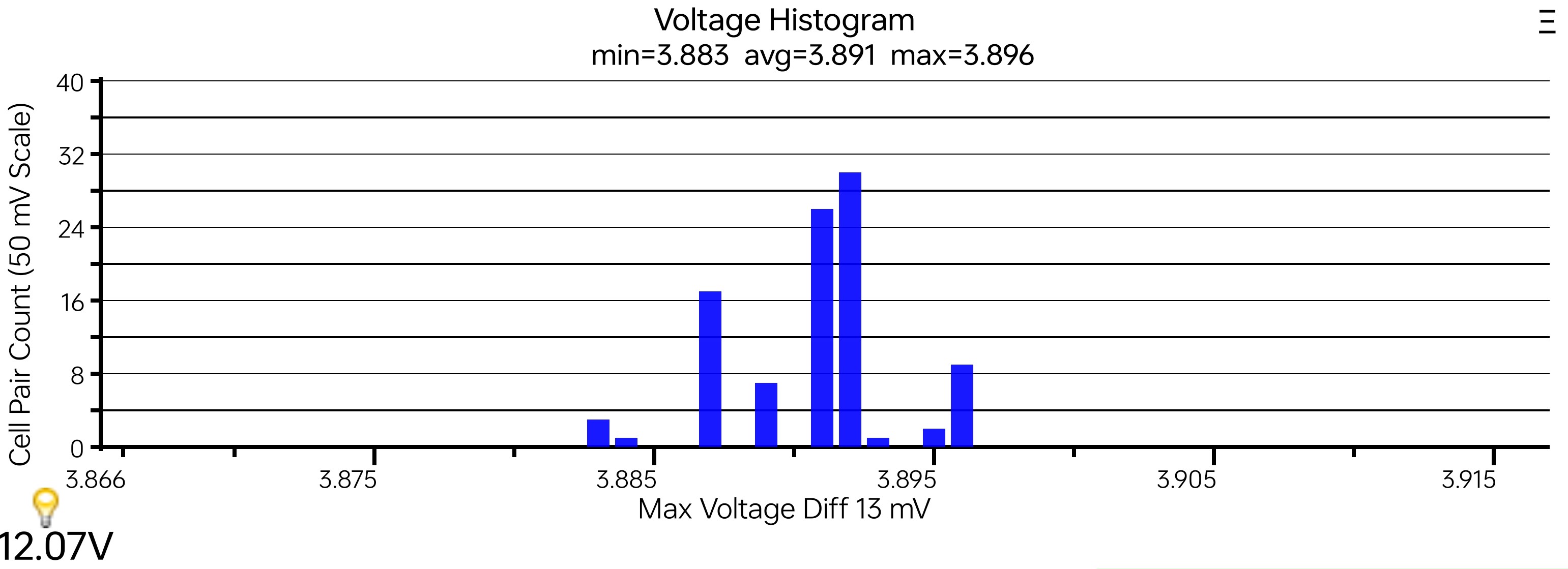

I used the good info by Dala to make a rats nest of a battery sniffer to see how the 30kWh battery is doing. Well, as the Norwegian wreckers pre -dismantle pics showed 11/12 battery soh bars, I was expecting around 80% condition when purchasing this.
I still don't hve a deep enough understanding of the battery side to interpret whether this is in good condition or not, but maybe the community can shine some light on how to make sense of the Leaf Spy data
The leaf SM on battery says on the battery part that a maximum cell voltage ±33mV. I suppose that this 13mV seen in the LeafSpy schreenshots means that battery is good. Looks like I didn't win in the PDM bingo and got a 3,6kW charger. Well, shouldn't be a too big of a bummer as this is a single phase charger and I'll be charging this with a 10A schuko plug charger anyways for most of the time. I cracked open the PDM to remove the AC comp cable. A nice tool to use in the opening is a cheap knife Later I read from the Leaf SM that you shouldn't use a metal tool to scrape the sealant as it can (will) cause shavings that can enter the PDM AC compressor cable attaches to the battery input bus bars and there is a 30A fuse (400V), I wonder if there is anything limiting the max current which can be drawn here? See thoughts for phase 3 of this project I extracted the Leaf reduction gear input shaft as it is useless for me in any other purpose than adapter building. I had a Suzuki transmission main shaft with the splined output that was the first thing I thought of for the other part of the adapter build. The other day I remembered that I have laying somewhere in the parts bin this TC input gear that needs a dentist. This should be a more suitable blank to work on as it has the splined driveshaft flange end

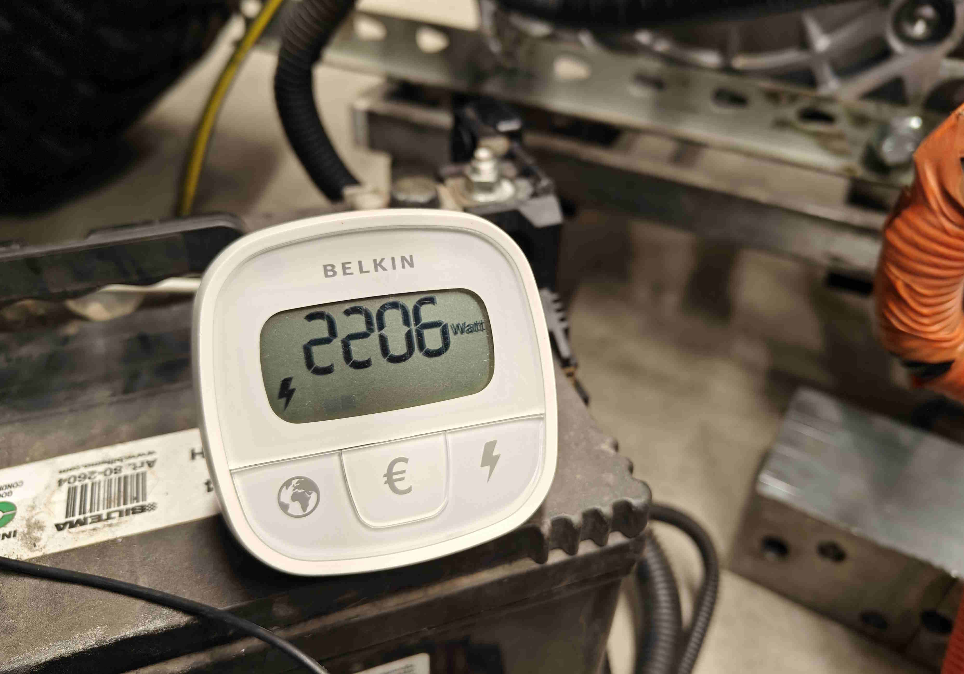

The other day I got things connected to the extent that I plugged the HV battery to see if the inverter would see the voltage rise during precharge (I did study the Leaf SM and to me it looks like the inverter voltage measurement is used during precharge to determine when to close main contactor.
Inverter voltage goes up during precharge, so next I'll attempt some copy-paste-coding and see if I can get the Leaf BMS talking with zombie

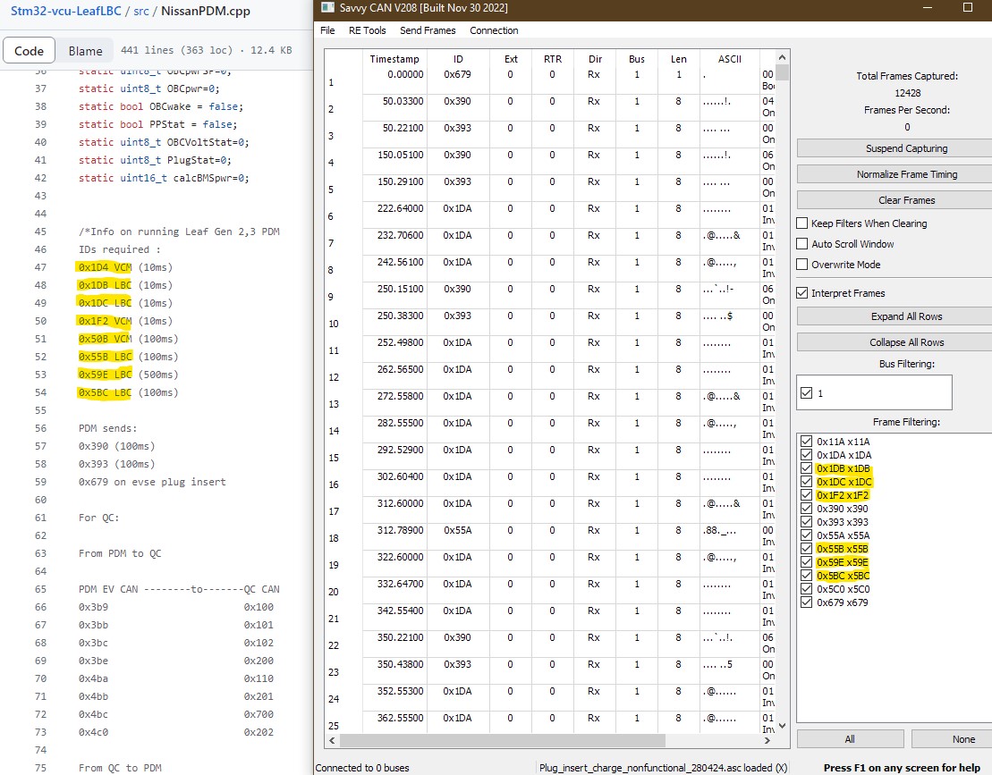

Re: [WIP] Project Rising Sun: Suzuki SJ410k meets Leaf full stack
An update in place: I'm in Github now
https://github.com/Romukeisari/Stm32-vcu-LeafLBC
This hackery is not working properly at the moment.
Contactors close and motor runs but EVSE is not charging.
Leaf LBC for current info and Leaf inverter voltage used for precharge info.
Is my train of thought correct if I mute the LBC simulating CAN messages Zombie sends to CAN if I have the actua LBC in same CAN as PDM and Inverter?

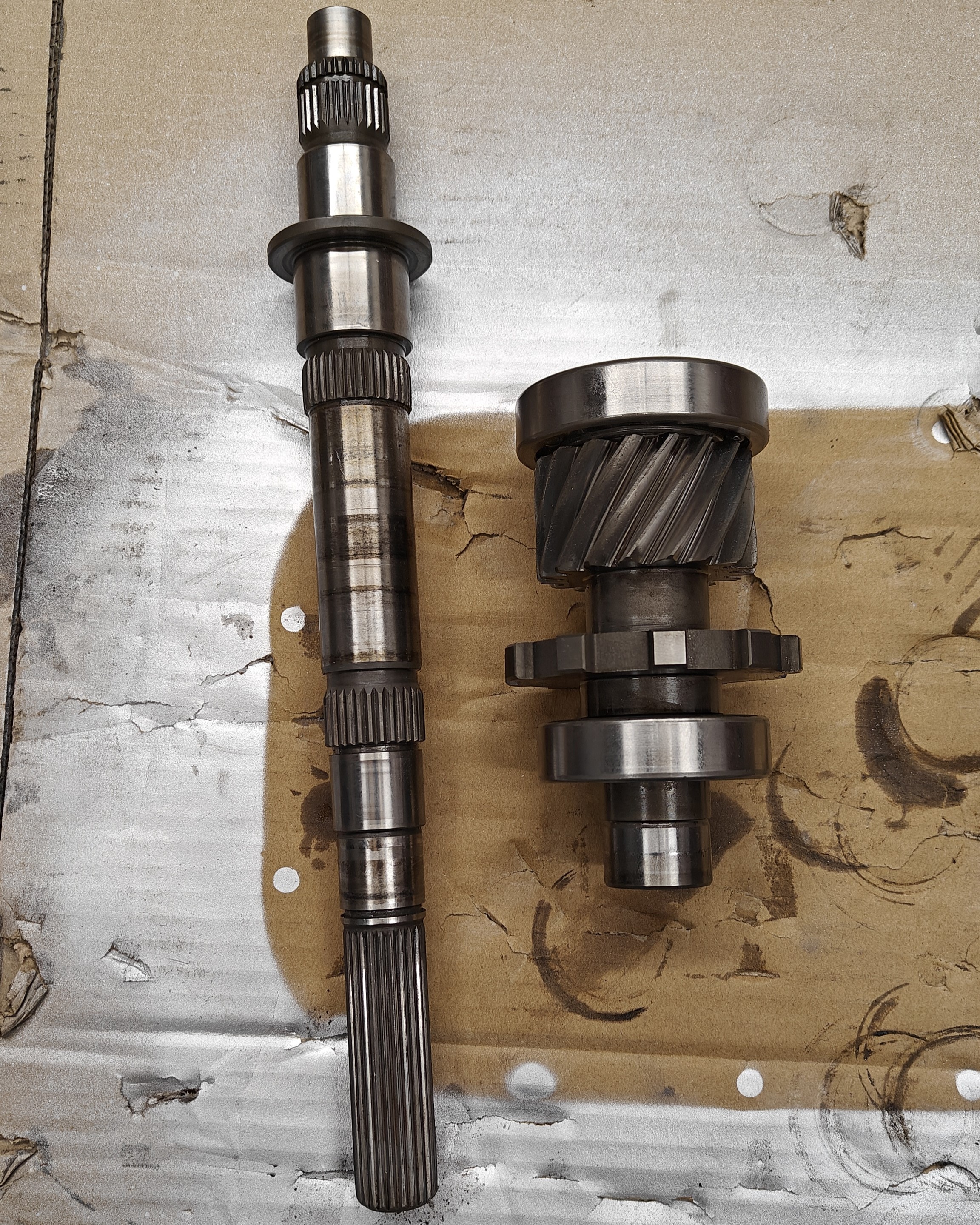

I've started to gather materials for motor/driveshaft adapter. Will use a 15mm aluminum plate as base and make a bearing mount in the middle.
Headbanging continues

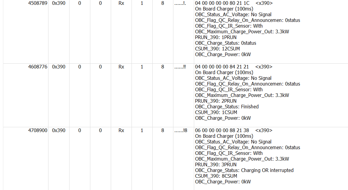

NEW ability unlocked, now I can CANtrace and decode with savvyCAN, this is really cool I use the AZE0 DBC by Dala
IF I'm quick, I can get the charger to click but no current. I may have found out the reason for no current, but at the moment don't fully understand what is happening.
The way I read this is that when the OBC wakes up, it's happy to output 3.3kW
This status shift realated to OBC bootup?
Zombie sends a charge power command, before there is AC voltage signal. Is this sensitive to the sequence of events.
Then there is AC status voltage, but nothing changes afterwards
Here's a CANdump of what I'm looking into at the moment. Here I have both the spoofing messages Zombie sends and the actual LeafLBC messages, but to me it looks like the OBC doesn't get upset because of all those LBC messages flying around. Thoughts and input are more than welcome
IF there would be a kind someone with a Zombieverter with Leaf stack and slow charging works for comparison a CANdump could be useful (of the process of plugging in the charger to a system which is OFF until the EVSE clicks and current flows)
I have no experience with leaf PDM etc, but your code on github does not look up to date as it does not compile and has other errors.
From you CAN log the zombieverter is still sending data on 3 ids which may be causing the problems. I think this is because where you have declared/defined the variable to compare BMS type ( a bit confusing you are using shunt type parameter ) is fixed at compile time and is not code that is executed at run time.
Good that you brought that up, I had some problems getting the code to push and now I managed to push some updates I'm working on to see if this would get it working (git also a very new thing to me )

AC Charging works!!!
Woah, today I split the atom (well for me this felt like it )
My code botchery was only partially to be blamed for AC charging not working. While I've been beating myself why I'm unable to copy paste the work of others and tweak it so I'd get what I need, I also started to notice that I'm not alone with my troubles.
How come there are all these comments on this forum that AC charding does not work on Leaf PDM?
Bratitude has no AC charge
Then vin also has problems
What I have had working for quite a while now is contactor control by reading Leaf inverter voltage for precharging (just as Nissan does it, inverter is on when HV is on) and LBC current is visible on web ui --> current is read from LBC. Since I was getting more and more confident that my LBC "integration is not the problem, I began suspecting that there must be something not working properly with the part of Zombie code I have not touched.
I invested in LeafSpyPro to read the DTCs of the modules. Read the DTCs after I plugged in the EVSE and relays clicked and EVSE showed charging status.
CAN still showed that PDM is not happy and doesn't want to output anything Some DTCs that come back after clearing them, motor control DTC were related to the topic at and in a way yes... Looked these up from Nissan SM So it's understandable that PDM closes shop if it doesnd get all the info it needs.
It's really difficult to catch something that you are overlooking (because you make the assumption that this is proven working and there can't be any issues with it) I was close already, but then it finally hit me like an electric shock, while I was explaining to my friend how this is supposed to work and had the code and my latest can trace of system not working side by side. "You see, this part of the code is nice because it has quite a lot of comments that help to understand how this works. Like the PDM needs all these messages to operate and here you can see them being transmitted to CAN..."
Can you spot the difference I'll copy it here from NissanPDN.CPP for clarity and so that this is expressed somewhere on this forum posts so search can find this too.
So yes, you need all of the above CAN messages to be sent in order for Leaf PDM to function and to have AC charging working.
For anyone struggling with AC charging, check that you have these messages being sent
I will admit that, I was a little overzealous in muting the LCB spoof messages zombieverter sent and by mistake turned off needed message 50B.
But the real issue had been identified and fixed once over and got broken again as code has been modified, restructured and rewritten between releases.
Now I do not know what was the last published version of Zombie firmware that the AC charging on leaf PDM would have actually worked with Nissan original type 1 charge port. If I have understood correctly, using type 2 charging port needs some signaling going directly to Zombie?
Anyways, now the Leaf PDM AC charging can be fixed that it would work for ALL Zombieverter users
My GitHub should be up to date at the moment.
I got the Outlender EVSE connected to an energy consumption meter and that is a rowof digits I've been chasing here CAN also tells the truth N00b here doesn't understand how a pull request works and when it would be appropriate to make one.
This is still in quite raw shape, but since I have your attention now, maybe I can get some comments on how to make this better.
This is likely a result of my code botching, but something weird is happening when I have the system run mode (T15 active) and shut it off. It seems to want to jump to charge mode, meaning contactors shut off but then immediately it tries to go to charge mode. I have not looked into this properly yet.
Info on running Leaf Gen 2,3 PDM
IDs required :
0x1D4 VCM (10ms)
0x1DB LBC (10ms)
0x1DC LBC (10ms)
0x1F2 VCM (10ms)
0x50B VCM (100ms)
0x55B LBC (100ms)
0x59E LBC (500ms)
0x5BC LBC (100ms)
