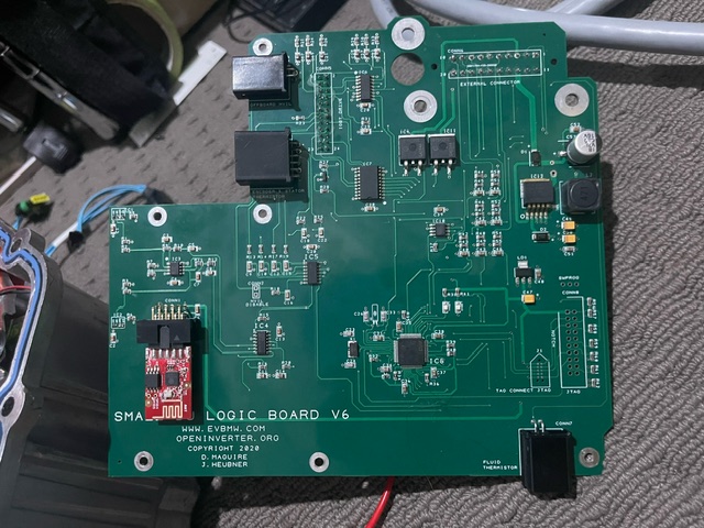

This post is interesting and may explain the problem with my board, which worked fine 4 years ago but now will not connect reliably to wifi. It has an L2 inductor but not an L3 - is this a typo ?
- Been thanked: 1918 times
Re: Tesla SDU/LDU wifi connectivity
No, this is just relevant for the newer boards with wifi soldered to it.
My board is V6 but does not have L2, just L3. The supply to the wifi module is measures at 3.4V, However I always have issues connecting on wifi (intermittent) and when I connect I can upload parameters OK but cannot download spot values - Just get a blank page. Does anybody have any ideas as to what the problem might be?
Can you supply a picture of your board?
Yep, typo in my opening post, should say V7, V8. This thread doesn't apply to your board then. Just make sure the 3.3V rail is dead stable. Measure between some GND and the upper rightmost pin of the wifi module socket
