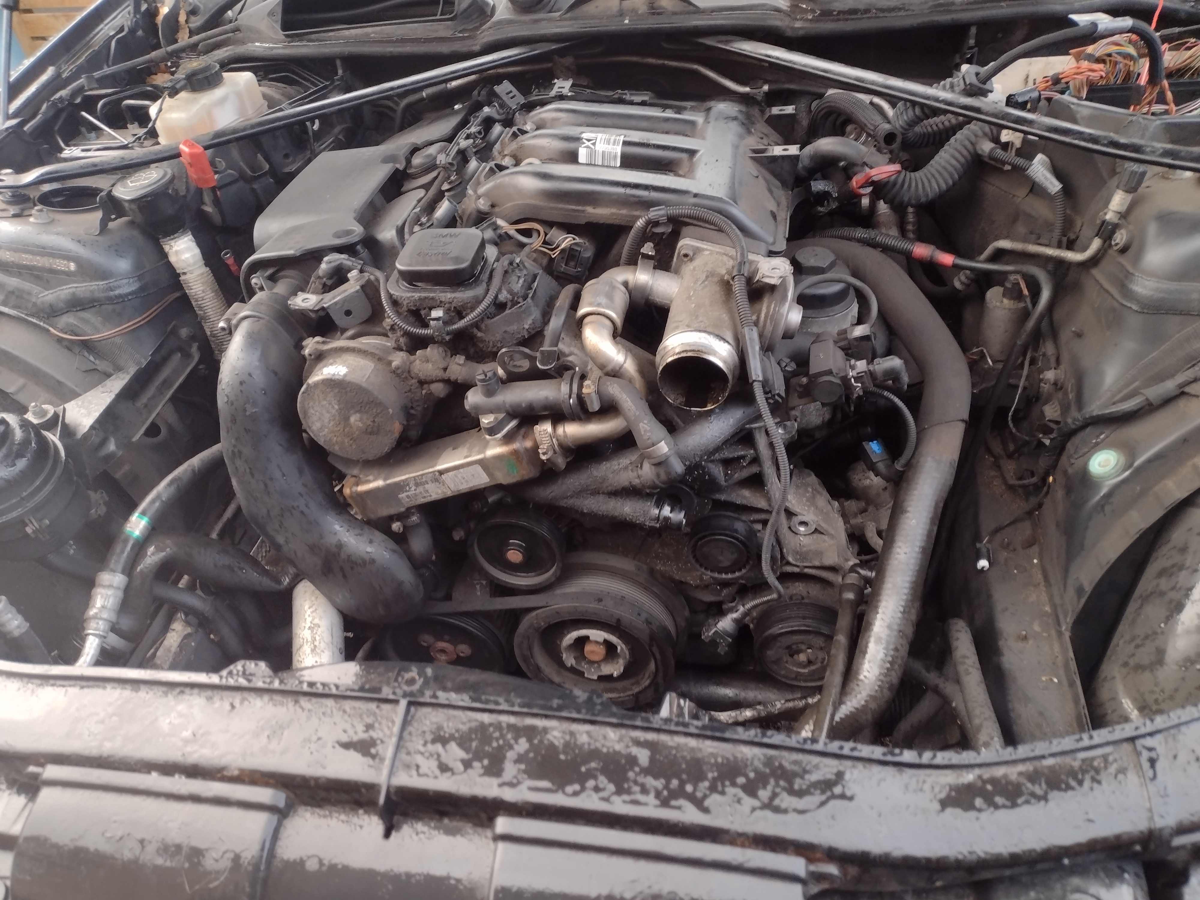

Found this for sale on Facebook with a very blown head gasket for £450 so conversion number 2 will begin. It'll be a GS450h, Zombie, Outlander Charger / Heater / AC compressor. Will have a UHI based CCS.

I taken can logs of the PT can from the DDE (BMW speak for ECU) https://github.com/jamiejones85/E91-320d-canlogs I think I'll take a few more logs, car in reverse, AC on, traction control off etc just to be sure I've got enough, then get the AC dude round to drain me (for the environmental and legal reasons) and begin ripping out the lump

Started disconnecting the coolant hoses and wiring. Compressor now unbolted so that's not holding me up, but the AC people coming Monday to evacuate anyway.
King Kong has put the wheel bolts in, my impact gun will not loosen them so can't get the front bumper off easily. So tomorrow, I'm going to try drop the gearbox off and get that out of the way before going round to my mates and taking his engine crane for a walk round to mine.

Will see what happens when I get to the batteries stage. Initially, I'll just be pulling out the 3rd pack from the boot, but I don't need multiple cars.
Trying to plan what I need to do to have AC, I've got a HV compressor, but my concern is how I go about cleaning out the oil from the evaporator, condenser, and lines. Then need to workout the EV friendly oil to put in and find someone willing to fill it up, obviously they've have to trust that the PAG oil has been cleaned out sufficiently as to no contaminate their equipment. Or somehow drive the current compressor with another motor.

Could convert the alternator from the bmw engine to a motor to drive the bmw compressor,
Fairly sure gen3 prius used r134a refrigerant, also you’ll be stuck with using r134a anyway regardless of what compressor you fit as the filling fittings are different size to r1234yf

I think the refrigerant is still r134a but the PAG oil eats the coatings of the windings and will problems.

I have flushed an a/c system before using pressurised aft and then compressed air, did involve taking the condenser off the car and doing that separately, used a new dryer on reassembly, if you used Toyota ws atf it would definitely be winding friendly!

Engine still not out yet, but only needs lifting out now, all stuff disconnected. My GS450h gearbox here now. Still need to source an inverter. Sellers asking too much on eBay for them.
