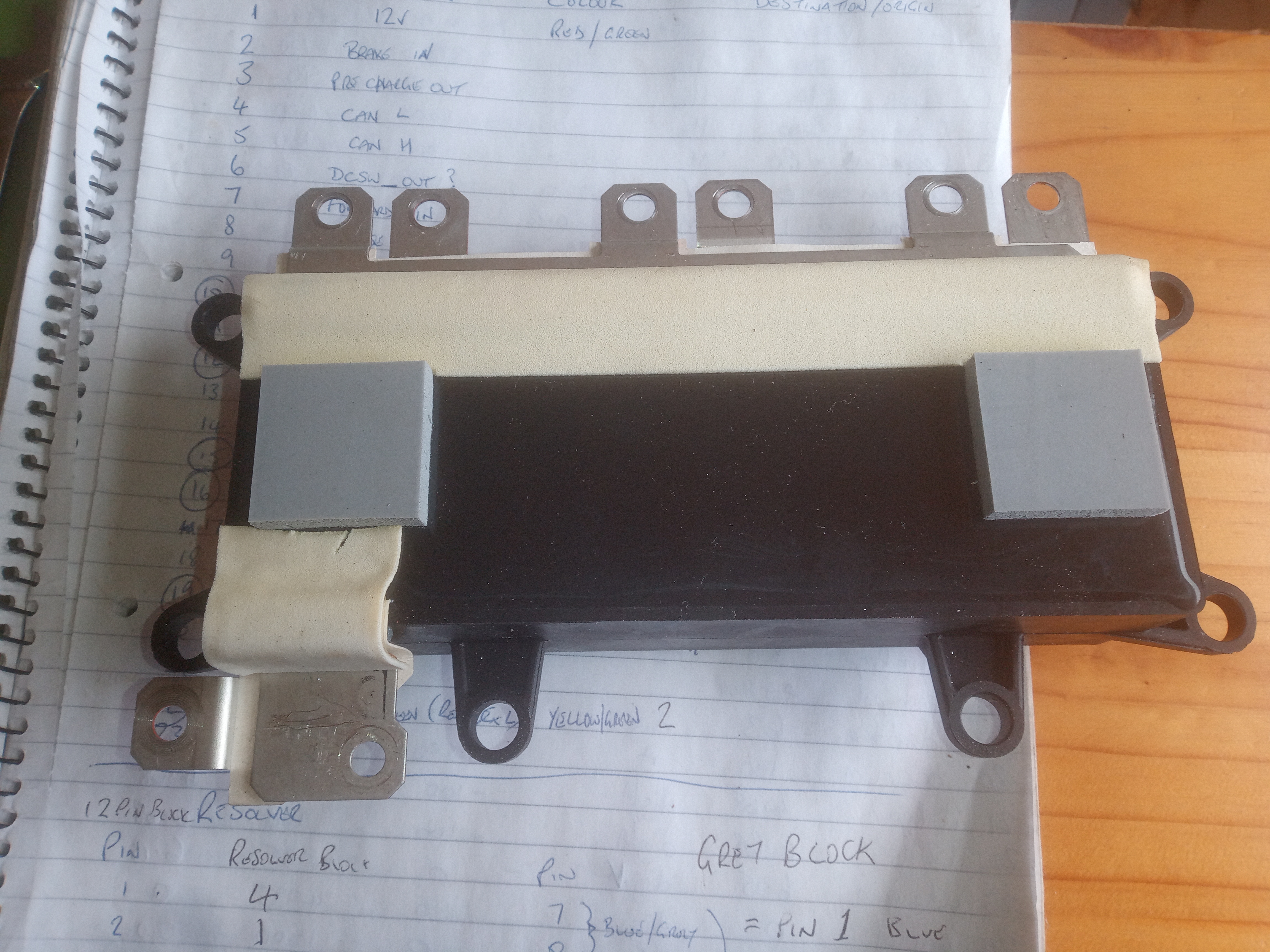

Re: i3 controller hacking from diyelectriccar.com
Has anyone made any more progress with this?
I am now stripping all the unnecessary stuff out of the safety box so I can put that in line with the batteries.
I am also uploading another video with the inverter casing work, should be up by the end of the day if anyone is interested.
I have put a plate over the coolant areas with a pipe connecting the two, hopefully it works ok.
