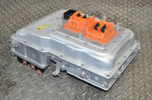

There are 2 variants of the i3, the standard i3 with motor power rated at 125kW and the i3s rated at 135kW.
There are 2 subvariants, as REX versions have an additional 25kw inverter and onboard generator.
Power stage: Infineon FS800R07 IGBTs rated for 800amps 650v

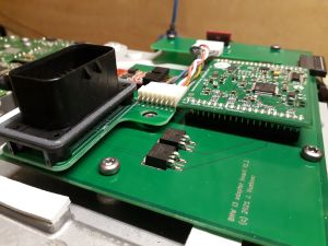

Openinverter Drop-in Board
The drop-in board houses the openinverter, generates 32V for the gate driver board, communicates via SPI with the gate driver board to obtain voltage and temperature readouts, and provides outputs to operate contactors. See bottom of the page for list of modifications required for these boards to work. Pinouts for the three connectors on this board below.

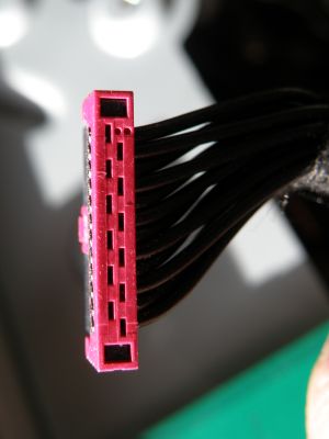

Motor Resolver & Temperature Sensors
12-pin PCB header to connect to the motor sensors is an ERNI MiniBridge, part number 294920
Wire colours to pin allocation below determined by schematic and multimeter trace, with resolver coils and temperature sensors checked for resistance. Confirmed with motor bench test.
| Pin No | Colour | Description | Notes |
| 1 | Brown | Sin Hi | Twisted pair. 22.4 - 33.6 Ω. |
| 2 | Blue | Sin Lo | |
| 3 | Yellow | Ex Hi | Twisted pair. 22.4 - 33.6 Ω |
| 4 | Green | Ex Lo | |
| 5 | Red | Cos Hi | Twisted pair. 13.6 - 20.4 Ω |
| 6 | White | Cos Lo | |
| 7 | Blue | Temperature
Sensor |
From BMW Service Technical Training Manual - I01 High-voltage Components:
There are two stator coil temperature sensors. The rotor temperature is determined using readings from the stator temperature sensors. |
| 8 | Grey | ||
| 9 | Red | Temperature
Sensor | |
| 10 | Grey | ||
| 11 | - | Unused | These wires terminate in one of the six pin connectors in the motor housing. There is nothing connected to them. |
| 12 | - | Unused |

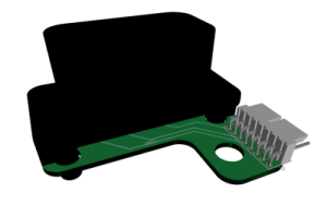

Modifications required to drop-in boards
Five modifications are required for the drop-in boards to work, plus an additional one if using CAN communication.

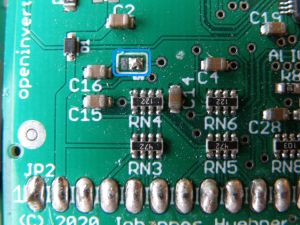

Mod 1. Close SJ3 on the openinverter board with solder
This enables SPI communications by assigned Pin 4 on JP2 as the MOSI line. Additional explanation here.

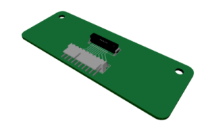

Mod 2. Motor Resolver & Temperature Sensor Adaptor Boards
A pair of adaptor boards (see also images to right) are available and shipped with the current drop-in boards. These enable the ERNI Microbridge connector from the resolver and motor temperature sensors to be connected to the required pins on the Ampseal connector. Design files for these boards will be posted on github at some point - if you need a copy in the meantime contact user 'CJW' or post on the i3 controller hacking thread.

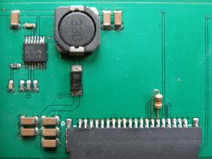

Mod 4. Check solder connections on the drop-in board
The 40 pin surface mount Harwin connector to the gate driver board may have dry joints or shorts.
Mod 5. Gate driver PSU power pin
Pin 35 of the Harwin connector to the gate driver board is not connected to anything. Testing indicates this must be powered for the gate driver to work, at least on some boards. The motor has been run successfully with 5V to this pin via a 100 Ohm resistor from the adjacent pin 34, which receives power from the openinverter's 5V supply. Some earlier notes in the i3 hacking thread suggest it may also have been tested with 12V.
