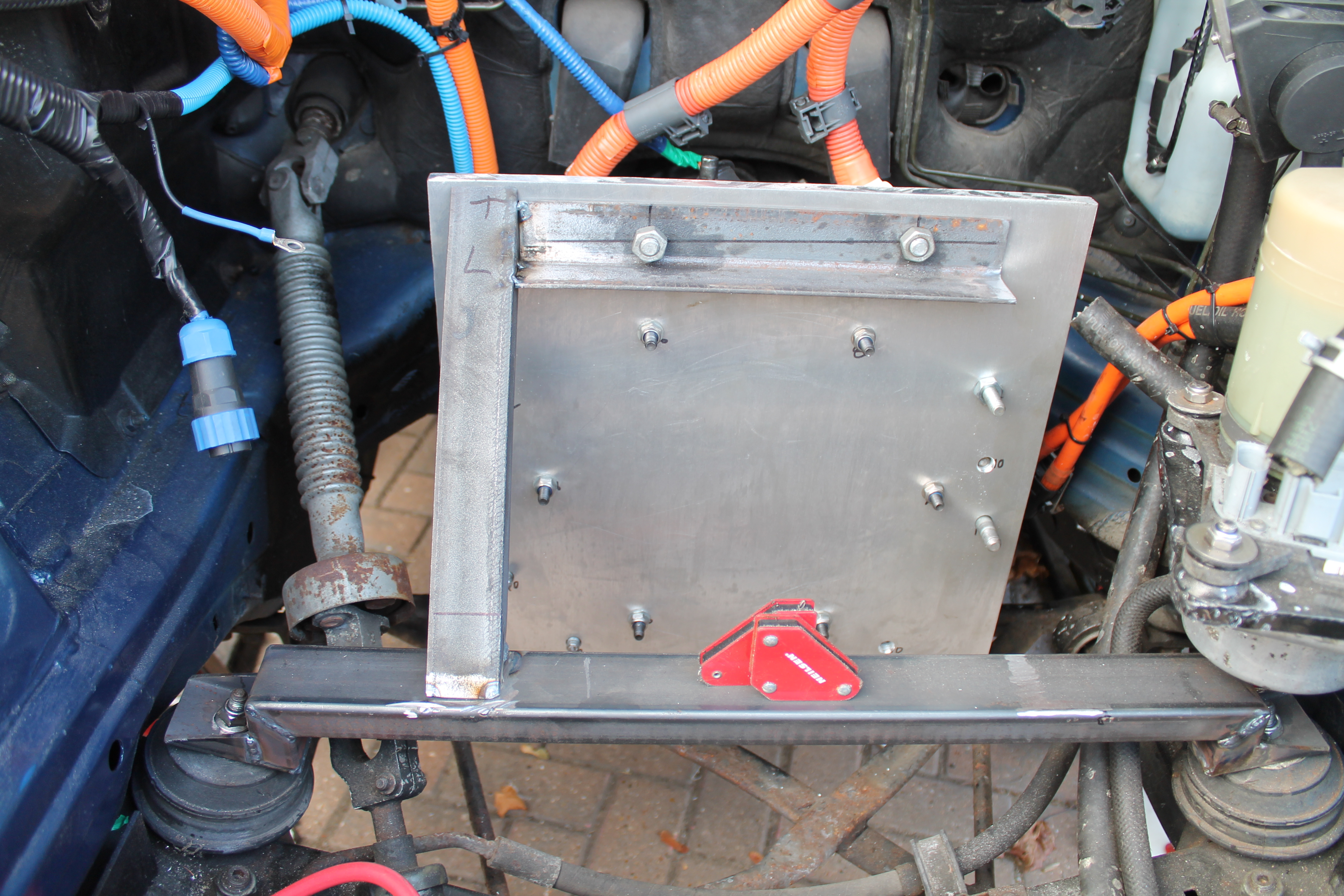

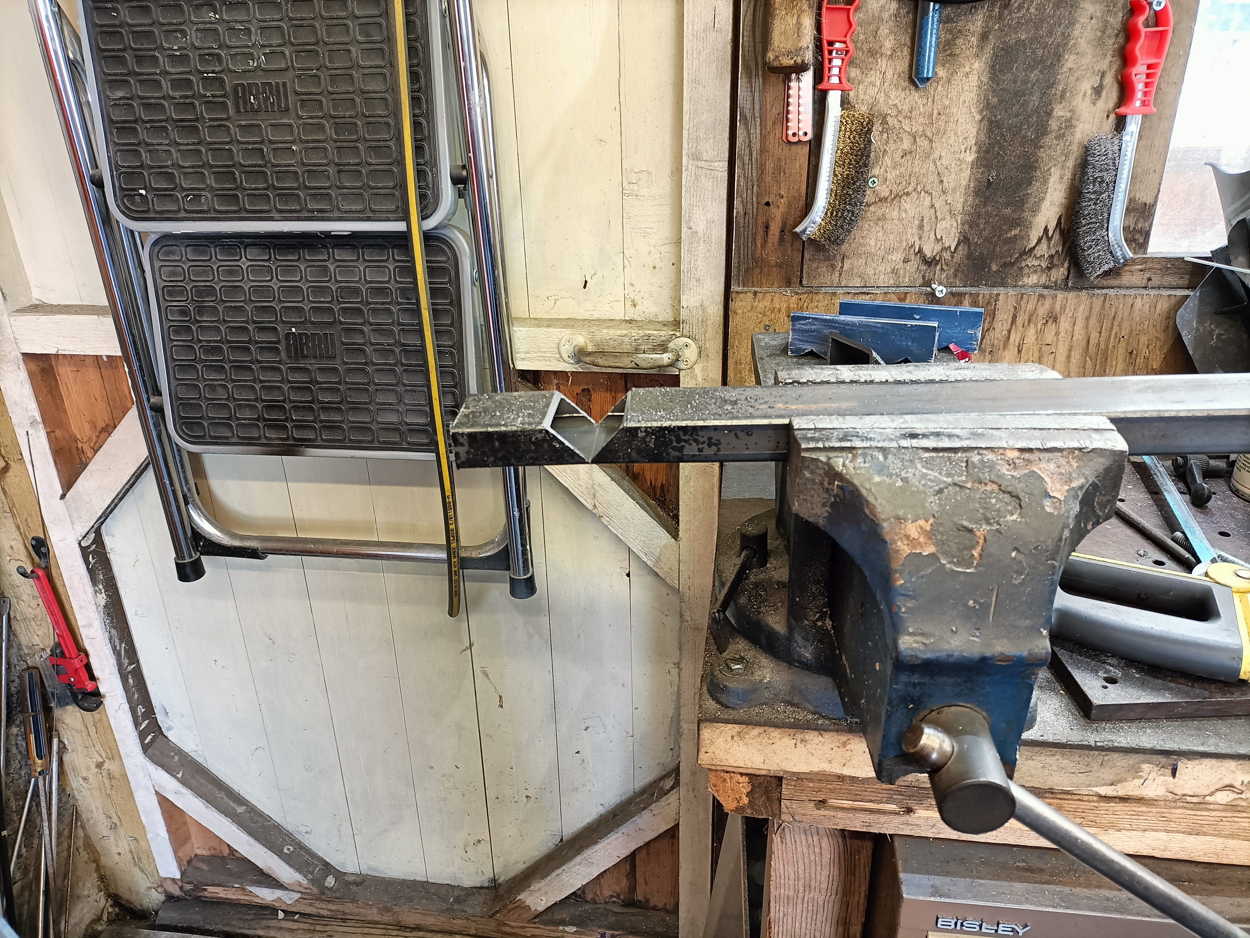

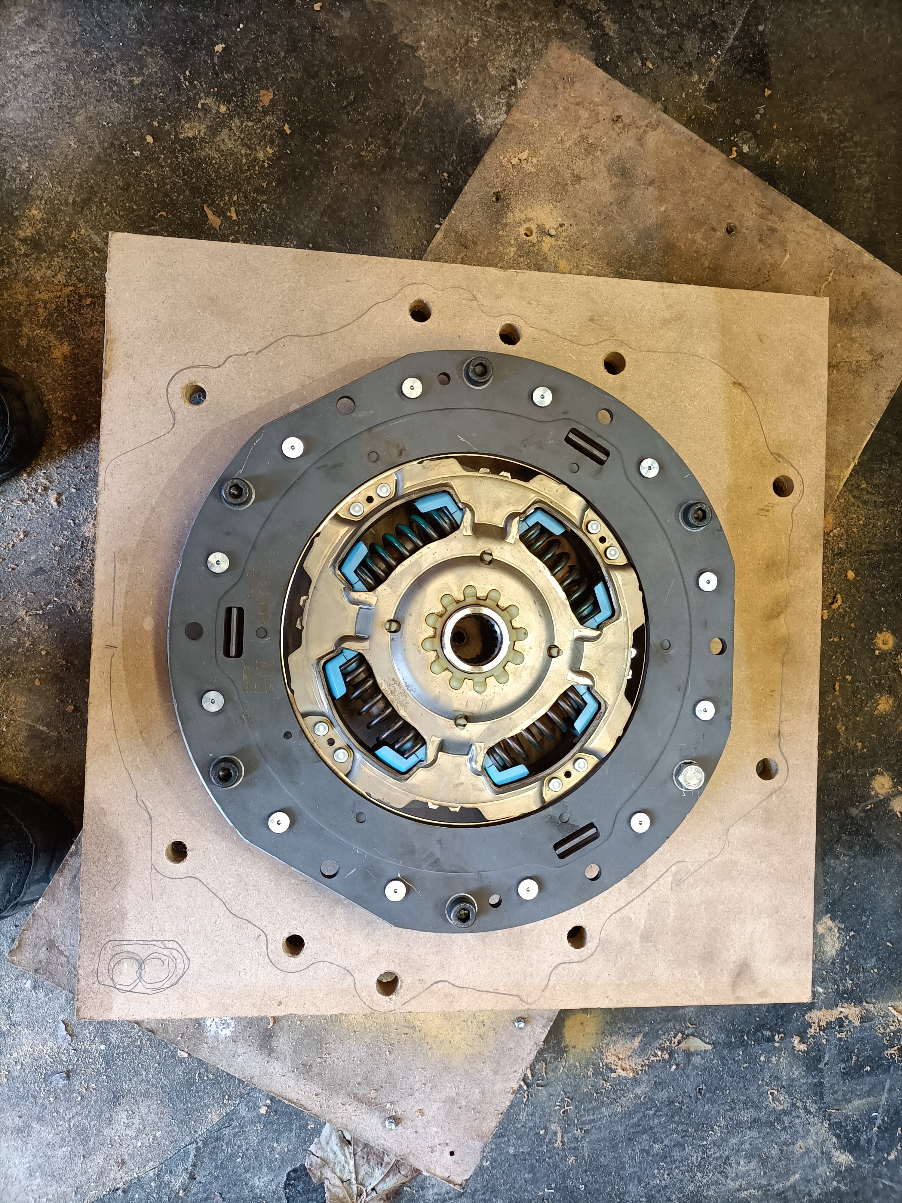

Re: [DRIVING] BMW Z3
Made up a template today for the front plate which will bolt to the lexus transmission as I'd rather mess up a cheap piece of mdf than an expensive ally plate, I made up some punches to the exact size to mark it through the bolt holes so that it's as accurate as possible
Also started making the steel work to fix it to the engine mounts, I'm using 3mm wall box section sadly I didn't get too far as I'm out of gas

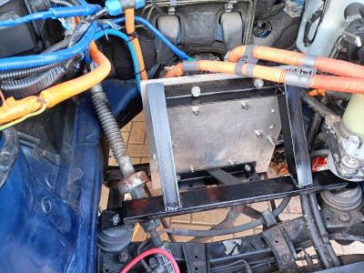

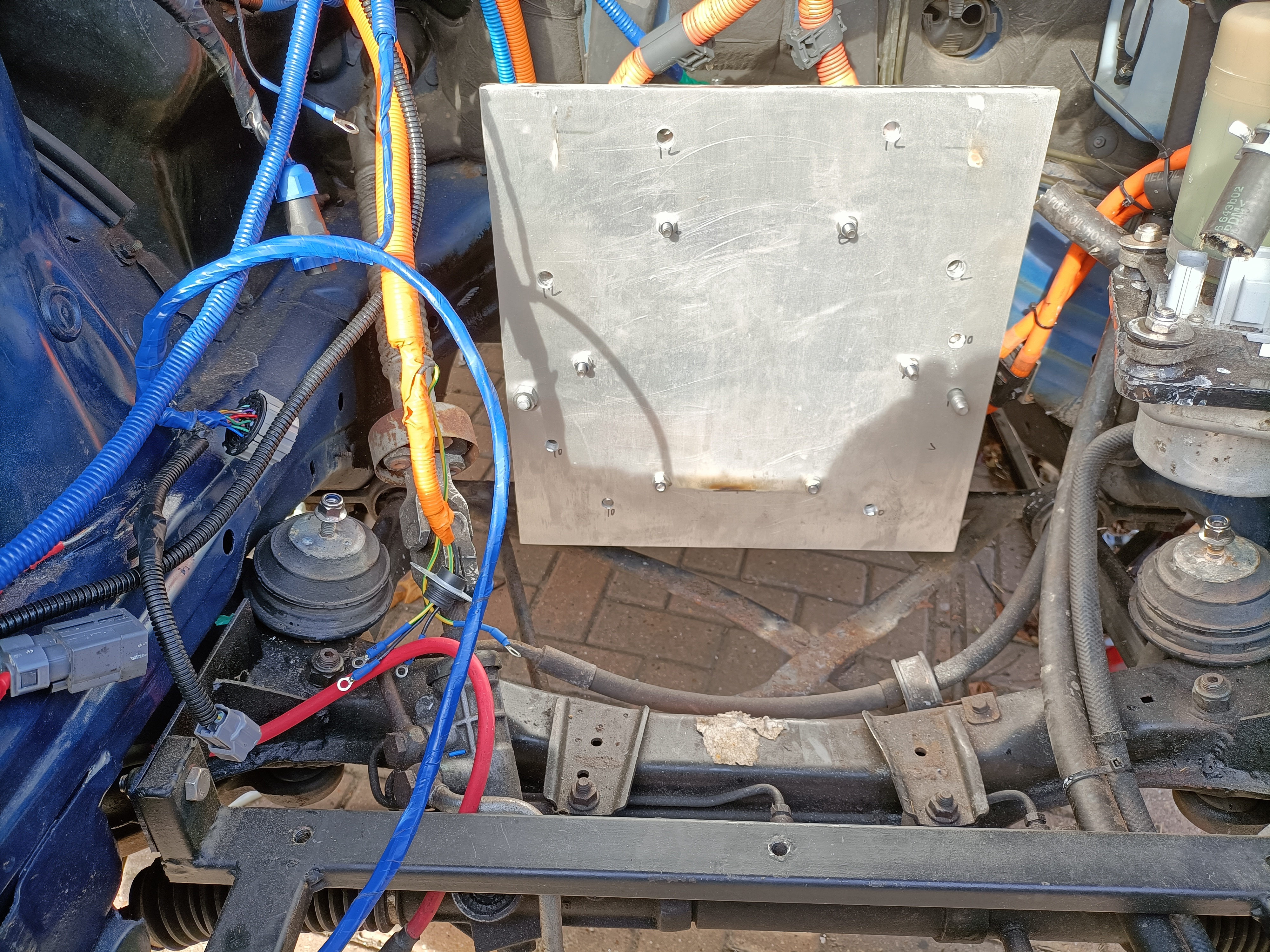

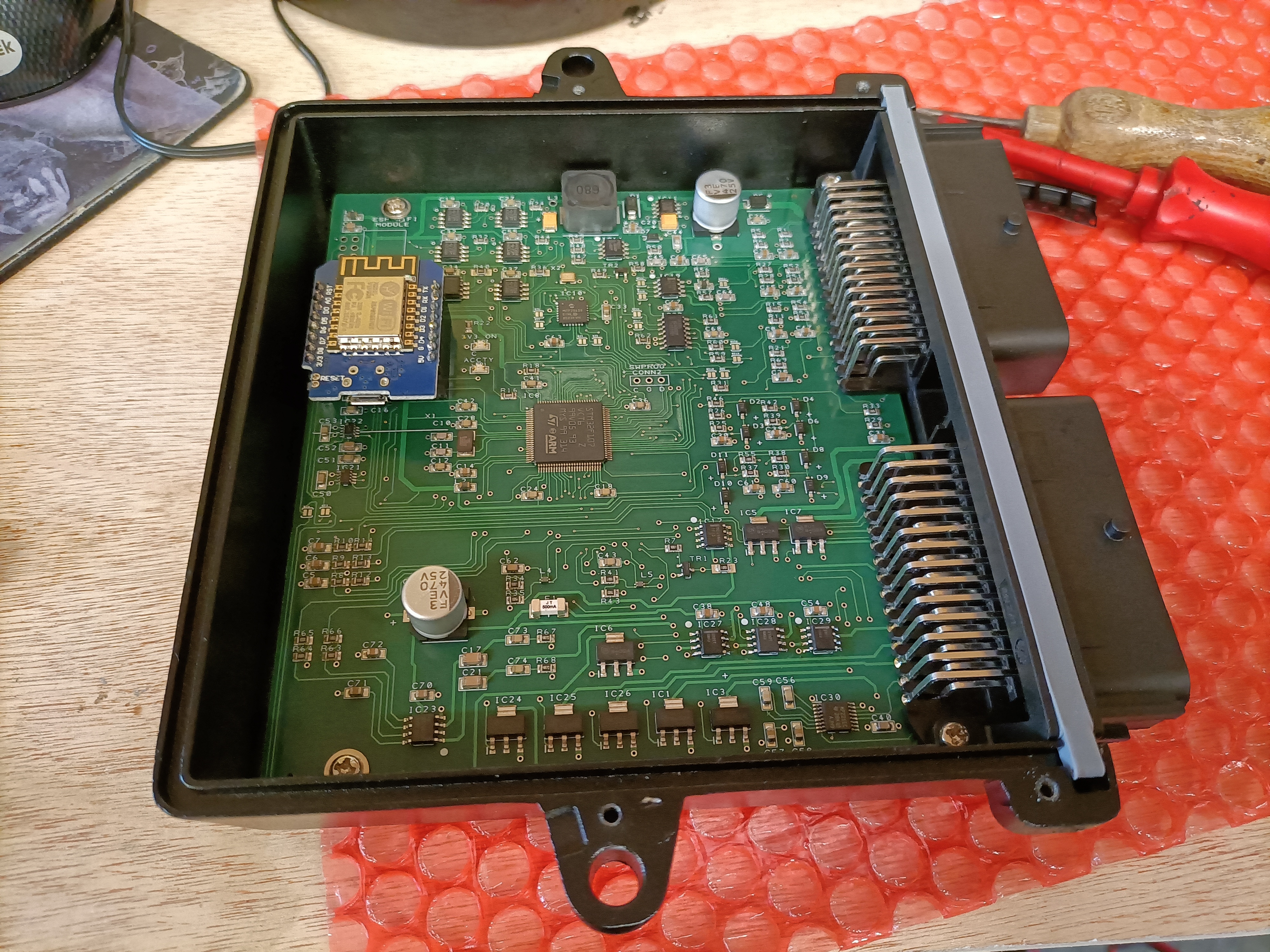

Re: [WIP] BMW Z3
My Zombieverter arrived a while ago and now that the connectors and case have arrived I've got it all built up and tested and ready to go
The ally plate also arrived for the lexus transmission mount and to mount the coupler for locking the input shaft, this has had all of the mounting holes drilled using my template and I've finished the mounting to fix it to the engine mounts
now that's all done I can pull it back out again and get it up and running on the bench, I could possibly do what I need to do with it in place but experiance tells me it's not going to be that easy
