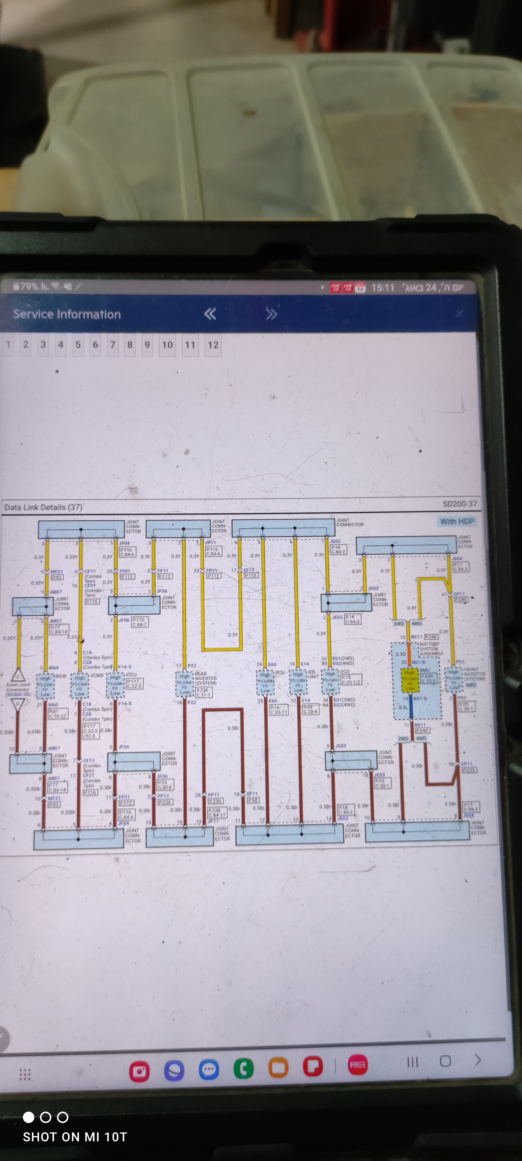

Hello everyone
I'm working on ionic 5 battery too. I could get the pen out for the BMS connector. I've done the connections to a diagzone connector. Pin 1 power. Pin 12 IGN power. 10 and 11 canbus. And i used chases ground. Using diagzone on Android i couldn't detect the bms. I've attached the pinout and the canbus diagram.
Ive used 120ohm on the canbus as well. But it didn't work.

I have also a kia/hyundai 77,44 kWh battery pack. I faced same issues as described in this thread.
I found that the wire cord socket (BF-11 also called as "BMU extension connector") descibes the10,11 pins as G-CAN FD (HIGH) and G-CAN FD (LOW) respectively. I suspect that indeed CAN-FD capable device may be need for BMS communication. I have read that "newer vehicles use a CAN-FD communication protocol". In addition I watched few viedeos of the PowerBASTRO where person has used G-SCAN with "Hyundai / Kia ACU Adapter 029 - G1ZDDPA029" and "Hyundai / Kia CFCI Module - G1DDDME001" to connect to Hyundai IONIQ 5 / KIA EV6 batteries to sucessfully communicate with BMS. Unfortunatelly I have neither CAN-FD device nor mentioned adapters that I could use for testing.

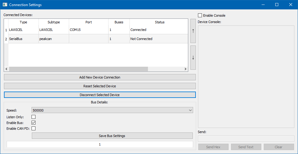

@cgalpin There could be problem with Savvycan CanFd support. It has to be enabled in connection window but it's only shown when supported canfd interface is selected (using qtserialbus so peak can and few others):
https://github.com/collin80/SavvyCAN/bl ... 19-L401C19
I have Canable v2 and savvycan sees only frames <= 8 Bytes long because it isn't possible to enable canfd in connection window.
Cangaroo shows all frames correctly
I used Toyota Yaris IV iBooster for testing

Posts: 38
Joined: Thu Sep 24, 2020 8:39 pm
Has thanked: 7 times
Re: Hyundai IoniQ 2020 HV battery pack
Post by cgalpin »
Yes I believe you are correct. In fact when I got my new CANDue I did notice a difference in serial log output using the CAN-FD connectors and Collin even explained it could be due to CAN-FD messages but I guess I didn't understand :). What I now believe was happening was it was seeing CAN-FD messages but it can't handle them and they never made it to the UI!
