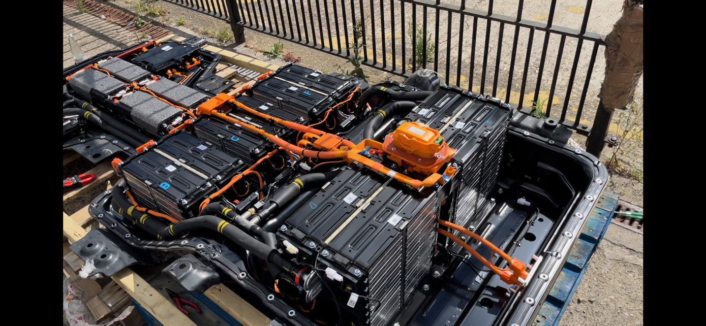

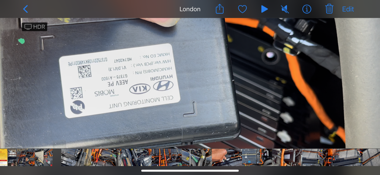

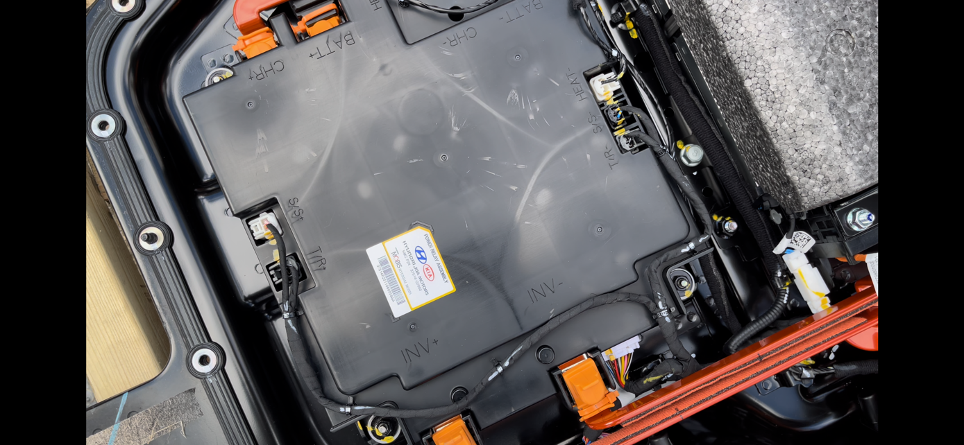

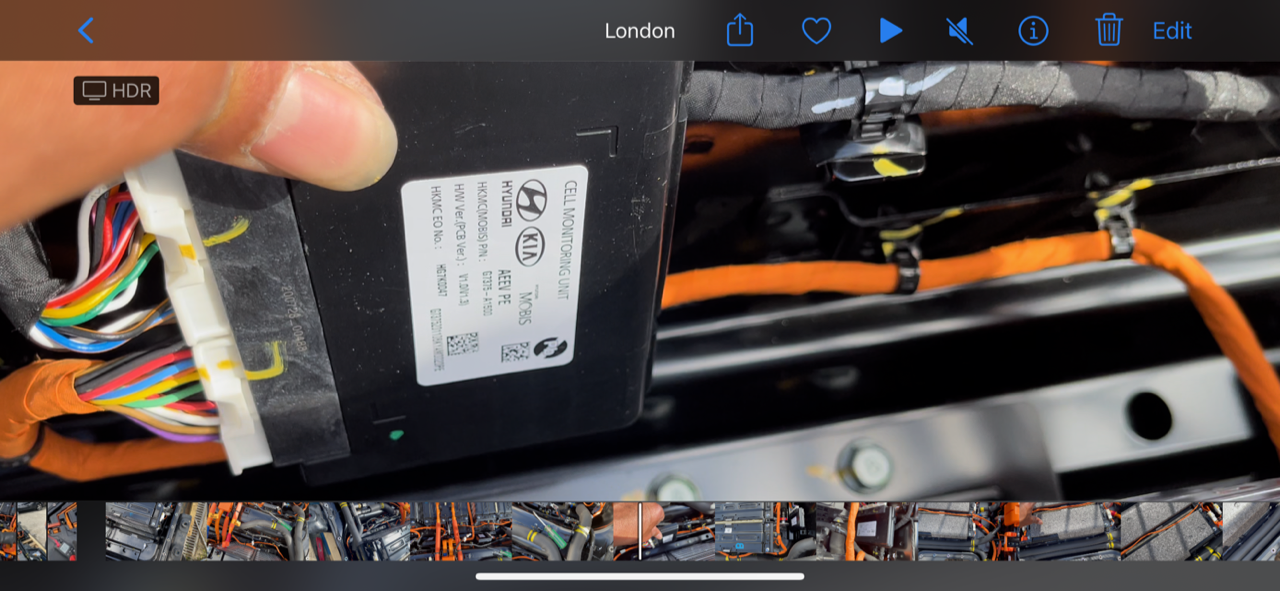

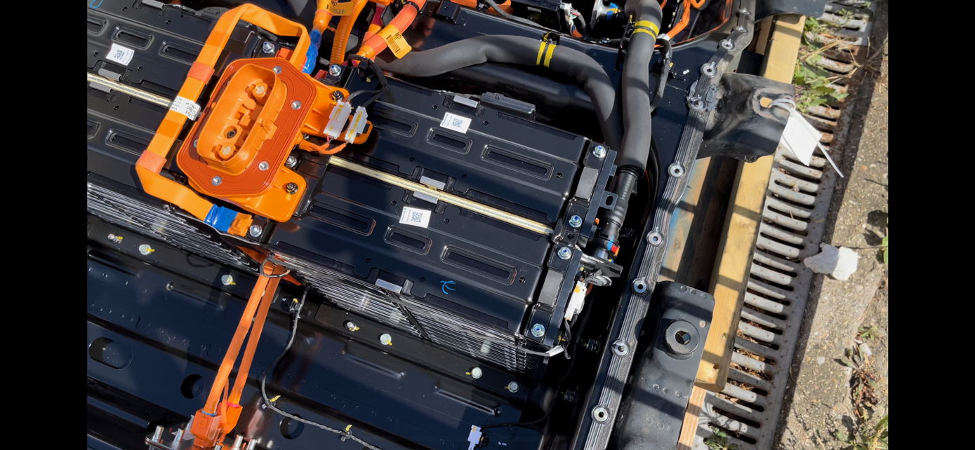

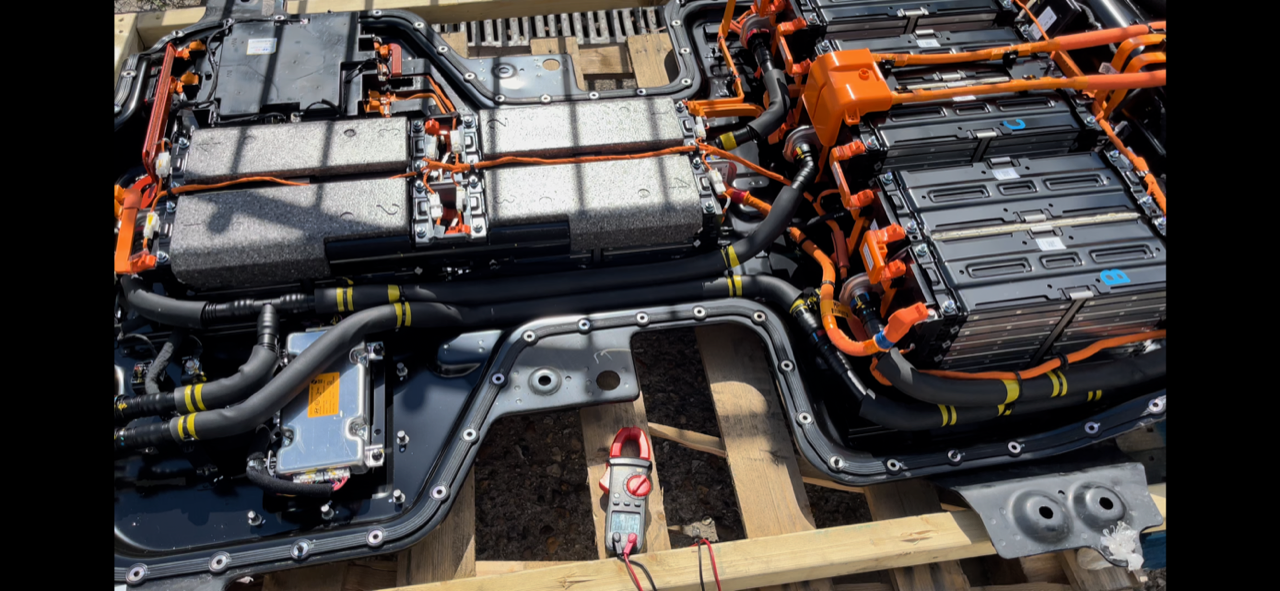

Hi All, so I’ve recently purchased a 2020 Hyundai Ionic EV battery pack 37501-G7650, and I’m hoping to get it working in my EV conversion, and hopefully spread some of the information that I find on here.
I do have some questions, so if anyone is able to, your input would be greatly appreciated.
1. Is it possible to read the BMS information via CAN?
2. Is battery balancing a standard operation on BMS systems and is it activated as soon as there’s power to the BMS.
Is the BMS involved in Grid station charging? What sort of information is required for a grid station to output power?
Thank you all in advance, I have attach photos of the pack? Please let me know if you require any information from it.

I used car scanner to check details on a 2018 28kwh , I would imagine you might be able to try and splice into the can lines and 12v to see if it works with a obd socket spliced on , I found a can log online for a 28kwh if that's of any use to you.
Re: Hyundai IoniQ 2020 HV battery pack
Hi, Yes definitely looking into this and will share what I can find. Adding photos and info on the next post.

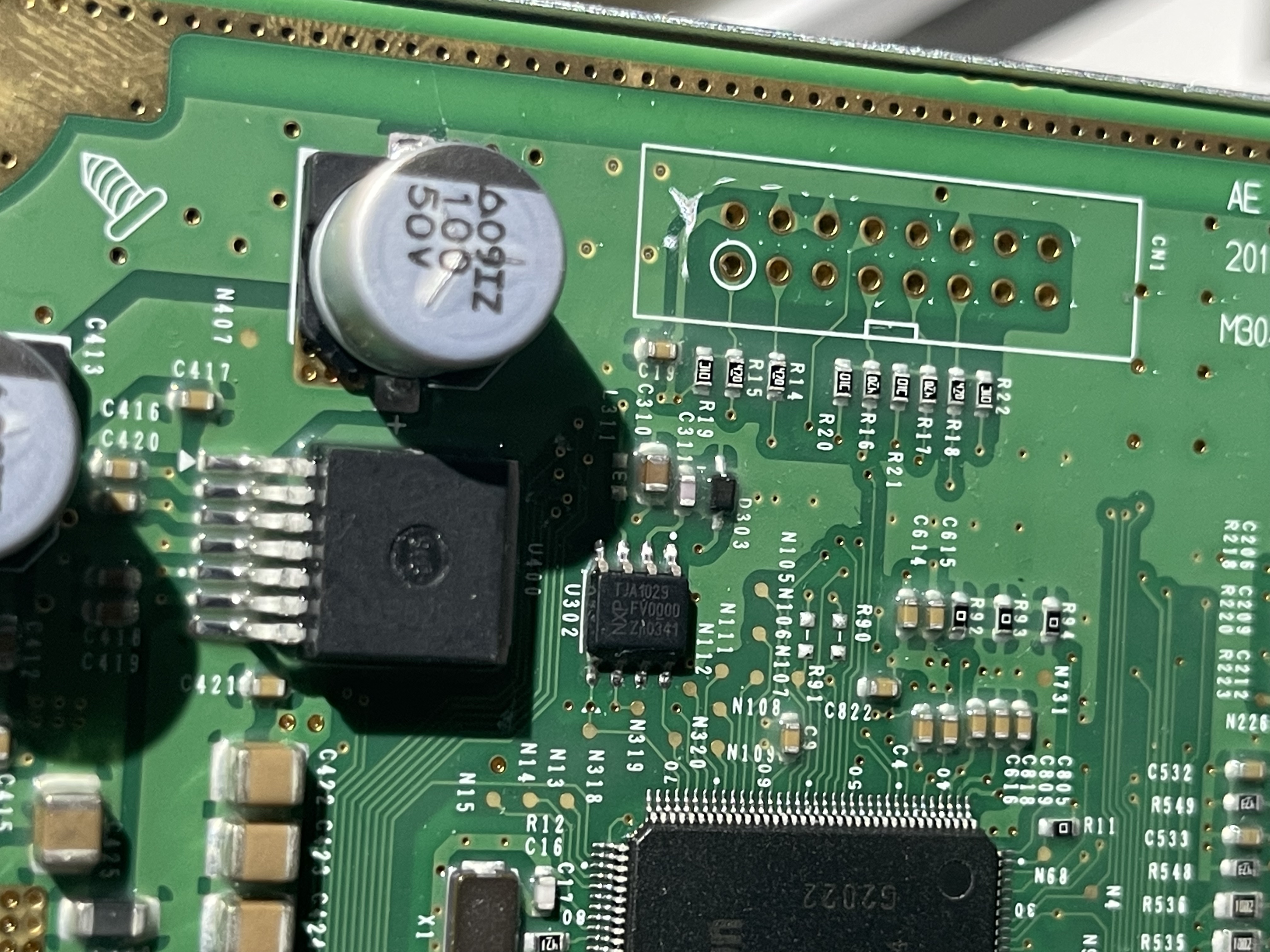

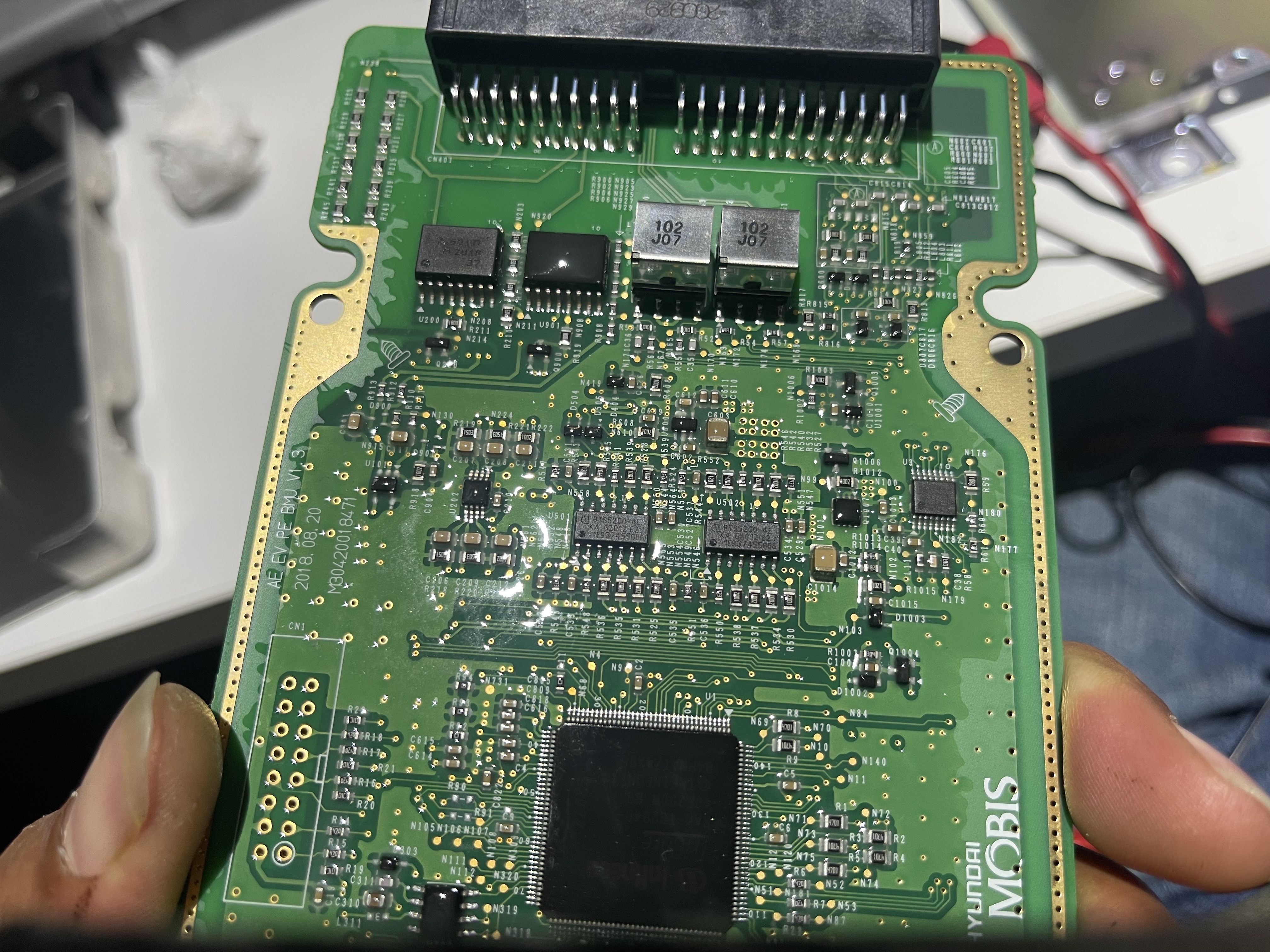

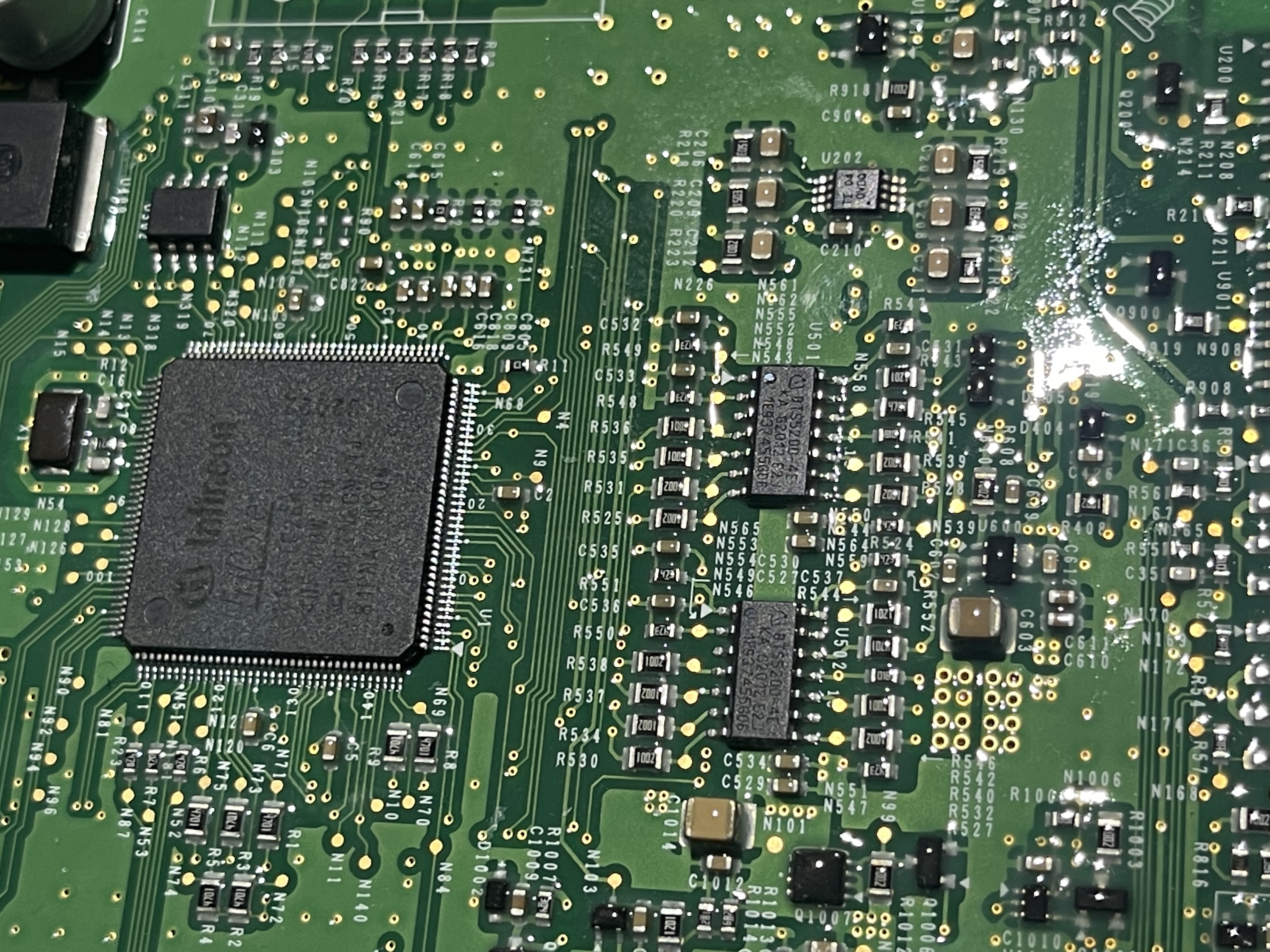

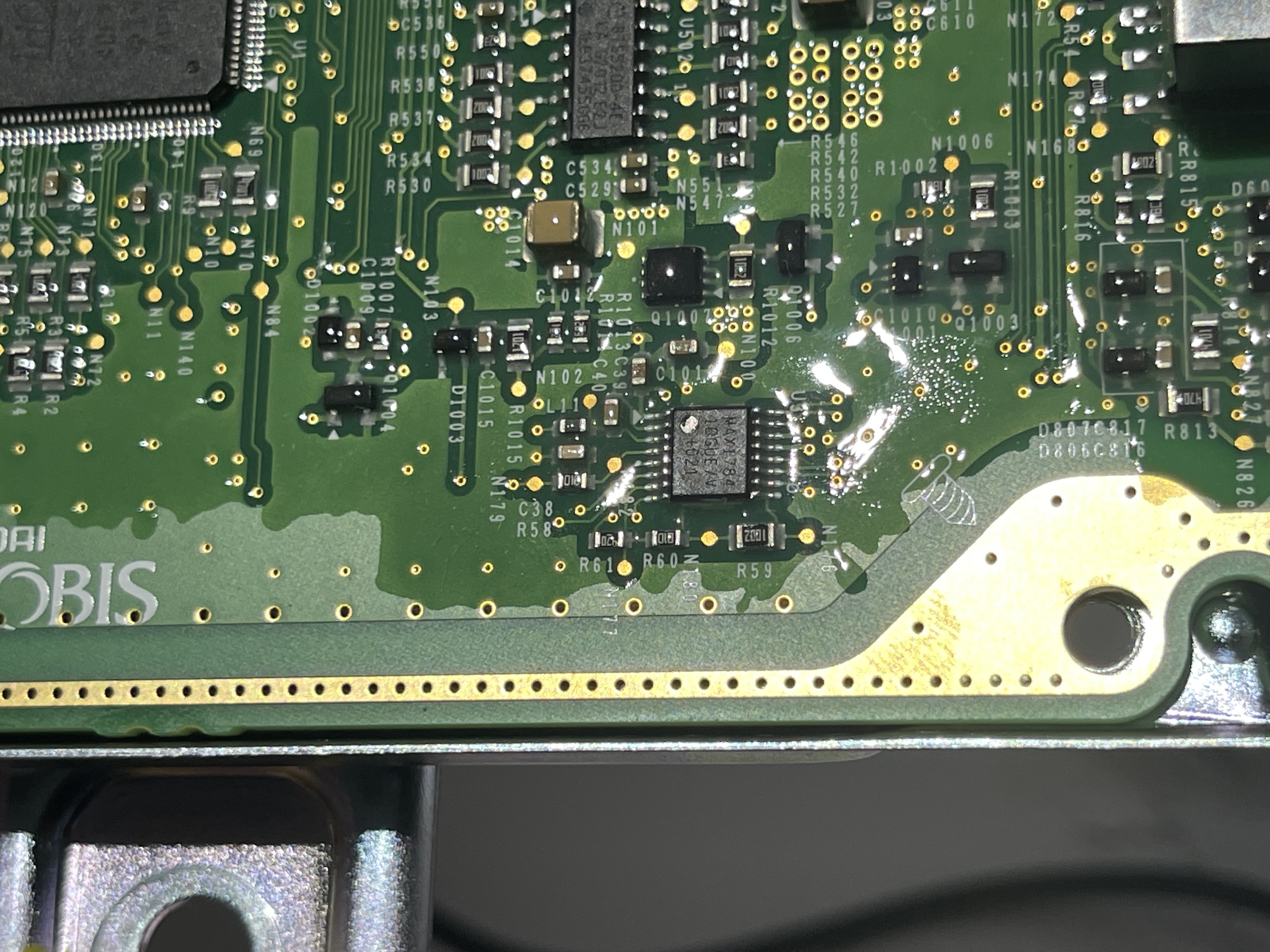

I' attempting to find the CAN signals connections with my limited PCB knowledge, and here's what I've found

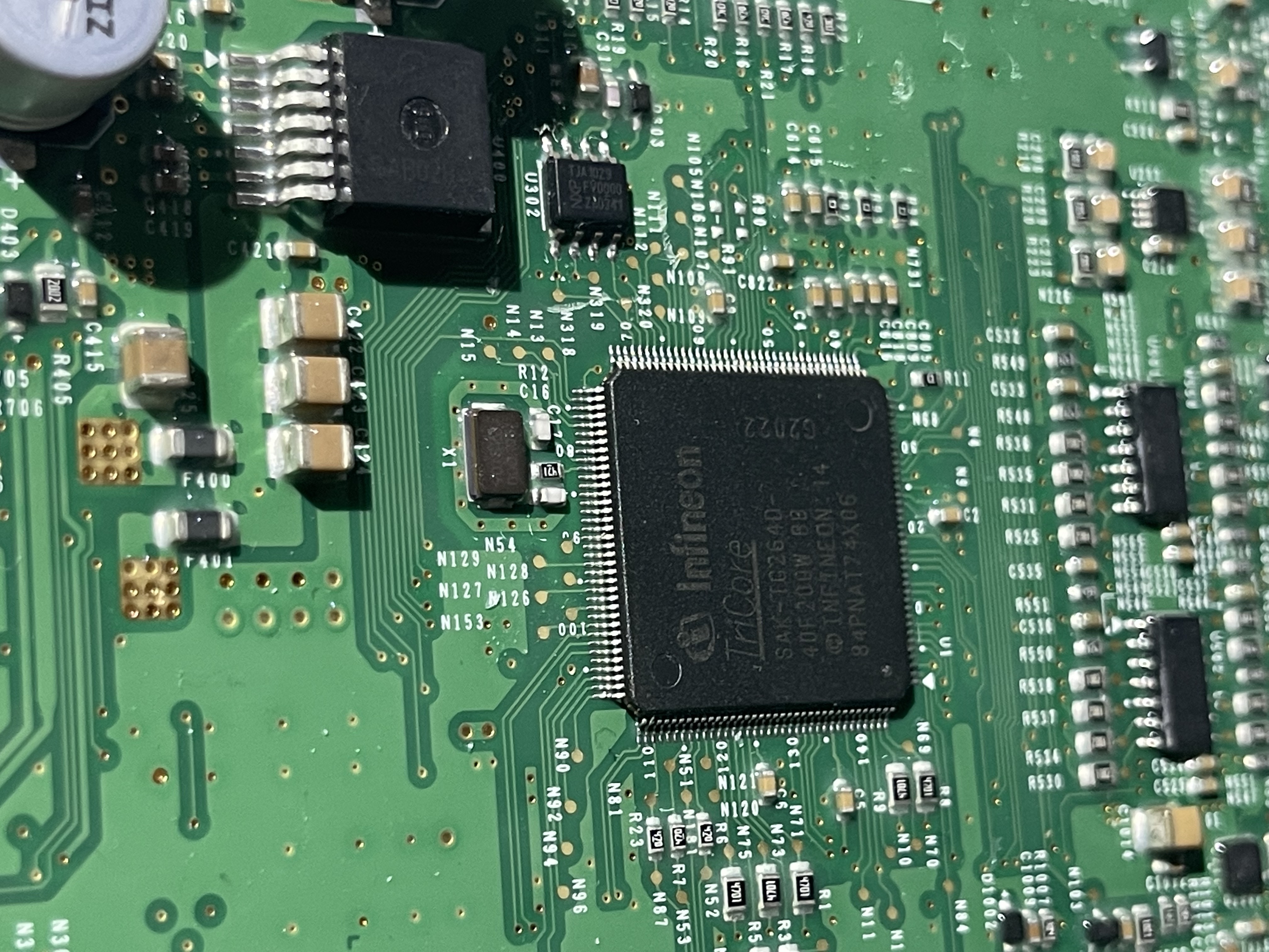

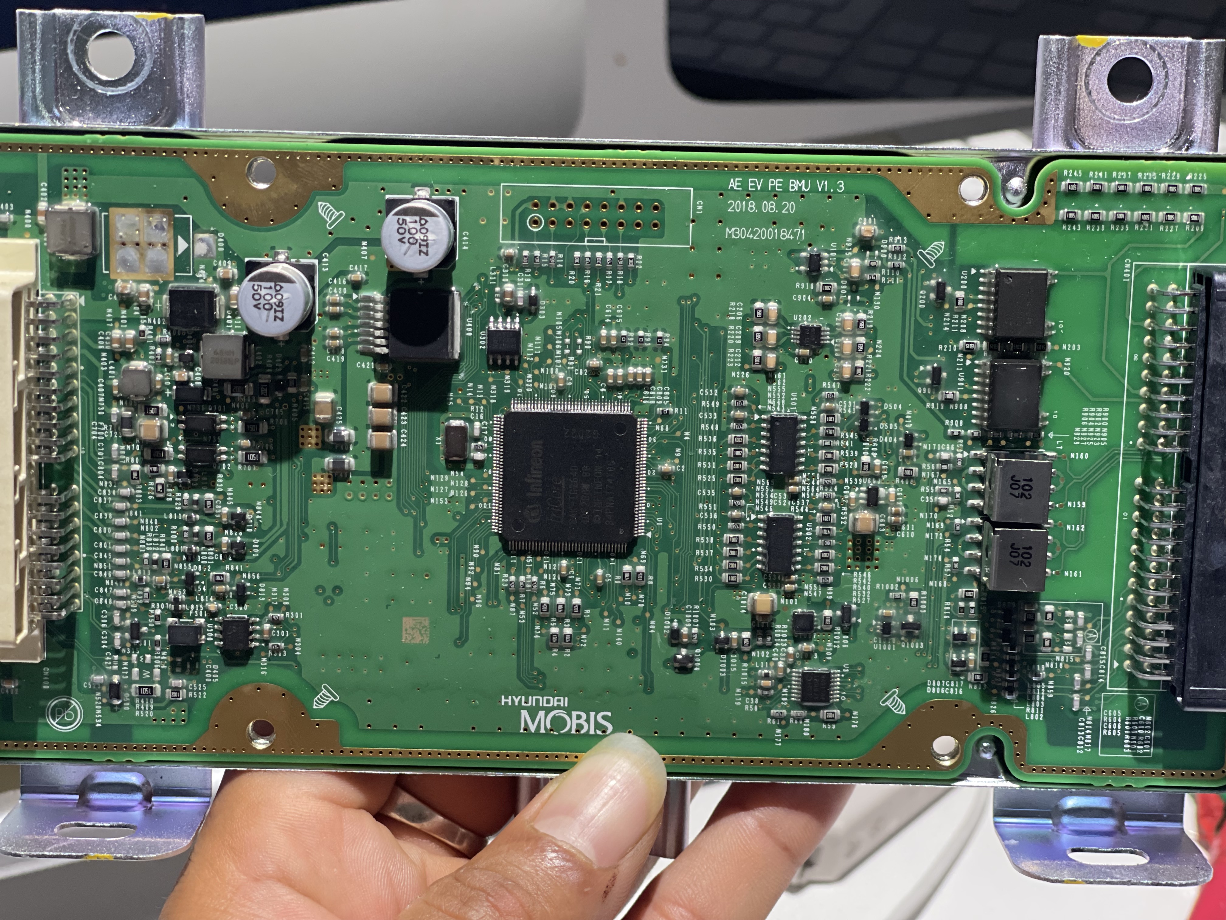

So I've taken out to BMU and opened it up and found some interesting chips on the board.
Infineon SAK- TC2640 40f200w BB Infineon 14 84pnat74x06
Max1784 1bgue/v +021
Tbs5200-4E KA G2012 e2j 1E937455g06
NXP TJA1029 FV0000 Zn0341
T251V 443 G2025
TI 04 OVDQ
I think I've managed to figure out power input into the board, However i'm unsure of whether an enable/ignition signal is requires
I'm assuming the NXP is CAN related, Maybe One of you legends could tell me differently.
And of course you have the Massive Infineon processor chip.

TJA1029 is LIN bus transceiver. U300 looks like CAN interface, possibly TJA1050 but can not read it in photo. U3 is MAX17841 which is ISO SPI, which I assume is the interface to the battery modules.

Nice photos. I've wondered when is it that someone might figure out the communications on the Korean stuff!

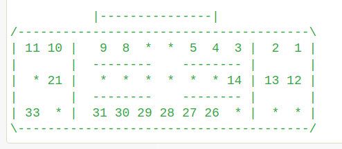

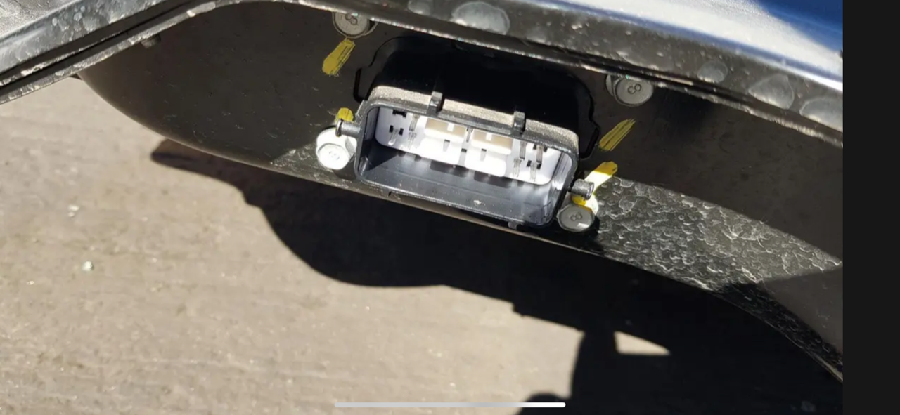

Nice stuff! I have a crashed 2019 Kona sitting outside. I'm hoping to run the full BMS in a transplanted vehicle (rather than going one layer down and talking to the the cell monitor units, as some others on here are successfully doing.)
I am hoping the battery pack control would be similar between 2019 Kona and 2020 Ioniq, It's hard to tell from the photo how many pins are in the external socket in your photo, it looks like it could be similar or maybe it has fewer pins?
On the Kona, the plug is KET MG656922-5 and the pinout (Kona connector number EB11) is:
EDIT: ASCII art seems to only work in some browsers, so here's a screenshot of the ASCII art!
(This might be mirrored left-to-right for you, I wrote it down based on the harness connector. My car is still mostly intact so I haven't verified it.)
Here are my (unverified) notes on the external connector pinout:
BTW, if you're in EU or some other places then you can pay 15 Euro to Hyundai Global Service Way then you can access the exact schematic diagrams, connector pinouts, etc for the Ioniq including schematics for inside the battery pack. The above is from notes I took while looking there.
Hopefully this is similar or the same as your pack. I plan to take some P-CAN logs from my Kona soon, and will post here when I do.

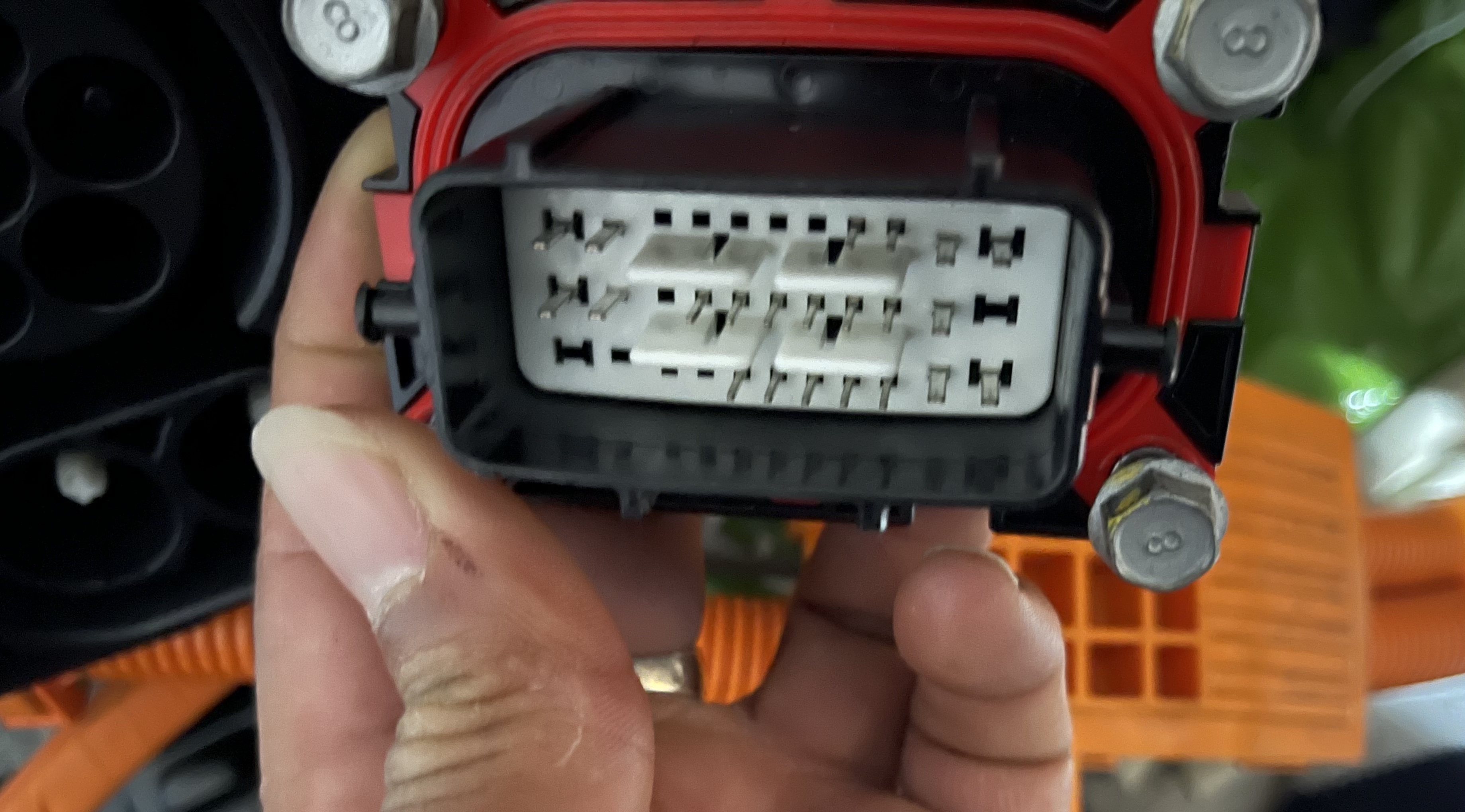

Wow @Projectgus that looks like it exactly. I'm going to test the connections and let you all know how I get on. Thank you very much, sure the forum members will appreciate it too.projectgus wrote: ↑Tue Sep 13, 2022 5:04 am Nice stuff! I have a crashed 2019 Kona sitting outside. I'm hoping to run the full BMS in a transplanted vehicle (rather than going one layer down and talking to the the cell monitor units, as some others on here are successfully doing.)

Huh, that looks like the same plug but with different pins populated in the centre rows. I guess it was too much to hope that they'd make the packs plug-and-play swappable.
If you've got the battery pack open then you can probably have a look behind this connector to see some of the connections (CAN will be a twisted pair, main power will be thicker wire, etc.) But would recommend diving into the Hyundai site if you can, 15 Euros to look at the schematics can save a lot of headaches.
I did think that, when I started trying to piece it together, but i thought to myself, If the connector looks so similar, its more likely that the power and CAN would be in the same place, So i got the multimeter and traced some continuity, from the inside of the BMU to the pins and that seemed to work.projectgus wrote: ↑Tue Sep 13, 2022 11:02 pm Huh, that looks like the same plug but with different pins populated in the centre rows. I guess it was too much to hope that they'd make the packs plug-and-play swappable.

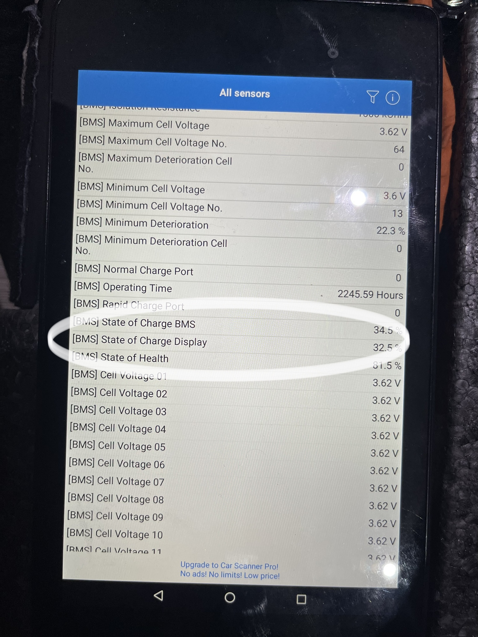

Hi Guys, Just thought I'd do an update on reading the information from the BMU.
So i've managed to connect a Bluetooth OBD11 to the device's pinout and use CarScanner on an android device to view the cells information on the pack, and the cells seem to be in good shape. I have all the connections to provide the data from the cells and pack sensor to the BMU connect and they are all reading fine. Slight strange State of charge percentage displaying 34.5% however the pack is at 318.8 volts, not sure if that's correct but something to look into. This is the video of the setup and what i could see, if anyone is interested.

Any chance of CAN capture when reading the info using the diagnostic tool? Seems to me it would be useful.

FWIW, the PIDs in the scanner requests probably match the ones shown here: https://github.com/JejuSoul/OBD-PIDs-for-HKMC-EVs

RoyBoy, check if battery draws any current from 12V, in my case it's about 300mA. Check if there are termination resisors on CAN bus (120 or 60 ohm)
