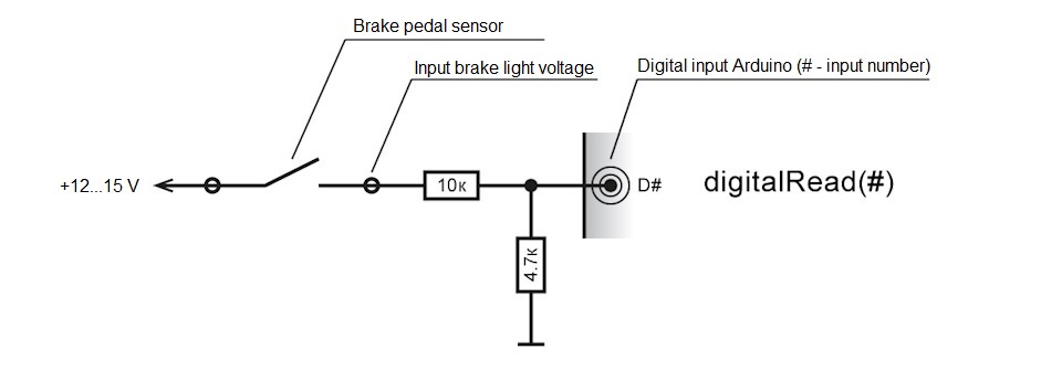

VanGogh wrote: Wed Jul 12, 2023 6:03 pm Now the knob rotates freely. But in the car, it is locked and only when the brake pedal is pressed does the knob unlock. How to implement it? What data needs to be sent to the CAN bus?
Wouldn't be too hard to implement. We know what canbus is used to lock or unlock the knob, you could run the brake light voltage through a relay (So you don't send 12v into an arduino pin)to act as a signal for the arduino. When the brake light is on, send the canbus messages to unlock.

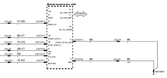

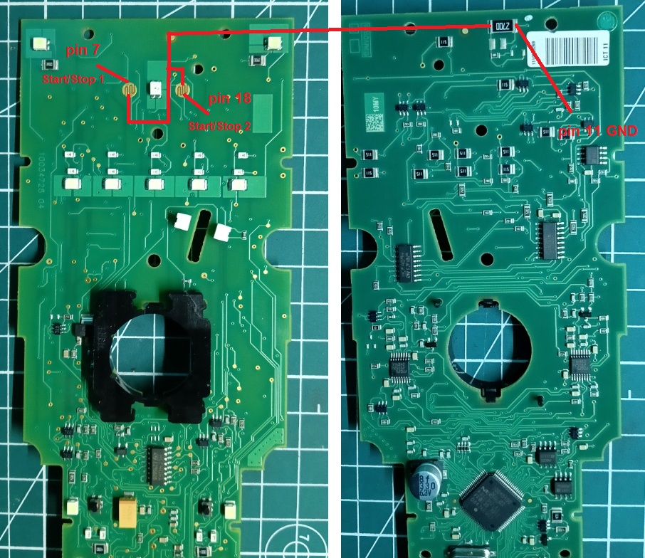

Do you think the voltage on the start/stop button and the handbrake depends on the CAN bus signal or not? I apply 12V to pin 12 (Wake up). And on pins 7, 18 and 11-ground (start/stop) I get 0V. But according to GSMTSM - Pinout.pdf they must be under voltage. The same situation with manual brake, on pins 8,9,10,19,20 I get 0V. Maybe I need to send some kind of message to the can bus and wake up these outputs? Or these contacts work on the Lin bus
GSMTSM - Pinout.pdf
(484.6 KiB) Downloaded 815 times
nkiernan
Posts: 589
Has thanked: 516 times
Been thanked: 95 times
Re: can id´s 4 Gear Selector
Post by nkiernan »
VanGogh wrote: Thu Jul 20, 2023 7:16 am Do you think the voltage on the start/stop button and the handbrake depends on the CAN bus signal or not?
Did you check if the start button for example simply closes a switch, so continuity between ground and start_stop_1 when button is pressed?
VanGogh
Posts: 41
Joined: Mon Apr 03, 2023 7:33 pm
Post by VanGogh »
This is not a simple switch. There is a resistor between the buttons and ground. When the button is pressed, there is no short circuit between ground and start_stop_1 or _2. The tracks from the buttons go inside the board and there is no way to track them

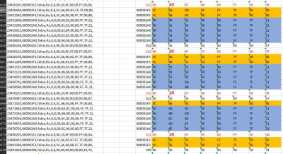

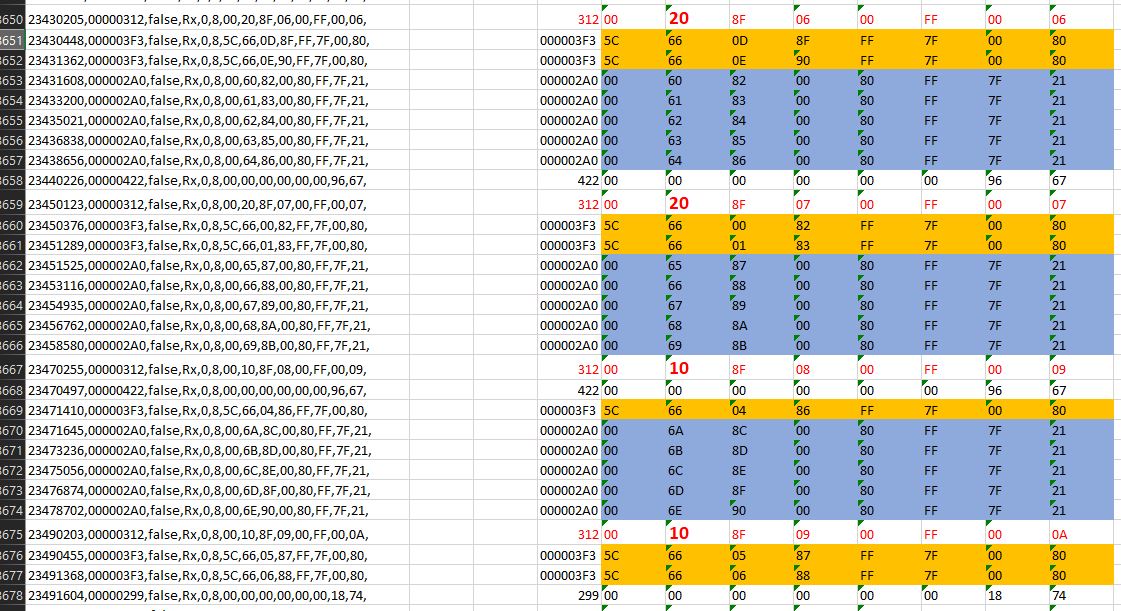

Hello. I looked at the logs from tom91 for Gen1. I don't understand. How does ID 312 turn 0x20 (locked) into 0x10 (unlock)? What command blocks the knob? If you look at Gen2 ID 02C there are two command 0x00 and 0x40 (D3). But they don't work for Gun1

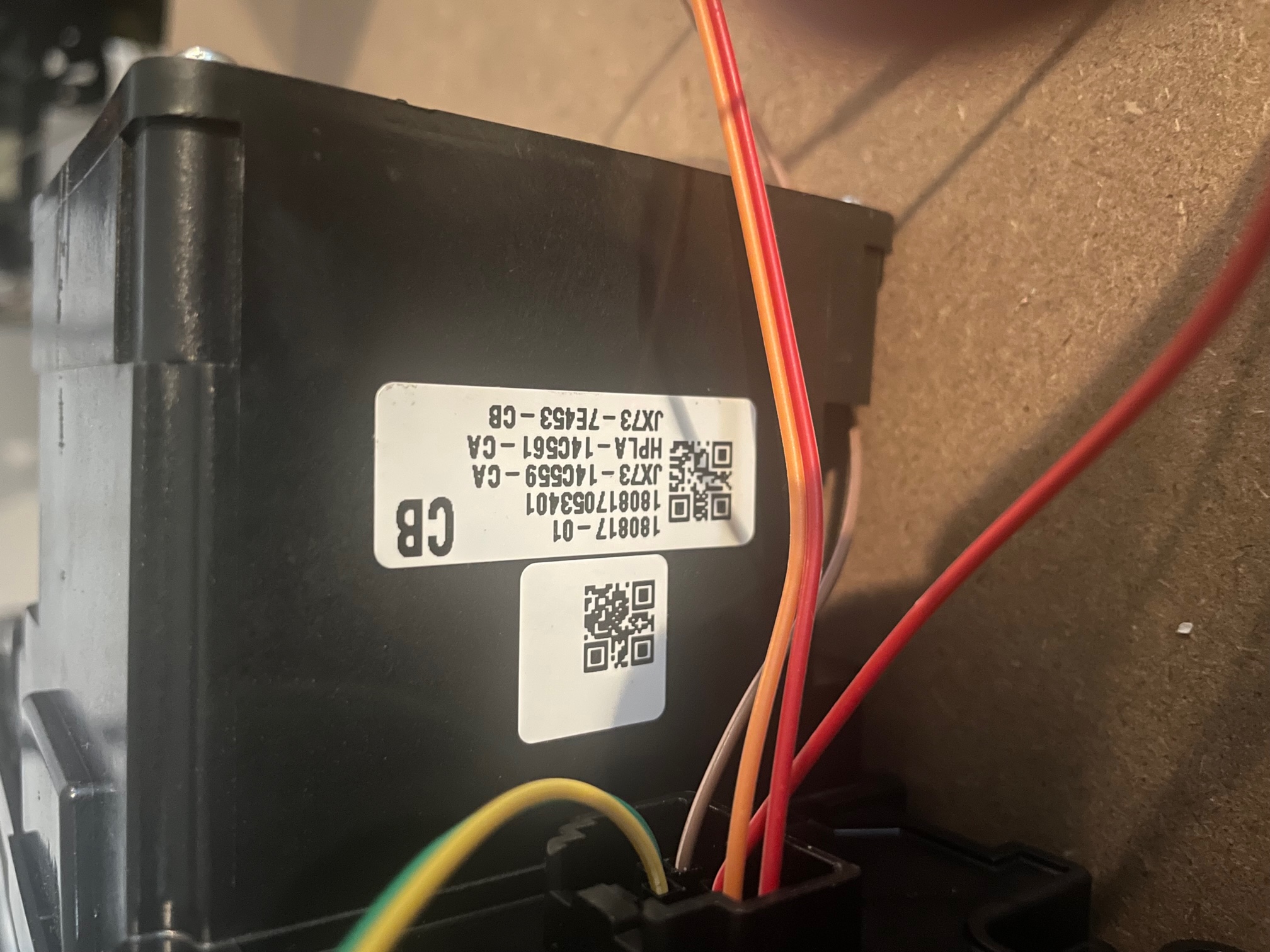

I just bought this selector jlr gj32-7e453-ab. When I power it up on the bench, with just the kvaser on its canbus, it starts streaming just one message on the ID 0x1F0
0- 20
1- 00
2- 00
3 and 4 its a cyclic message, looks like some kind of check sum
5- 00
6- 00
7- 40
I just looked at the github projects and couldn't find any log that looks like it. Does anybody knows if the canbus payload can change if the selector came out of a Jaguar or Land Rover?
