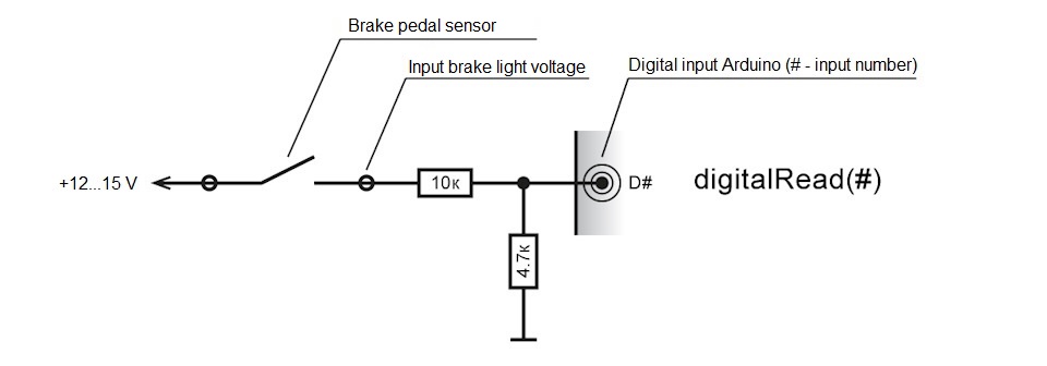

Now the knob rotates freely. But in the car, it is locked and only when the brake pedal is pressed does the knob unlock. How to implement it? What data needs to be sent to the CAN bus?

Re: can id´s 4 Gear Selector
Wouldn't be too hard to implement. We know what canbus is used to lock or unlock the knob, you could run the brake light voltage through a relay (So you don't send 12v into an arduino pin)to act as a signal for the arduino. When the brake light is on, send the canbus messages to unlock.

Hello. If anyone needs a modified GEN1 code to connect the relay to the module buttons. Also added module highlighting. But I can’t find what data I need to send to the Can bus to block the knob in the P and R positions. And how to track when the ignition is off and the knob is down (I need this to restart the arduino)?
