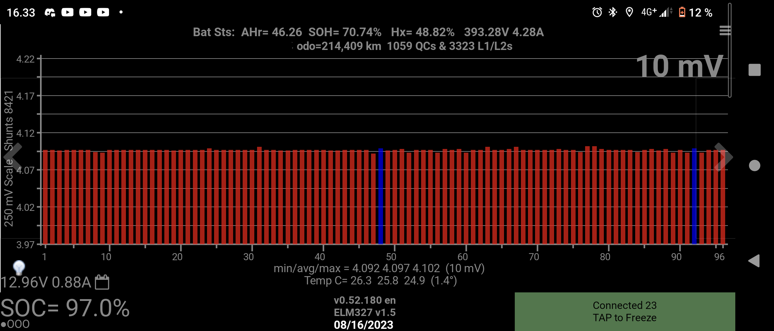

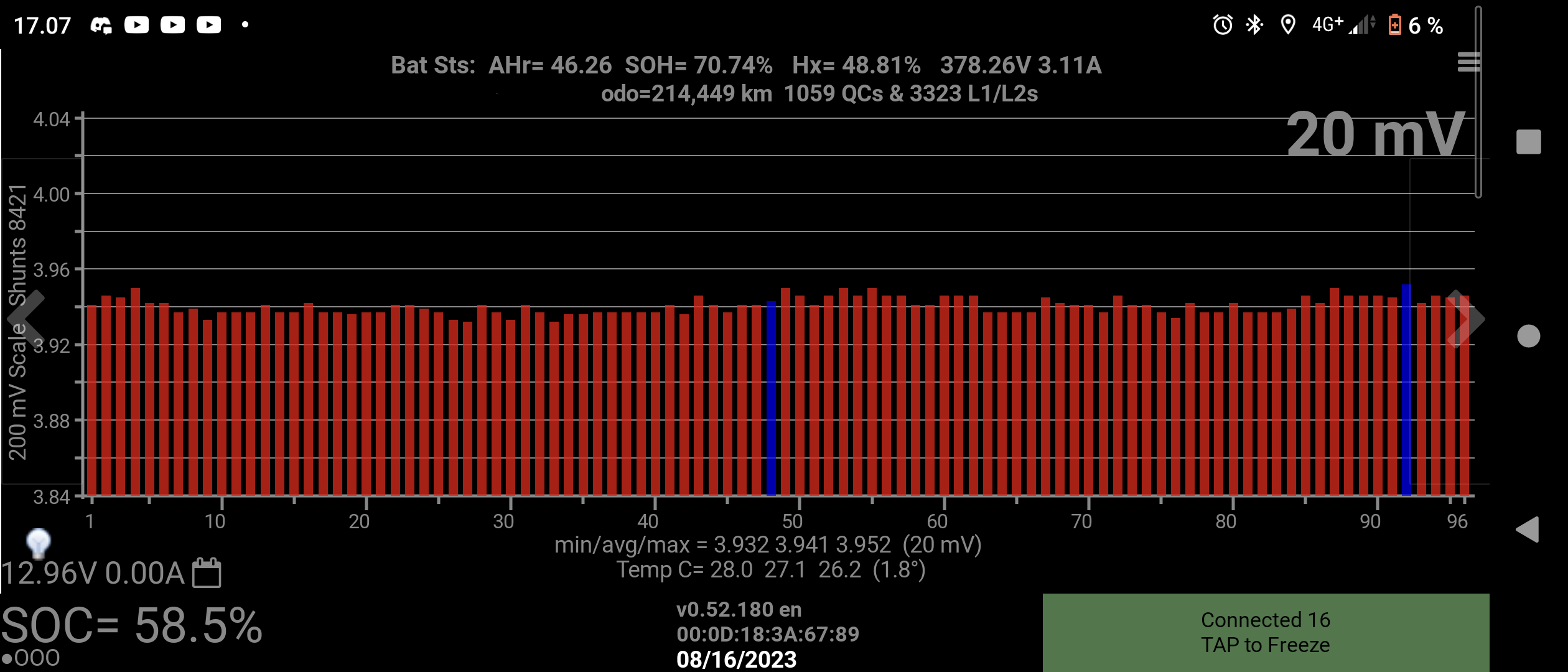

Her you see how much in 40km driving on highway the cell voltages vary on OEM 2014 Leaf. The BMS balances them when charged. When the battery gets more empty the differences are larger. E: This 40km took 6,32kWh

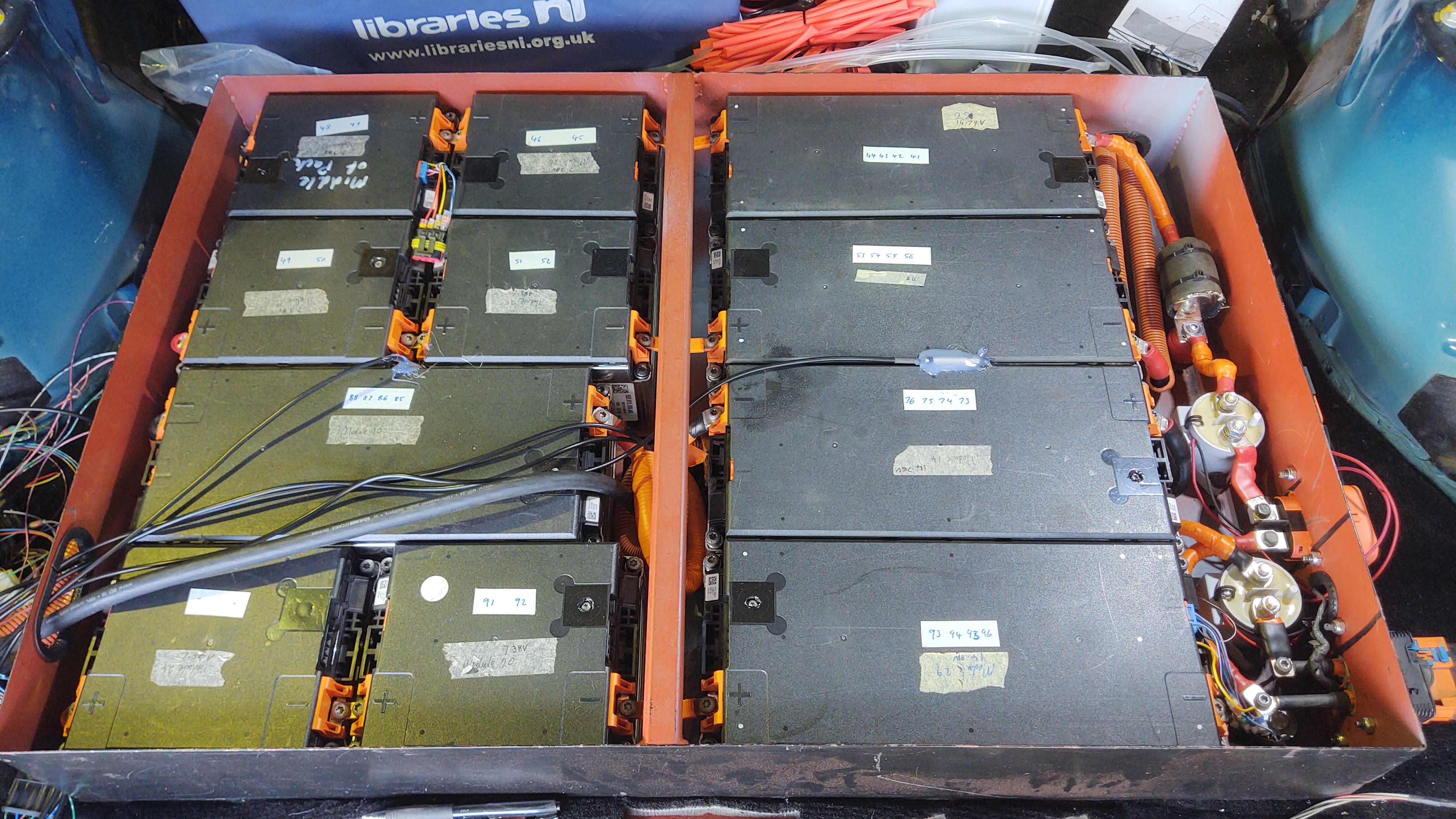

This is the rear pack pretty much complete now
Cell 48 is the top left module so not a suitable place to mount the disconnect as there would still be voltage on the cable albeit a small voltage.

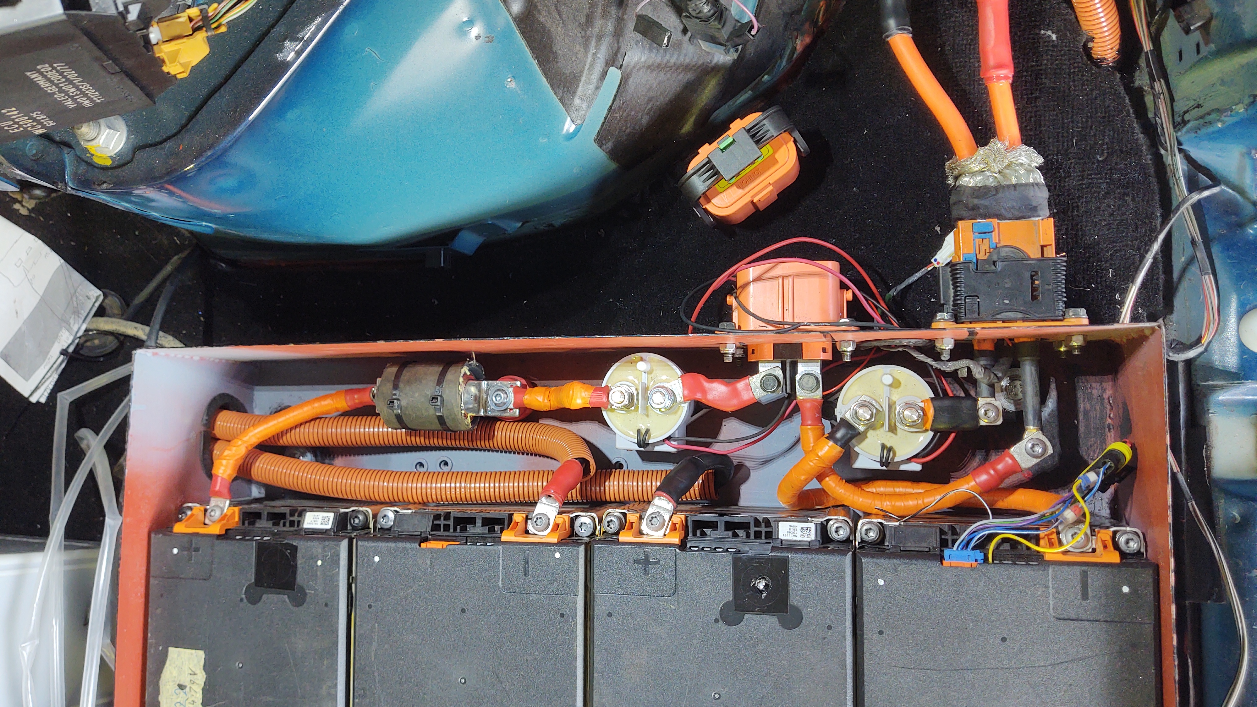

This is a closeup of the contactors etc.
It may be overkill using a manual disconnect alongside a contactor but I figured it would do no harm.
