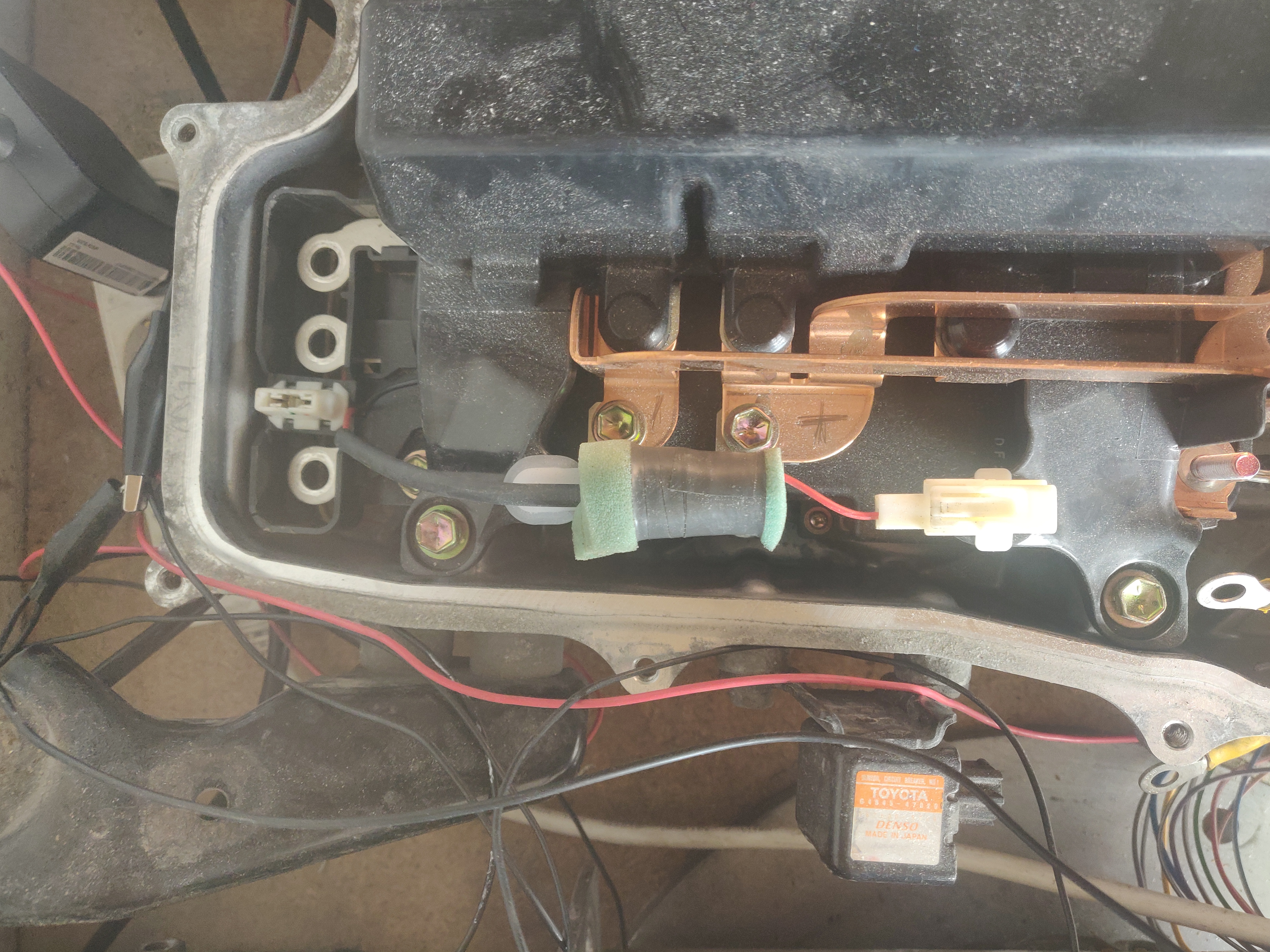

I tried with the MG1 motor, didn't get any voltage to the MG2 output. Here are some pictures of my setup, 3 lead acid batteries in series with a 230v lightbulb that never lights up, but I could read 36v at the rails, slowly declining when batteries are disconnect so I would guess that capacitors was charged.
Forgot to mention that I did put something in the safety thing for the lid, so it's not that.

After writing my last post, it does sound like the lid switch is the issue. I took a closer look at it. 2 cables goes from it, red and black, and the red one goes to a connector that is not connected to anything. The first picture is a screenshot from a video from Damien Maguire, the second picture is my inverter. Should this red wire have + LW or + HW? I would guess LW (12v) but I am not sure, the black cable goes down and is hard to follow without taking stuff apart.

The lid switch is optional. When the lid is closed it just connects the case GND to the red wire. So if you expect to get GND from the red wire, two preconditions must be met: case grounded and lid switch closed.
Normally while bench testing you don't run anything via this red wire.

Can't really read the values, except Boost is at 1700. Should be 20000-30000

That is true, I changed it to 20000 but no difference.

Good news, everyone, I have spin!
Minimum settings needed for spin or lights from default (version 5.27.R-sine) are the following:
0 boost 20000
15 dirmode DefaultForward
85 fslipspnt 1
86 ampnom 70
There was an issue with low voltage (12v) supply to the inverter for me, when I fixed it the power draw went up to 1,2A for the inverter and Openinverter PCB together.
But still the lights wouldn't light up, once I changed dirmode to DefaultForward I could hear noise from the inverter, first real life sign it has made for me, then I knew I was getting close. The "high voltage" (12v feed) was 1v at the rails, so I put a 5A fuse in parallel with the 230v lightbulb, then I got lights blinking.
When it tried the MG1 motor the 5A fuse blew, but with a 25A fuse everything worked great, had to increase the fslipspnt to 10 to get smooth rotation of MG1, MG2 doesn't want to rotate because of the parking break I would guess.
Thanks for the input from everyone who posted on my thread, it would have been even harder without help.
I hope this helps someone else trying to get their first spin.
0 boost 20000
85 fslipspnt 1
86 ampnom 70
