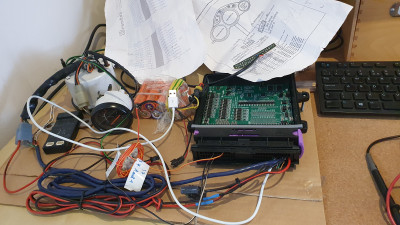

Better a small update than none:
Have wired up the ISA current sensor & resistor, but still need to take the board out to replace R97 & solder jumper connectors for the CAN termination.
untested code:

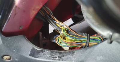

Well, that was one evening mostly wasted:
[*] RF600 wiring colours don't match with the RF400... At least the connector pinout seems to be the same
[*] probably busted the temp gauge with 12V applied...
[*] couldn't get the RPM gauge to move with function generator of my hobby charger. Probably have to take it out to bench test with the iPDM56.
[*] labelled the wires for some of the idiot lights at least
Also ordered a second 56pin connector that I can keep wired in the bike as I add features on the bench. I think I found a location last weekend with some CAD, will make a compartment.

My another strugle with the board is, I am able to get the program running on it and it seems to work fine, but only if usb cable is connected. So it looks like it is not getting powered with 12V. The sample program even reports the Vin voltage, so it is powered. I have even wired all +12V's and all GND's, but not getting the board powered. I am likely missing something fundamental.

post a picture of your setup

Here it comes. If only red (+12V) and black (gnd) at my fingers are connected, shouldn’t the unit wake up and led glow?

raine wrote: Tue Jul 25, 2023 3:17 pmIf only red (+12V) and black (gnd) at my fingers are connected, shouldn’t the unit wake up and led glow?
In a word yes. Double check the wiring and you should also be able to do continuity checks by following the circuits on the board back from the 12v + and - pins to the various components. Starting with where the pins are soldered to the board.

Once you feed 12V (8V to 16V) to those pins, the white LED should light up, and code should run.
What does happen when you do it?
The regulator U4 near those pins is a good place to start probing with a voltage meter. The ISP header has the AVR's 5V exposed so that's also a starting point (or more like the ending point).
Let me know if the schematic and layout images here leave something to be desired: https://github.com/celeron55/ipdm56/tre ... /ipdmhw1.1

Luckily I have a second unit at hand and after soldering the connector to it, I plugged in the connector of the first unit to it for test. And yes, it works. Leds illuminate, so the first one was a DoA.
The second unit is working fine and I have managed to get Digital outputs (logic level, lout, hout) working like expected. However, I am still struggling with aouts and lpwms. I didnt succeed with the sample code for usage of the pwm. So if something to wish, is bit more howto use examples for those please.
But positive progress. I am sure, will get it fully working afterall.
