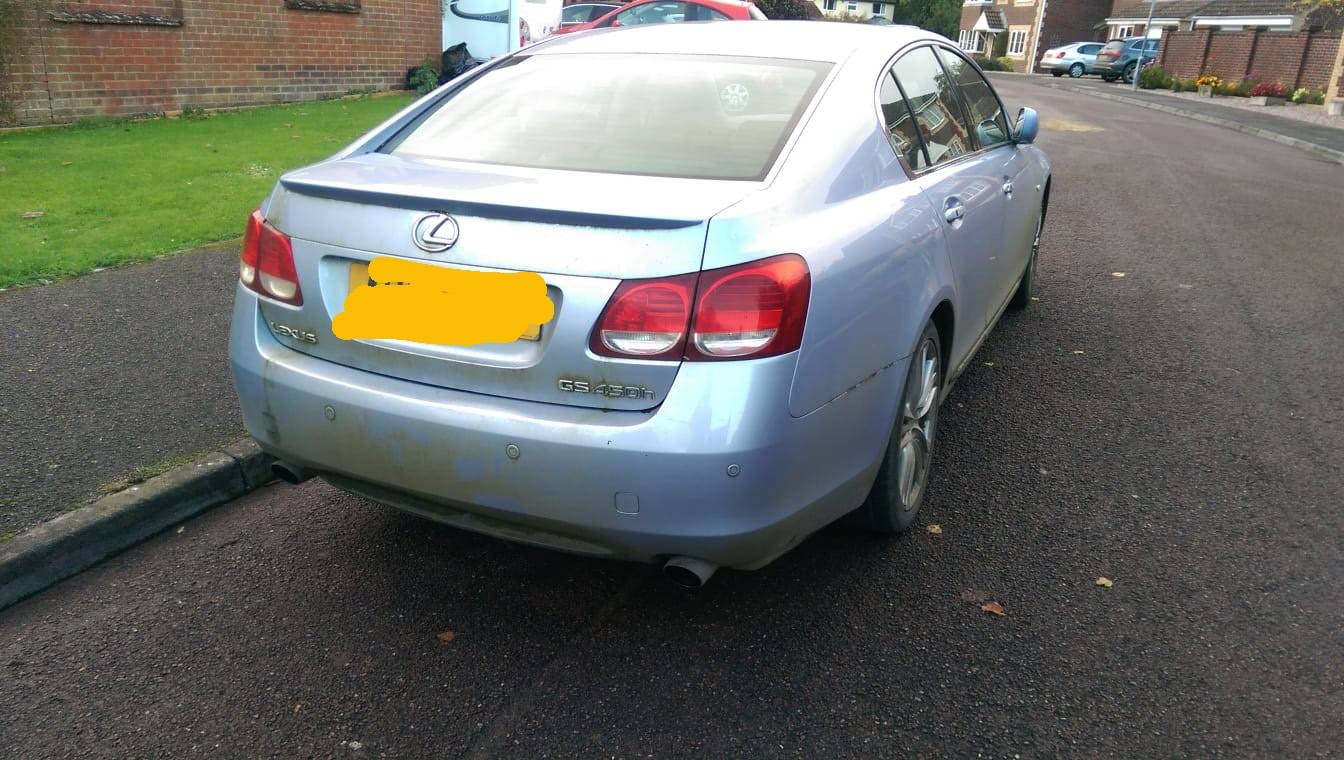

Re: how are Lexus/Toyota using torque in their application with the 2GR petrol engine
This Lexus cost us £500 and the ICE, Exhaust, CATs, and fuel tank are worth £2000. With 250kW CCS rapid charging and >60kWh battery it will make a very simple and capable EV that can be converted in a few days

Damien is road testing BEXUS at ~480V
