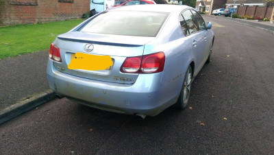

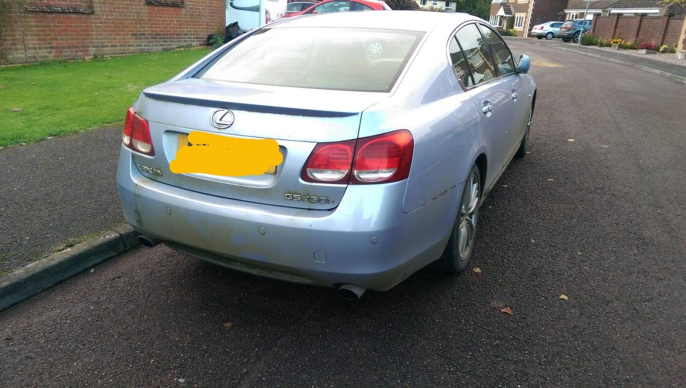

Swing wrote: Mon Jan 27, 2020 9:10 pm One where you chuck out the engine, saving 200KG and some space, good for placing batteries. Convert it to full EV with help of the board as discussed in this topic.
This Lexus cost us £500 and the ICE, Exhaust, CATs, and fuel tank are worth £2000. With 250kW CCS rapid charging and >60kWh battery it will make a very simple and capable EV that can be converted in a few days :)

Kevin Sharpe wrote: Mon Jan 27, 2020 10:15 pm
Yes although I think it will be unrealistic to assume 500 quid as market value. If have seen them here for 5000 euro with broken battery light, left hand drive. Maybe someone will come by cheaper if you have time. Still, it is a lot of hardware for little money.
So that is plan A, where you spend some money on a nice battery pack. But all in all, it is pretty easy given that you can buy the developed board for this and just make some adjustments based on your battery pack.
