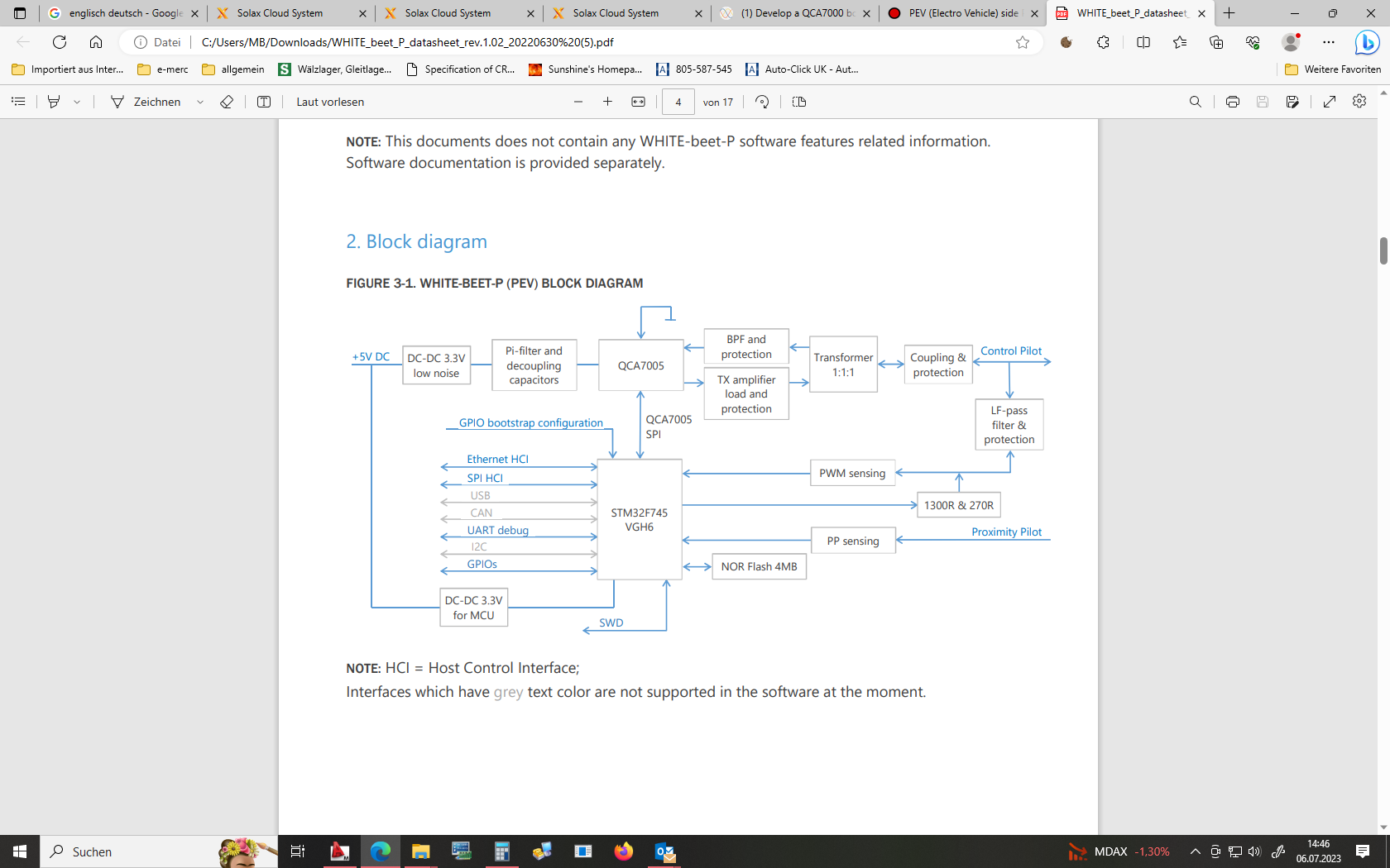

This module is my favourite, but regardless of that, there is a suggestion for the power supply and the transformer in the documentation.
8devices_carrier_board_ep_datasheet_rev.1.04_20201211_564076_10.pdf
- (550.86 KiB) Downloaded 394 times
RED_beet_1.1_datasheet_rev.1.20_20220922 (2).pdf
- (1.18 MiB) Downloaded 362 times

8Devices does the same thing with the two 3.3V regulators on their WhiteBeet

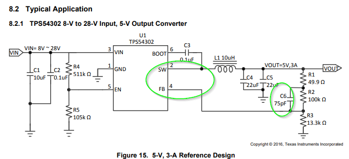

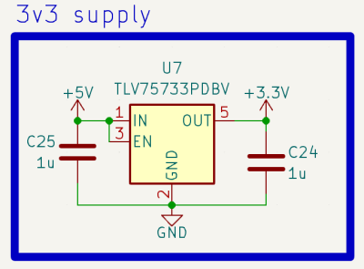

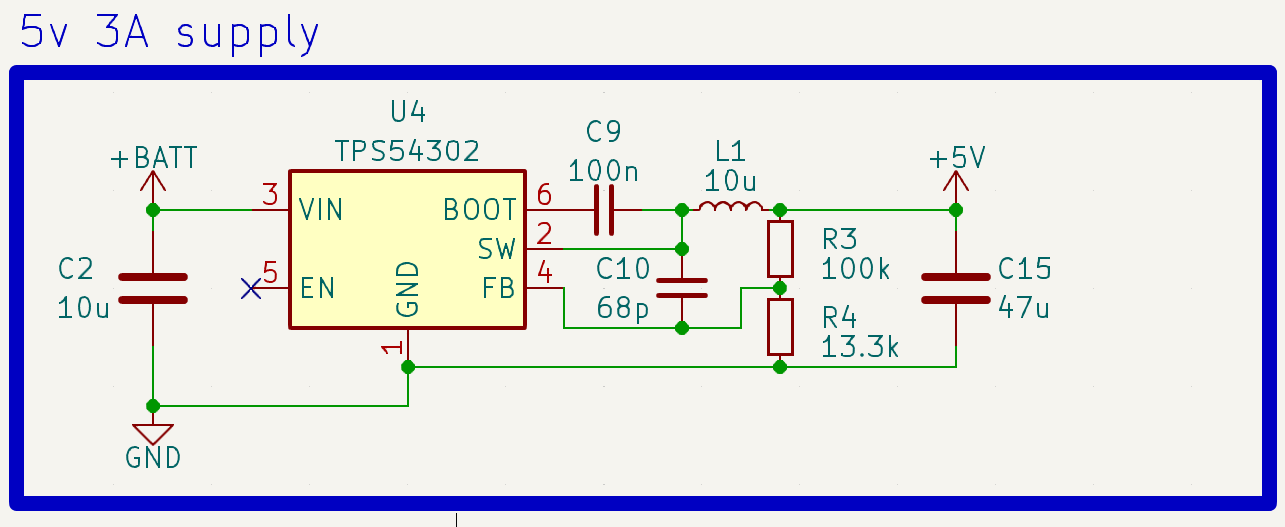

I'd encourage you to ave a look at the design I use (attached).
JLC parts:
* C311983 (TPS54302)
* C408412 (Inductor)
In this case I was running it at 5V with a TLV75733PDBV linear regulator because I needed both rails, and I often prefer to do this anyway in RF applications, but it's easy to reduce the voltage to 3v3.
This TPS54302 supports up to 28V input (30v absolute maximum).

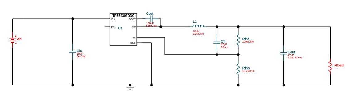

Is the 68pF intended to be on the switched output? The data sheet says, it should be after the L:
- catphish
- Posts: 959
- Location: Dorset, UK
- Has thanked: 96 times
- Been thanked: 188 times
Re: Develop a QCA7000 board?
You're absolutely correct
See attached the generated example from TI PowerDesigner with the correct design.
Looks like I only build one board with this error and fortunately it wasn't for a customer!

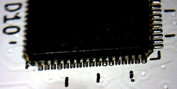

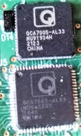

The QCAs arrived. Thanks @projectgus for finding a reasonable priced source and organizing the shipping.
Although there is a small risk that they ship the wrong parts, everything went well. At least from outside they look original to me. The lower one is the original in the Ioniq CCM, the upper is the freshly arrived.

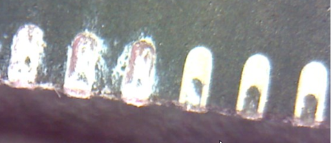

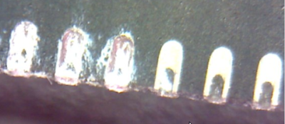

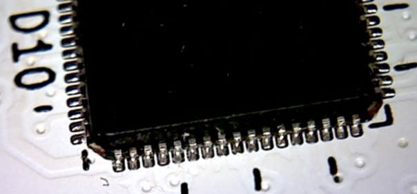

And later a clear fail:
This is how the "pins" look like. Left tinned, right untinned:
... and some rework ... and finally:
One surprise was, that the "pins" of the QCA do not like so much to be tinned. It needs an amount of flux and patience, and a hot iron, that they get tinned. I pre-tinned them before placing on the board, because I did not trust my soldering process.This is how the "pins" look like. Left tinned, right untinned:

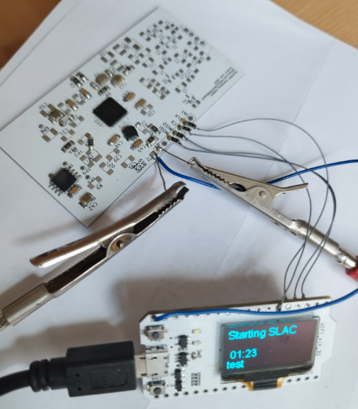

I never did this before, and was quite insecure whether I have a chance to do this. But after watching some videos I understood it is easier then expected, when knowing the tricks. Flux is the key. And pre-heating the board to 100°C. And then hot air, and the part will float by itself to the correct position. Really amazing to watch. Ok, my first attempt went wrong, but nothing broken, just again flux, preheating, hot air, tip from the side, and it exactly jumped in the correct position. The next time will be faster I guess.
Ahh, and the 7005 is no real QFN, it is QFN with "wettable edges", this means we can inspect the solder connections. The real QFN is harder I guess, because you see nothing.
Yes, exactly. The SPI, the interrupt pin (which maybe is not necessary) and the reset, and some test points to be able to program the Flash.
Something is wrong with this ugly board: No smoke up to now. It just talks to the ccs32berta. This went a little bit too smooth.

Glad you got these OK, and powered up already! Good flux is extremely helpful, especially with these low volume parts sales that are often so-called 散新 "loose new" (ie production run leftovers). If they've been sitting around and not stored well, they can have a thin layer of oxidation on the pads that needs fluxing off.
If you're keen to do more QFN and you already have hot air, then I'd suggest looking into solder paste and stencils. At this point I'd much rather build a single board with QFN and quality fresh solder paste than a single through-hole board!
