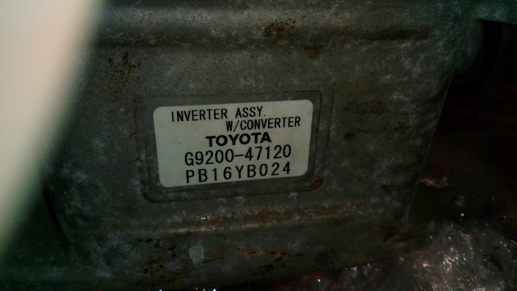

Alexstarex wrote: Sat Jan 25, 2020 10:45 pmin the picture is 1st generation. Need an inverter 2 generation
Hmm. It matches my picture of a Gen 2, not a Gen 1. But I'm far from knowledgeable about all models sold and what years:
