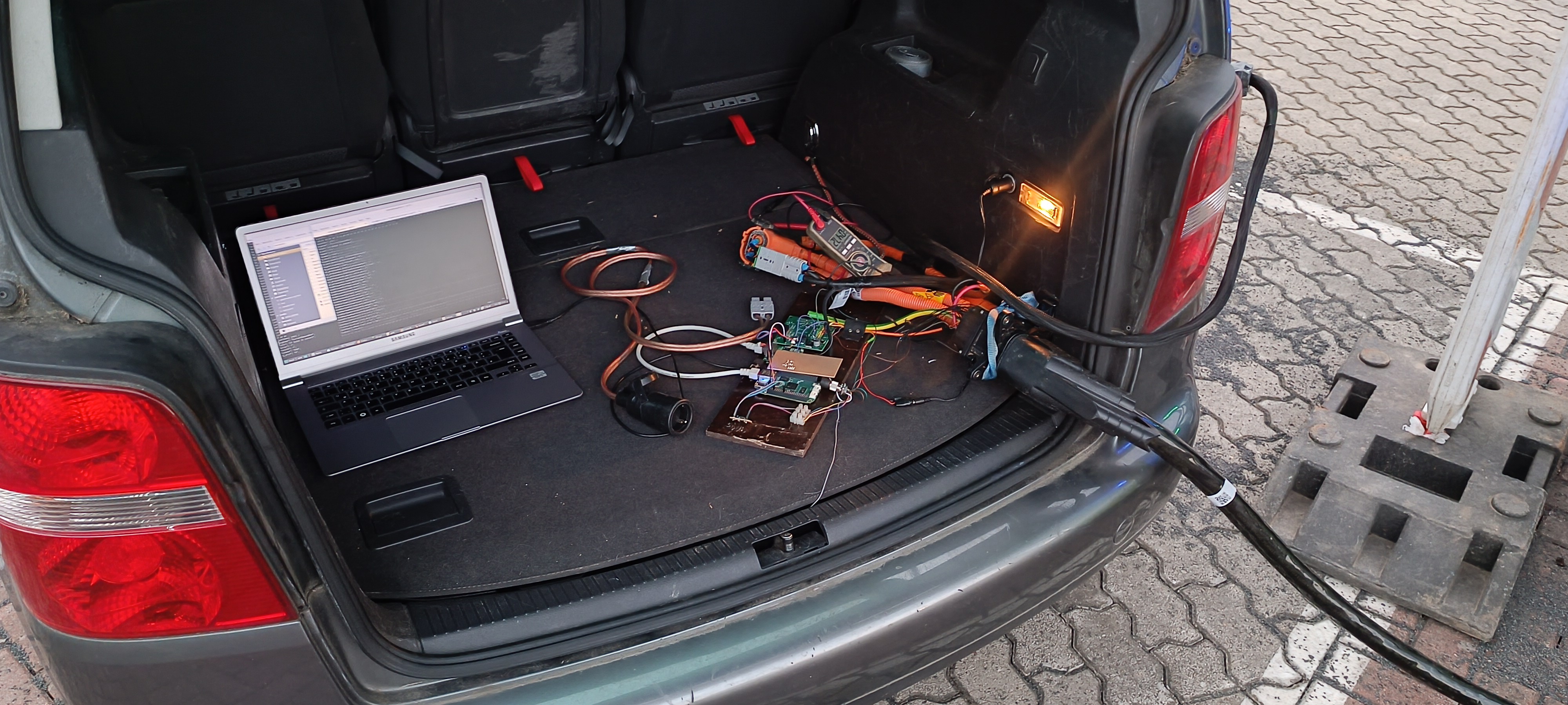

Did another session at the Compleo charger with the latest commit and now and nicely charged at its maximum of 66A (per my clamp meter) and 24.2 kW per charger display. Video coming.
Latest idea is to temporarily rig up the CCS set in Audi for transporting it the 400 km over to its owner. Should be fun

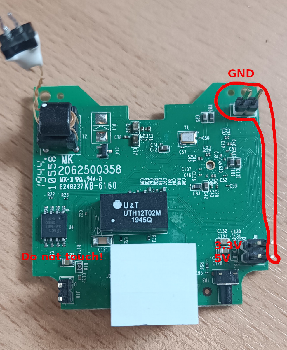

Just learned some lessons.
Got a new set of two adapters. Plugged some both in to confirm they power up and measured the voltages on the power supply pins.
Then snipped off the power supply and supplied the two pins to the left of the RJ45 port with 3.3V as I had measured. Nothing happened. So moved over to the set of 4 pins and supplied 3.3V to the one as marked. Current draw but no LED light up. Also supplied 5V to the pin where I'd measured 10V but that didn't change anything.
It seems the two pins to the right are feedback pins to the power supply. I must have shot something when I supplied voltage there. Indeed on the second board when I power the set of four with 3.3V I see 3.15V on the two pins on the left.
The previous board was structured differently, taking 3.3V on the left two pins and 5V on the set of 4.
Then went to upgrading and patching. I though lets just use pev.pib from last time but then found it also contains the devices MAC address. No problem, just patched the one read earlier and all is good now.

I could not believe, but yes: Even if the boards look very similar, there are different pinnings of the "connectors". Just confirmed with two of my setups here. Very dangerous. So the conclusions are: Always first measure, before cutting too much. And maybe it is easier to keep the PCBs together, to include the 3.3V regulator. In my setups I supply only 5V, and the 3.3 is generated with the original circuit.

Rigged up a CCS port in Audi, it will be handy when we bring the car over to its owner, 400 km away. Not fun with 100 km range and 4 kW AC charging.
Wasn't too successful, CableCheck fails. Probably because in my infinite wisdom I found one charge port relay on the positive is sufficient. Of course there is some leakage between GND and B- (measures udc/2) and the charger seems unhappy about it.

That's at least a good test for the safe shutdown sequence
Happy second-contactor-installation
