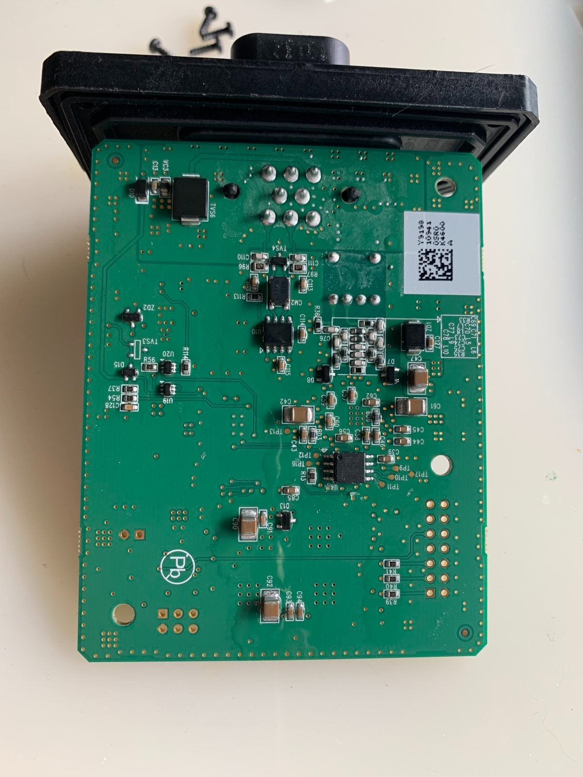

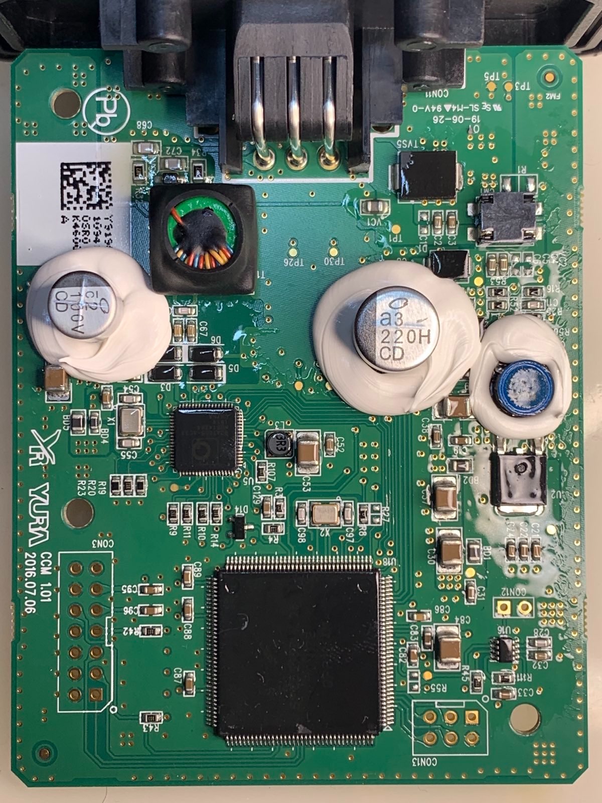

Some progress with the Ioniqs CCM donated by @larsrengersen (thanks again): Reading the controllers memory worked. Also tracing the SPI between the controller and the QCA7005 was successful. This basically opens three different ways to re-use the CCM:
1. Keep it in original state, and just feed the appropriate CAN message to it. Still some investigations necessary to understand the handshake.
2. Hold the original controller in reset, and connect an other controller (ESP32, stm32, RaspberryPi, ...) to the SPI. The driver for the QCA is already included in Linux, so it is easy to just configure a Raspberry to drive the QCA via SPI, this creates a virtual eth1, and use pyPLC configured to this eth1.
3. Develop a new software for the original controller. Would be a quite long way, but would keep the original hardware and would offer full flexibility. If there would be an open-source development environment and some basic examples for this controller (for CAN and SPI), this way looks possible.
Stored the current results here: https://github.com/uhi22/Ioniq28Investigations

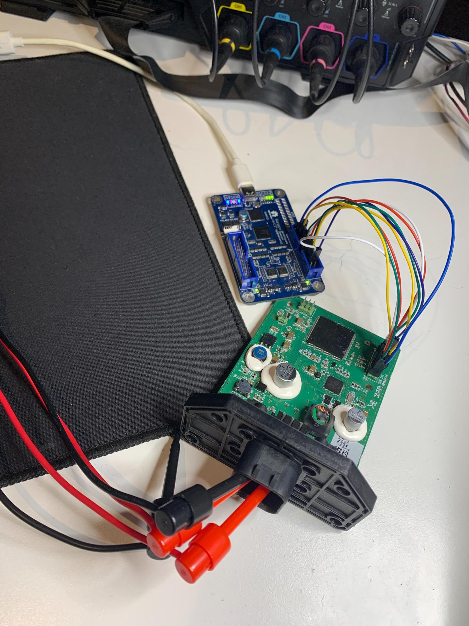

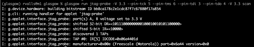

Hi uhi22, I'm projectgus' friend, helping him out with his FrakenKona
I also got a CCM to muck around a couple of days ago from another EV club friend and got to the point of having a Glasgow board talking with bitbang'd JTAG against OpenOCD. I've written up a few (not all) details from my setup here:
https://gist.github.com/brainstorm/ab2f ... d1a32a20ad
Unfortunately OpenOCD has some troubled and incomplete e200 support:
https://sourceforge.net/p/openocd/mailm ... nlr.menet/
May I ask how you managed to dump the contents of the main FreeScale SPC5606 IC? Like Mike Electric Stuff, I dumped the SPI flash 8 pin IC only to find the QCA drivers there, but not much application payload.
Cheers!

Luckily we used the same controller family 10 years ago in a professional project, and the "blue box" debugger from ISystems was still flying around. The connector matches directly, so it was just plug &play
Would be interesting to know whether there is a working open-source solution for at least flashing, in best case also for debugging ...

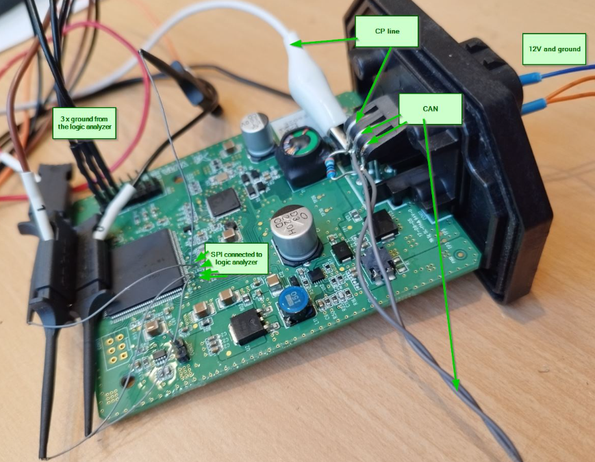

The toolchain for decoding the SPI traffic between the SPC5605 and the QCA7005 is working now.
- SPI is traced by Saleae logic analyzer, and exported as text file.
- The text file is converted to a pcap, using https://github.com/uhi22/Ioniq28Investi ... 1886e4a915
- The pcap can be converted to see the content of the V2G/EXI messages, using https://github.com/uhi22/pyPLC/blob/mas ... nverter.py
- Finally the result can be shown as osci plot, using https://github.com/uhi22/pyPLC/blob/master/scope.py

Installed the CCM from Lars in my Ioniq and drove to a public charger to see whether this works. Results:
- Charging works. (Ok, not a really surprise. Both CCMs have the same part number.)
- SPI trace of a complete charging session recorded and decoded, results here: https://github.com/uhi22/Ioniq28Investi ... i-analysis

To summarize the current status:
- From the CAN traces, created a (still weak) understanding how the CCM is talking with the rest of the car during a charging session. https://github.com/uhi22/Ioniq28Investi ... ng-session This needs to be refined to be useful. My conclusion for the moment is: The CCM is not really suited to play as a charge controller for not-Hyundai projects. Because it does no CP handling, no connector lock, no charge port temperature measurement. It is just a CAN to PLC bridge.
- The CCM helped a lot to understand the design of the QCA7005 together with its power supply, flash, microcontroller communication.
- Based on the gained knowledge, there is a way open to make an open-source implementation using ESP32 and QCA7005. The CCM works well for such a development (while it's original host controller is just hold in reset, so it does not disturb). https://github.com/uhi22/ccs32berta
