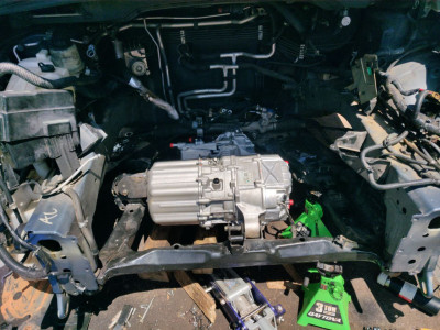

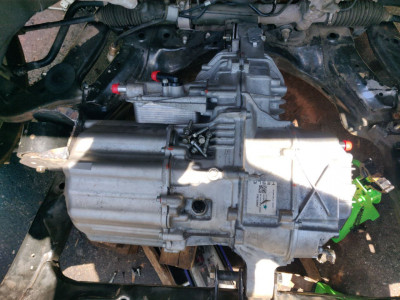

Do you remember what size and specs were the 3 bolts holding the mounting bracket for the heavy side o the SDU motor? everything I have at home seems to get stuck after few turns.

Standard M8 if you mean the rear SDU's 'ear'.
Since it's alloy sometimes cleaning the threads helps with the correct taper offcourse.
Before you do make sure we talk about the same holes.

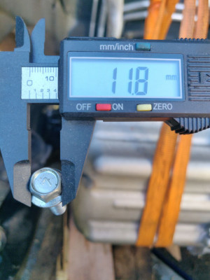

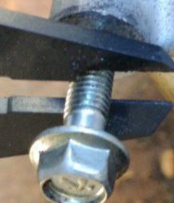

It looks like M7? I tried with 12 mm Wrench and it seems to go in. I just did not want to strip the threads.

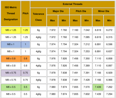

Referring to an external thread chart, here's a list of various M8 thread pitches and diameters for M8 bolts:
It appears that the bolt you are measuring has a minor dia. of 7.5mm, which corresponds to a M8 x 0.5 bolt thread (extra fine). Around here, that's an uncommon pitch.
The most common M8 pitch I encounter (~80%) are M8 x 1.25 (coarse), and maybe 15-20% are the next finer pitch, M8 x 1.0 .

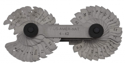

A thread pitch gauge is an invaluable and inexpensive tool. While I use mine maybe 3x/year, when you need one, it saves a lot of time. The one pictured below runs USD$10 via Amazon:
Better quality ones run about twice that, but you can generally make do with a cheap set. My set are small enough to fit in an M8 tapped hole.

The chart and measurement don't match because the minimum diameter is the one of the drill to make the thread.
So the plain shaft so to speak. That's why a finer thread gives a thicker bolt (less thread height).
What's measured on the photo is the external diameter on the threads...

The minor diameter is what is measured at the root of the thread, what you're describing is what is shown on a "tap chart".EV_Builder wrote: ↑Mon May 29, 2023 8:22 pm The chart and measurement don't match because the minimum diameter is the one of the drill to make the thread.
That can't be, because there is no 7.5 mm "OD". Proton must be using the blades at the end of the caliper to measure the minor diameter of the bolt.EV_Builder wrote: ↑Mon May 29, 2023 8:22 pm What's measured on the photo is the external diameter on the threads...

I disagree. With a caliper you can't reach that deep in the thread. The thread is a spiral. Also I'm 90% sure I used standard bolts. Plus M8 means it's 8mm outside . The chart gives the tolerances for all measurements. So M8 should be between 7.9 and 7.7 outside.
By jumping between the flanges you easyly go out by 0.2mm.
If that bolt is the correct one measure 10 threads with the caliper and we know the pitch.

Proton measured 7.5mm "somewhere". If you've measured a bolt, you would know that the blade portion of standard calipers will measure to the bottom of the threads: by turning them slightly from perpendicular to the bolt's axis. This is actually the way this measurement is supposed to be accomplished. Take a look at how Proton has the calipers oriented to the bolt:
Proton is measuring at the root of the threads ("minor diameter"), and has observed 7.5mm .
From the chart I screenshotted, the only place that can be measured on an M8 bolt that is close to 7.5mm is the minor dia. of an M8 x 0.5 -- a fairly rare bolt. Proton's bolt doesn't fit the hole, so that matches the observed reality.
I had said that it's much more likely that the bolt needed is M8 x 1.25 . Quoting myself:
Honestly, I can't follow the rest of what you posted. We agree that it's likely to be M8 x 1.25 . What you are on about otherwise, I'm going to dispense with as some communication fubar that's not worth chasing.

Pretty sure it's a standard M8 coarse bolt - (I replaced mine)
Re: SDU bolt discussion (split from catphishes project thread)
Just checked, it's a normal m8x1.25. Maybe your threads are damaged?

Not sure. I know the pitch is x1.25. The bolts were used on the Nissan motor before I took if off the car. It uses the 12 mm wrench.
