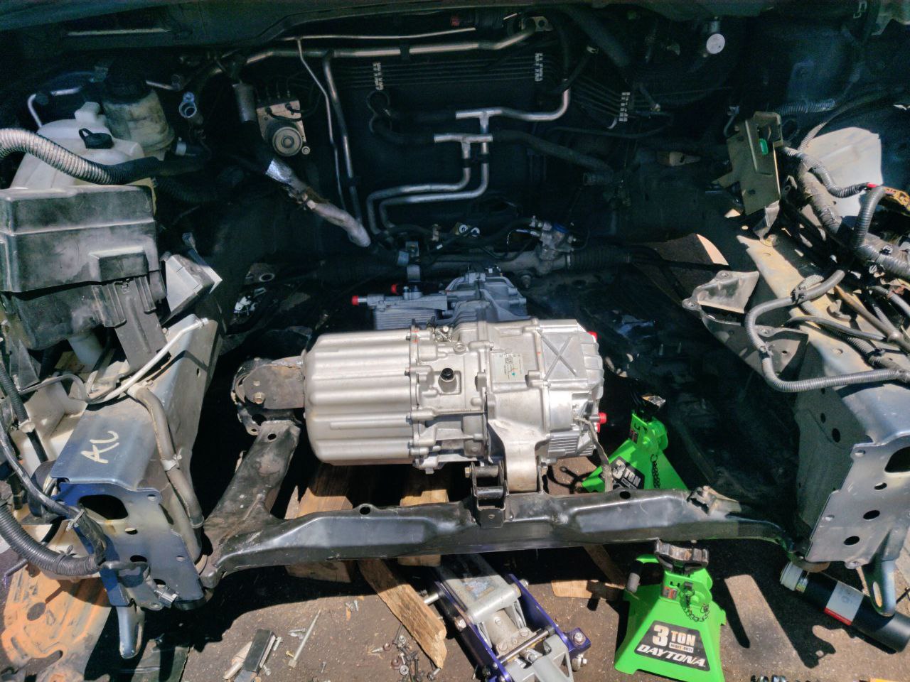

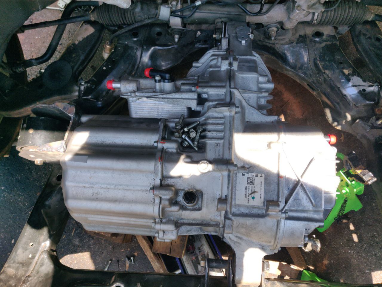

Do you remember what size and specs were the 3 bolts holding the mounting bracket for the heavy side o the SDU motor? everything I have at home seems to get stuck after few turns.

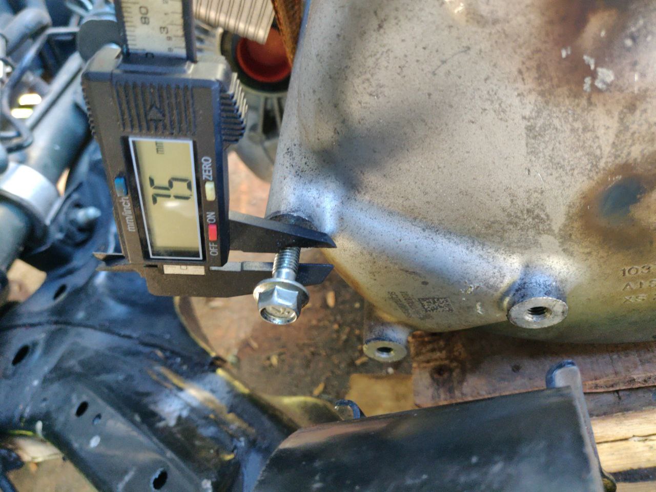

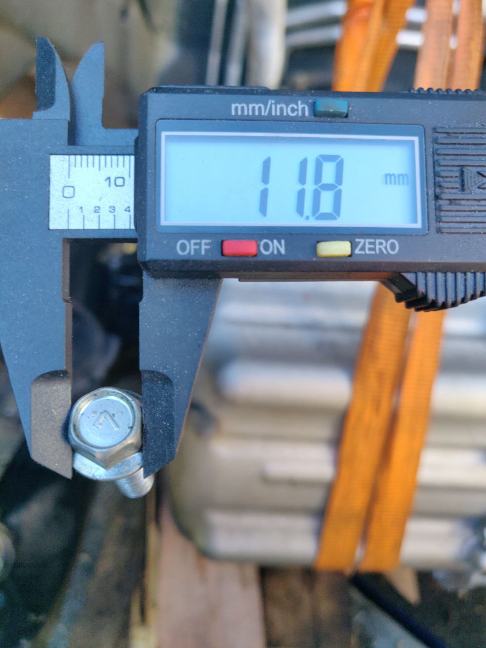

It looks like M7? I tried with 12 mm Wrench and it seems to go in. I just did not want to strip the threads.

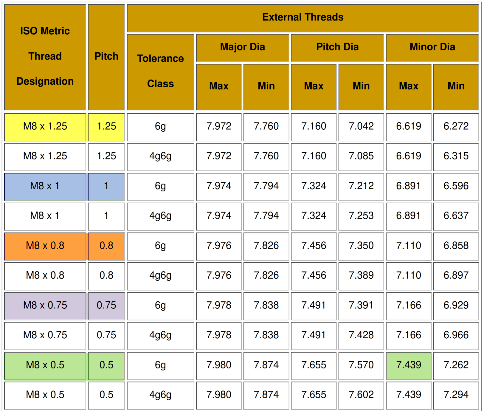

Referring to an external thread chart, here's a list of various M8 thread pitches and diameters for M8 bolts:
Chart of M8 bolt thread pitches and diameters
It appears that the bolt you are measuring has a minor dia. of 7.5mm, which corresponds to a M8 x 0.5 bolt thread (extra fine). Around here, that's an uncommon pitch.
The most common M8 pitch I encounter (~80%) are M8 x 1.25 (coarse), and maybe 15-20% are the next finer pitch, M8 x 1.0 .

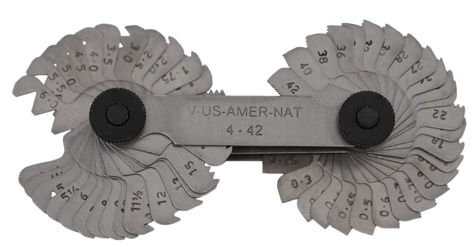

A thread pitch gauge is an invaluable and inexpensive tool. While I use mine maybe 3x/year, when you need one, it saves a lot of time. The one pictured below runs USD$10 via Amazon:
Thread pitch gauge
Thread pitch gauge
Better quality ones run about twice that, but you can generally make do with a cheap set. My set are small enough to fit in an M8 tapped hole.

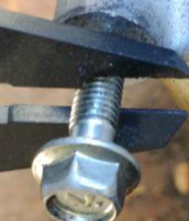

Proton measured 7.5mm "somewhere". If you've measured a bolt, you would know that the blade portion of standard calipers will measure to the bottom of the threads: by turning them slightly from perpendicular to the bolt's axis. This is actually the way this measurement is supposed to be accomplished. Take a look at how Proton has the calipers oriented to the bolt:
Proton is measuring at the root of the threads ("minor diameter"), and has observed 7.5mm .
From the chart I screenshotted, the only place that can be measured on an M8 bolt that is close to 7.5mm is the minor dia. of an M8 x 0.5 -- a fairly rare bolt. Proton's bolt doesn't fit the hole, so that matches the observed reality.

Not sure. I know the pitch is x1.25. The bolts were used on the Nissan motor before I took if off the car. It uses the 12 mm wrench.
