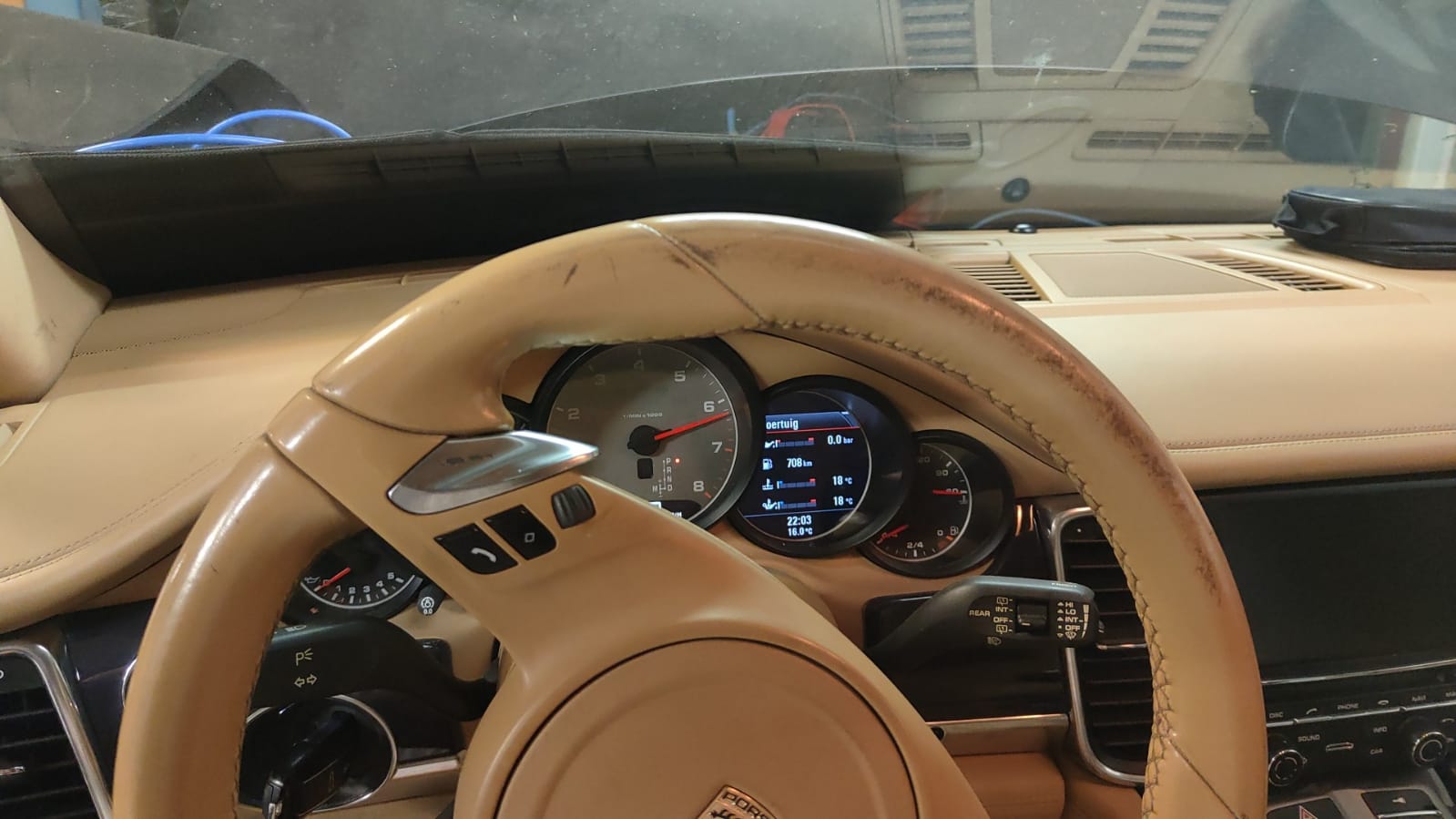

Ok basically in need of any dbc file you have or can find from any Porsche.
Trying to shed some light on the mysteries on my Panamera 970...

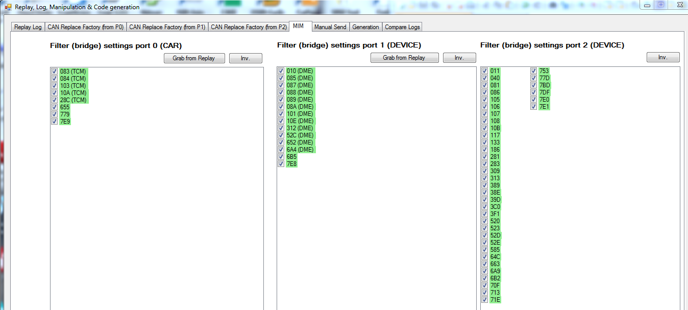

Ok guys! I'm like in maniac mode = on now!
Look at this: I build-ed further on my CANBus suite so now it accepts 3 Adapters (USB peaks) and i can play with stuff.
The ID list you see is coming from that particular interface.
underwater i re-join (or not) the canbusses again by software (forwarding messages).

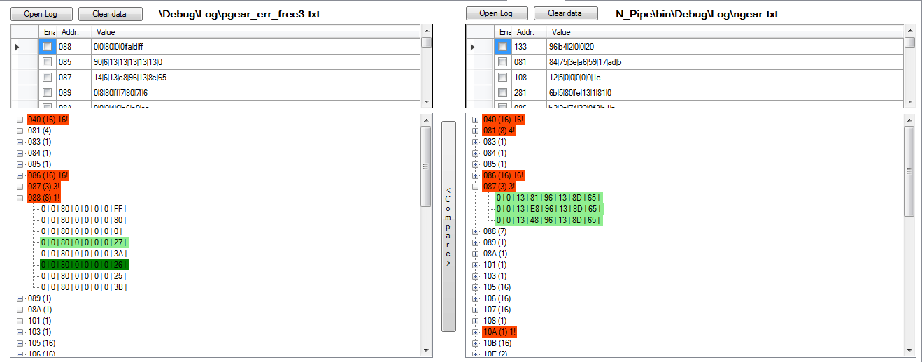

@Damian; I also made a very nice CANBus Log comparer...maybe i pull that part out one day and release it to the open...
! = Unique value in this side
RED = Different then other side
