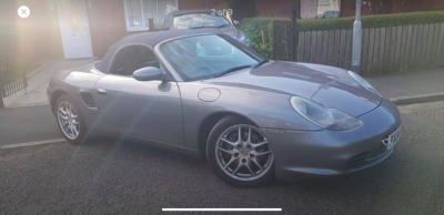

Zero EV (here) have announced a Porsche Boxster build that they will document as a four part mini series on their YouTube channel (here).
The build will use their commercial version of the open source inverter controller developed by Damien and Johannes. They will also use the Tesla 11kW Charger, Tesla DCDC, and a 36kWh Tesla battery from the Smart 8-)
They have also announced that a bolt in kit for the 911, 930/964, and 993 is in development.

Project coming along nicely. All the bits out last episode now new bits going in.
Battery box, a Mercedes B class pack stacked in 6 above 6, giving 36kWh and a rear small Tesla motor get installed.
Also fitted a vacuum pump and charging socket.
Currently chasing down the wiring, luckily there is already an Electronic pedal in there to reuse.
The gauges will be kept and driven from a Teensy to make them work to display power instead of RPM and SOC instead of fuel level.

Quite some more work done on the car. She is back on her wheels ready to be 12V wired up.
