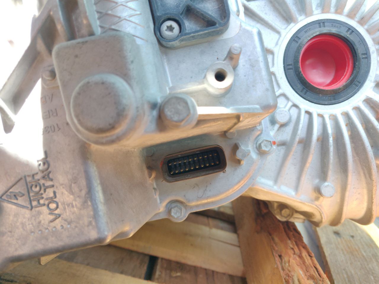

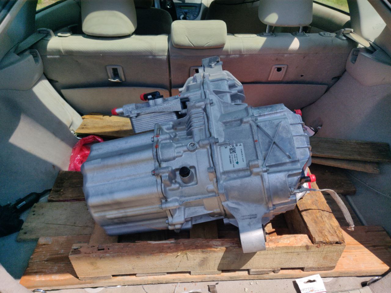

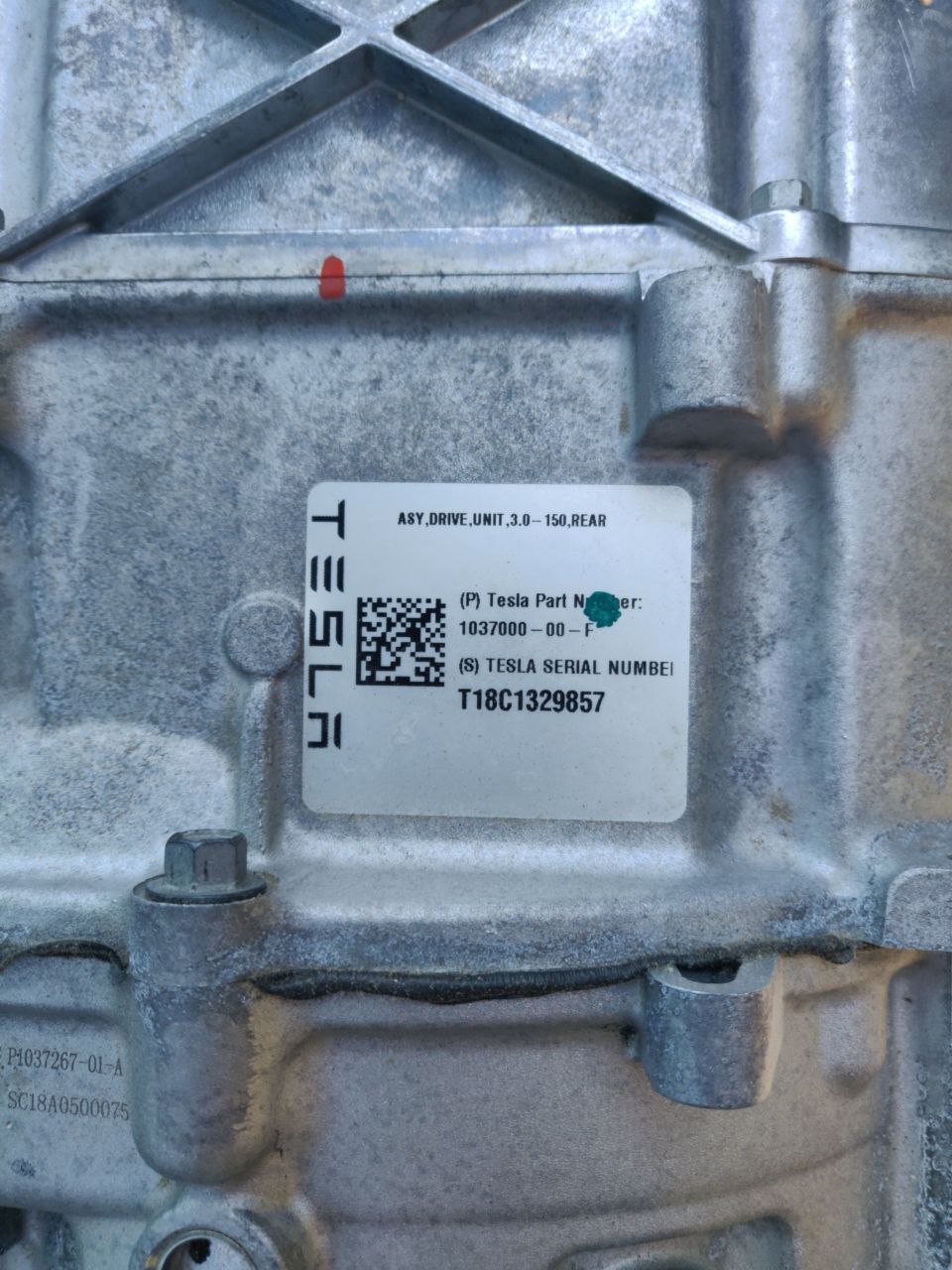

I bought a Small rear drive unit for Tesla with $1150 on e-bay. is this the right board to order?
https://openinverter.org/shop/index.php ... duct_id=62
It has no connectors. SO now I have to figure out parts I need to test the motor and the board.
- Posts: 6743
- Has thanked: 380 times
- Been thanked: 1564 times
Re: Should I buy an OpenSource Board?
Yes that's the right one.Proton wrote: ↑Mon May 08, 2023 5:44 pm I bought a Small rear drive unit for Tesla with $1150 on e-bay. is this the right board to order?
Connector info here: https://openinverter.org/wiki/Tesla_Mod ... %22SDU%22)

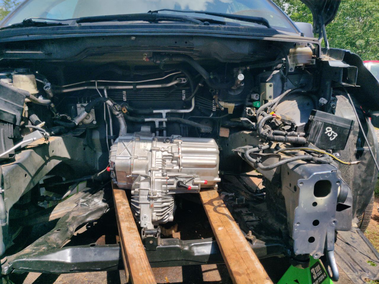

Johu, is this board working with the small front unit from Tesla S/? I tried fitting the SDU facing forward but the angle is too steep. Modifying the oil pump looks a complicated process, so I started looking at a front motor from TeslaS/Xjohu wrote: ↑Mon May 08, 2023 5:52 pm Yes that's the right one.
