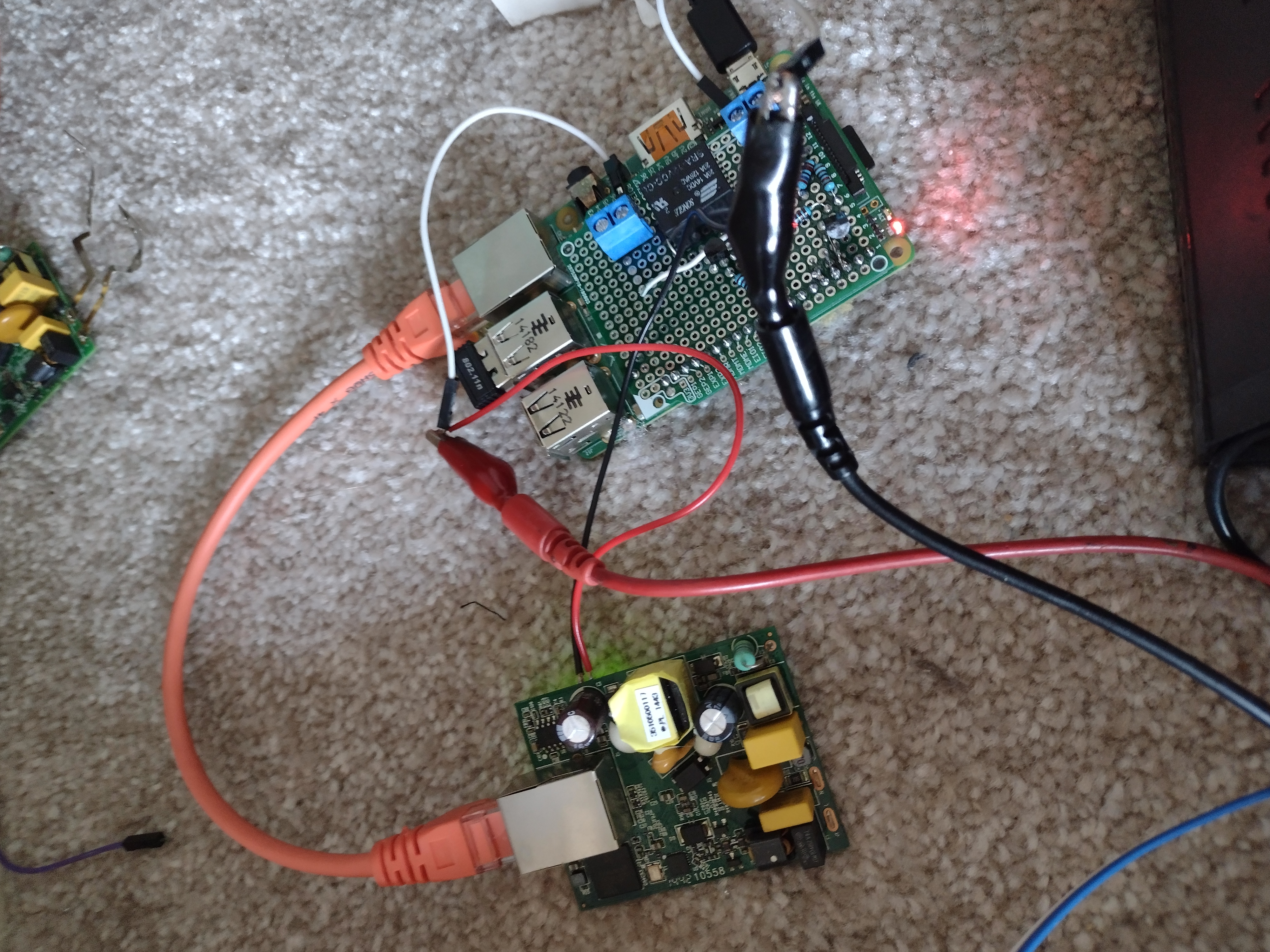

I got a single Devolo Powerline 200+ MT2710 in preparation for viewtopic.php?p=54814#p54814 . I dont have a CCS capable car.
I used the Devolo software to reset to factory defaults like recommended here https://www.goingelectric.de/wiki/CCS-T ... e-Details/ . The firmware Version of the Devolo MT2710 reported by the Devolo software is 4.4.0.05 . I have seen version 4.4.0.5 as latest firmware update for other Devolo 200Mbit devices. So i expect to be the latest one Devolo released for this device series.
The Atheros Chip is AR6400-AC30. The PCB have 81790F and E173761 written on it.
The pictures are dual-licensed CC-BY-SA 4.0 and GPL V3.0 and can be used here (MT2710 is unlisted at the moment there) https://github.com/uhi22/pyPLC/blob/mas ... ardware.md
My first goal is to reproduce this setup:
viewtopic.php?p=53848#p53848
In the setup the TP-Link is been used. Is there a special reason why?

The only reason is, that catphish started the investigations with this type of adaptor, and found out, that it is perfectly what we need. Maybe other adaptors with other chips than the AR7420 work as well, but we do not know. I just made a test with the Devolo dLAN 200 AVplus, which contains an INT6400A1G, with software INT6000-MAC-4-4-4405-00-4497-20101201-FINAL-B and unchanged parametrization. This worked perfect here as pev, with an TPLink/AR7420 on the other side as EVSE. This means, I see good chances that your adapter should work.
Done a bit of work on my prototype, the Pi hat has CP control and contactor control, the pi's GPIOs working nicely.
Not got a CCS socket yet, but next up, I need to get my head around MAX22530 for isolated SPI voltage measuring.

Nice :-) The experience shows, that the voltage measurement is overrated, it also works without, by just relying on the EVSEPresentVoltage which is reported by the charger. Your setup looks like quite ready for the light-bulb-demo :-)

Maybe I'll do without in that case. Once I get a CCS socket I'll post some logs. As I'm not using any serial devices I've got the console on serial so I don't have to setup WiFi away from home
