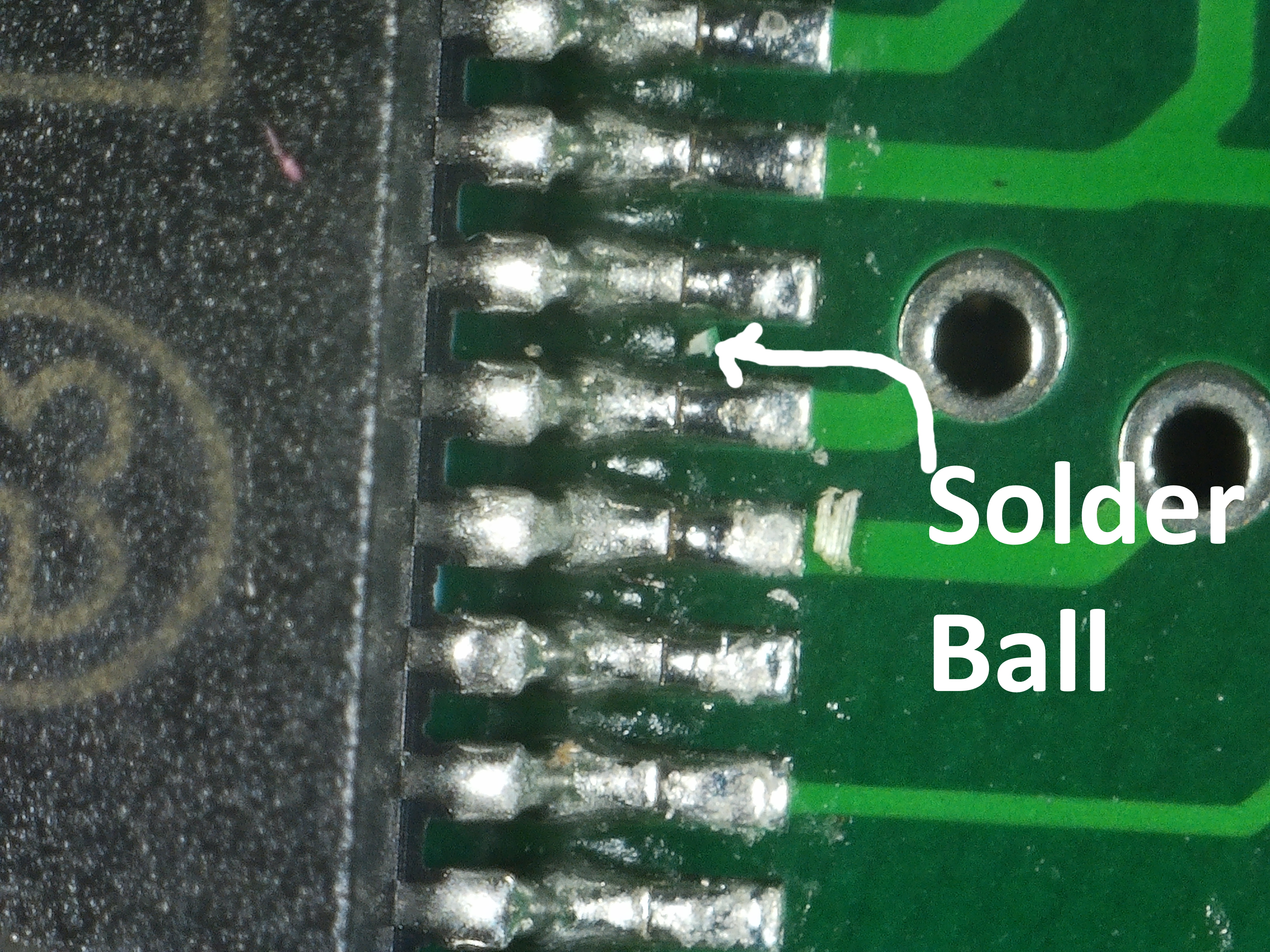

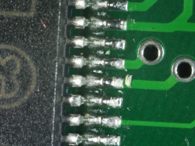

I discovered a loose solder ball between some pins on the STM32, between the UDC_11 pin and another pin (VDD I think?). I reflowed the solder on that side of the IC and the udc measurements are behaving better now.

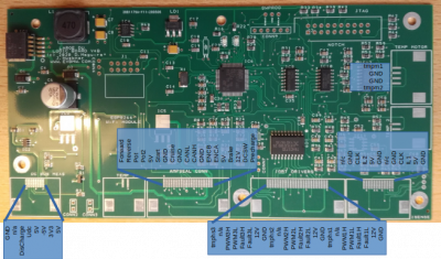

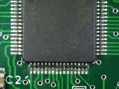

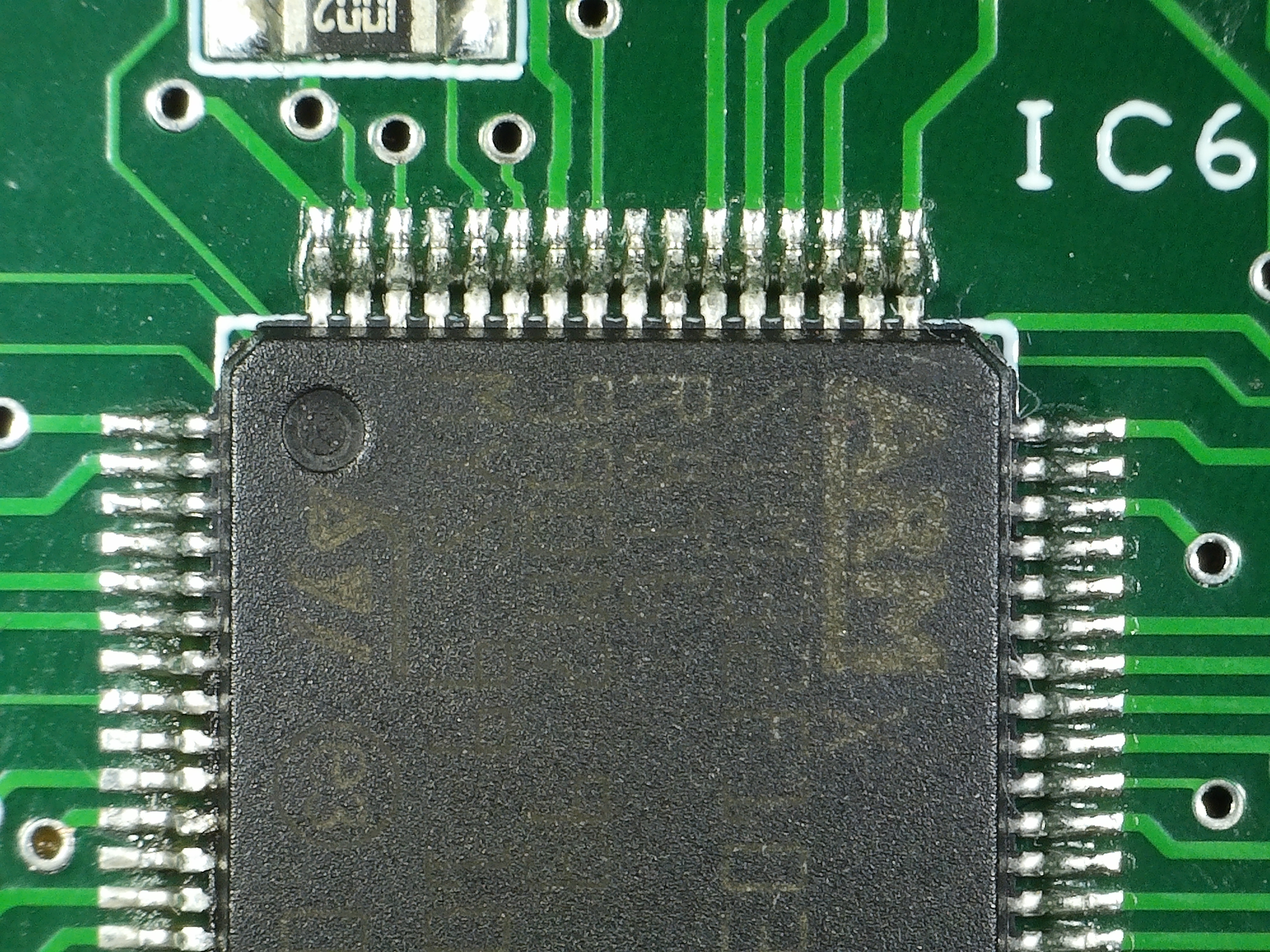

Ok, loose solder ball sounds not good. Can you post a hires macro picture of the processor and the entire board?

Attached are the requested photos. I had to take two photos of the micro controller as I couldn't zoom out far enough with my microscope.
I also attached the photo I took when I first discovered the solder ball. It can be kinda hard to see, so there's two, one that is edited to point it out.
