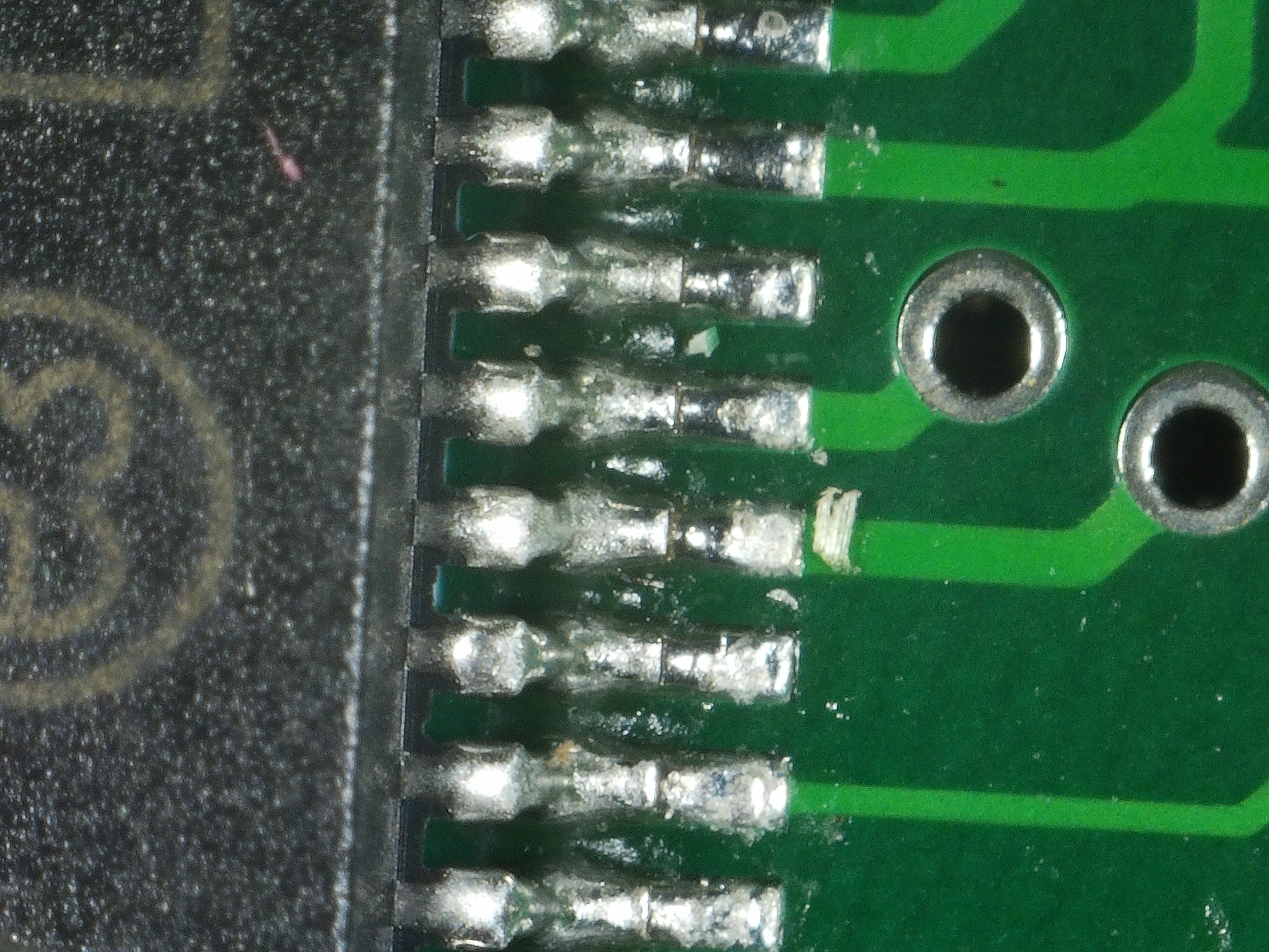

Hello,
I recently purchased an LDU logic board from the shop. After attempting a bench test, I found that the a few measured Spot Values are behaving quite erratically.
"udc" and "temphs" are both swinging around wildly.
udc: Seems to swing around between 20v and 550.15v.
tmphs: Seems to stick at exactly 100c, but will randomly jump around 43c for a ~3 sec, then go back to 100c.
uaux: Sticks at exactly 16.43v despite my changing the 12v up and down a bit. Does not respond to changes.
These problems occur both on the bench, and while hooked up to the drive unit. Precharging the drive unit doesn't seem to affect the readings.
I double checked the connector soldering job I did under a microscope and things look fine.

uaux is indeed not implemented. The others shouldn't jump around though. I'm currently not home, will get back to you tomorrow with some more detailed checks.
Re: Tesla LDU Logic Board Erratic Measurements
Thank you kindly!

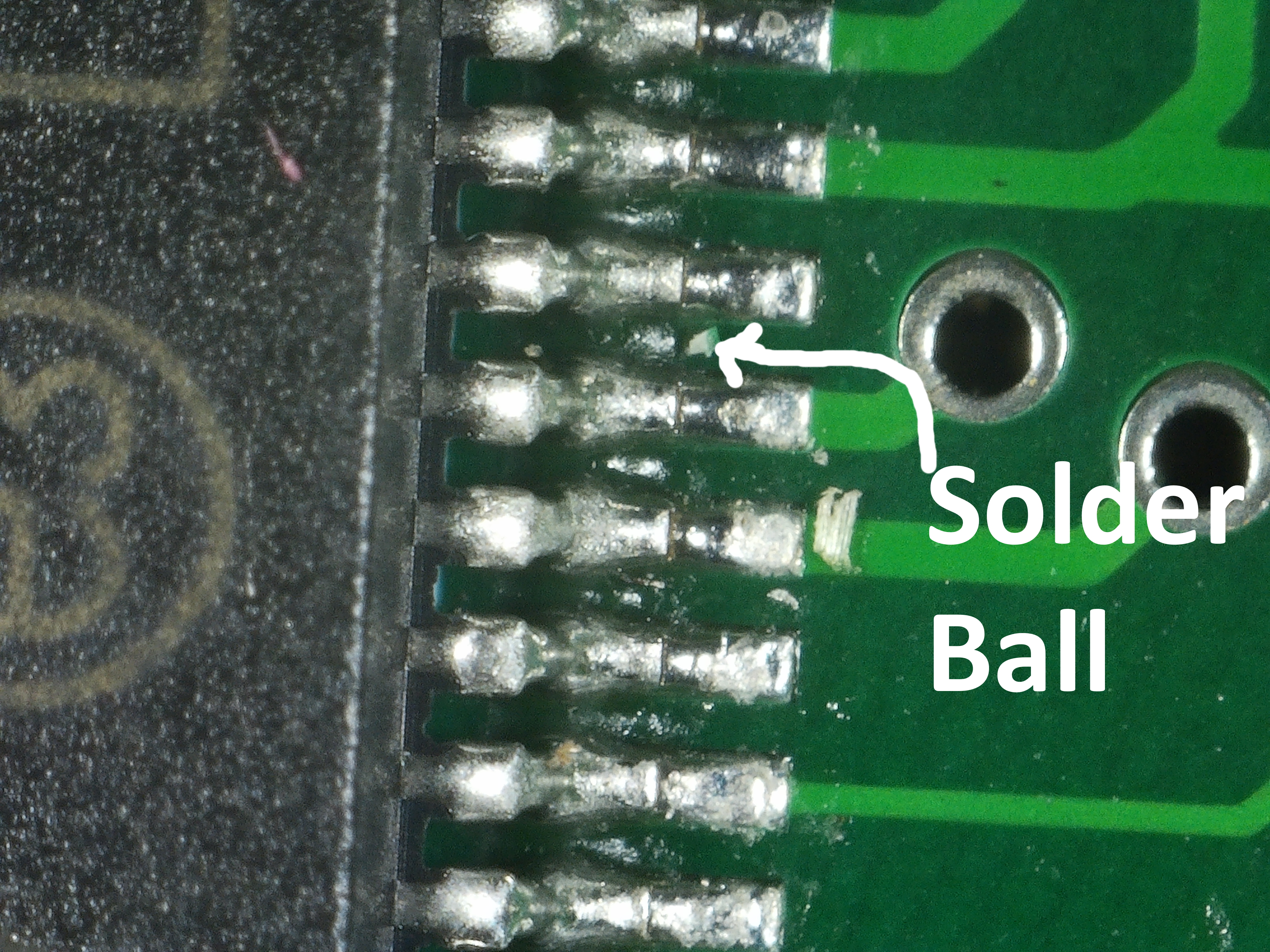

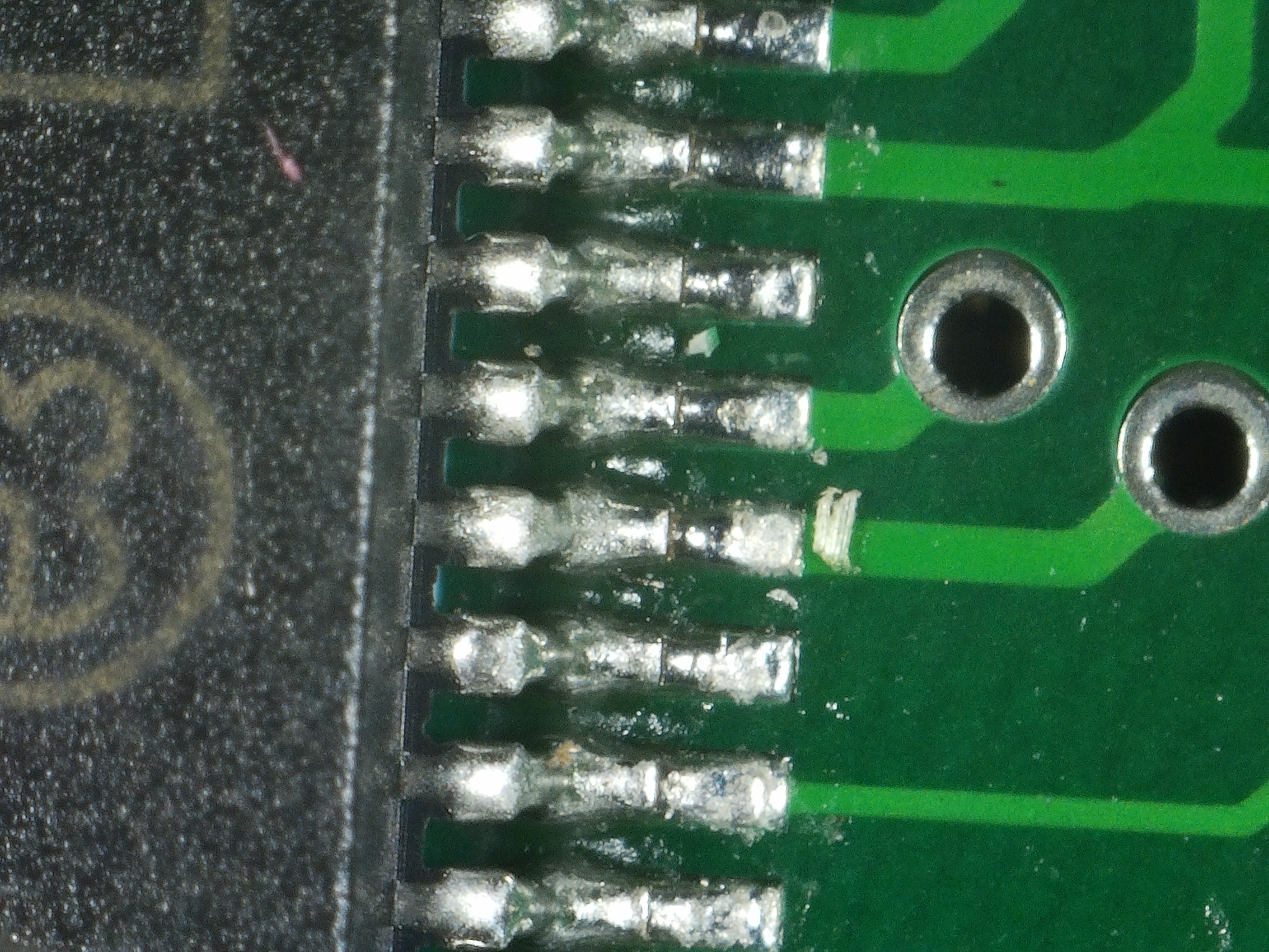

I discovered a loose solder ball between some pins on the STM32, between the UDC_11 pin and another pin (VDD I think?). I reflowed the solder on that side of the IC and the udc measurements are behaving better now.
Since tmphs is still giving me trouble I attempted to reflow the side of the chip that it's pin resided on, however that didn't resolve the issue. It's still reading incorrect temps.
I did attempt to spin the motor up on ~24 volts but it keeps tripping overcurrent right when I "start" it. Wondering if there's something else going on.

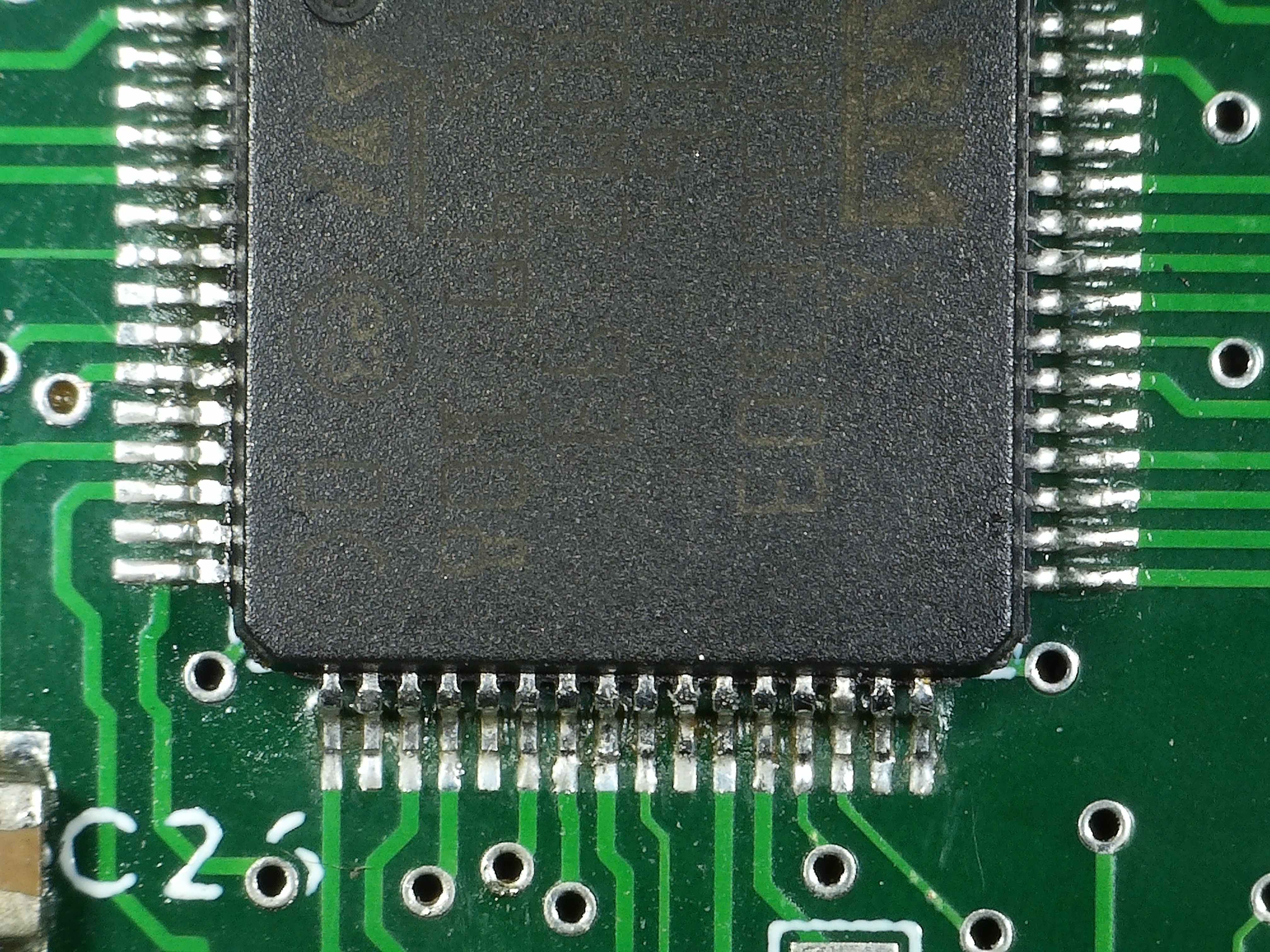

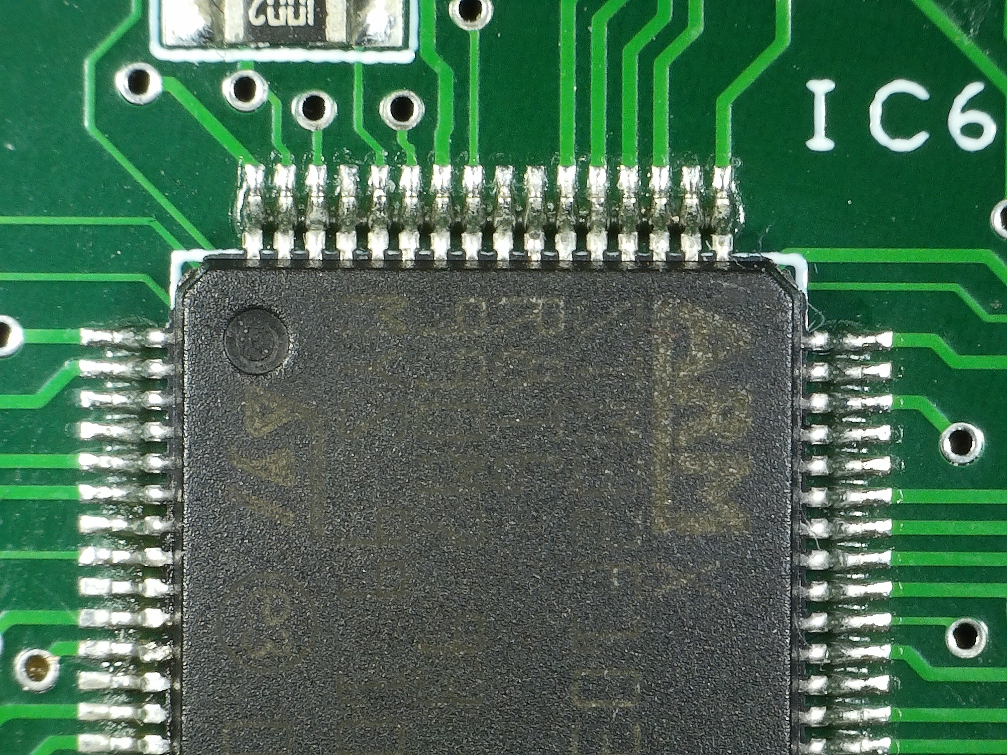

Ok, loose solder ball sounds not good. Can you post a hires macro picture of the processor and the entire board?
Attached are the requested photos. I had to take two photos of the micro controller as I couldn't zoom out far enough with my microscope.
I also attached the photo I took when I first discovered the solder ball. It can be kinda hard to see, so there's two, one that is edited to point it out.
I PM'd you my order number. Let me know if you need better photos of anything!

Ok, so the remaining problem is tmphs. tmpm reading is stable? What about pot and pot2?
Can you measure the voltages on IC12, Pin 1, 2 and 5 with "IGBT DRIVER" connector is plugged in?
tmpm stays at around 7.3c-8.1c, which is strange because ambient temp is 21c. pot1 and pot2 appear to be stable.
Pin 1: 1.68v
Pin 2: 1.72v
Pin 5: very low, maybe open circuit?

Then Pin 5 is probably the culprit, or rather the signal that feeds it (TEMP_B). Maybe cold solder joint on the connector (pin 16 of IGBT DRIVER).

I tested from the connector pin back to the chip and it actually tests fine. So maybe there's something wrong with the temp sensor within the inverter? I'll have to take a look later.
For a quick test, I raised the max temp and tried to spin. The inverter makes a whining noise, however, the motor does not spin. The "angle" value is changing quite a bit despite there being no movement.

Some interesting developments here. I did get it to spin! It appears my flux is more conductive than I remember and was causing temp sensor to read wrong. I gave the board a bath in IPA and scrubbed off all the flux I could see.
It also wouldn't spin up on 24v with just 1850 boost. Setting it to 6000 let it draw around 22a and start rotating.
Once rotating, though, I heard a strange "knocking" sound. After some research I discovered this is likely the "milling noise" others have suffered from, so I disassembled the unit. The bearing on the motor shaft (on the motor side) appears to be the culprit as it feels the worst, but it's hard to tell.
I have a new bearing on the way. We'll see how things develop from here!
