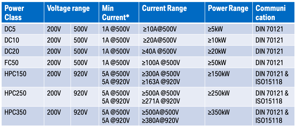

Useful CharIN document detailing CCS power classes 8-)
DC-CCS-Power-Classes-v6.pdf
(595.54 KiB) Downloaded 456 times
