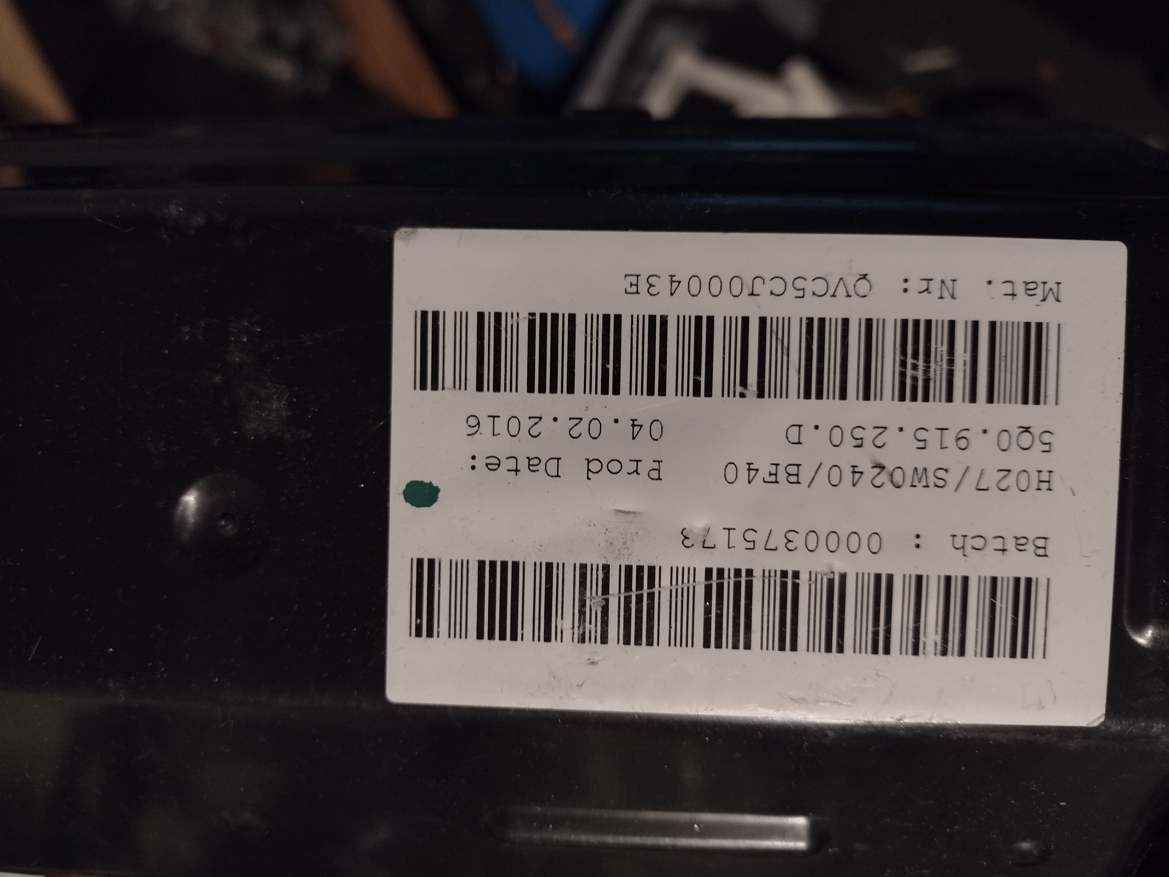

Mhs wrote: Sun Apr 23, 2023 11:17 am Thanks, that's a great step into the right direction!
Can I ask what's the vw part number?

Post by snelly »

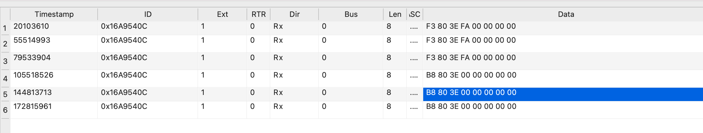

Finally got it. After an Iso test a single 0x16A9540C message is sent with the result :D 4th byte along seems to show resistance :D Not sure if the 5th will be HV positive resistance to ground, will need to test further.
I did 6 tests, 3 first without fault and 3 with a direct short to ground from the HV negative.

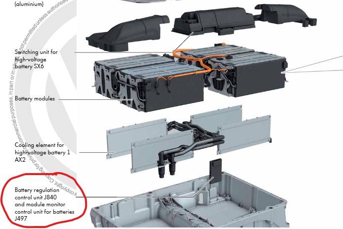

snelly wrote: Sun Apr 23, 2023 12:20 pm
I have the same control unit with code 5WA915183B from Škoda Octavia IV PHEV (battery manufactured 2020)
Seems like control units J840 Battery Regulation Control Unit and J497 Module Monitor Control Unit
are integrated into one control unit under the contactor box so called ebox
my battery doesn't have this separate control unit marked with red circle. I think that all of them are integrated into one unit now.
picture from VAG SSP 550 – The Passat GTE
pinouts that are on the wiki https://openinverter.org/wiki/VW_Hybrid ... s#Golf_GTE don't match with this version.
I wonder where to get that kind of info?
