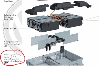

Ruudi S
- Posts: 101
- Joined: Sun Apr 12, 2020 2:02 pm
- Location: EU Estonia
- Has thanked: 55 times
- Been thanked: 32 times
Re: VW Golf GTE Contactor Box
I have the same control unit with code 5WA915183B from Škoda Octavia IV PHEV (battery manufactured 2020)
Seems like control units J840 Battery Regulation Control Unit and J497 Module Monitor Control Unit
are integrated into one control unit under the contactor box so called ebox
my battery doesn't have this separate control unit marked with red circle. I think that all of them are integrated into one unit now.
picture from VAG SSP 550 – The Passat GTE
pinouts that are on the wiki https://openinverter.org/wiki/VW_Hybrid ... s#Golf_GTE don't match with this version.
I wonder where to get that kind of info?
