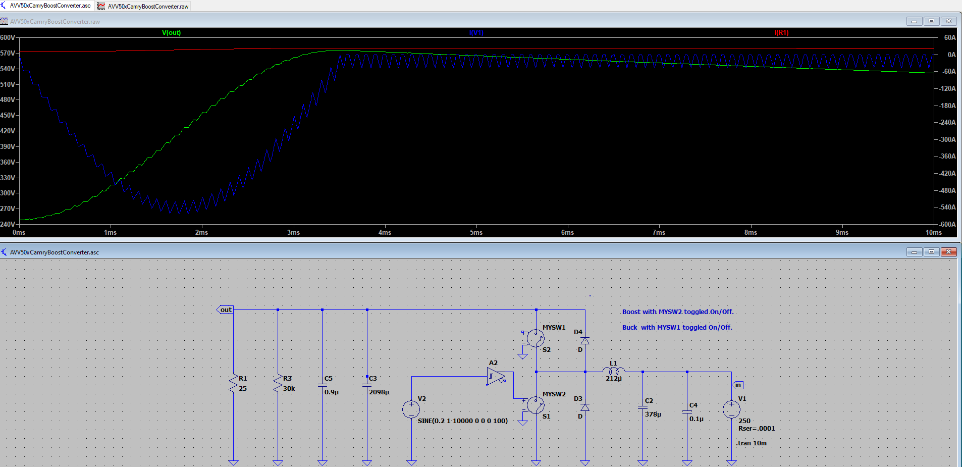

I have made an LTspice XVII model, and have put one graph on the forum:
Operation is more complicated than I thought it would be.
I have included the file as well below.
So far my model only has equal mark / space ratio, but battery voltage and parameter values can be changed.
If anybody wants to, we can explore what this model can do for us with boost.
With this nonlinear stuff, sometimes it is better to use simulation models rather than maths I find.
Kind regards
Johnspark.
AVV50xCamryBoostConverter.zip
(1.04 KiB) Downloaded 1396 times
Pete9008
Posts: 1801
Has thanked: 102 times
Been thanked: 351 times
Post by Pete9008 »
Good idea, that looks interesting :)
Need to install LTspice before I can have a play (used it a lot in the past but never got round to installing on Linux).
All looks to make sense but can't quite see what is causing the oscillation in the input current on the RHS of the plot, guessing the inductor and input/output capacitors could be resonating a little? Might be worth also plotting the inductor current to check? If it is then including a little bit of series resistance in the inductor might help clean it up (increase damping/reduce Q).
Not sure you need the flip flop. If you drive the sig gen straight into the buffer you should be able to use the sig gen parameters to set the duty cycle.
johnspark
Posts: 264
Has thanked: 59 times
Been thanked: 48 times
Post by johnspark »
Will try these things Pete9008 .

i took your advise Pete and got rid of the D flip flop. But found I could replace it and the buffer with a schmitt buffer. Now I am getting sensible results. For a 250V battery and approx 500V output, current from battery is approx double that going to load resistor.
Also that saw tooth waveform superimposed on the carrier is gone :).

I can also adjust mark space ratio by adjusting +/-DC offset of sinewave generator. So model becoming more realistic and simpler.
johnspark
Posts: 264
Post by johnspark »
This model now has adjustable mark/space ratio via the adjustable battery.
Very happy with this model, it can be adjusted, and gives realistic values :).
For this example, I have 3 different mark space ratios for initial conditions, to reduce the large inrush current (slows down speed of getting HV).
Pete9008
Posts: 1801
Post by Pete9008 »
Looking good :)
Thanks for posting the Prius MG1 data, been hoping to do a bit of simulation to see what it might be able to do for a while now.
I was wondering what to do about the power up current surge as it could saturate the inductor but your soft start does a good job of controlling it.
Might be worth having a look at using the PULSE function instead of SINE for the sig gen. If you give it a Tperiod it generates a continuous stream of pulses rather than a single pulse. You can either use it either with zero rise and fall times and use the Ton argument to control the dutycycle to get a square wave or use Trise and Tfall to generate a sawtooth or triangle waveform to do the kind of control you have above (but more linear). I suppose the next step would then be adding a feedback loop and a comparator to control the switching point based on output voltage to have a fully regulated model?
What's the goal here, are you looking to use it to boost the voltage to the inverter to drive the motor?
Might also be worth starting a separate thread for it to make it easier to find?
