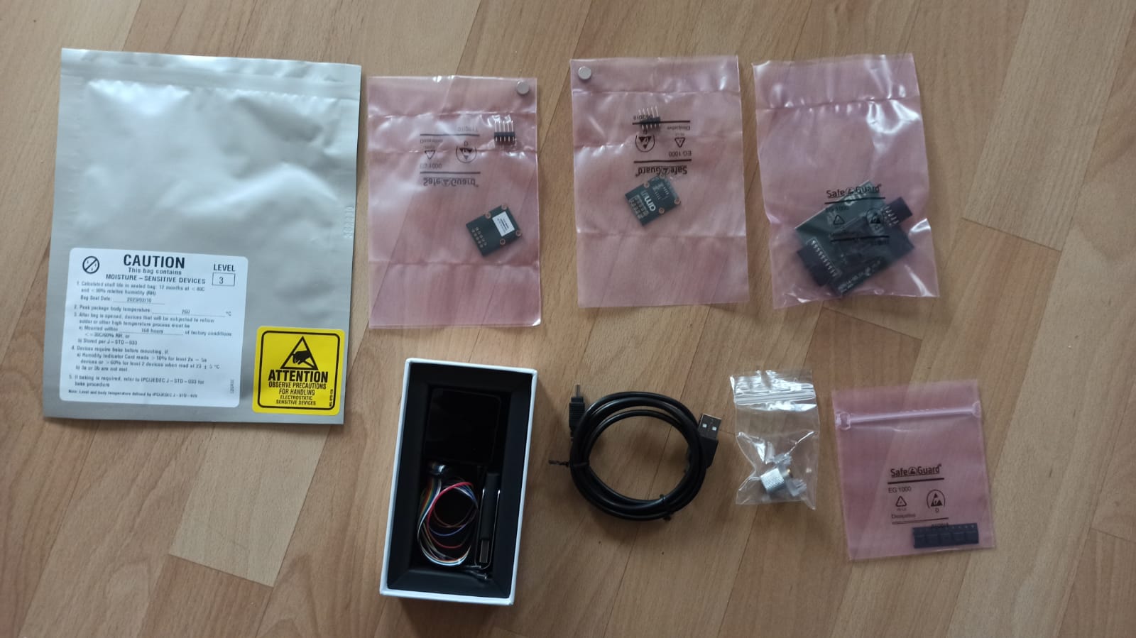

I received ready-made boards for sensors, I also received my purchase of microchips + kit programmer.
the first connection to the V3 OI board showed excellent work after the sincosofs settings and the firmware of the chip itself.
