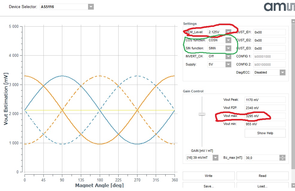

hello everyone.
I want to use this chip, but there are questions about what kind of board to make for it, under what variant of the supply voltage and how to connect it correctly to the board v3 of johu.
thanks for the tips.

Re: questions about the sine cosine chip as5116
the setting allows you to select a 3.3 or 5 volt power supply, also allows you to select the average voltage point, and the slider of the amplifier changes the maximum and minimum voltage.

does this mean that the VCM level should be used 2.125, and the gain should be adjusted so that the amplitude does not exceed 3.3 volts?
evil neodymium
- Been thanked: 1918 times
Ideally the midpoint is at 3.3/2=1.65V and the swing uses as much of the 0-3.3V range as possible.
But even midpoint 2.125 allows for 1.2V swing until it hits 3.3V so will be fine as well.

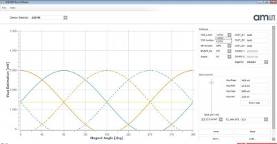

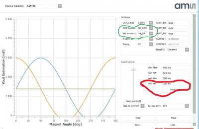

The settings support 1.375 or 2.125, so you can choose 1.375 and adjust the amplitude amplifier to a maximum of 3.3 volts.
however, if the middle point is 1.375, then with an amplitude reaching almost 3.3 volts, the lower point goes into a negative value. is this normal or is it better to reduce the gain so that all the sinusoids are in positive values?
also, I do not yet understand the option for the sine/cosine function (choose where there are only two lines of the graph or where there are dotted lines as well)?

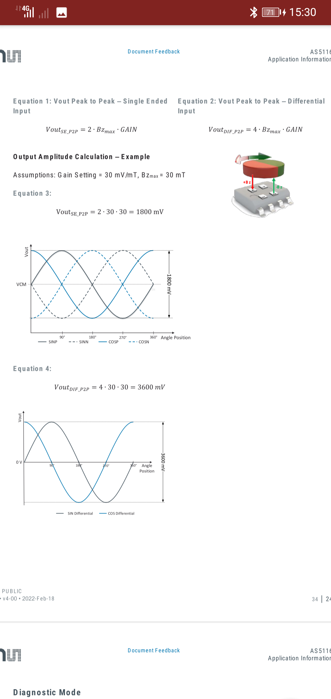

You want just two lines and the signal mustn't go negative. 1.375V offset gives you 2.7V usable amplitude, that's certainly good enough and better than 2.3V when using 2.125V mid point.

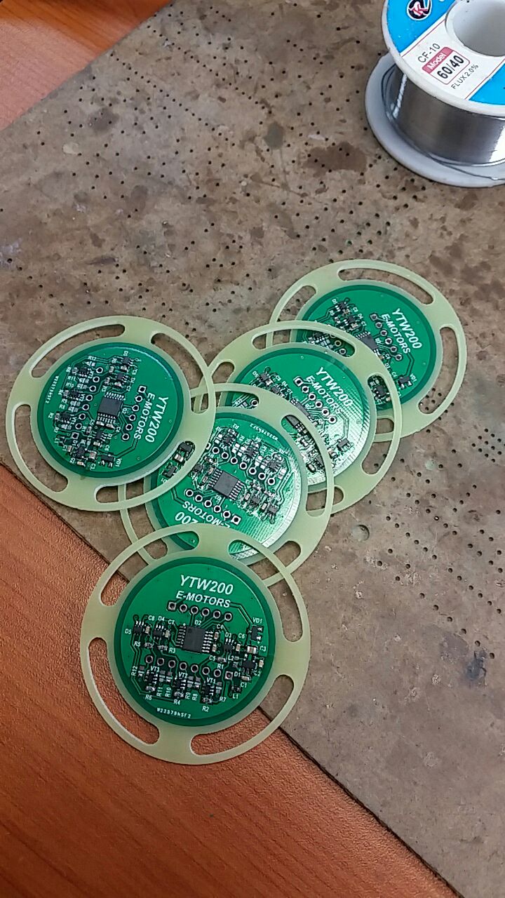

and so!
I received ready-made boards for sensors, I also received my purchase of microchips + kit programmer.
the first connection to the V3 OI board showed excellent work after the sincosofs settings and the firmware of the chip itself.

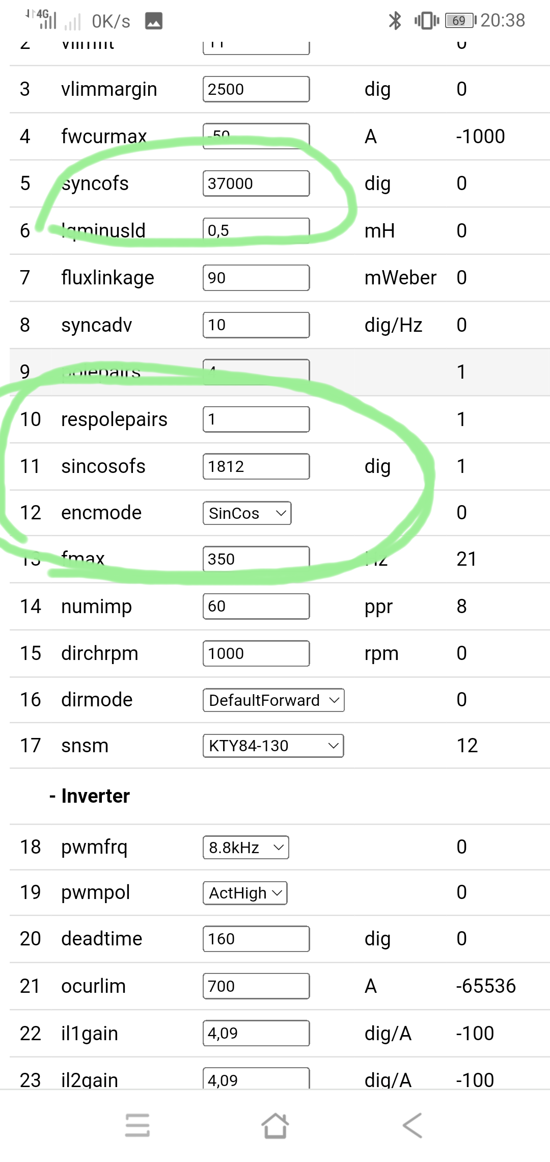

I also have a question, do I need to configure the RESPOLEPAIRS field in the SynCos encoder mode? Judging by my setup program, it generates one full sine wave per revolution. Is it equal to 2 pairs of encoder poles?

however, I have doubts about the angle search algorithm with the new firmware! I first tried to adjust the angle on my Nissan motor, and it turned out that the motor does not rotate between 64000 and 1000. therefore, taking 65000 as the middle, I subtracted 32768 and entered the resulting value. at the same time, the engine was standing still. but after pressing the pedal, it began to rotate by itself at full speed!
when I returned the value 64000, the motor is working adequately!
Does this mean that the new algorithm for finding the sensor angle does not require subtracting or adding 32768 and you need to enter exactly the value at which the motor does not rotate?

here you can see some settings for this sensor, as well as the gain settings of current sensors for the Honda ima inverter.

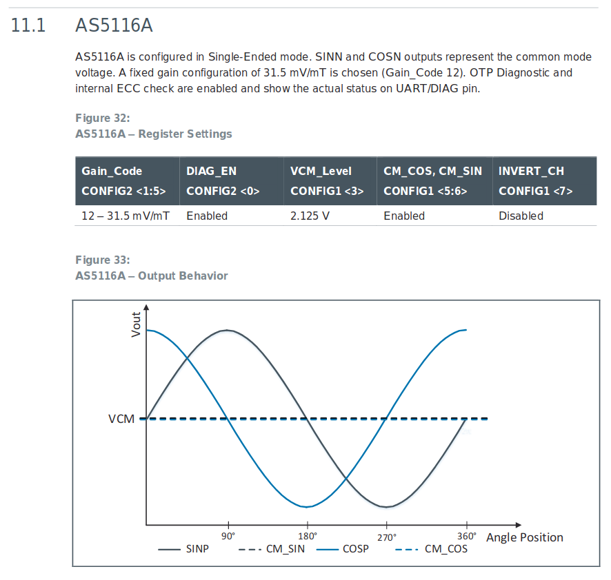

Just had a quick look at the data sheet and am fairly sure that the positive output signals are the same regardless of 2 or 4 wire mode. The common mode voltage does change if in 5V mode though. Scaling the output by 0.66 should get you back the the right common mode voltage and full scale voltage for the OI inputs though.
Also looks like the output voltage is dependant on magnet strength and the distance to the magnet so the gains really needs to be set up once everything is in its final positions.
Hadn't realised that these things were one time programmable - once you save the configuration the setting is permanent!
Surprised by that, it looks like it should work. Had another look at the data sheet and found this description of the AS5116A configuration: It looks like it should be fine apart from the 5V operation which the resistive divider should fix.Romale wrote: ↑Fri Apr 14, 2023 10:43 pm I tried a non-programmable hall effect chip with a voltage divider. does not work. the controller sees the position of the rotor, the maximum voltage between the minus power supply and the sine was 2.85 volts and the minimum 0.2 volts. I calculated the midpoint as indicated in the settings description and tried to calibrate the angle. the motor never spun, only squeaked slightly. Then I just started the controller in normal mode and changing the angle by two thousand units I tried to press the accelerator pedal, only in a narrow range the motor cracked slightly and slowly rotated, and in the rest the battery current simply increased without rotating the motor. I also tried to measure the voltage between the sine and the sine minus output, it varied from +3 to -3 volts. Conclusion, the as5116A chip on the hall effect does not suit us! It is not clear why it is not programmed, while the same chip without letters (as5116) is perfectly configured and works with our controllers.
I can only think of two explanations. Either the phasing/polarity of the outputs does not match your OI setup or the 31.5mV/mT gain set on the A version is too high for your magnet configuration and the outputs are saturating in some rotor positions. Would it be worth plotting sin, cos and angle while rotating the motor manually to see? What gain setting did you find worked on the programmable version of the chip?
