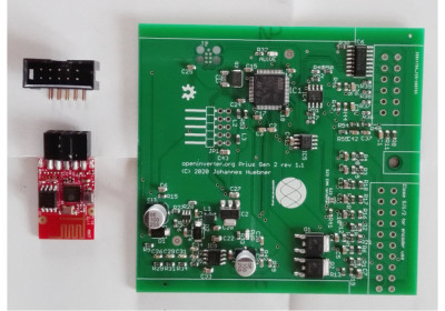

is about Toyota Gen 2 inverter I find cheap invertors in Ebay and need a logic board to run the Toyota Prius Gen 2 Inverter. I found all files in https://github.com/damienmaguire/Prius-Gen-2-Inverter, but when i try to make order on https://jlcpcb.com/ told me that BOM file is not correct format and missing CPT file in folder. Also some files are missing in DC_controller folder. I will use it for my Peugeot 407 with Bosch SMG 180/120 PMSM motor.
- Posts: 261
- Location: N. Wiltshire. UK
- Has thanked: 22 times
- Been thanked: 130 times
Re: Toyota Invertor Gen2 Problem
The fact that there is no CPL file and the BOM is not in .xls format is becase this was not designed to be assembled at JLCPCB. At the time JLCPCB did not assemble leaded parts. You will either have to assemble it yourself or update the BOM with JLCPCB part numbers etc.
Alternatively buy this.
https://openinverter.org/shop/index.php ... duct_id=68

Thank you for information, i will buy the logic board from openinverter shop for my Toyota gen2 inverter, i will use
for Bosch SMG180/120 motor with MG1 -250A 200v battery is it possible to start the motor with toyota inverter gen2 and logic board from shop openinverter?
- Posts: 1017
- Has thanked: 403 times
- Been thanked: 260 times
I'll let Johannes speak for his own product, but, no, I don't think so.bliznakavd wrote: ↑Sun Dec 18, 2022 10:43 amis it possible to start the motor with toyota inverter gen2 and logic board from shop openinverter?
Short answer is that nothing on EVBMW or OpenInverter is a DC motor speed controller.
The thing you can purchase from OpenInverter is to run the Gen2 Prius inverter as an inverter, for an AC motor.
Which, is pretty significant overkill for what it takes to run a DC motor. But if you wanted to spend the money... maybe Johannes know of, or would write a short bit of code that would spit out useful DC instead.

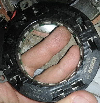

I just want to say thank you on Johansen(Johu), Pete9008 and MattsAwesomeStuff,
with their help we were able to find out what the engine is, my PMSM motor bosch SMG 180/120 i will use with inverter from Toyota GEN 2 with a logic board of openinverter.org at 144 volts, the motor is with The Resolver is from Tyco Electronics,
Multi Coil Resolver
Type: MCR605
Speed: 6-speed (so 6 pole-pairs)
Excitation_Voltage: 7Vrms
Excitation_Frequency: 10kHz
The MCR605 pin-layout (6-pin variant):
1 / green / reference
2 / brown / sine-
3 / blue / sine+
4 / white / cosine-
5 / red / cosine+
6 / yellow / supply
Multi Coil Resolver
Type: MCR605
2 / brown / sine-
3 / blue / sine+
4 / white / cosine-
5 / red / cosine+
6 / yellow / supply
I have the same motor. Could you confirm guys that it's correct resolver output? On Damien's film plot was more repeatable and regular, but maybe number of poles makes difference.
- Posts: 6713
- Has thanked: 368 times
- Been thanked: 1542 times
Looks alright to me

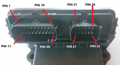

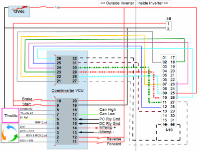

Good news, so I can go further. It's my working pinout for resolver slot of Peugeot motor.
1 – Motor ground,
2 – EXC- → e.g. JP7 pin 16
3 – SIN- → JP2 pin 2
4 – SIN+ → JP2 pin 1
5 – COS- → JP2 pin 2
6 – COS+ → JP2 pin 3
7 – EXC → JP2 pin 4
1 – Motor ground,
7 – EXC → JP2 pin 4
Do someone know what kind of temp sensor is used in this motor? There are 4 pin, in original wiring pins 1 and 4 are twisted pair (10k between them), pins 2 and 3 are shorted.
- Posts: 32
- Joined: Tue Dec 13, 2022 8:13 pm
- Has thanked: 12 times
- Been thanked: 9 times

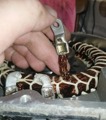

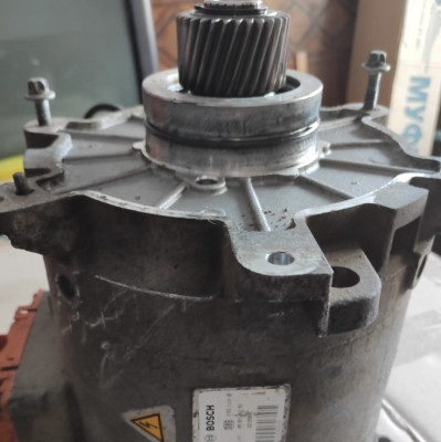

I suppose that 1 and 4 should be connected to TEMP and TEMP- (but what polarity?). One of 2 and 3 should be powered by 12v and other connected to IN_MPROT. There is still issue what type of temp sensor should be chosen in inverter settings.
In a fact I have got bigger trouble now, because I realised, that there is big backlash between rotor and front bearing. It's really bad news for me, because I planned use normal clutch, which is quite heavy. Even if I fix it or buy other motor, problem could quickly return.

It's really bad news, if you use normal clutch the problem will return quickly, may be if you use C3 new bearings, Would someone tell me is that correct wire diagram on my Gen2 inverter? which pins are need to use for resolver
