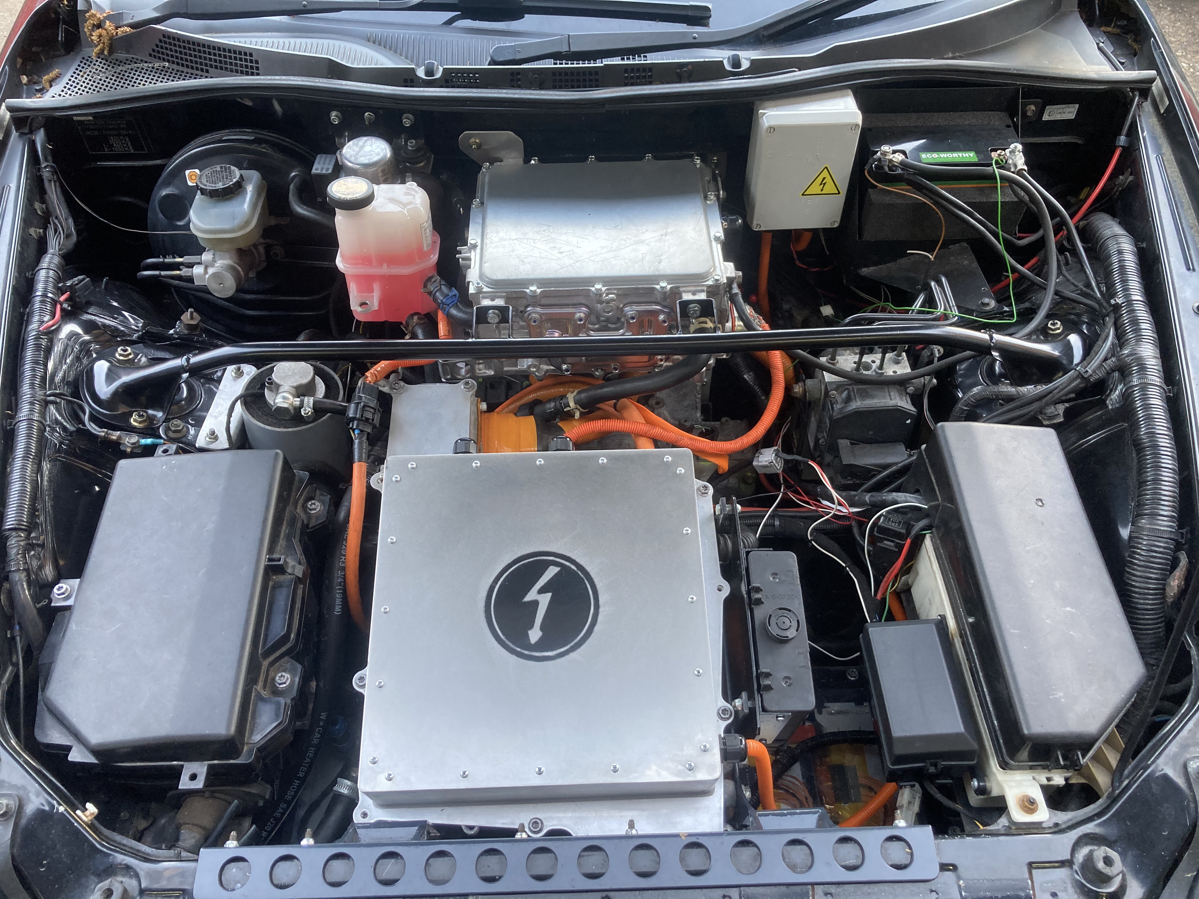

Outlander charger now mounted in the front and plumbed in, not wired up yet, seemed like more effort than expected to mount it in the only available space and keeping to only using oem pickup points!

So when I first put this setup together I decided for some reason to put the main contactors in the inverter case in the space left from the boost section which I removed.
This seemed like a good idea at the time but like a lot of things with an ev conversion there’s things I’d do different next time, one of the issue being the to add chademo I’d need to get more wires into the inverter than I had space for not to mention the need for yet another box somewhere with the chademo contactors, all easy options seemed like they’d be messy so instead I have remade the top of the inverter box with just enough room to add 2 contactors and the isa shunt I need, Not finished yet but it’s a step closer to getting the chademo installed
Re: Project RX8 , Prius gen2, Lexus transaxle to rwd
Another week another small step towards chademo working, port is in the car, make up a little home for it to sit in behind the hole I cut in the bumper in December! Made from my favourite plastic material ; spare lids from whamm upcycled storage boxes it’s really easy to plastic weld together with an old soldering iron! And installed the charge port itself, still searching for a suitable hinge for the lid. Still a bit to do mostly all wiring and configure the isa shut which I forgot to do before installing it!
