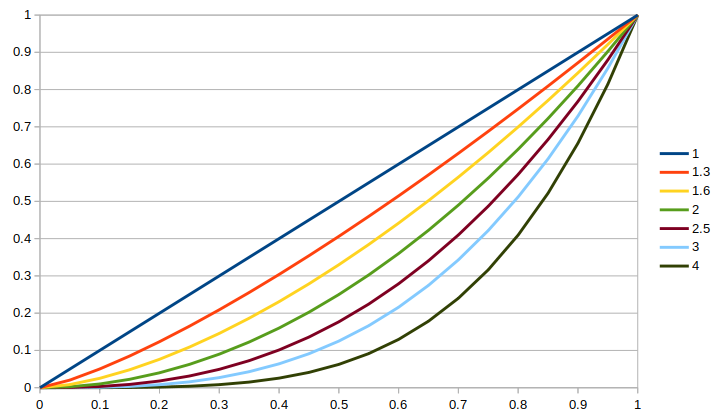

Unfortunately coding this for the stm is beyond me but I’m happy to contribute to its development, just wondered if it would be of use to anyone else
Basically I’d quite like to have an adjustable non linear throttle ramp so the start of the throttle application is less sensitive the end..
mostly because once you turn up throtramp and throtcur to achieve desired performance coming on and off the throttle can be quite jolty as it takes up and releases drive line slack… this can be tamed by lowering throtramp, but at the cost of performance when you step on it!
Non linear throttle ramp

I like this idea
Just had a play, how about using non linear maps rather than ramps? If you use throttleout = power(throttlein, powerterm) then you can modify the powerterm to give a number of different maps: It's like using offset pivots on throttle linkages on an ICE engine to make the throttle open more gradually at the start of the travel.
Edit - corrected plot axis labels
Re: Non linear throttle ramp
Yes that’s just what I had in mind, I know this kind of pseudo inverse logarithmic response can be achieved on a potentiometer by placing a resistor between the wiper and ground, not sure it would work with Hall effect throttles though hence the requirement to do it in software
I'd wondered about that too but couldn't see an easy way of making it adjustable. Plus as you say it wouldn't work with anything that isn't analog pot based (it relies on the pot output impedance to work).Ev8 wrote: ↑Sun Mar 12, 2023 4:14 pm Yes that’s just what I had in mind, I know this kind of pseudo inverse logarithmic response can be achieved on a potentiometer by placing a resistor between the wiper and ground, not sure it would work with Hall effect throttles though hence the requirement to do it in software
