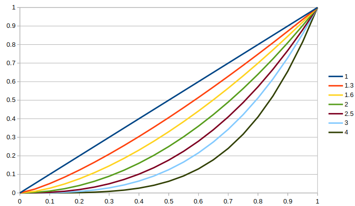

Unfortunately coding this for the stm is beyond me but I’m happy to contribute to its development, just wondered if it would be of use to anyone else
Basically I’d quite like to have an adjustable non linear throttle ramp so the start of the throttle application is less sensitive the end..
mostly because once you turn up throtramp and throtcur to achieve desired performance coming on and off the throttle can be quite jolty as it takes up and releases drive line slack… this can be tamed by lowering throtramp, but at the cost of performance when you step on it!

I like this idea :)
Just had a play, how about using non linear maps rather than ramps? If you use throttleout = power(throttlein, powerterm) then you can modify the powerterm to give a number of different maps:
It's like using offset pivots on throttle linkages on an ICE engine to make the throttle open more gradually at the start of the travel.

Yes that’s just what I had in mind, I know this kind of pseudo inverse logarithmic response can be achieved on a potentiometer by placing a resistor between the wiper and ground, not sure it would work with Hall effect throttles though hence the requirement to do it in software

Ev8 wrote: Sun Mar 12, 2023 4:14 pm Yes that’s just what I had in mind, I know this kind of pseudo inverse logarithmic response can be achieved on a potentiometer by placing a resistor between the wiper and ground, not sure it would work with Hall effect throttles though hence the requirement to do it in software
I'd wondered about that too but couldn't see an easy way of making it adjustable. Plus as you say it wouldn't work with anything that isn't analog pot based (it relies on the pot output impedance to work).

I am looking towards Lebowski polynomal throttle.
There are three coefficients you can set in code that determine the curve. a, b, and c are floats because they can be less then 1.
x is the throttle value and y is the result.
y = a*x + b*x^2 + c*x^3
Currently i am using this in my pug with Lebowski brain.
My settings are:
a=0.3
b=0.8
c=0.6
And they work really well as i dont need a sharp takeoff but want to have good upcurve at full throttle.
Probably there would need to be an acceleration limiter for safety as well.

Re: Non linear throttle ramp
Post by Pete9008 »
Wondered about that approach too but what put me off is the user has to work out whether the combination of a, b and c add up to full throttle (or more or less than full throttle). Also more things to adjust so more ways to get it wrong. Probably faster in terms of execution time though?
