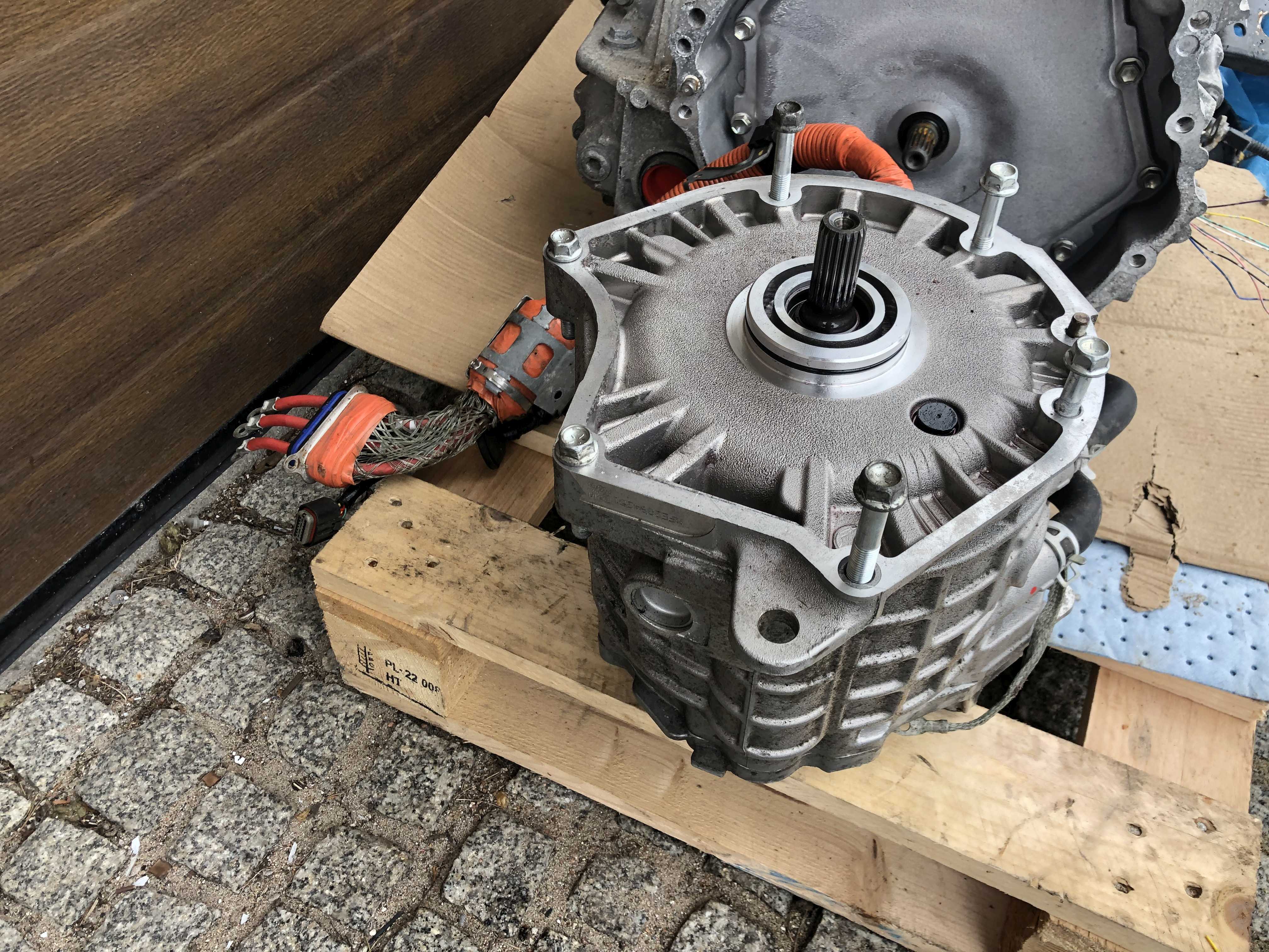

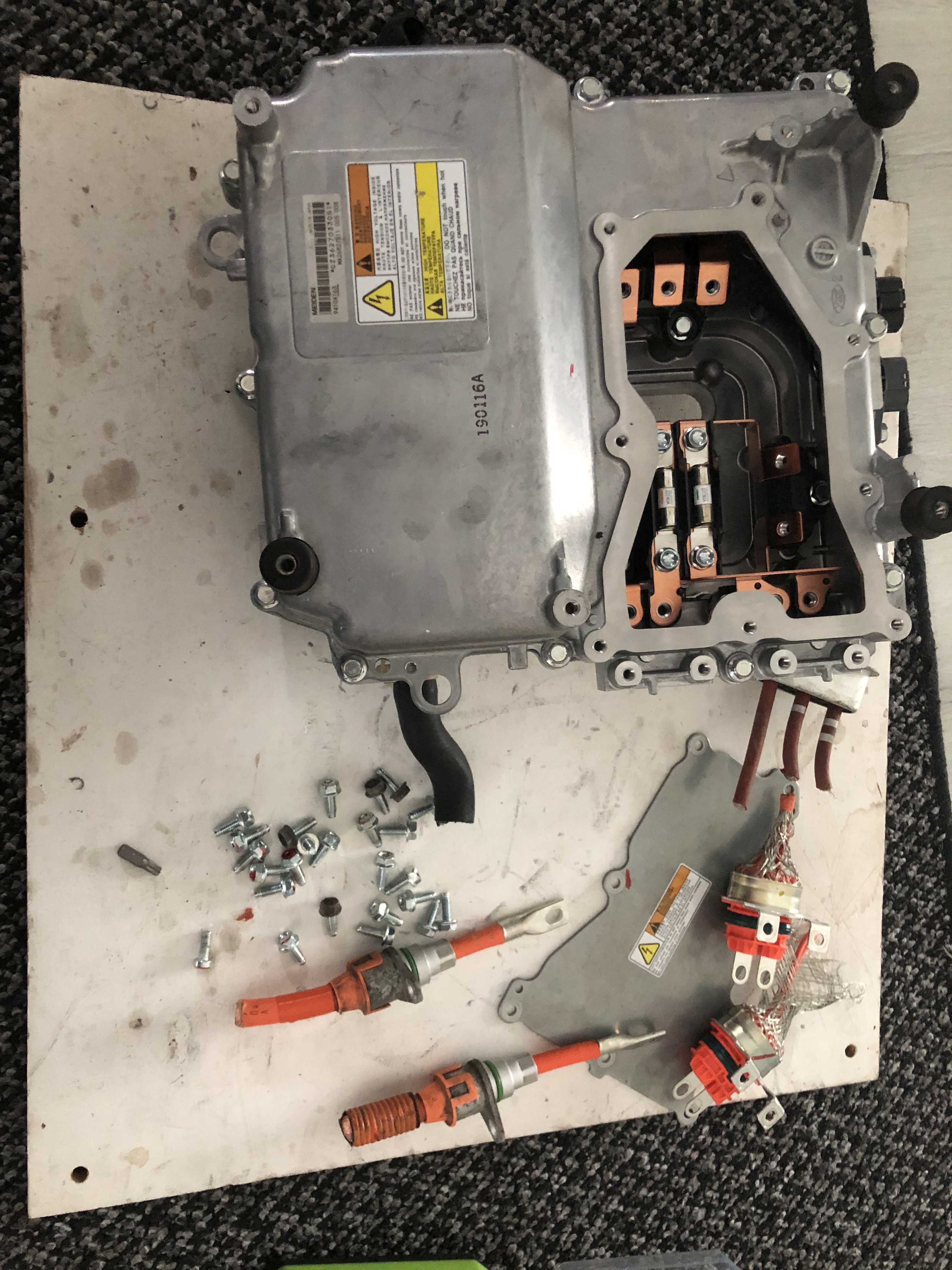

Hello everyone. I'm starting soon with my first project based on peugeot 306. I got it for free from my friend, that's why such an idea for a base. I want to use an inverter from Toyota Yaris with Small board V1d. As a drive I want to use rear drive from Outlander. The battery will come from the i-miev. The vacuum and power steering pump comes from Opel. I'm going to connect the electric motor to the original gearbox. Earlier, I wanted to use the drive from Toyota Yais, but this Peugeot model has a speed measurement not from abs but from a mechanical sensor in the gearbox. My version of the Peugeot also has air conditioning, so at a later stage I want to use the air conditioning compressor from the Outlander. The project is to be a science of conversion and is to serve as a daily car charged from my off-grid installation that powers my house.
I want to divide the battery so as to load the car evenly and place some of the cells in the place where the fuel tank was and the rest under the hood to match the weight of the old internal combustion engine.
The photos show the items I have already collected.

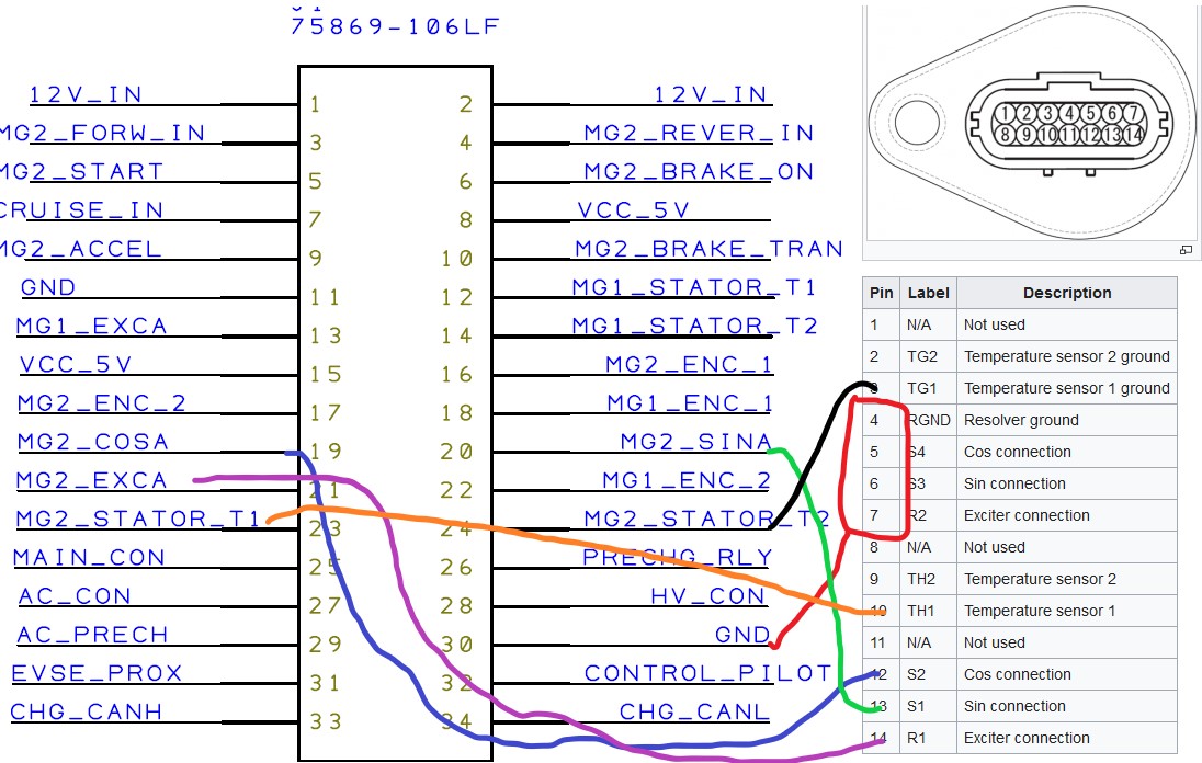

I have such a walking question about connecting the resolver to this board. I saw on the wiki describe the connectors but there are two pins for sin, cos and exciter. How should I connect them to the mg2 inputs in the inverter?

As for the use of the gearbox from the Toyota Yaris, I thought about it, I even bought it, but the problem with the speed sensor, additionally, the modification of the driveshaft, making the gearbox mounts, all these additional works prompted me to use the outlander drive. The only thing I need to add is a plate connecting both elements, a clutch and one motor mounting point. The advantage of this solution is having gears. As for the inverter, I have already ordered a board for the Yaris inverter and it is unlikely that it will be able to control the inverter from the outlander. For this you need a zombieverter and here is the problem with ordering the assembled board in jlcpcb because I did not find a single configuration file on githab. I miss the CPL file if any of you would have such a file I would be grateful.

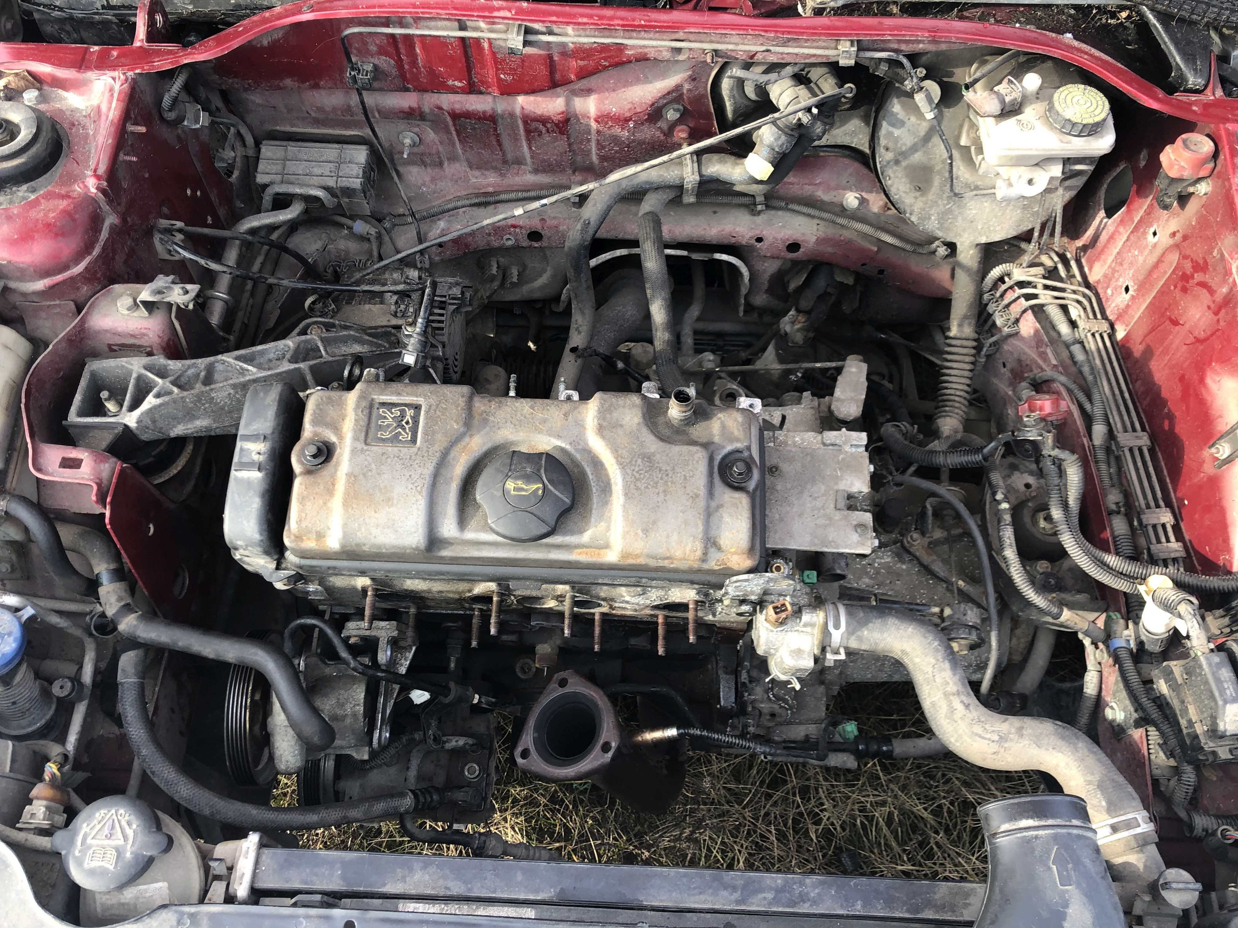

Work is progressing slowly, waiting for the outlander's engine, I'm disassembling the internal combustion engine. Due to the cold and snow, there is not much going on

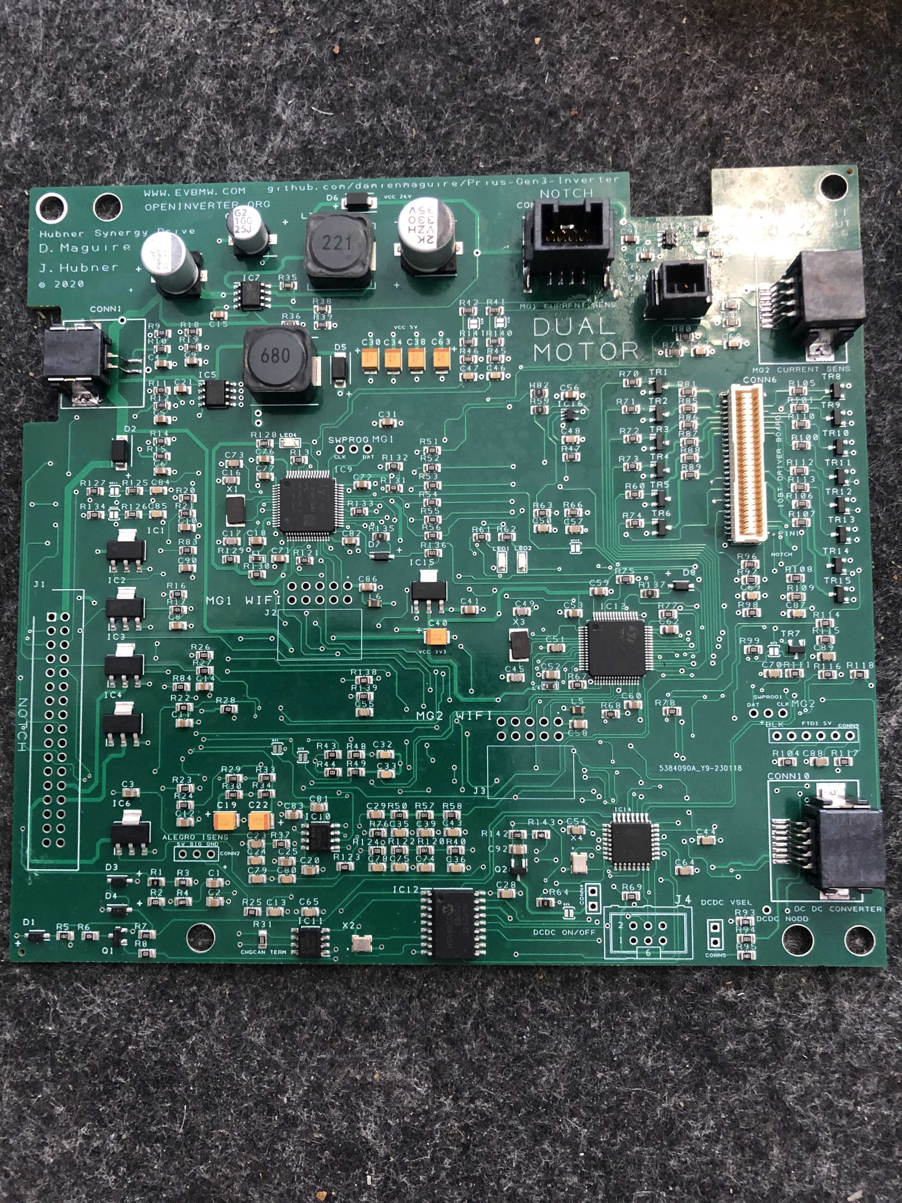

Finally, the assembled boards have arrived from jlcpcb. I am starting to assemble the connectors removed from the yaris inverter board.

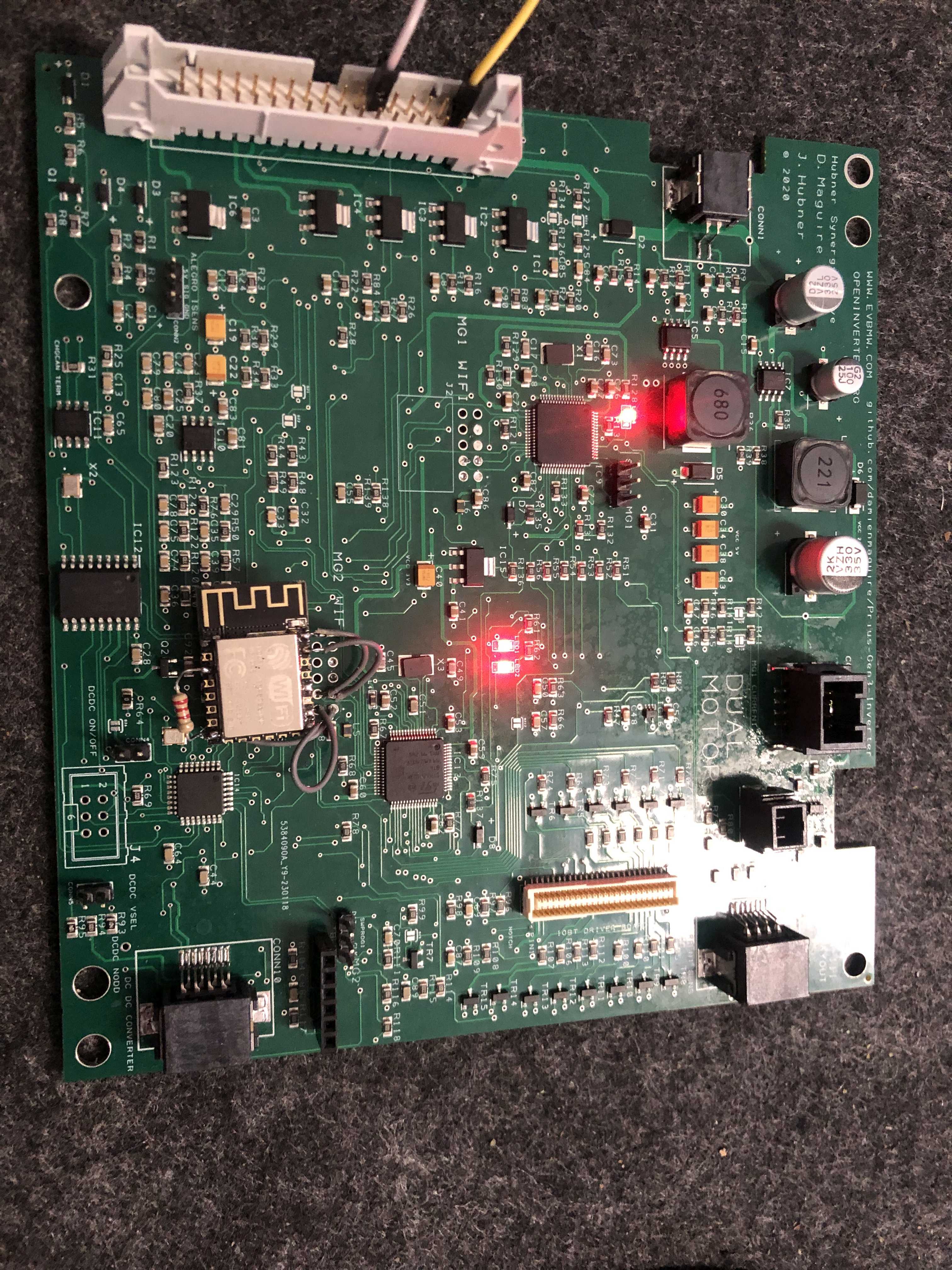

the board is already alive after programming
I did everything step by step like this friend on YT

I have a question for people with more experience than me. Below I have compiled the connector from the dual_v1d board and the resolver from the outlander rear drive unit, is this connection correct?

youngpoland wrote: Wed Feb 08, 2023 5:06 am I have a question for people with more experience than me. Below I have compiled the connector from the dual_v1d board and the resolver from the outlander rear drive unit, is this connection correct?
No, S3 and S4 does not go to ground. Should be connected to MG2_ENC_1 and MG2_ENC_2, one to each. That is the resolver inputs.
ok like that

Yes, that looks correct to me.

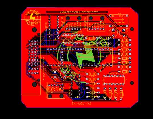

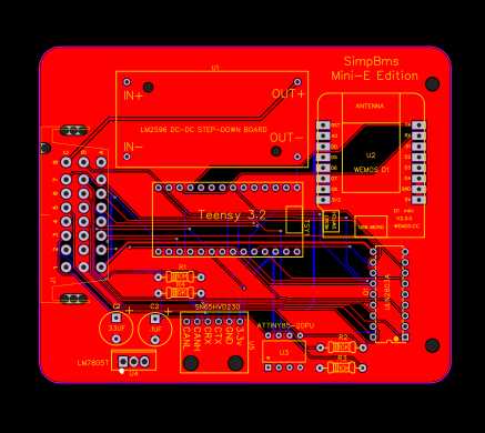

Today I managed to buy probably the last piece of teensy 3.2 for little money. And now I have a question.
I want to use
https://oshwlab.com/aot93/mini-e-t4-vcu_copy to control the inverter from outlander
and as bms
https://oshwlab.com/aot93/simpbmsminimal
the question here is if I program it with the soft https://github.com/Tom-evnut/ImievBMSV2 will it all work together. Because I have original batteries from i-miev and I want to use them.

Short answer is no.
The code base needs to be modified to work with these boards.

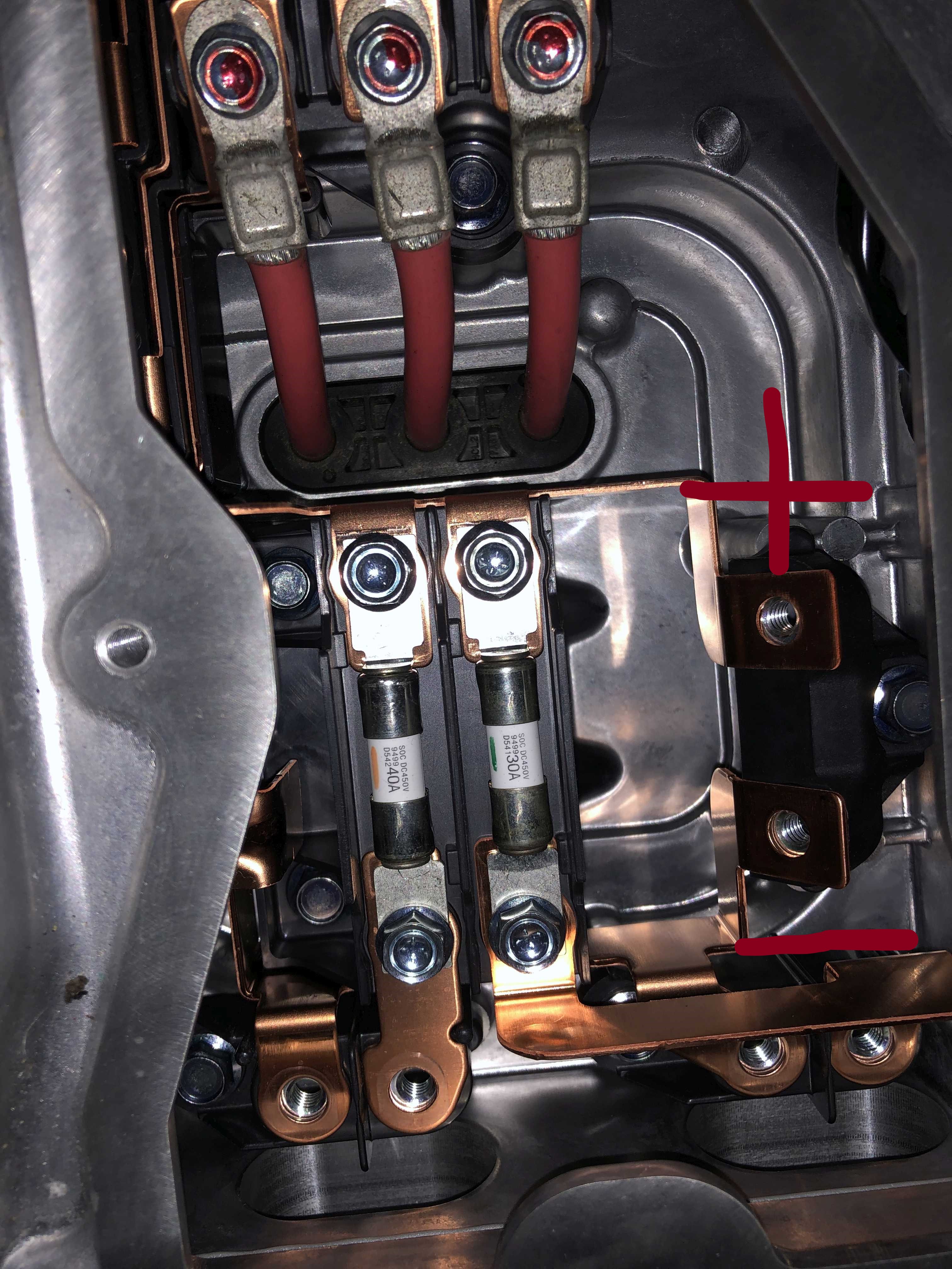

I have a question, do I think correctly that this is how the poles of the battery wires should be connected? This is the rear inverter from the outlander

Thanks, just wanted to confirm that I'm thinking right

youngpoland wrote: Mon Feb 20, 2023 7:12 am I have a question, do I think correctly that this is how the poles of the battery wires should be connected? This is the rear inverter from the outlander
In outlander inverter +HV is on the side of the fuses. Simple, just follow the fused rail to your positive terminal.
