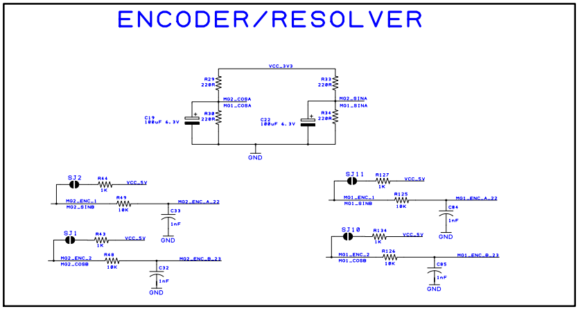

I have such a walking question about connecting the resolver to this board. I saw on the wiki describe the connectors but there are two pins for sin, cos and exciter. How should I connect them to the mg2 inputs in the inverter?

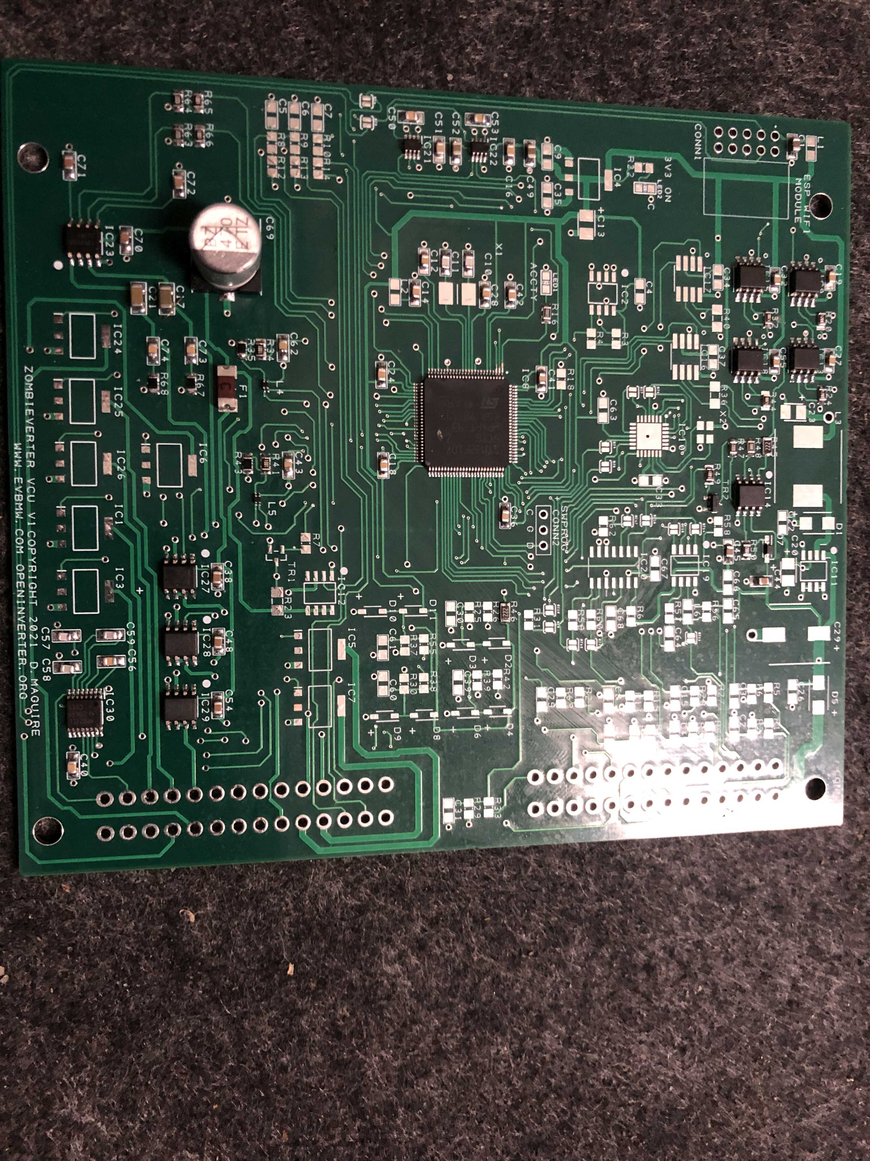

Finally, the assembled boards have arrived from jlcpcb. I am starting to assemble the connectors removed from the yaris inverter board.

the board is already alive after programming
I did everything step by step like this friend on YT

I have a question for people with more experience than me. Below I have compiled the connector from the dual_v1d board and the resolver from the outlander rear drive unit, is this connection correct?
bexander
Posts: 866
Location: Gothenburg, Sweden
Has thanked: 71 times
Been thanked: 97 times
Re: Peugeot 306 '98 conversion
Post by bexander »
youngpoland wrote: Wed Feb 08, 2023 5:06 am I have a question for people with more experience than me. Below I have compiled the connector from the dual_v1d board and the resolver from the outlander rear drive unit, is this connection correct?
No, S3 and S4 does not go to ground. Should be connected to MG2_ENC_1 and MG2_ENC_2, one to each. That is the resolver inputs.
ok like that

Post by bexander »
Yes, that looks correct to me.

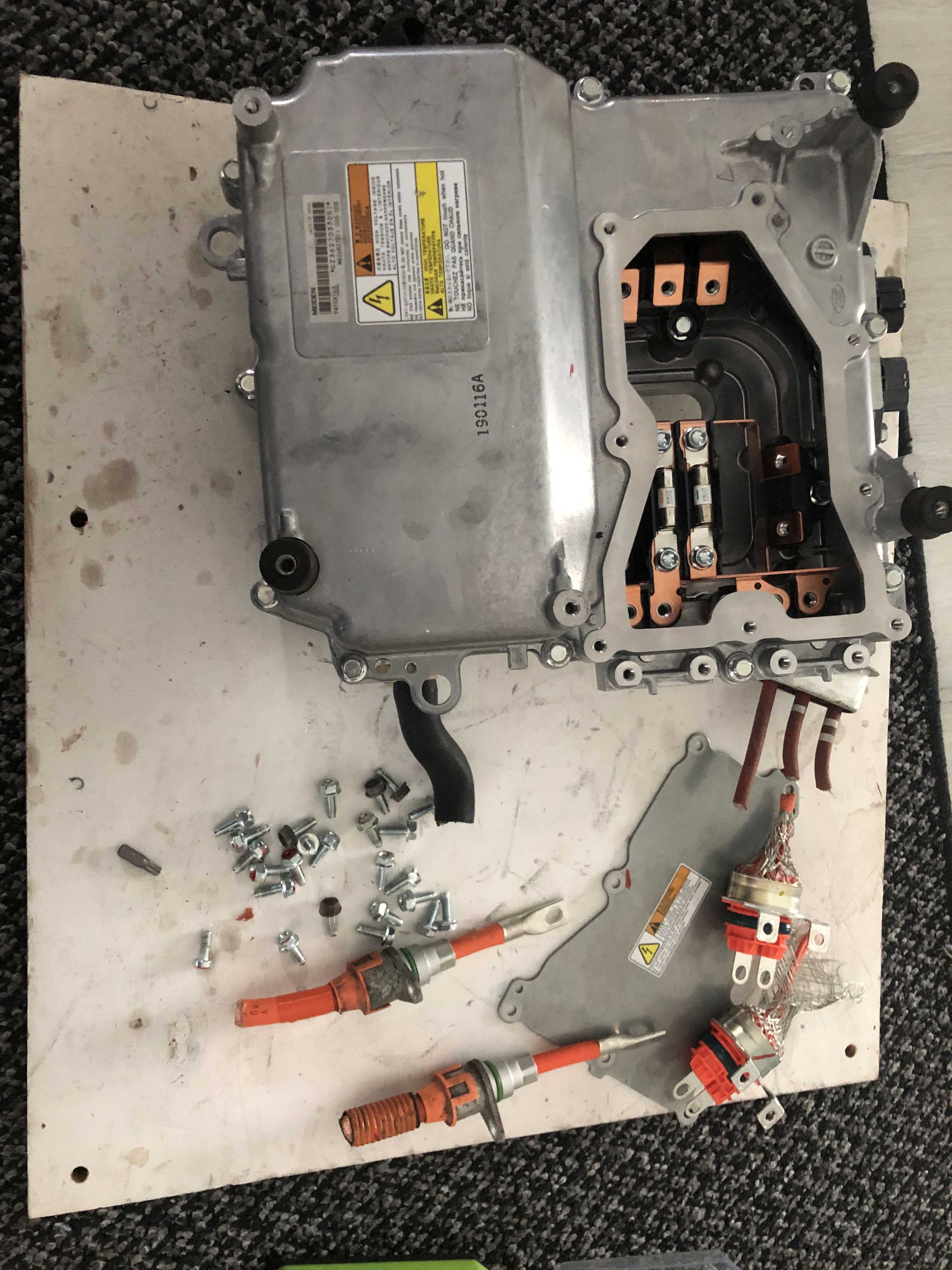

I have a question, do I think correctly that this is how the poles of the battery wires should be connected? This is the rear inverter from the outlander

Thanks, just wanted to confirm that I'm thinking right

youngpoland wrote: Mon Feb 20, 2023 7:12 am I have a question, do I think correctly that this is how the poles of the battery wires should be connected? This is the rear inverter from the outlander
In outlander inverter +HV is on the side of the fuses. Simple, just follow the fused rail to your positive terminal.
