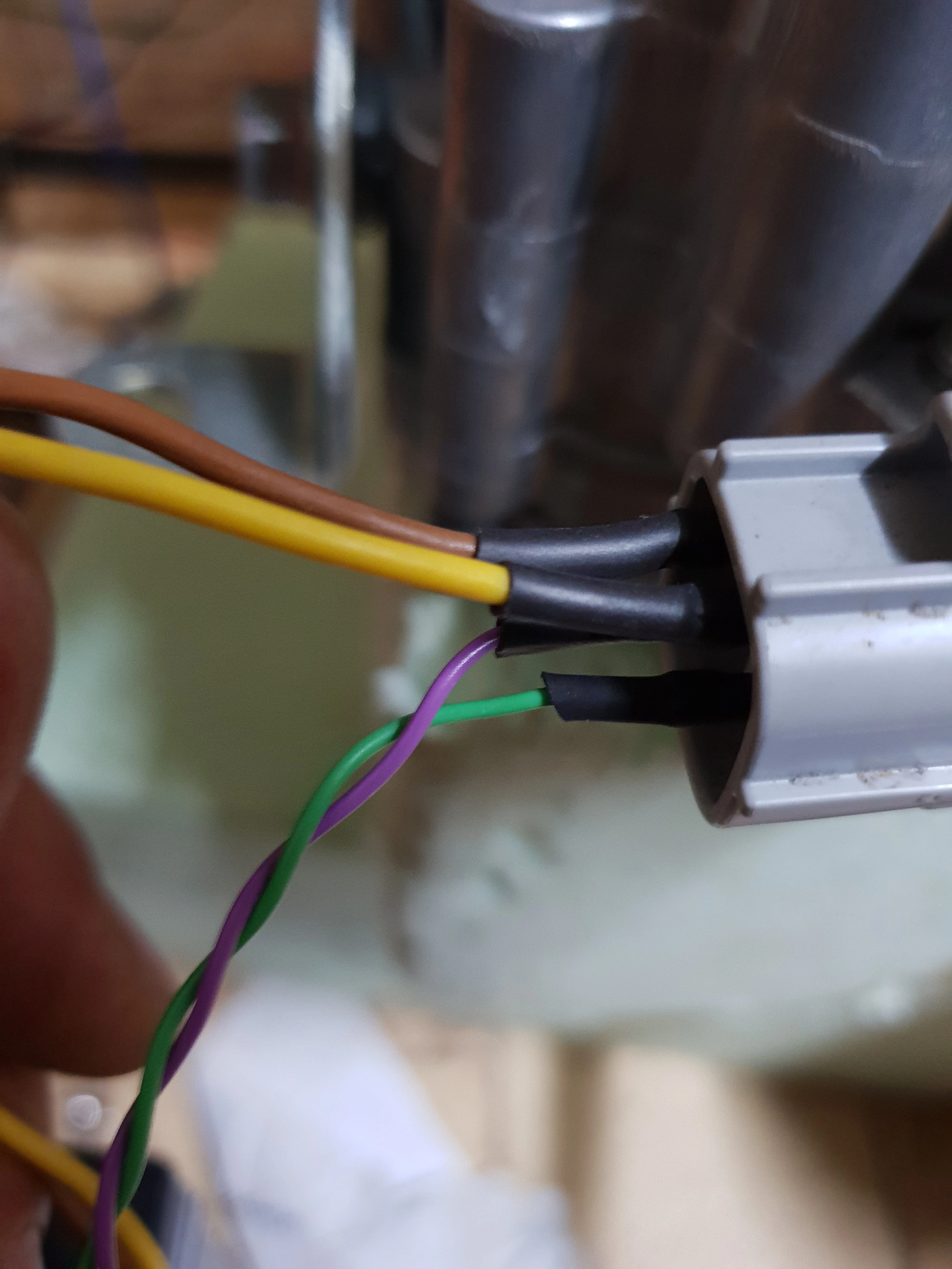

Romale
Posts: 550
Location: Romania
Has thanked: 346 times
Been thanked: 101 times
Re: Outlander PHEV A/C pump
Post by Romale »
the image of the compressor connector in the first post is not very similar to reality. it can be interpreted both straight and upside down. it looks like a drawing of the return connector from the wiring side.
therefore, the question with the picture is: did I understand the pinout correctly?
evil neodymium :twisted:
Posts: 3796
Been thanked: 413 times
Romale wrote: Fri Nov 22, 2024 1:01 pm ... did I understand the pinout correctly?
Yes, D44 connector is male connector on the side of AC compressor.
So the female pins of the opposite side connector will be mirrored.
See here i tested wiring with direct 3mm female fastons connected to compressor D44 connector
https://leafdriveblog.wordpress.com/202 ... er-canbus/
