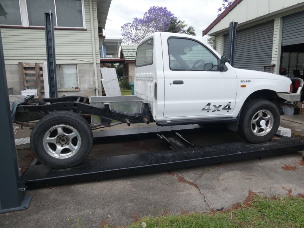

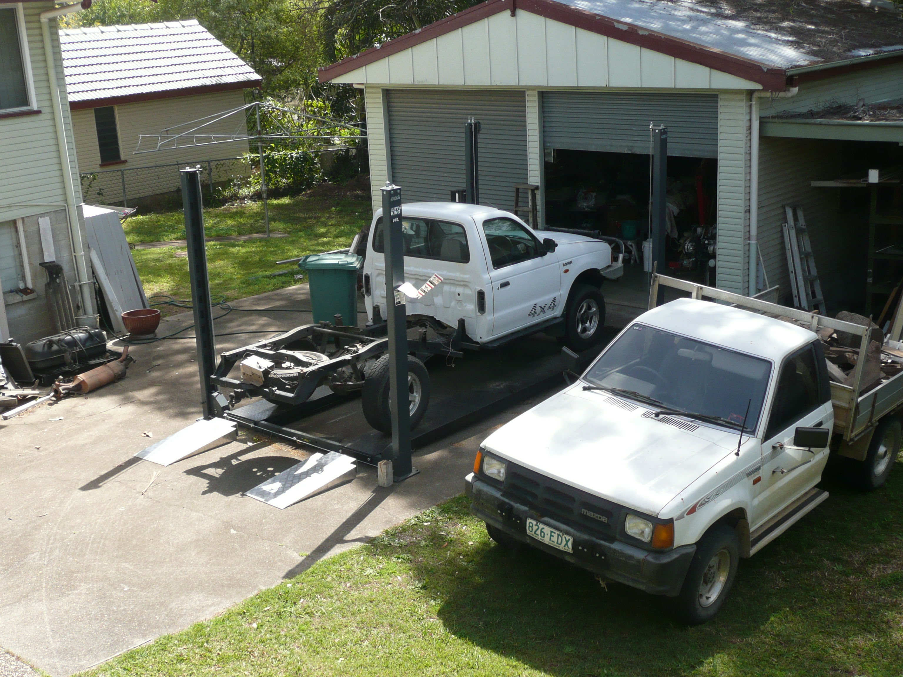

This is my first post on this forum. My brother and I want to convert an old 4x4 Mazda ute and we thought the Leaf gen1 motor might be okay. I'm not sure what my profile shows but we're in Brisbane Australia. It'll be doing city driving for the moment but paddock driving as well. We need the 4wd as the property floods almost every year - not this year though - gulp . We were planning on keeping the clutch, more for the paddock. The Ute will be charged by solar and will also augment the House battery.
I'm planning on having about 235v nominal of LFP batteries. I like the idea of the CAN controlling the LEAF inverter but is there a low voltage requirement that the leaf inverter imposes? Will the inverter allow maximum torque given the lower battery voltage?

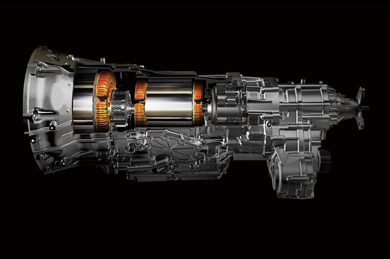

Re: Solar Powered Ute
Welcome
Have a look at the Lexus transmission projects which include bolt on options for AWD and 4WD. Might be a much easier conversion than Leaf/clutch/gearbox. Also supports a very wide range of battery voltage option.mackoffgrid wrote: ↑Fri Jan 03, 2020 11:59 am We need the 4wd as the property floods almost every year - not this year though - gulp . We were planning on keeping the clutch, more for the paddock.
Thank Kevin
I do like the Lexus transmission but I didn't realise it had options for FWD etc. Another weekend (week/month) of researching how that all works
Versions of this gearbox only come in RWD (Lexus GS450h / Toyota Crown hybrid) or 4WD (Lexus LS600h).mackoffgrid wrote: ↑Fri Jan 03, 2020 8:22 pm I do like the Lexus transmission but I didn't realise it had options for FWD etc. Another weekend (week/month) of researching how that all works![]()

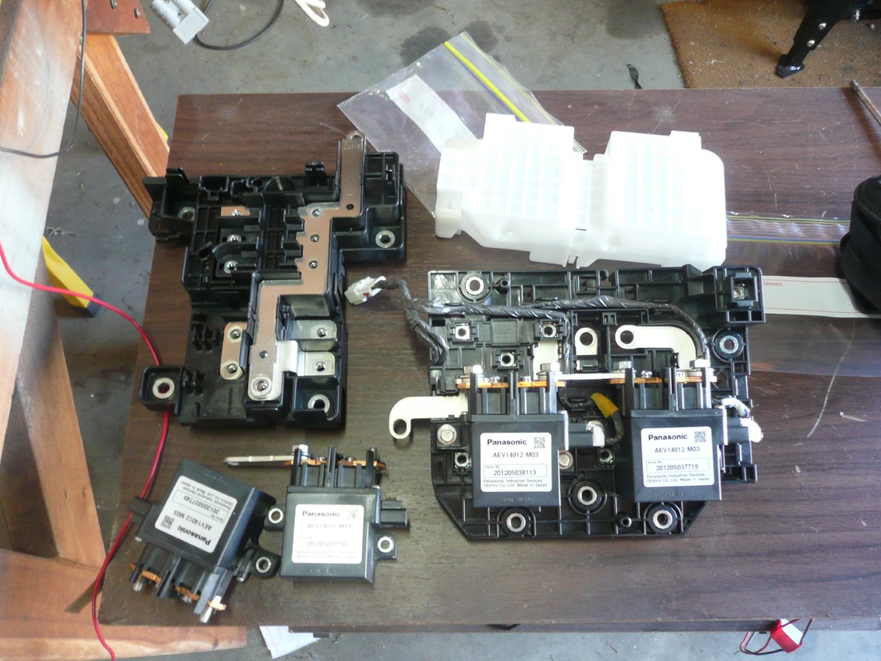

While I wait for the leaf G1 motor to show up I thought I'd sort out some of the basic electrical components.
These parts are not cheap and would like comment on component selection.
We have these or on their way
What do you guys do about a safety/maintenance switch - nothing?
Haven't found a fuse holder yet.
Cheers
Andrew
- LEV200 one at each end of the battery string.
- Bussman Fuse 300A Found an alternate supplier of the fuse at about AUD40 ish
- Vacuum Pump Switch
- Astra (Opal) steering pump.
- Vacuum pump. Hella UP28 , chinese copy
Cheers
Andrew

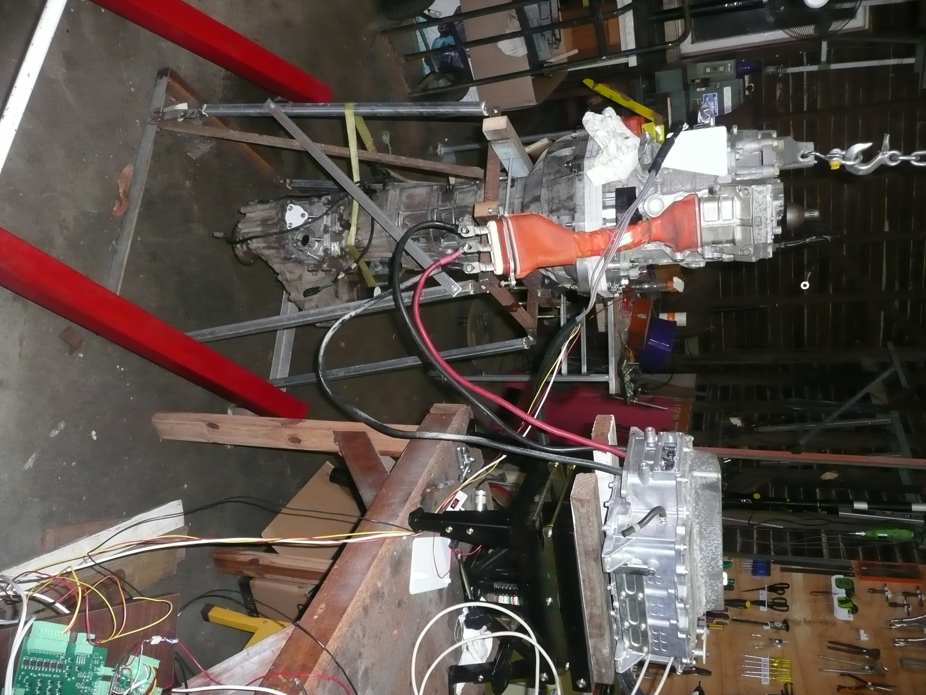

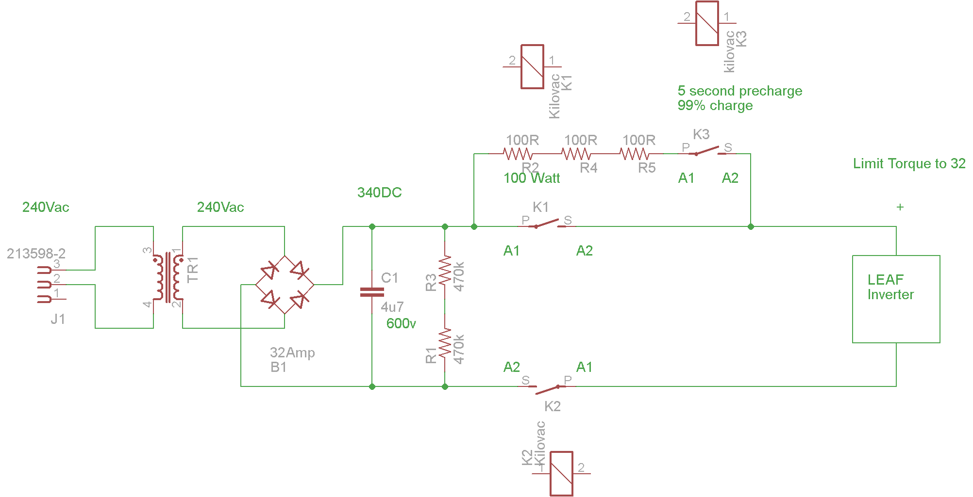

We have our Leaf Gen1 motor now, but no battery yet.
I'm controlling the motor using CAN messages to the Leaf inverter.
I found that under about 175 volts the inverter gives an error.
I used Mains AC to test the motor, limited the Torque to under 32 and it still achieved about 3700 RPM at about 2 amps.

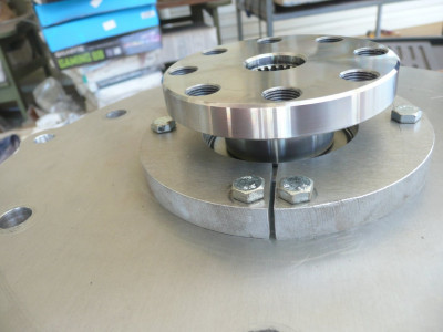

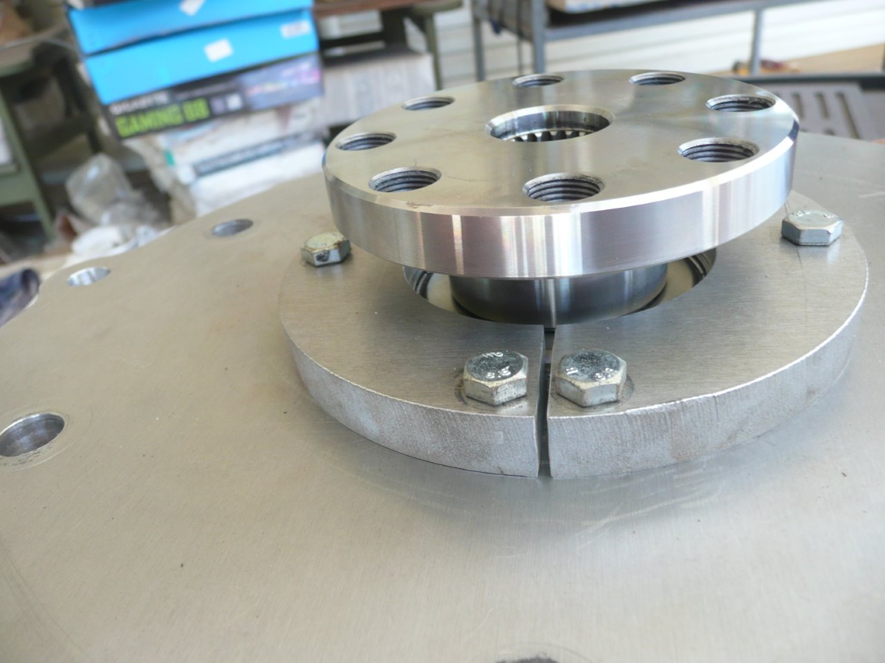

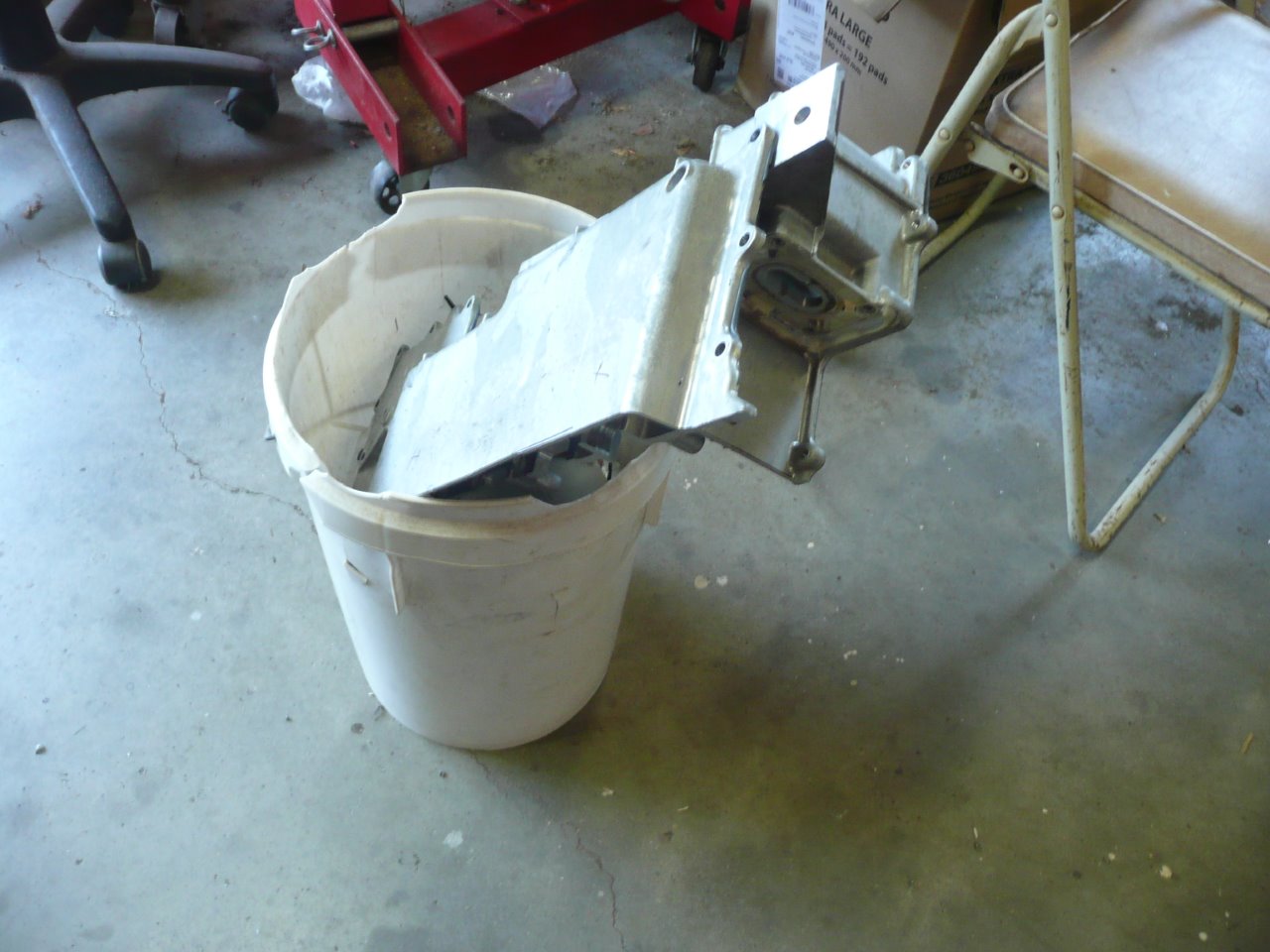

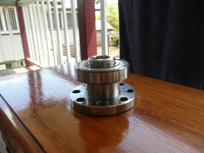

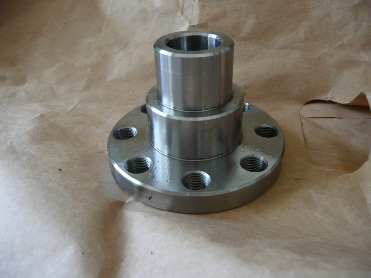

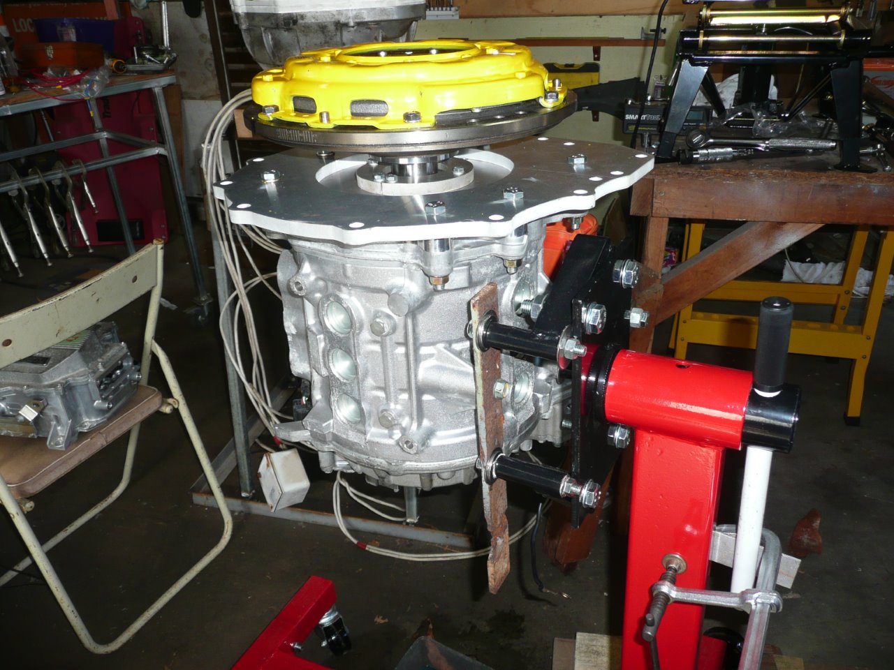

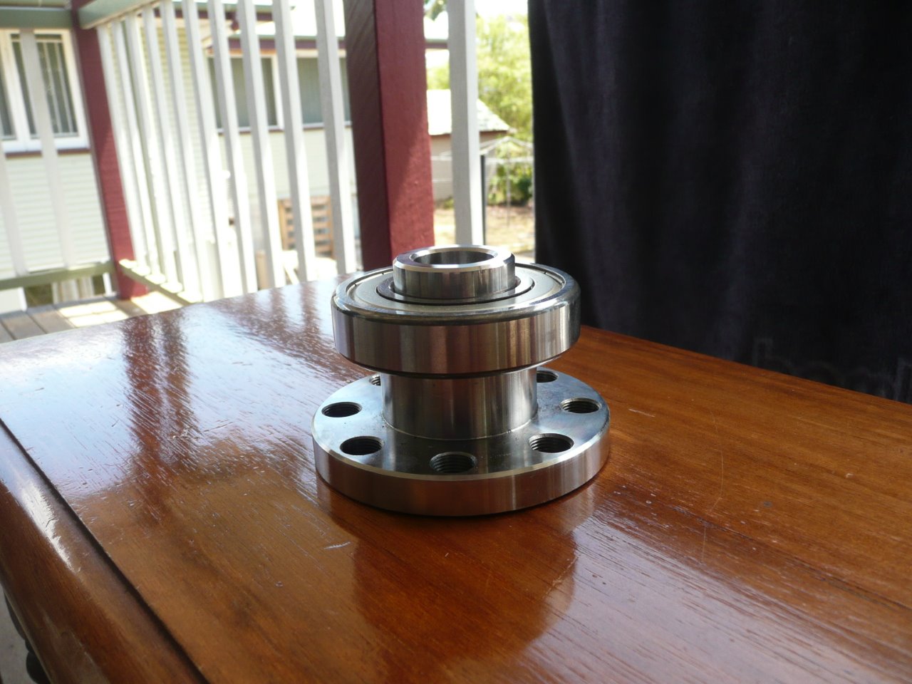

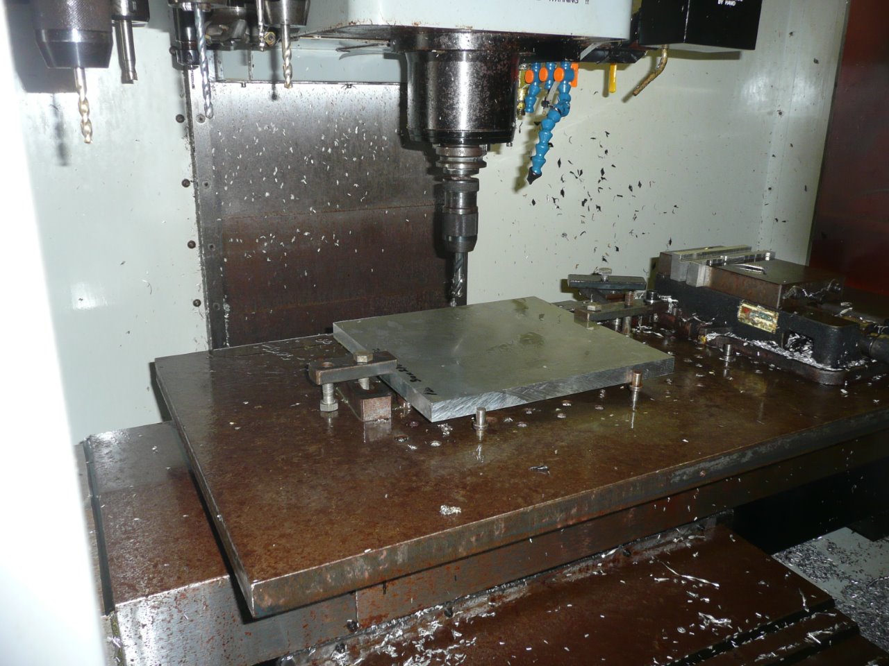

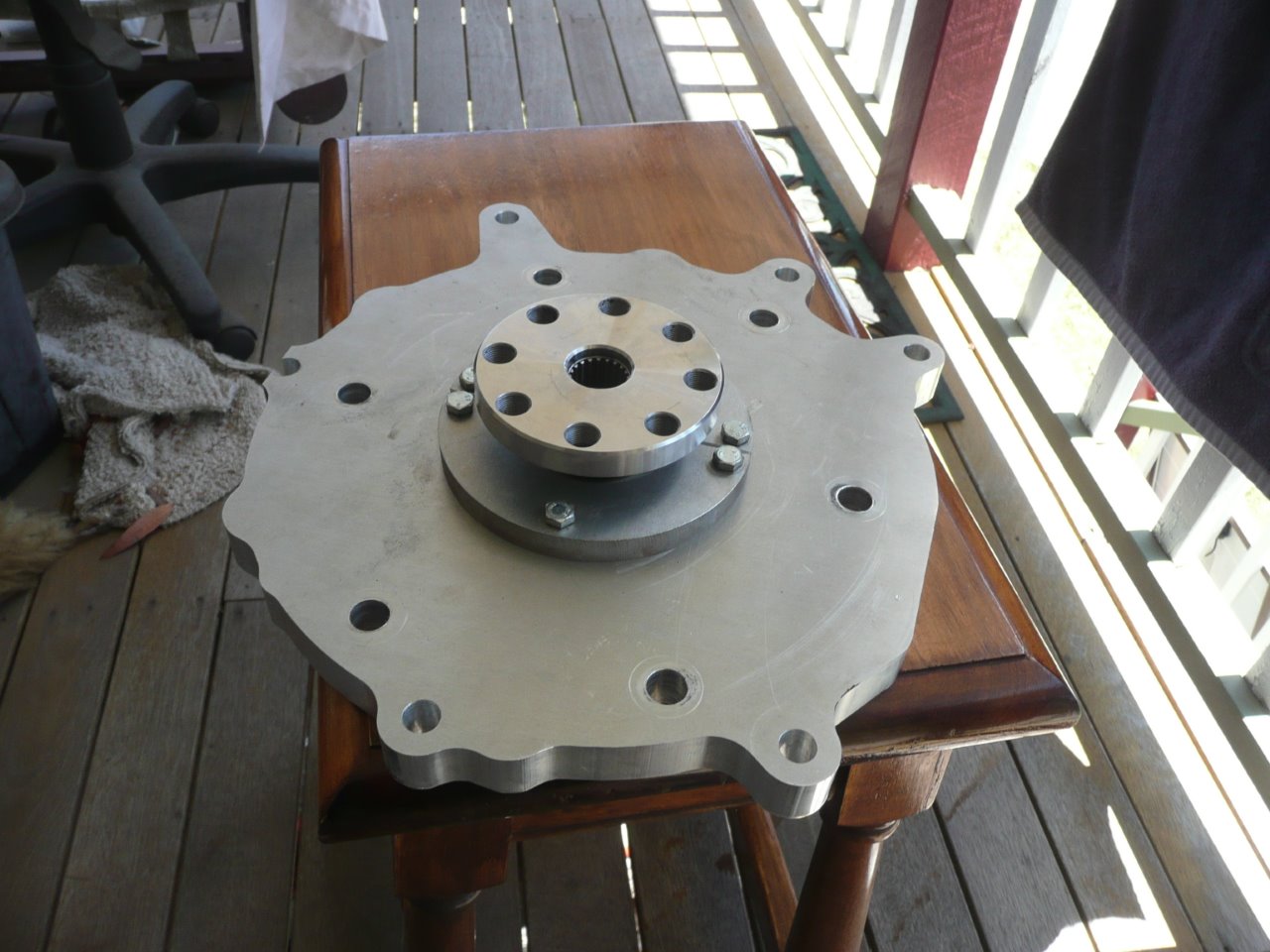

We spent quite a bit of time designing the coupler and adapter plate.
https://github.com/mackelec/SolarUte/tr ... /Fusion360
We printed a 3d version of the coupler and gave that to a local firm along with the motor to produce the coupler.
A friend of ours has this beaut milling machine
Coupler with it's thrust bearing

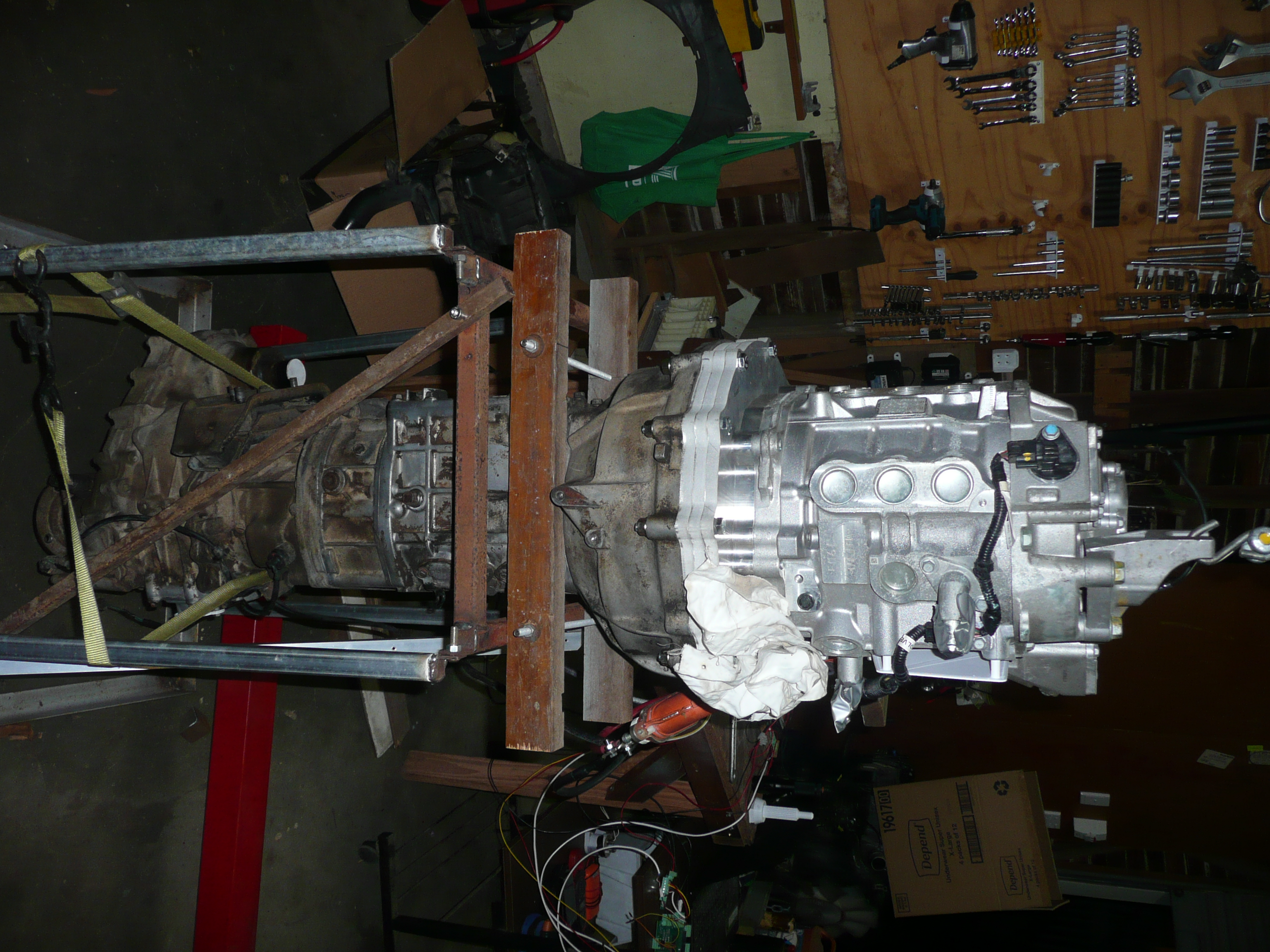

Attaching the Leaf Motor to Gearbox
We wanted to run up the motor fitted to the gearbox on the vertical. The Gearbox is quite heavy - 75kg. The frame suspended the gearbox free of the ground and the hoist was there just as a precaution.
Our mate Francisco features in this video, a man of action, wanting us to slip the motor-gearbox into the Ute that night - We got half way there
It took us another 5 days days to get it in - and we still don't know how we did it
but it took the hoist and a couple of trolley jacks and about 6 heavy garden sleepers. If we did this again, we'll make a gantry crane, that will work over the hoist.
https://odysee.com/@solarUte:4/P1070870:a

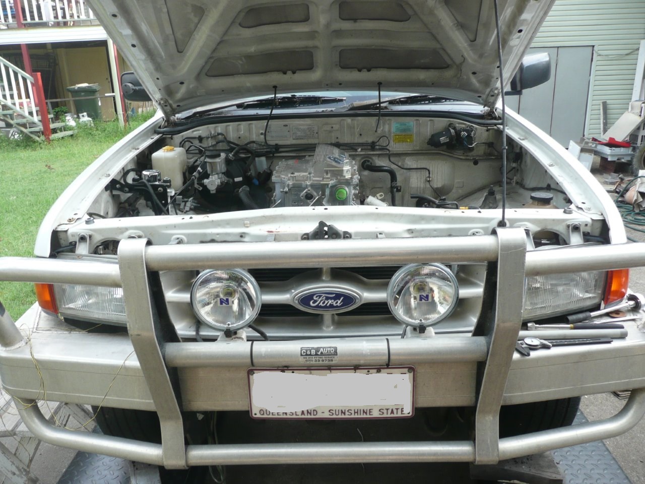

The Engine Bay
Engine (Motor) mounts done.
Inverter mounted.
Aircon Compressor mounted.
Yes - the bonnet does shut
Inverter mounted.

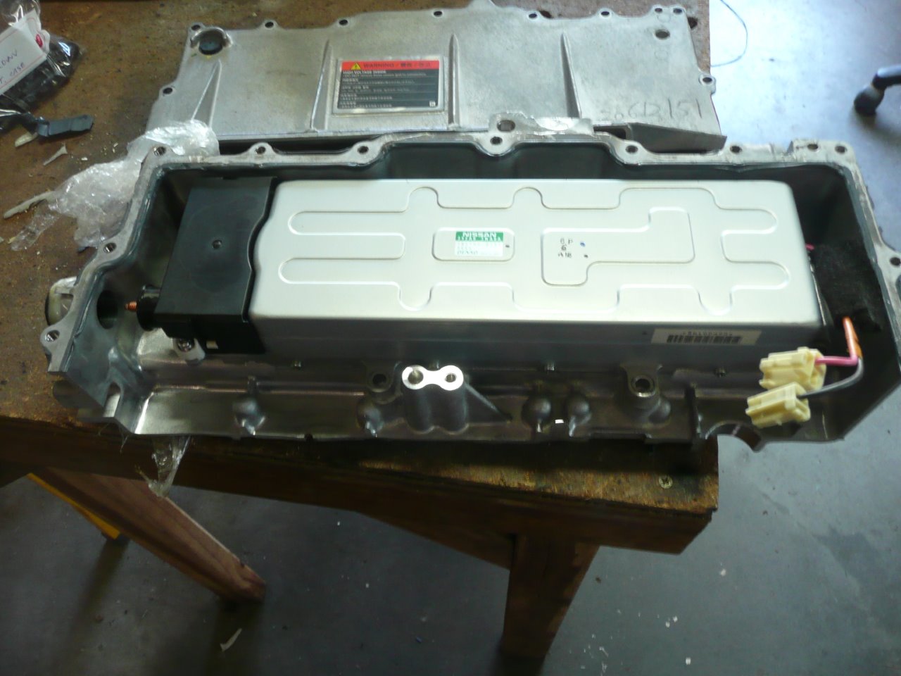

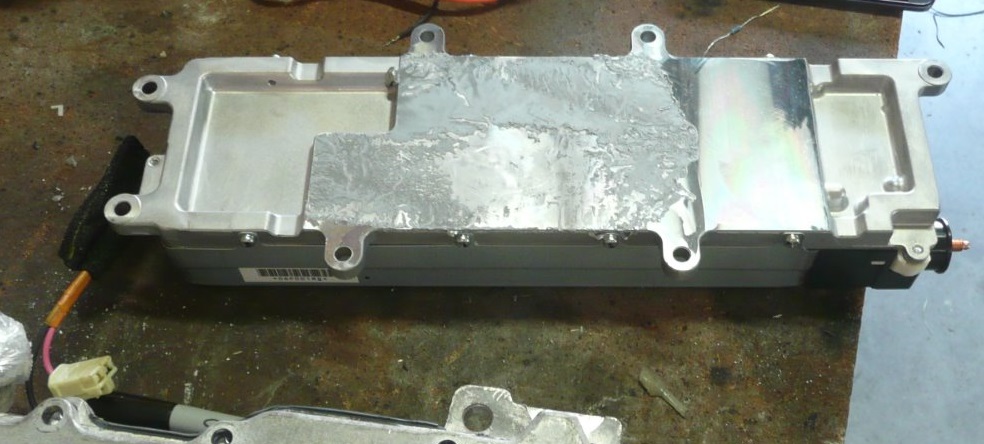

Leaf DC-DC Converter
It was decided that we didn't need the LEAF PDM (Power distribution Module) but we do want the DC-DC converter.
We tested the DC-DC converter and it work's fine, even with 208v of a prius battery. It did like a bit of load. So we could vary the output with a 8.5Hz 5v PWM from 13v up past 14v.
We also thought we want to keep that water jacket
so ......
Now we just have to work out how to seal the bottom side
so ......

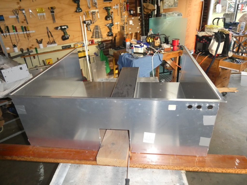

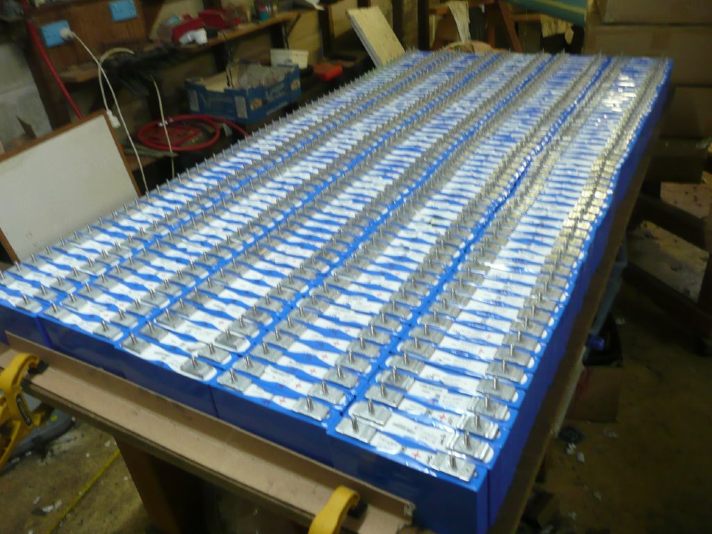

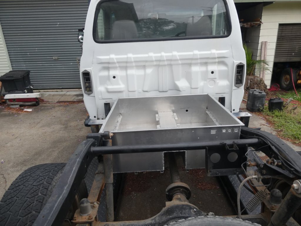

300 LTO Cells
These will be configured into a string of 150.
One third will go under the bonnet and the rest will go under the tray.

Pairing the Cells
The supplier of the 30Ah yinglong LTO cells was kind enough to capacity test each cell, - I imagine they use some EIS method of determining Ah capacity, happily, all were over 30Ah with the average being 32.8 Ah.
So the intention is to pair the cells up (nom 60Ah) so it will be 2P 150S.
So the next question is, how to determine the optimal pairing of cells? Randomly - No. well you could - but no. What I will try to achieve in pairing the cells is to get the most consistent combined Ah (smallest SD), with the highest minimum Ah.
I have all the Ah measurements which the supplier provided, all but 5 where the stickers were damaged etc so I put together a discharge tester and measured those five cells as well as a cell that was closest to the mean, 32.8Ah. I am please to say that the suppliers figures track my own
So I thought about writing a brute force program to calculate the optimal pairing. Then I started analyzing the size of the combinations - whoa.
Npairings = n! / (m!*2^m)
where n=300 and m=150
A very large number
My math skills have much diminished over the years so please correct me if I am wrong.
So, as a reasonable compromise I entered all the cell capacities into a spreadsheet and just matched the largest capacity with the smallest capacity and so on. This left me with a SD of 435mAh in a nom. 60Ah pair - that will do fine.
A very large number

Where did you source your LTO cells - which supplier? I had initially considered buying LTO and spoke to numerous suppliers in China but dropped the idea due to inability to determine which supplier was reliable and that's too much money to be scammed out of. How much did you end up paying per cell? I might still consider buying LTO for my second project car.mackoffgrid wrote: ↑Wed Mar 10, 2021 7:40 pm
So, as a reasonable compromise I entered all the cell capacities into a spreadsheet and just matched the largest capacity with the smallest capacity and so on. This left me with a SD of 435mAh in a nom. 60Ah pair - that will do fine.![]()
For my first car I ended up buying Li-ion cells at 40 Ah nominal 192 cells in total. Since cells are used and I have exactly same intention to arrange them in 2P configuration I will have the same job to pair them and I suspect capacities might vary quite a bit because I think I noticed some weak cells in there. It is such a task to capacity test all of them that I am thinking to pair them randomly and just see how they behave when used - if some pairs get discharged/charged faster than others and then swap them over. My plan might totally fail though.
What is SD by the way?

SD = standard Deviation. So One SD in my case is 435mAh which means, 68.2% of all my pairs are within +/-1SD (435mAh) of the mean (65.6Ah)
It sure is. One thought is, instead of testing capacity, is to test internal resistance, and then match them the same way I did. If you bring all the batteries to a similar charge, then use say two 1 ohm resistors, use one for steady state current and pulse the other one in parallel for a ~ second (or x mSec) , internal resistance is the delta-V over delta-I. Should only take some seconds for each test.
I'm thinking of extending my Discharge test jig to incorporate this internal resistance measurement as I thought it'd be interesting to see iR over the discharge curve.
