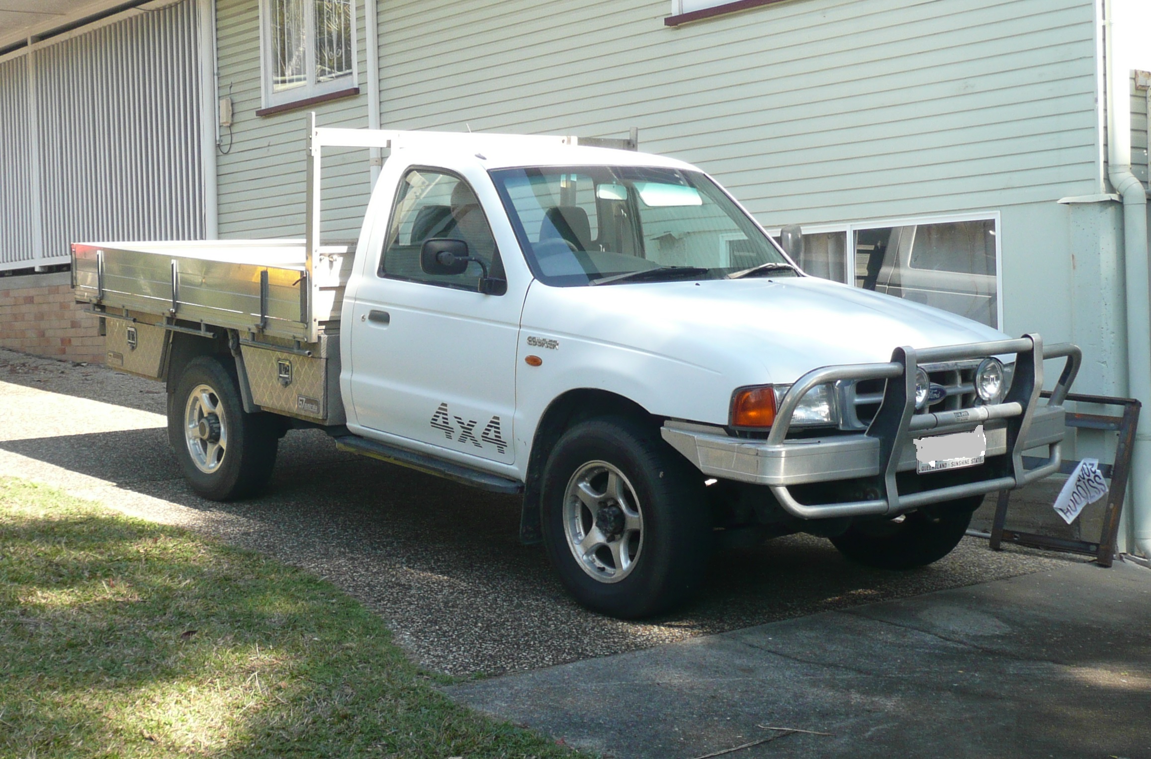

This is my first post on this forum. My brother and I want to convert an old 4x4 Mazda ute and we thought the Leaf gen1 motor might be okay. I'm not sure what my profile shows but we're in Brisbane Australia. It'll be doing city driving for the moment but paddock driving as well. We need the 4wd as the property floods almost every year - not this year though - gulp . We were planning on keeping the clutch, more for the paddock. The Ute will be charged by solar and will also augment the House battery.
I'm planning on having about 235v nominal of LFP batteries. I like the idea of the CAN controlling the LEAF inverter but is there a low voltage requirement that the leaf inverter imposes? Will the inverter allow maximum torque given the lower battery voltage?
Cheers
Cheers

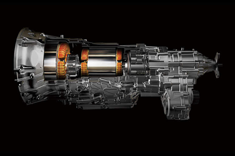

Have a look at the Lexus transmission projects which include bolt on options for AWD and 4WD. Might be a much easier conversion than Leaf/clutch/gearbox. Also supports a very wide range of battery voltage option.mackoffgrid wrote: ↑Fri Jan 03, 2020 11:59 am We need the 4wd as the property floods almost every year - not this year though - gulp . We were planning on keeping the clutch, more for the paddock.

I do like the Lexus transmission but I didn't realise it had options for FWD etc. Another weekend (week/month) of researching how that all works![Smile :)](./images/smilies/icon_e_smile.png)

Versions of this gearbox only come in RWD (Lexus GS450h / Toyota Crown hybrid) or 4WD (Lexus LS600h).mackoffgrid wrote: ↑Fri Jan 03, 2020 8:22 pm I do like the Lexus transmission but I didn't realise it had options for FWD etc. Another weekend (week/month) of researching how that all works![]()

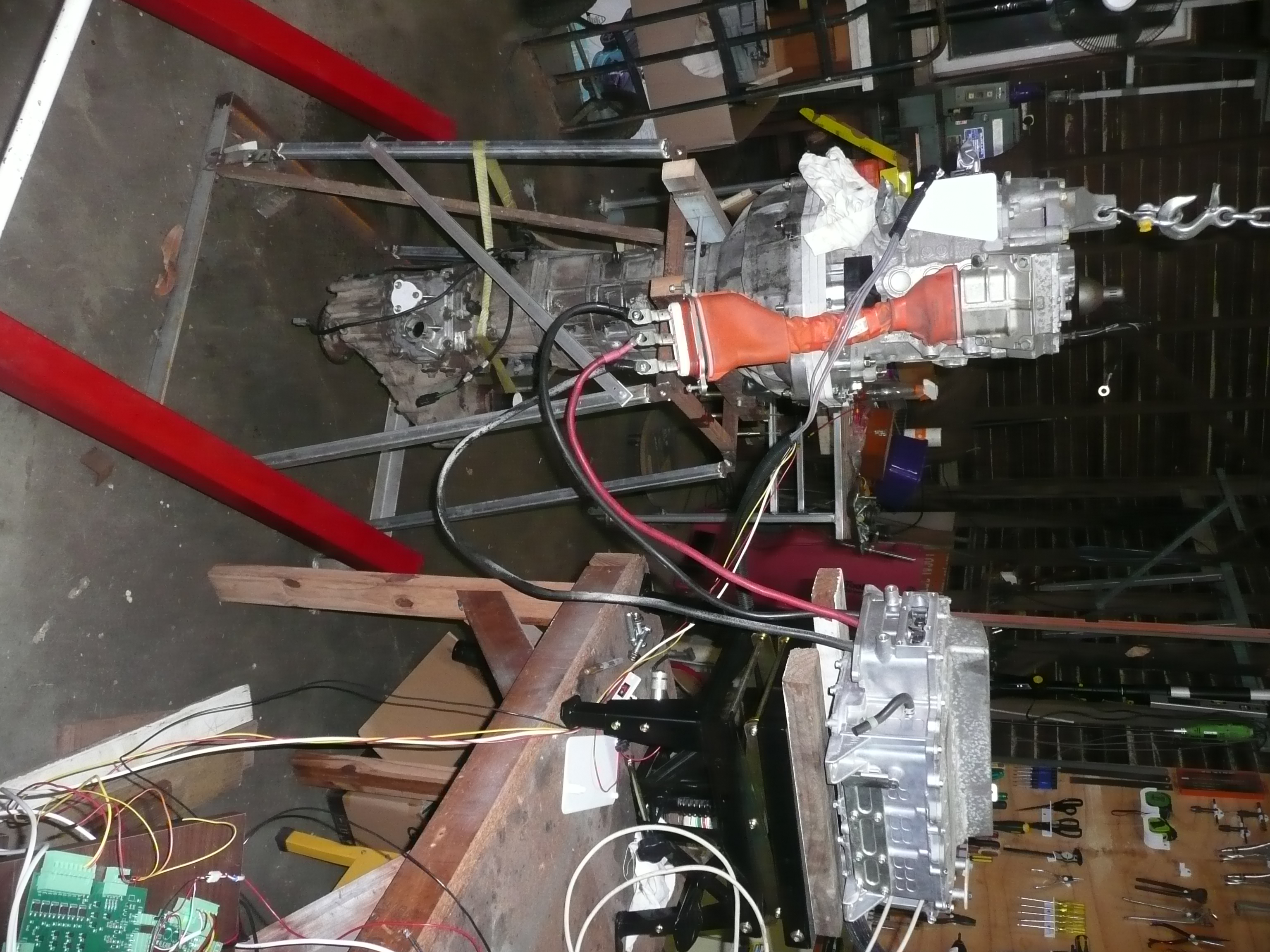

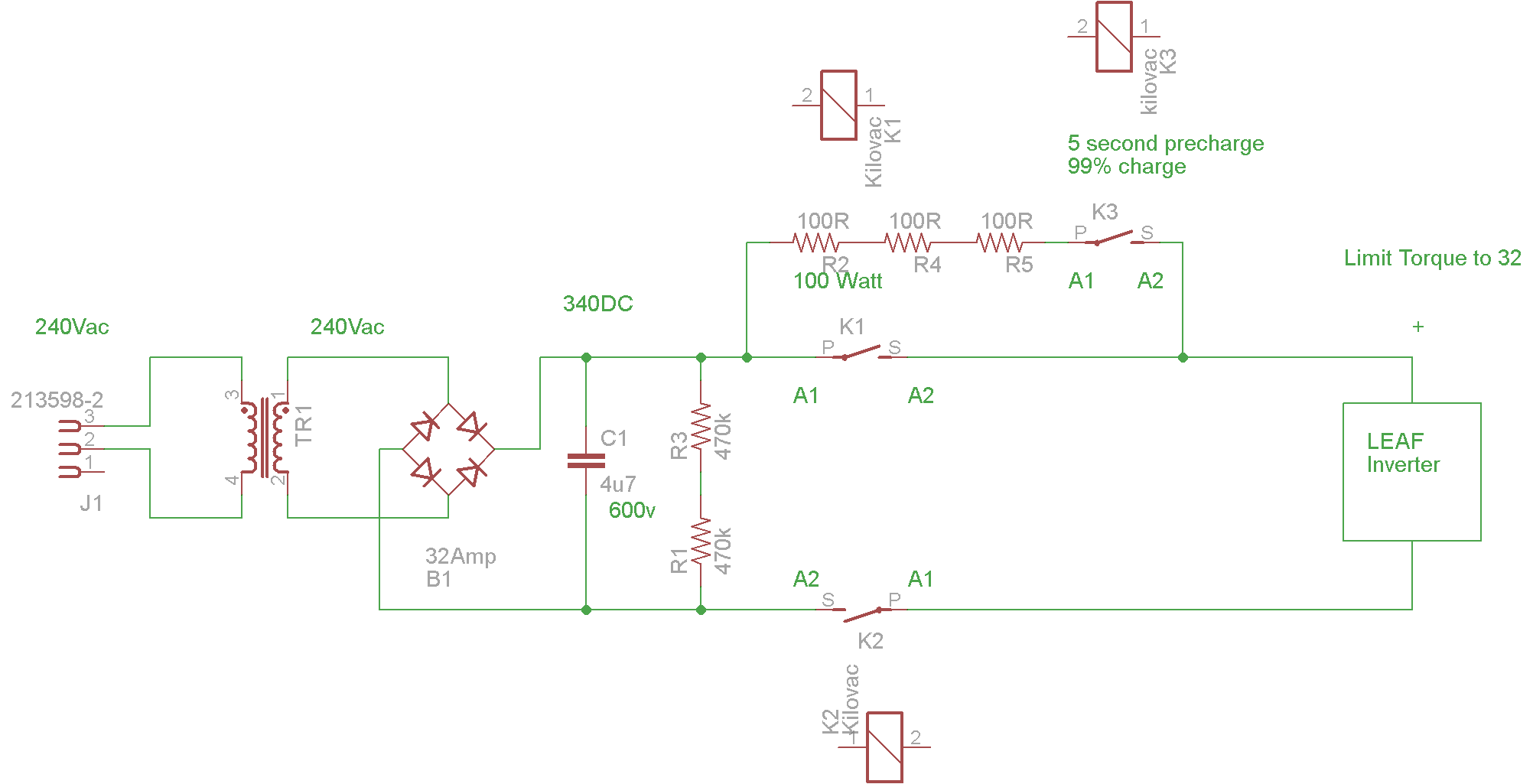

We have our Leaf Gen1 motor now, but no battery yet.
I'm controlling the motor using CAN messages to the Leaf inverter.
I found that under about 175 volts the inverter gives an error.
I used Mains AC to test the motor, limited the Torque to under 32 and it still achieved about 3700 RPM at about 2 amps.

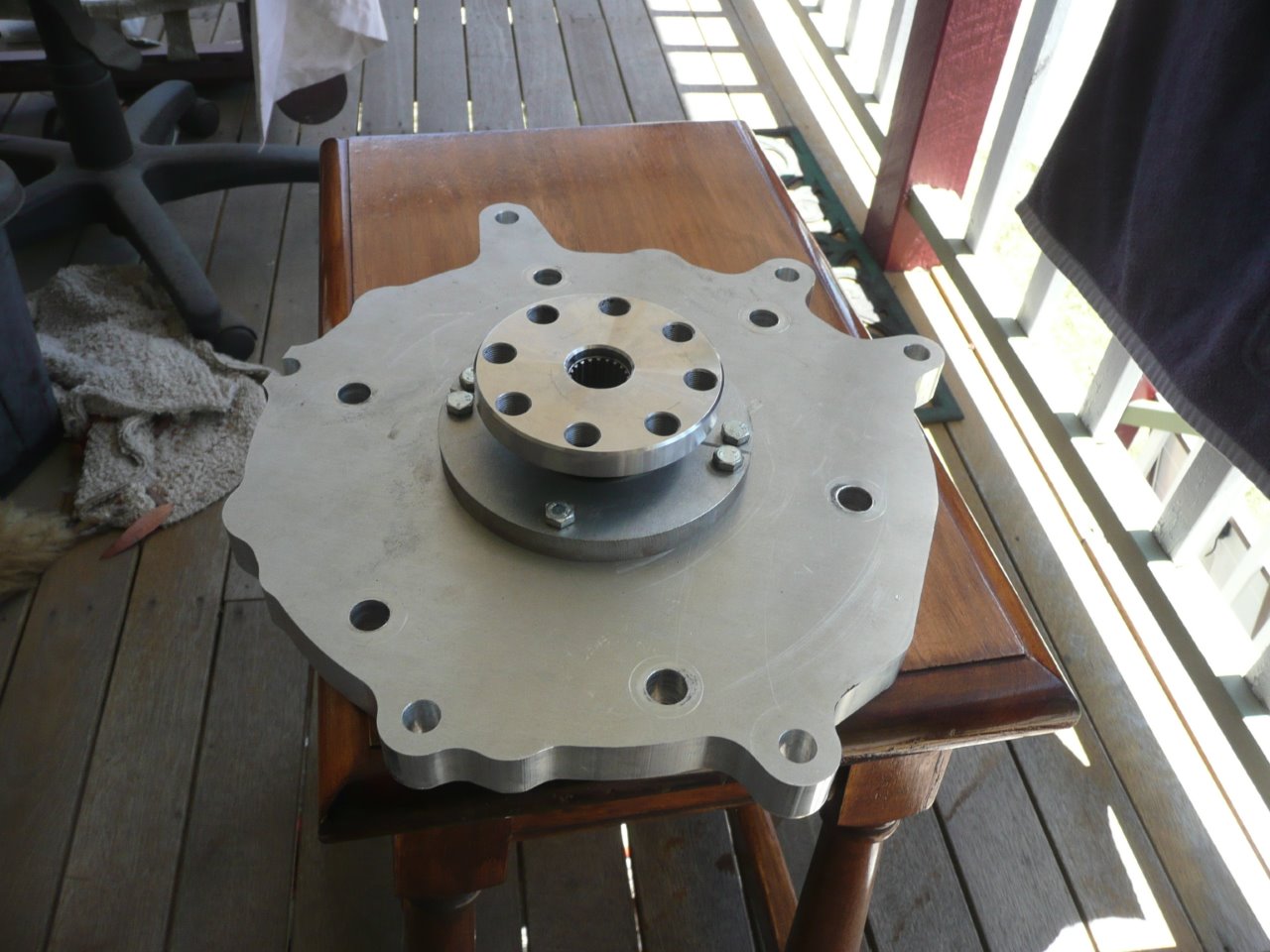

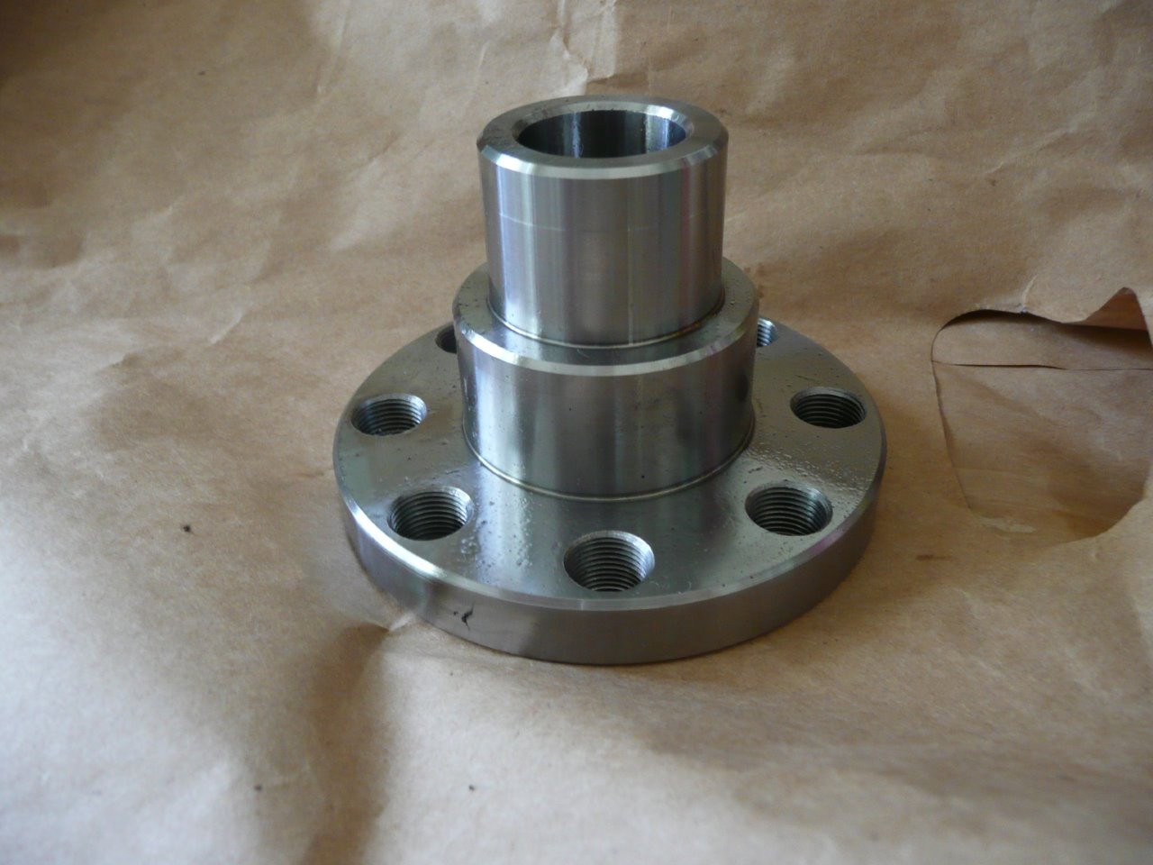

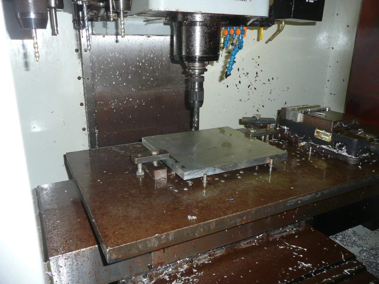

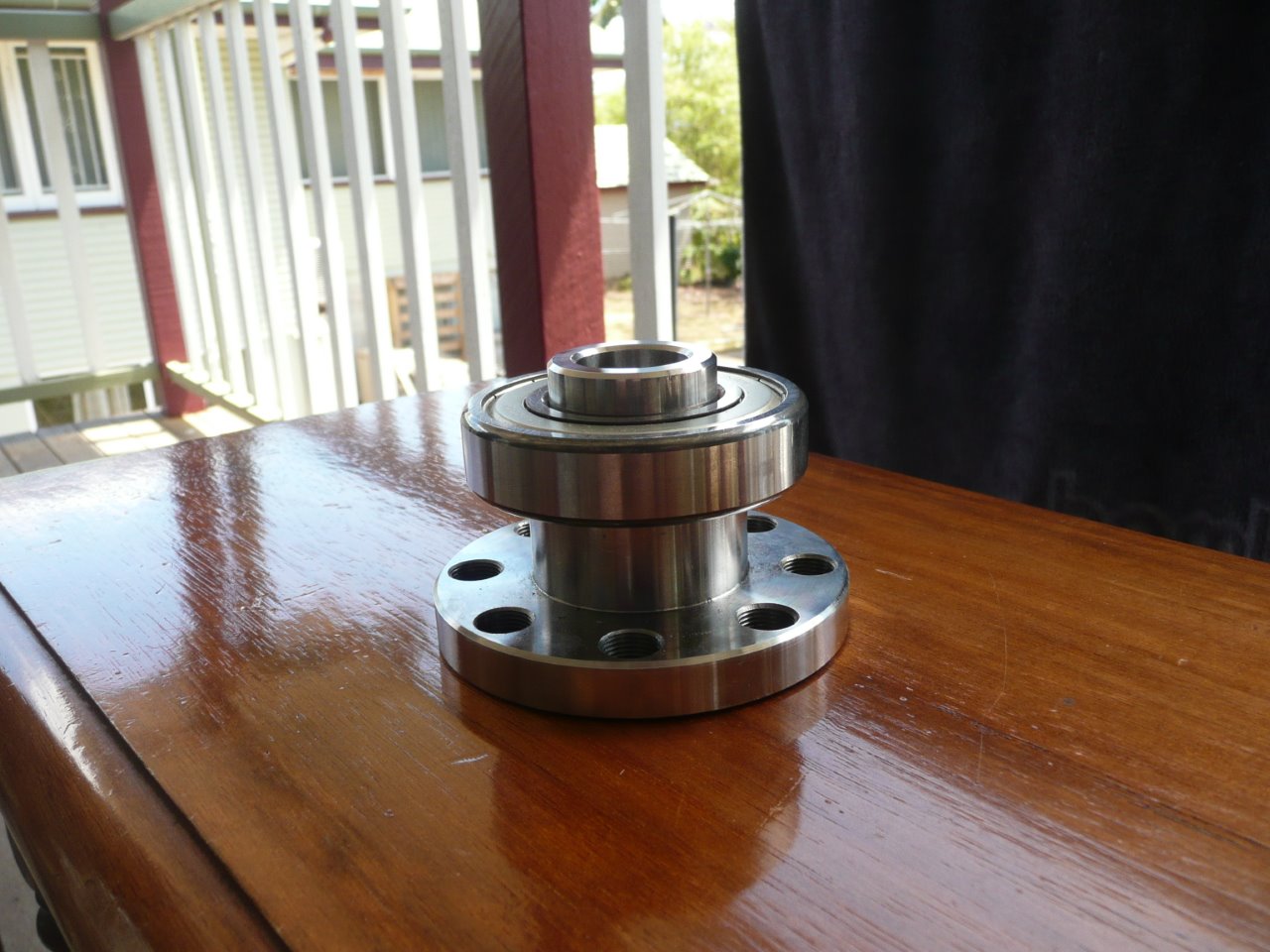

We spent quite a bit of time designing the coupler and adapter plate.
https://github.com/mackelec/SolarUte/tr ... /Fusion360
We printed a 3d version of the coupler and gave that to a local firm along with the motor to produce the coupler.
A friend of ours has this beaut milling machine
Coupler with it's thrust bearing

Attaching the Leaf Motor to Gearbox
We wanted to run up the motor fitted to the gearbox on the vertical. The Gearbox is quite heavy - 75kg. The frame suspended the gearbox free of the ground and the hoist was there just as a precaution.

Our mate Francisco features in this video, a man of action, wanting us to slip the motor-gearbox into the Ute that night - We got half way there
It took us another 5 days days to get it in - and we still don't know how we did it
but it took the hoist and a couple of trolley jacks and about 6 heavy garden sleepers. If we did this again, we'll make a gantry crane, that will work over the hoist.

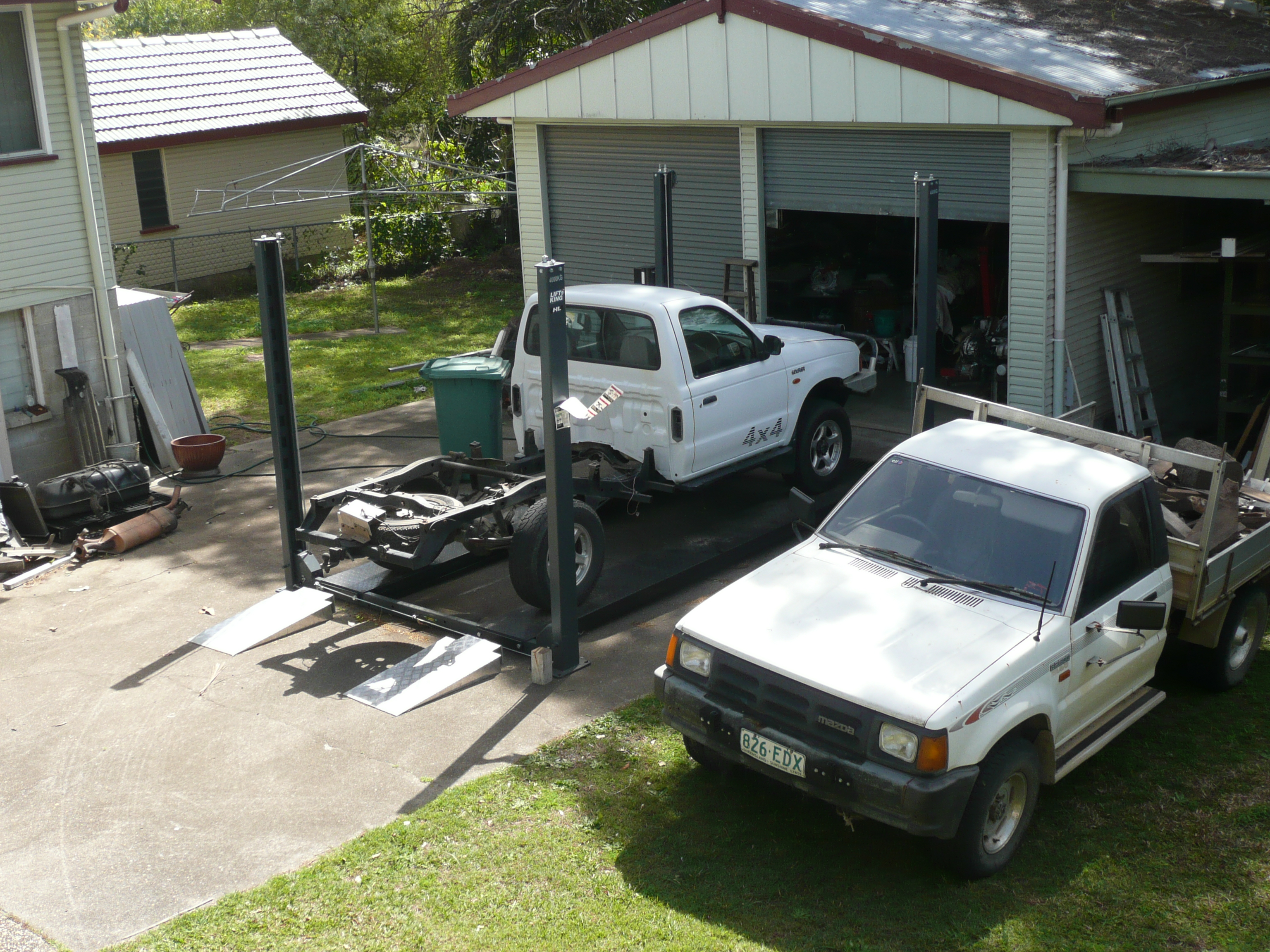

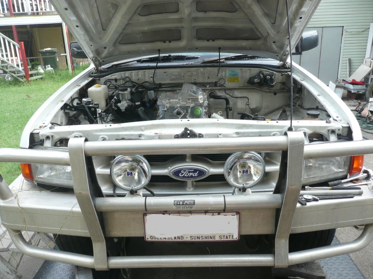

The Engine Bay
Engine (Motor) mounts done.
Inverter mounted.
Aircon Compressor mounted.
Yes - the bonnet does shut![Very Happy :D](./images/smilies/icon_e_biggrin.png)
Inverter mounted.

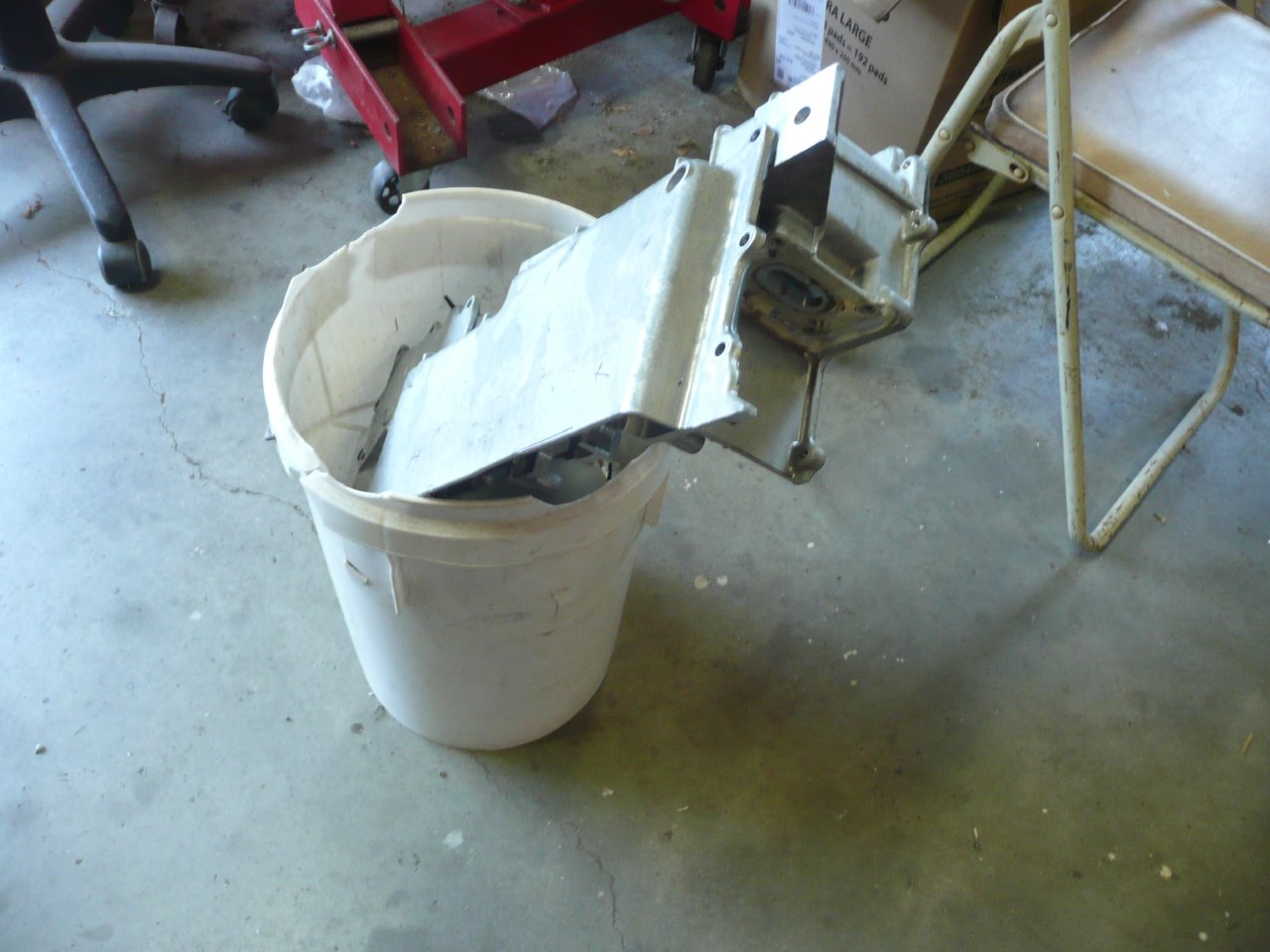

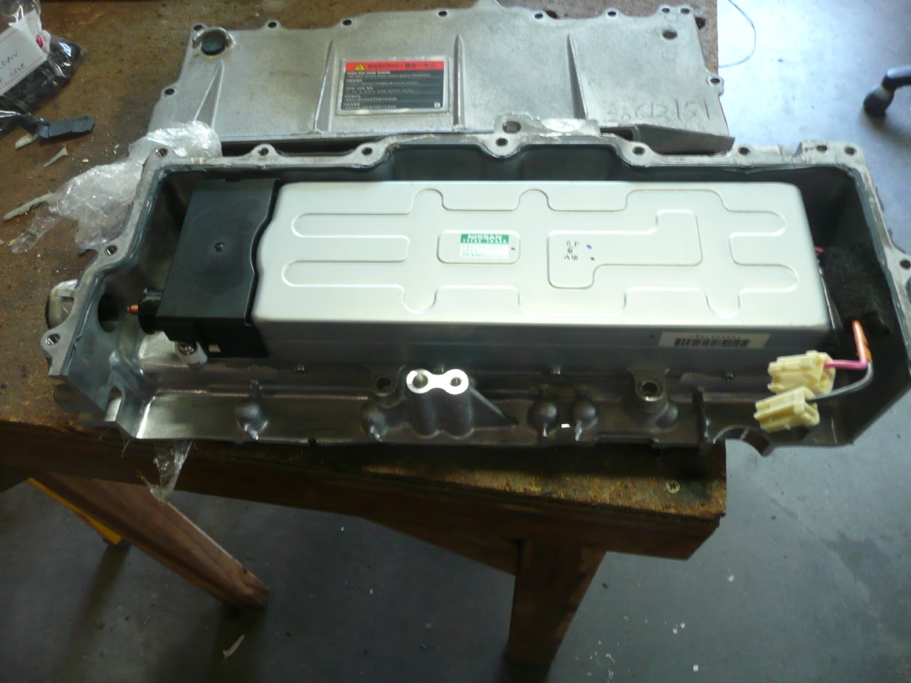

Leaf DC-DC Converter
It was decided that we didn't need the LEAF PDM (Power distribution Module) but we do want the DC-DC converter.
We tested the DC-DC converter and it work's fine, even with 208v of a prius battery. It did like a bit of load. So we could vary the output with a 8.5Hz 5v PWM from 13v up past 14v.
We also thought we want to keep that water jacket![Cool 8-)](./images/smilies/icon_cool.png)
so ......
Now we just have to work out how to seal the bottom side![Laughing :lol:](./images/smilies/icon_lol.png)
so ......
