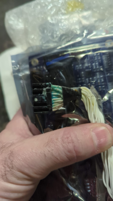

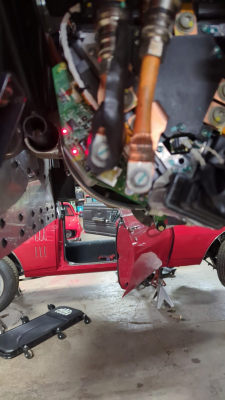

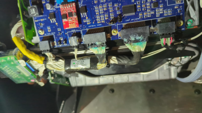

As a side note, they asked how repairable is the inverter in case the coolant leak stops the car (this will be the highest volume scenario) This brings up another major challenge to jump start LDU rebuild capability worldwide. Inverter contains Tesla IP control and IGBT boards which someone else probably can't legally make. Harness, bus bars, plastic/metal structural parts are probably not a problem.
Just as a side note on my INVERTER repair, in my case it turned out solely to be a HARNESS issue. As you may recall, my coolant leak made it into the inverter and here are some photos of the condition of the harness before the repairs took place.
I purchased a new 23 pin harness from ZERO EV, since they make one, but no one sells the harness that attaches to the gate drive board on the three phase blocks, so I thoroughly cleaned that harness and when things still did not work, I assumed my damage was in the DU card initially. I replaced it with a new one and that did not solve my issue.
I then moved onto the phase blocks and assumed that was issue based on these scary looking RED LEDs.
With the help of the amazing Boxster EV, I was able to obtain an untested replacement inverter from him quickly. THANK YOU AGAIN! When it arrived, I disassembled it into the three separate phase blocks and brought them to shop. Without HV connected and just 12V power and the car off, I unplugged the harness from the alleged bad gate drive board and plugged it into each of the three replacement phase blocks and in each case, those RED LEDs lit up again. In order to troubleshoot further, I unplugged the harness from one of the other two phase blocks without RED LEDs and when I plugged those into the phase block that had been lighting it up, it did NOT and the same went for the replacement blocks.
At this point, I surmised that the two red LEDs were supposed to be lit up when the car was off with 12V supplied power (sorry if this is obvious to all of you experienced members). When the car starts up, those RED LEDs disappear. Therefore, it turns out that the coolant exposure damaged the phase block harness and two of the blocks were not getting any power.
Luckily, the replacement inverter from Boxster EV came with a harness and when I put that harness into play, all three of the existing phase blocks lit up with 12V and car off and all went off with 12V and car on. At this point, I tested the inverter and it went into RUN mode for the first time in 2 months. I drove the car home from the shop and everything seems to be operating as it should now.
All of this to say that they PCB cards seem to be heartier than we might think and that the coolant exposure to the wiring harness did not short anything out on my inverter and just kept it from powering on. It might be a project at some point in time to fabricate these harnesses since they are not that complicated to replicate and this could be the most cost efficient solution for a coolant leak into the inverter and a first line of testing things after a coolant leak and inverter failure.

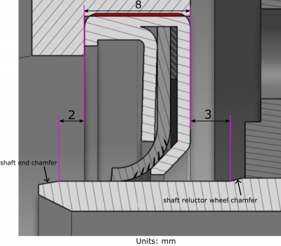

As I have already written, I am in negotiations with a seal manufacturer in Germany. He sent me an interesting draft. I have pointed out that a Speedi Sleeve may be used. He also takes into account the slightly larger diameter and the limited length.
He also has reservations about using Loctite because of the poor heat dissipation. I did some googling and came across this glue.
https://www.sepa-europe.com/wp-content/ ... 000010.pdf

@muehlpower: I don't have time for this yet I can't let go :ugeek: : Very interesting design! It looks like the lip is CNC machined and definitely not formed using a mandrel. Some questions and remarks in random order (I may be dead wrong of course):
1) Does GFD have experience using this design (and @10k RPM with coolant) or is it highly experimental?
2) The left "primary" lip is too close to the shaft end (at least for my LDU which I measured - see my drawing below). Now it would contact the "shaft end chamfer" and probably leak! It must be moved at least 1mm away from the shaft end (relative to the current position in the drawing) in order to have at least 1mm of clearance from that "shaft end chamfer". Which is maybe still not conservative enough. Simultaneously, the excluder lip is allowed to be positioned a maximum roughly 1mm extra away from the shaft end (relative again), so that it has a (reduced) 2mm clearance from the "shaft reluctor wheel chamfer". Why 2mm and not also 1mm? Because my drawing shows the motor in the "cold" configuration. Once heated up, differential thermal expansion can move the shaft roughly 0.5mm deeper into the manifold because the rotor can get hotter than the stator+housing, and also lateral accellerations can "bounce" the rotor roughly 0.5 to 1mm in axial direction (because the rotor is kept in place by a spring and floating bearing on the manifold side), which reduces the clearance to maybe only 0.5 to 1mm. This design is very tight! Seems like Tesla had very little available space ("bauraum" in german) :-)
2) The garter spring seems to be able to "slip off" the lip easily, so maybe add some more material to "cradle" it (keep in place). Especially because I think that the spring pressure must be relatively small (compared to the classic elastomer lips) because too high pressure results in too much frictional forces and thus heat development.
3) Does the steel ring have an interference fit? It shows 55mm nominal only and no tolerance.
4) The excluder lip should ideally maybe have nearly zero pressure on the shaft, maybe even a very tiny gap like the SKF FKM seals, so maybe reduce the interference.
5) What price range?
6) Maybe increase the primary lip contact area (width) to 2mm in order to reduce contact pressure. This is also a benefit from some formed lips (like the Ceimin lips). Just an observation based on Stuttgart PhD work on PTFE seals.
Disclaimer: Despite all efforts, all (which I write) should be conservatively interpreted as a poorly informed, error-prone, non-expert opinion that is subject to continuous change, especially in this age of hyper-specialization and newly gained insights.
