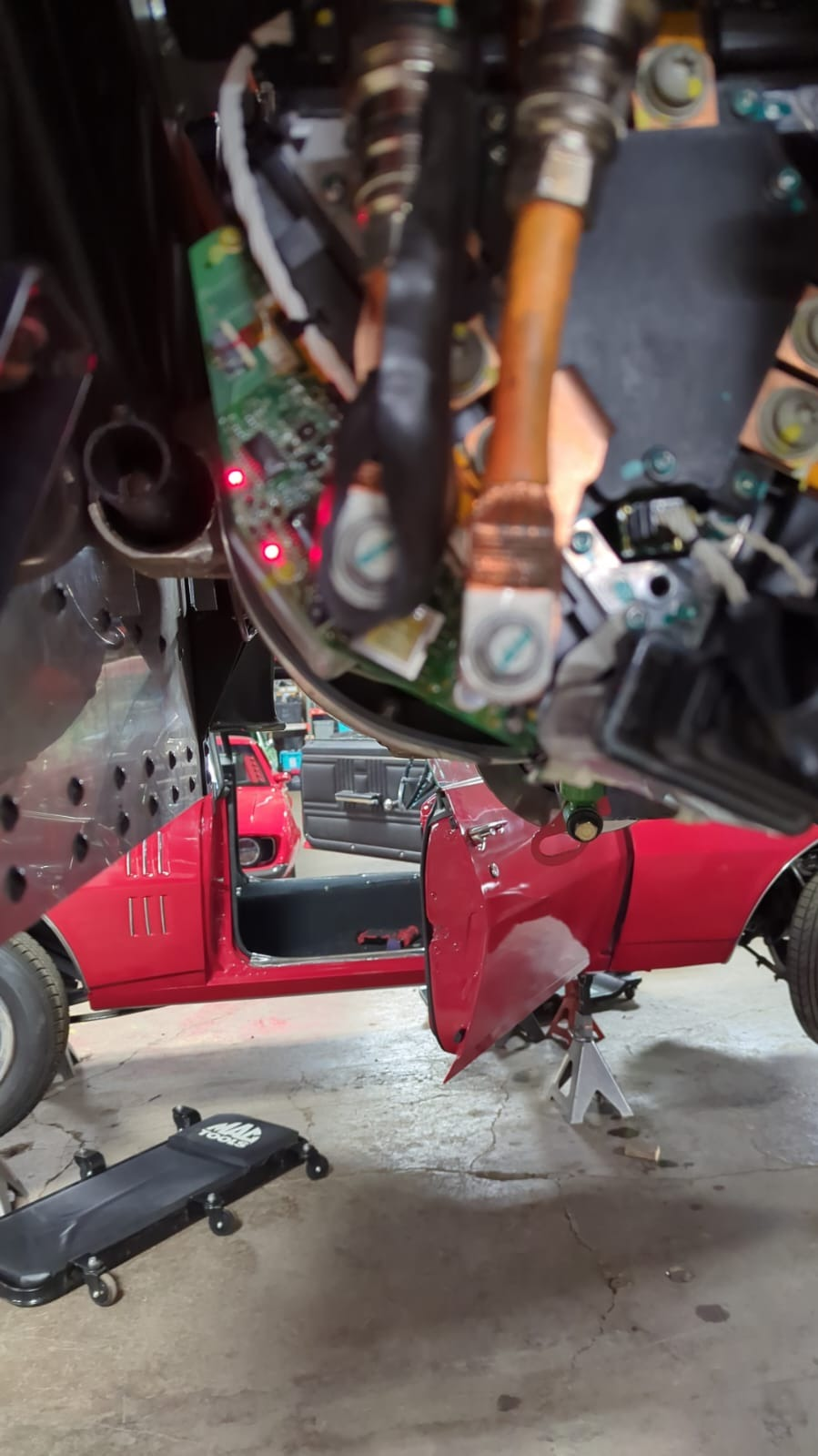

Post by jsimonkeller »
howardc64 wrote: Wed Jan 04, 2023 10:56 pm An update on rotor repair option
As a side note, they asked how repairable is the inverter in case the coolant leak stops the car (this will be the highest volume scenario) This brings up another major challenge to jump start LDU rebuild capability worldwide. Inverter contains Tesla IP control and IGBT boards which someone else probably can't legally make. Harness, bus bars, plastic/metal structural parts are probably not a problem.
Just as a side note on my INVERTER repair, in my case it turned out solely to be a HARNESS issue. As you may recall, my coolant leak made it into the inverter and here are some photos of the condition of the harness before the repairs took place.
I purchased a new 23 pin harness from ZERO EV, since they make one, but no one sells the harness that attaches to the gate drive board on the three phase blocks, so I thoroughly cleaned that harness and when things still did not work, I assumed my damage was in the DU card initially. I replaced it with a new one and that did not solve my issue.
I then moved onto the phase blocks and assumed that was issue based on these scary looking RED LEDs.
With the help of the amazing Boxster EV, I was able to obtain an untested replacement inverter from him quickly. THANK YOU AGAIN! When it arrived, I disassembled it into the three separate phase blocks and brought them to shop. Without HV connected and just 12V power and the car off, I unplugged the harness from the alleged bad gate drive board and plugged it into each of the three replacement phase blocks and in each case, those RED LEDs lit up again. In order to troubleshoot further, I unplugged the harness from one of the other two phase blocks without RED LEDs and when I plugged those into the phase block that had been lighting it up, it did NOT and the same went for the replacement blocks.
At this point, I surmised that the two red LEDs were supposed to be lit up when the car was off with 12V supplied power (sorry if this is obvious to all of you experienced members). When the car starts up, those RED LEDs disappear. Therefore, it turns out that the coolant exposure damaged the phase block harness and two of the blocks were not getting any power.
Luckily, the replacement inverter from Boxster EV came with a harness and when I put that harness into play, all three of the existing phase blocks lit up with 12V and car off and all went off with 12V and car on. At this point, I tested the inverter and it went into RUN mode for the first time in 2 months. I drove the car home from the shop and everything seems to be operating as it should now.
All of this to say that they PCB cards seem to be heartier than we might think and that the coolant exposure to the wiring harness did not short anything out on my inverter and just kept it from powering on. It might be a project at some point in time to fabricate these harnesses since they are not that complicated to replicate and this could be the most cost efficient solution for a coolant leak into the inverter and a first line of testing things after a coolant leak and inverter failure.

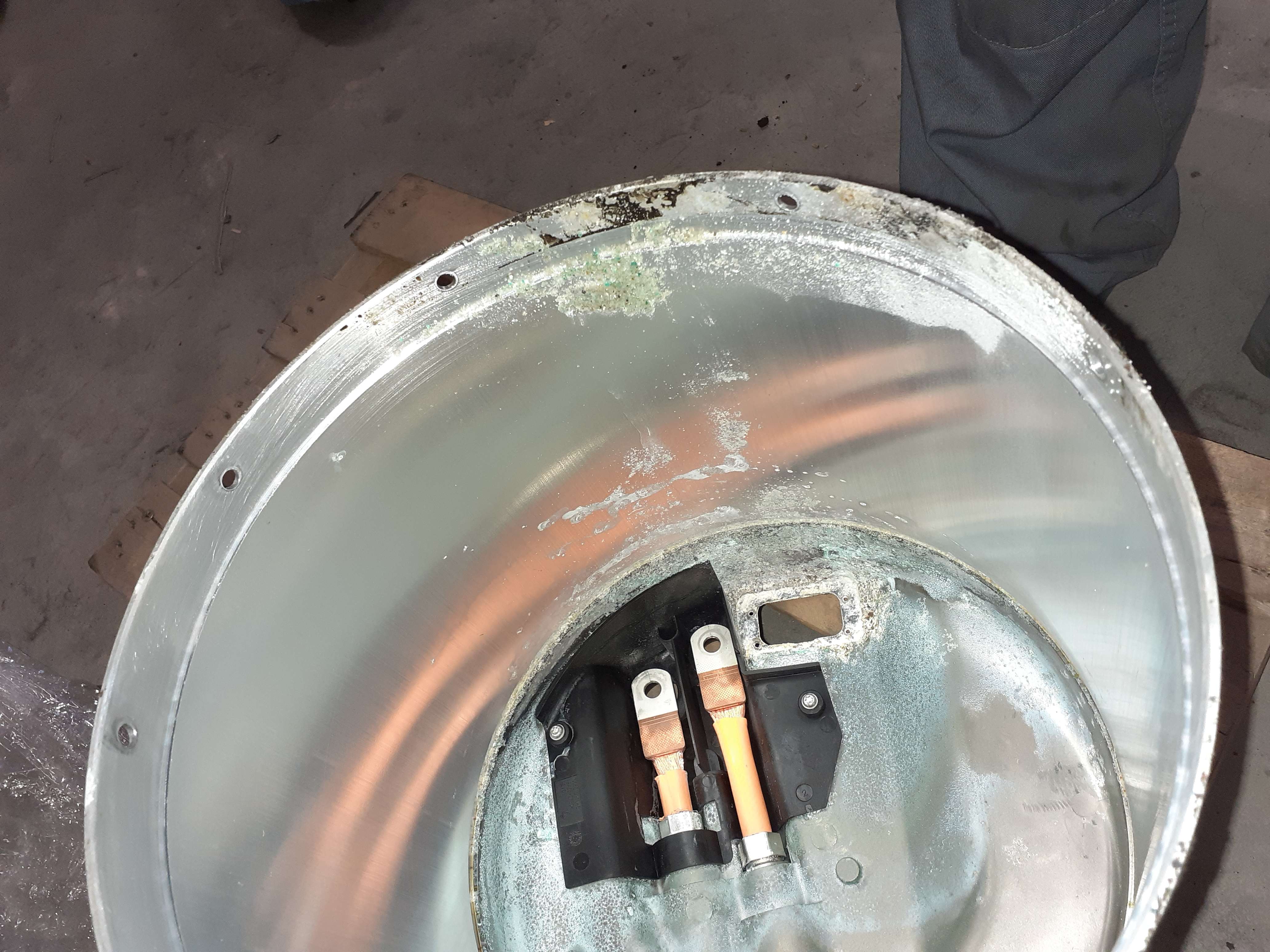

Post by howardc64 »
Very cool! Glad its up and running with harness change.
Spoke with @jsimonkeller over the phone to confirm the details. He believes the connectors coming out of the control board to the 2 phase gate drivers on top and right of the CANBUS connector (looking at the gearbox) lost signal. The harness+connector to the phase gate driver board on the left of the CANBUS controller was actually okay. Red light was presumably a signal to say "getting power but can't go further"
Anyway, when the coolant makes it way to the inverter and pools on the bottom. Its 1/16" from the CANBUS connector and the wiring harness/connectors to the control board (according to QC Charge tech on teslamotorclub forum). Then the coolant wicks up the wires reaching the connectors to start the corrosion.
I have seen 3 levels of damage from this and summarizing them all here
Very slight coolant in Inverter
This was my case. Inverter was fully functional. The earliest sign of wicking had started along with coolant residue coating on bottom of CANBUS connector. Coolant doesn't really leave a mark along its travels so had to do some forensics to confirm leak was not from the inverter passages.
https://teslamotorsclub.com/tmc/posts/7052908/
https://teslamotorsclub.com/tmc/posts/7053072/
Here is an annotated pic showing this the very early stages of harness coolant wicking. I cleaned it up with ISO prior to reinstall.
Heavier coolant intrusion in Inverter
@jsimonkeller post prior to this one shows coolant caked on all the connectors to the control board. Luckily in his case, all boards survived and just needed replacement harness
Causing IGBT damage?
I wonder if pics here shows IGBT damage. The white lines along the interior of the inverter casing looks like lightning marks to me. Its location is along the row of IGBT heatsinks (mounted just above IGBTs) along the IGBT board. Wonder if it jumped and arced leaving the white residue
https://teslamotorsclub.com/tmc/posts/7025439/
BTW, here is a simple check to make sure no shorts on the IGBT phase board
CANBUS connector
The CANBUS connector and electronics just behind it seems can be easily damaged. The electronics immediate behind it is actually sealed pretty well filled with gel inside. However, this connector along with the harness is on the bottom of the connector. If the inverter is sitting right side up mounted to the gearbox, probably can easily damage it.
@dzolotnyuk ( viewtopic.php?p=46191#p46191 damaged his and had to source an replacement ) @Johan used foam under the inverter sealing the 2 halves of the gearbox when the inverter housing must remain removed to pull the temp sensor cable through ( btw, mesh sleeve on outside of sticky temp sensor insulation is the trick to make this go way easier https://teslamotorsclub.com/tmc/posts/7182122/ ) And I assembled by LDU halves upside down so there is support for the inverter.
in LDU rebuilder QC Charge's postings. This CANBUS connector is always removed on all inverter pictures presumably for safer handling? Example pic in the link under "Causig IGBT damage?" above.
Fried IGBTs
Finally, I've seen this LDU->1970s American Muscle car build that fired an IGBT. Author claims can happen when power drops out while driving. I'm assuming this uses non Tesla control board that most custom EV builders are using.
I'll forward this info to potential rebuild kit manufacturers, a new harness, CANBUS interface, and a PTFE seal stretch tool before mounting on manifold for blind installation is probably desirable in a rebuild kit.

SuperV8 wrote: Thu Feb 09, 2023 9:10 am On an side note - but related to LDU: a work friend recently had his LDU replaced (Model S P85D - I think 2016my?) - luckily under warranty (the garage who sold him the car covered it!) - Tesla said it was due to water ingress - apparently from the large power cable's insulation/seal braking down and allowing water in the inverter. Something else to ensure is well sealed and the cable's are in good condition.
HV cable seal leak
Here is an example of how bad these can get
https://teslamotorsclub.com/tmc/posts/7339499/
Mine looked fine but the design causes natural moisture pooling and attack the cable seal with gravity. To mitigate this, probably need a custom designed boot to seal around the cable to avoid any moisture pooling on top of cable seal.
https://teslamotorsclub.com/tmc/posts/7340120/
