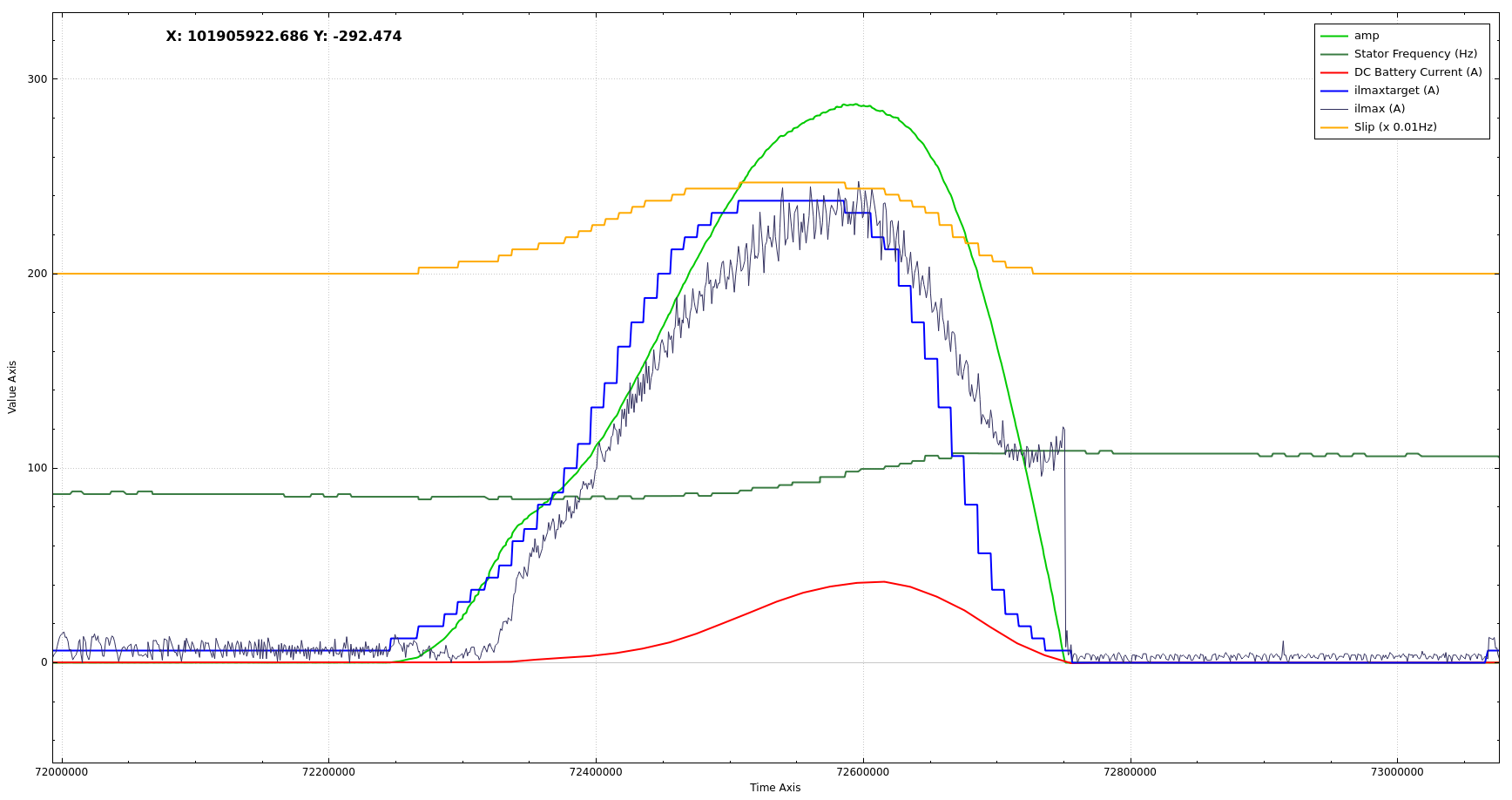

Well... I seem to have found a way to work around the problem! I compared the data for the V/Hz and the current control modes, and the obvious difference was that the V/Hz code uses fslipmin at all times, where my code adjusts slip according to torque request and previously did not even have a concept of fslipmin.
So with fslipmax=3 and offthrotregen=-20% I was running 0.6Hz of negative slip. In theory, this is the right amount, but in reality this seems to be the cause of the instability.
I tested with fslipmin=2, fslipmax=3 and the problem was significantly reduced, at fslipmin=3 the problem went away almost completely.
Once I started using fslipmin, I was able to notice a second (and more expected) issue that causes the same effect, very sudden changes between positive and negative torque request. With the higher slip, it became much more noticeable that high throttle slew rates between driving and regen still upset it a little. It's worth noting that because of fslipmin, the *slip* transition is still instant, no matter how slow the throttle moves, but the current request tapers down to zero before coming back up. Looking at the charts, the defining factor that seems to solve the problem is that current much reach zero before starting back the other way.
I will implement a few more code changes now so that I can experiment more:
* Configurable slip slew rate limit
* Configurable current slew rate limit
* Individually configurable fslipmin and fslipmax for forward and regen modes.
One big success here is that I'm seemingly able to control regen all the way down to a stop
NB. this is only tested in axle stands for now.
Attached charts showing acceleration and regen cycles. Note that in one example I came off the throttle excessively fast, and the current did not reach zero before the regen began, causing a small overshoot on the regen current.

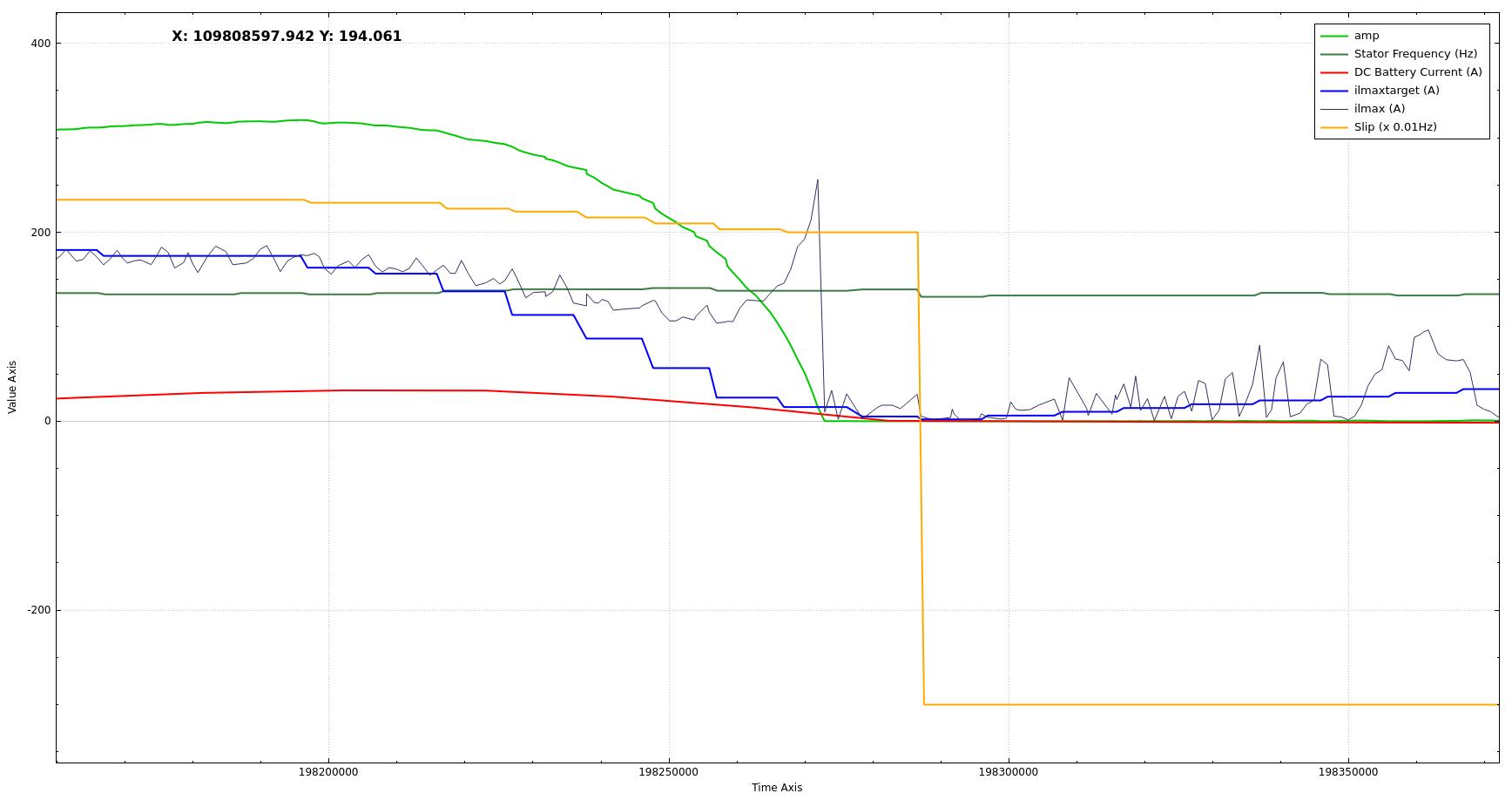

Here are closeup examples of good and bad transitions (same graph scale to make clear the slew difference), note in the second example, stator current never reaches zero and hence causes the overshoot as it rises again.
Edit: I wonder if increasing the strength of my PID would fix the second example, as a faster drop in voltage would probably cause a faster drop in current. I haven't done much tuning on it beyond the major fslipmin experiment.
Edit 2: Looking again, maybe the best solution is to set the negative slip (which seems to pull the current down hard) and wait for it to reach zero before allowing the current request to rise again. :idea:

I'm looking more closely at these voltage-current charts, and something is amiss! This is not a happy shape for a current sine wave!
Not sure if I've messed something up with my changes.
Edit:
Looks like a small offset in the current sensors is causing the total calculated current and hence the output voltage to oscillate so this is a "me" problem :)
It goes away once the current is significant.
Pete9008
Posts: 1801
Has thanked: 102 times
Been thanked: 350 times
Re: Current control of induction motors
Post by Pete9008 »
Think that is just the space vector modulation (gets an extra 15% amplitude by shifting the zero point around). Or do you mean the bit around the zero crossing? If so then that possibly be a little oscillation in the slip calculation.
Edit - ignore me, it shouldn't be there in the current waveform too! No idea what that is
Edit2 - Wondering if it's due to the way the space vector bit is done. It doesn't add a true third harmonic, instead it shifts the waveform. Wondering if the small errors introduced get amplified somehow by the motor impedance?

Pete9008 wrote: Wed Jan 25, 2023 8:23 pm Think that is just the space vector modulation (gets an extra 15% amplitude by shifting the zero point around). Or do you mean the bit around the zero crossing? If so then that possibly be a little oscillation in the slip calculation.
I'm pretty sure the problem here is that a very small offset in one of the current sensors causes my calculation of RMS current to oscillate a little. The current control algorithm tries to correct it, causing an oscillation that matches the frequency. It's really only noticeable at very low frequency and amplitude.
I was originally concerned it might have been a problem with the SVPWM output, but that's so simple there's really nothing to go wrong, so I found the problem elsewhere. It only exists in my new code, so nothing to worry about.
