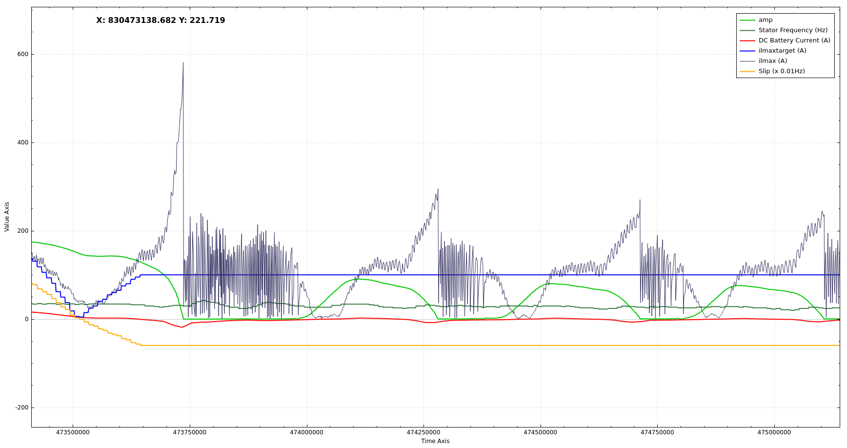

I've gone over everything this evening. These are the conclusions:
1) The crash wasn't actually a crash. It was just an overcurrent fault. I hadn't anticipated that lots of calculations just don't run when the inverter's not in run mode, so a bunch of values appeared stuck, but they were actually being transmitted. No harm done, just unnecessary panic.
2) Johannes is right. I can't explain it, but under steady state, my original control scheme works fine in both acceleration and regen. More voltage gives more current, regardless of direction. Using real power seems to have been a damp squib, despite the fact that it seemed obvious it would work! I suspect the reason this doesn't behave the way I assumed is because current isn't exactly in phase or exactly out of phase, it's at some other angle that makes the control less intuitive, but nevertheless, in the general case, my PID works.
3) So the question now is why there is usually a current spike shortly after changing slip direction. It happens in most cases when slip changes direction, regardless of what the rotor is doing. It feels like a large flux is building up in the rotor and then i'm unable to control it, pretty much exactly as you say. If the process gets past the initial hump, the regen is well controlled.

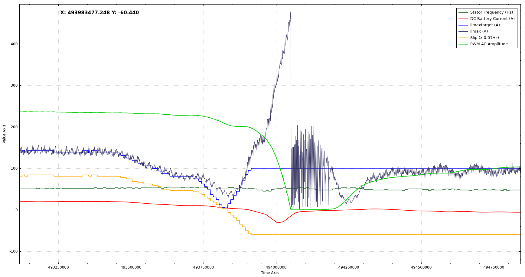

Here's a graph of the whole process working perfectly, achieved by using a gradual move from acceleration to regen, and with the wheels off the ground.

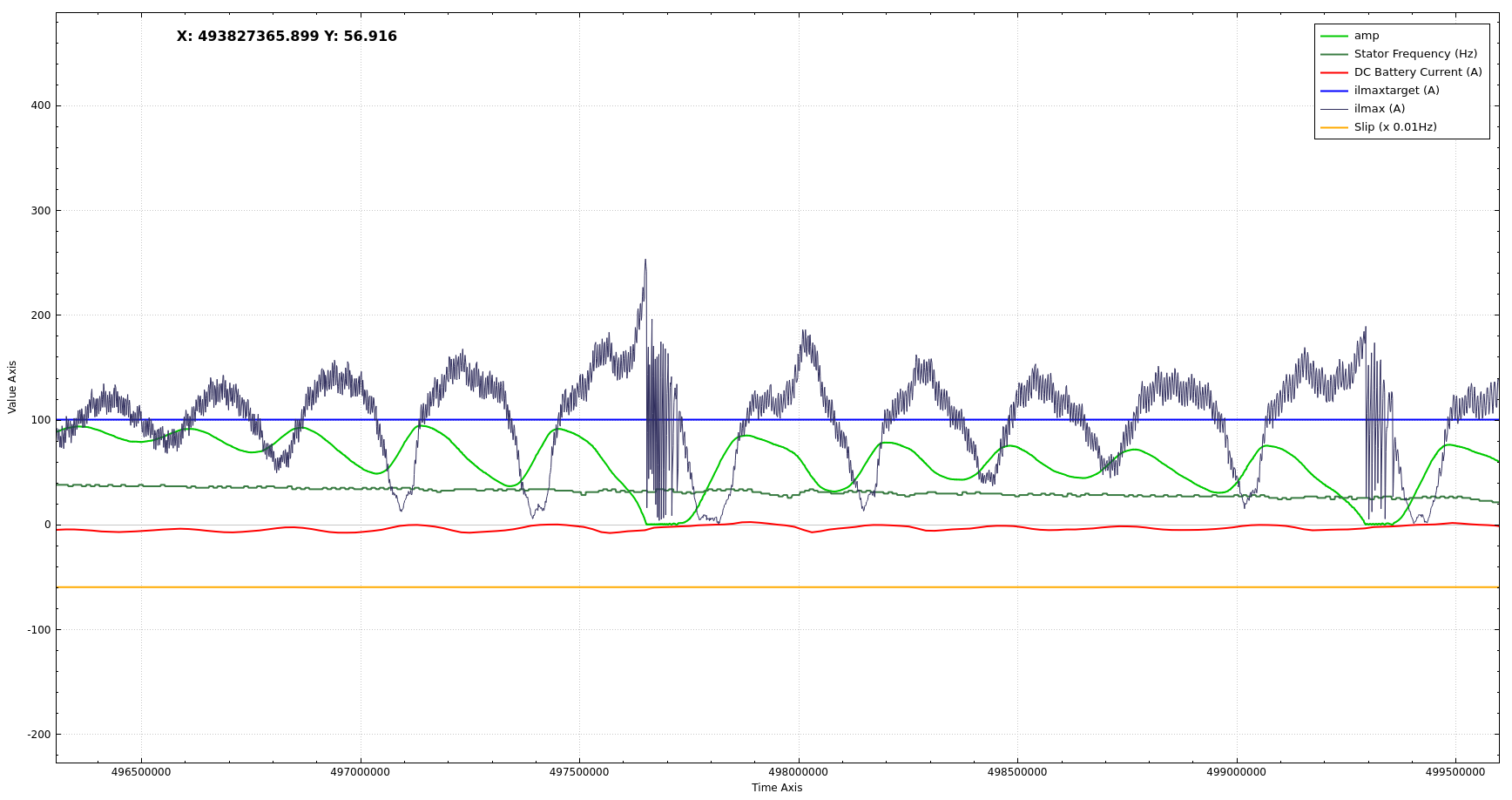

But here's what *usually* happens:
The problem usually happens after a throttle direction switch, but can also oscillate during continuous regen. There are periods where the regen is well controlled, though it appears to begin to oscillate.
This graph actually suggests that voltage has very little impact on current sometimes. Instead the current seems to be beyond my control, but the voltage is controlling the power delivered back to the battery. Very confusing at the moment.

catphish wrote: Sat Jan 21, 2023 7:02 pm there is usually a current spike shortly after changing slip direction
This sentence just made me realise that when slip changes direction of the induced currents in the rotor will change polarity and that is why your original code works, The PI control direction doesn't need to change because the flux in the rotor has!
catphish wrote: Sat Jan 21, 2023 7:02 pm Here's a graph of the whole process working perfectly, achieved by using a gradual move from acceleration to regen, and with the wheels off the ground.
Had assumed it was all on your test rig, hadn't realised you were testing this on the car, :o
catphish wrote: Sat Jan 21, 2023 7:02 pm The problem usually happens after a throttle direction switch, but can also oscillate during continuous regen. There are periods where the regen is well controlled, though it appears to begin to oscillate.
I thin Johannes is right about something else too, your control loop tuning may be the issue. Looking at the plots, in light of knowing that it should work, makes me think that what's happening is the torque demand drops so the voltage drops but it drops too fast. When you do things gradually you can see it start to go but the loop catches it and brings it back up again. When it fails it doesn't catch it and it then looks like it may go into saturation (where amp is locked at zero), it then recovers but is just barely stable and eventually loses it again. Johannes suggestion about bringing your loop parameters out to make them easily adjustable would make a lot of sense.

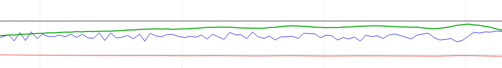

Here's a better closeup of the process. A strange aspect of this is that I see sizable currents when the voltage is at (or very near) zero.

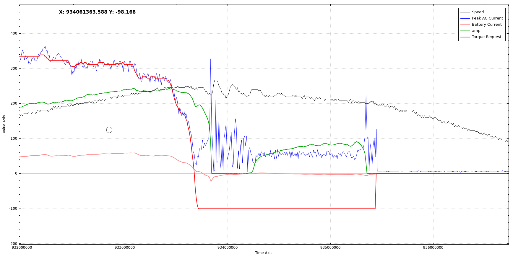

I started looking at how my PID operates in other places, and found this. This is an example of normal forward acceleration.
We can see here that when the rotor is already spinning, and throttle is applied, current immediately jumps up to follow the throttle, but voltage (and power, as demonstrated by the battery current) lags behind. It's as if my slip control is what's providing the majorty of the current control here, and the voltage proportional gain is much too low to keep up!

This is where my knowledge runs out. Does a 3Hz slip mean that there is a 3Hz current circulating in the rotor? If so is there a limit to how quickly it is realistic to expect that 3Hz current to change in response to a change in slip and voltage or is it instantaneous?
I'm interested in knowing the answer, just not interested enough to go and do a load of research ;)
Been thanked: 1914 times
Re: Current control of induction motors
Pete9008 wrote: Sat Jan 21, 2023 8:49 pm This is where my knowledge runs out. Does a 3Hz slip mean that there is a 3Hz current circulating in the rotor? If so is there a limit to how quickly it is realistic to expect that 3Hz current to change in response to a change in slip and voltage or is it instantaneous?
Indeed the rotor current is circulating at 3 Hz and therefor it takes some time for the field to build up. That's why some FOC implementations keep id (=current circulating in the rotor) at a constant value to speed up transient response. That is at the expense of loosing efficiency to rotor heating. I'd think in EV applications id is always dynamic much like the feed-forward "V/Hz" variant.

* Using very low values of slip when low torque is required.
It's worth noting that it's clear reducing voltage does not always reduce the current immediately.
The one substantial difference between the output of this implementation and the V/Hz version is that in the V/Hz operation, voltage is always reduced to zero *before* slip is reversed, while mine allows voltage to hang. This is something that could potentially be worked around but for now I'm going to read on how flux is created. I believe I need to find a way to make sure it always gets used up as fast as it's added. This may simply be a matter of using more slip.
I've added a setting to output CAN data at 1ms intervals which seems to work well, so attached is a dump of charts.
The latest code can always be found at: https://github.com/catphish/stm32-sine/tree/amp
Not much has changed there apart from the addition of a P value to the custom PI controller. Perhaps I will find a way to use the P value at some point.
PS. I really appreciate the assistance so far, but don't feel you have to help. I'll keep posting my findings here anyway :)

Here's probably the best example / simplification of whatever it is I'm doing wrong.

As far as I can tell, in regen states there seems to be a 100ms delay between changing voltage and seeing the expected change in current. This doesn't occur in normal motor states. I assume this is related to the motor's ability to provide its own rotor magnetizing current. With that delay, effective control is extremely difficult, so my goal probably needs to be to eliminate it, most likely by forcing the motor into a less efficient state during regen. I'm not certain though.
PS. I'm not certain that I should be testing regen with a below-freezing battery :!:
One thing to note is this particularly interesting segment, where the motor seems to power itself for 250ms while the inverter oscillates between open circuit (which is activated at 0v) and 1 step above 0V.

Not too sure I see what you mean there?
If you are serious about trying FOC control then I'd be tempted to try and add the rotor current measurement bits of the FOC implementation to this, just to 'instrument' the rotor. It would be interesting to see if you can actually measure it and if so the results could be enlightening about what is actually happening inside the motor.

At this point I'm starting to think that my current control approach completely falls down when the motor is also putting energy in. The V/Hz algorithm clearly works though. Just setting slip to 2Hz and changing the sine wave amplitude controls it, so I don't know why i'm having so much trouble in comparison.
I am tempted to write a real FOC implementation, though I tried and failed to do this once before. I feel like I'm invested in this now though!
