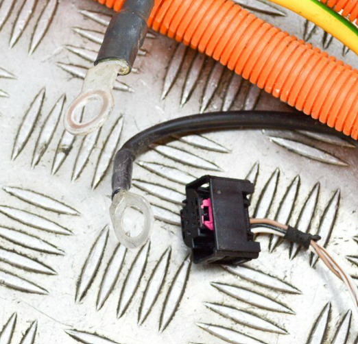

I have a EU SPEC BMW LIM from a Mini Cooper SE 2021 with its CCS cable loom and from what I see on the original 6pin 2B plug going to the LIM is that the jumper is between 2B-4 and 2B-5:
2B Pinout:
2B-1 CP
2B-2 PP
2B-3 Ground
2B-4 Jumper to 2B-5
2B-5 Jumper to 2B-4
2B-6 N/C
if someone can confirm this typo on the WiKi I will be glad to correct it.
2B Pinout:
2B-1 CP
2B-2 PP
2B-3 Ground
2B-4 Jumper to 2B-5
2B-5 Jumper to 2B-4
2B-6 N/C
See the picture below for reference:

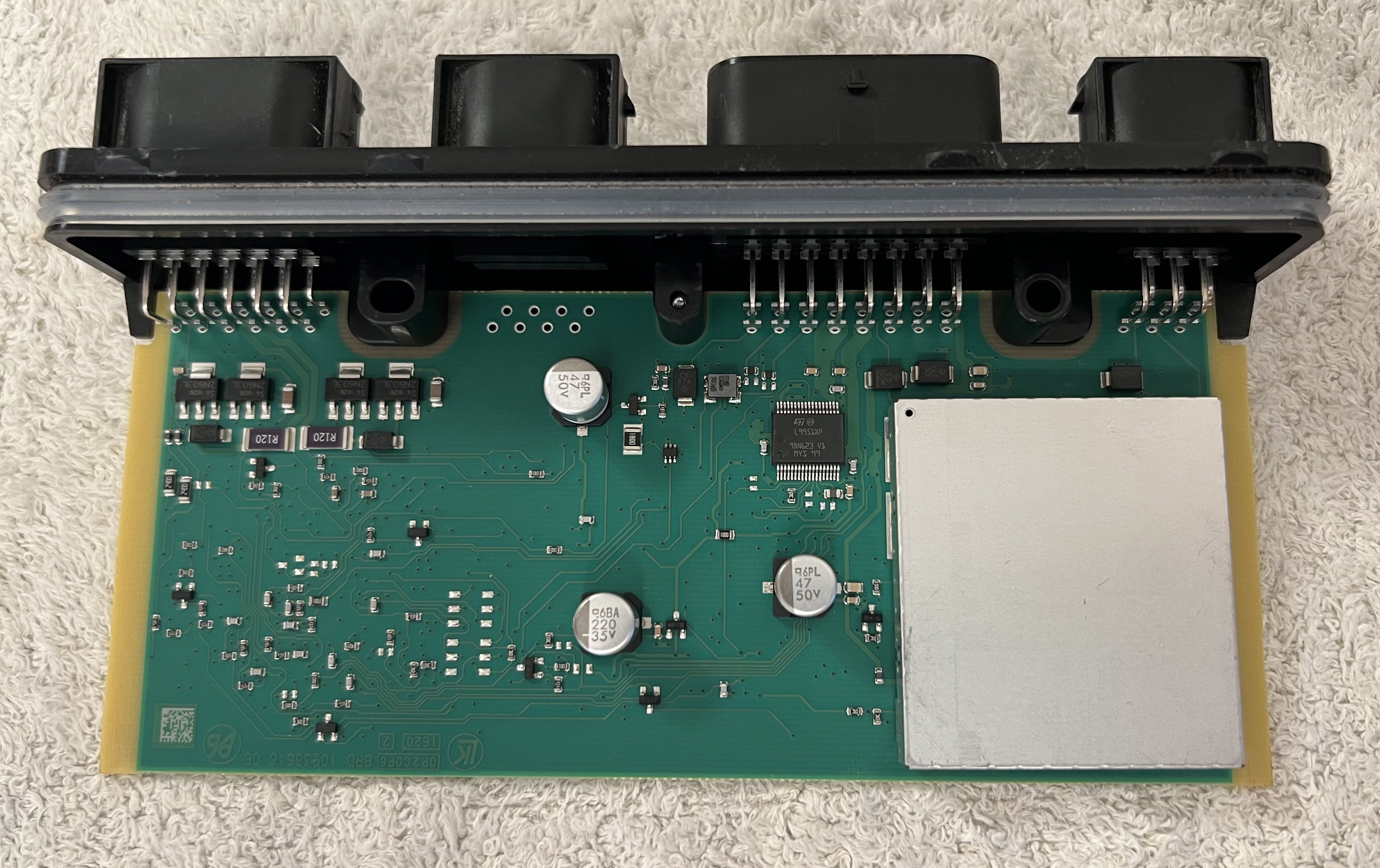

2B-4 & 2B-5 measure at Ground potential when the LIM is unpowered, but looking at the PCB of my ...052 (2016) LIM, those pins do not appear to route to the same place, so I'd be wary of assuming they're internally connected to Ground just because they appear to have zero resistance with respect to Ground (at least, when unpowered).
- muehlpower
- Posts: 807
- Been thanked: 186 times
I checked the schematics again and looked at the board of my LIM. On the BMW I3, 2B/5 is connected to a ground point via the shield. 2B/4 has no visible connection, probably leads to the ground layer. This means that in both cases 2B/3 and 2B/5 are connected to GND

Seems an odd, round-about way to ground a pin, when the ground plane is straight down
I can't ID this SMD, but I don't think we can assume that 2B-5 is explicitly grounded itself, and Sidemips' OEM harness does has an explicit jumper to the grounded 2B-4 for some reason, I assume.
It looks to me to be some external way to configure an option.

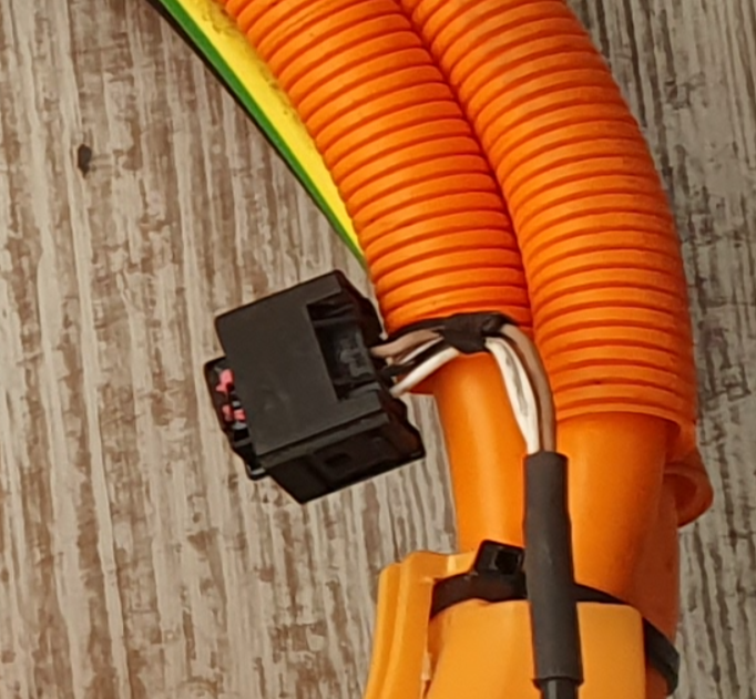

...No such jumper to be seen on OEM harnesses for the i3 (even for MY2021) ... only on the MINI !
I was wrong I found better pictures on the Internet, there IS a jumper on the I3 OEM harness... between 2B-3 and 2B-4
and the charge socket ground pin is on 2B-5... my apologies !

i think it makes no difference. On the BMW, pin 2B/5 is connected to GND via the shield, on the Mini via 2B/4. 2B/3 is connected to GND via 2B/4 on the BMW and externally on the Mini.
In the end, GND is on 2B/3 and 2B/5, regardless of whether 2B/5 is connected to GND in the LIM.

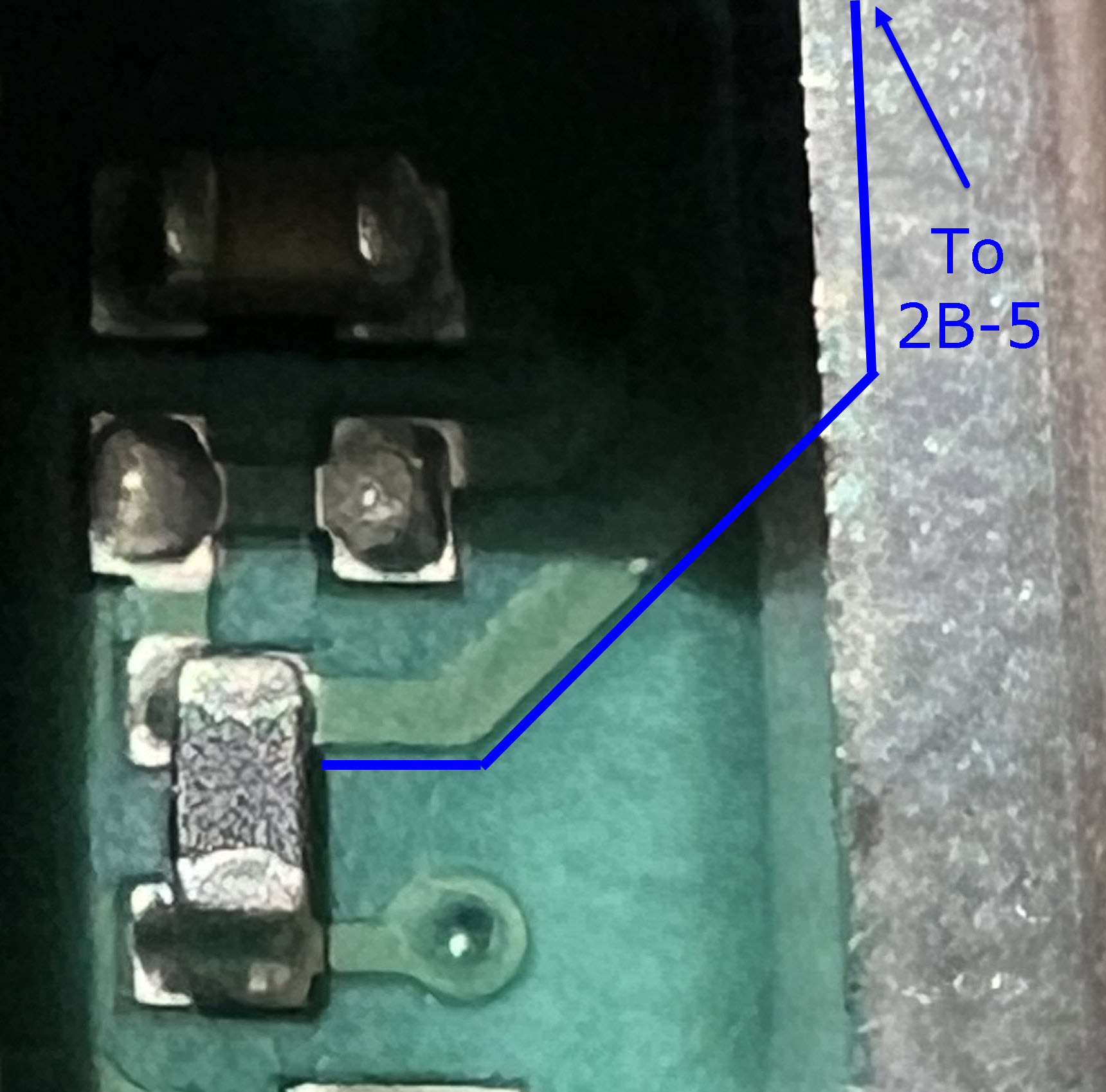

That may not be the case. Here's a close-up of 2B-5's trace termination:muehlpower wrote: ↑Sat Jan 21, 2023 12:46 pm On the BMW, pin 2B/5 is connected to GND via the shield . . .
Most DMMs are notoriously inaccurate when measuring very low resistance values (below 1 ohm), so I don't trust my Fluke 23 when it reports zero ohms between shield and 2B-5; it's possible that's eg a 0R1 SMD, and my test equipment wouldn't necessarily report that value.
I'm confused. Unconnected to a harness, 2B-3 is not connected to GND on my ...052 (2016) LIM; in testing, it's a capacitive circuit connection with respect to the shield, and also to 2B-4. Are you saying that on both the BMW and on the Mini, the vehicle harness (externally) connects 2B-3 to 2B-4? I don't have access to BMW wiring documentation, so I'm relying upon the Wiki.muehlpower wrote: ↑Sat Jan 21, 2023 12:46 pm 2B/3 is connected to GND via 2B/4 on the BMW and externally on the Mini.

In the BMW, the shield from the charge port is connected to pin 5, and this in is connected to a ground point in the car. So pin 5 is connected to ground in both cases. Not "inside" the LIM!asavage wrote: ↑Sat Jan 21, 2023 5:02 pm That may not be the case. Here's a close-up of 2B-5's trace termination:
