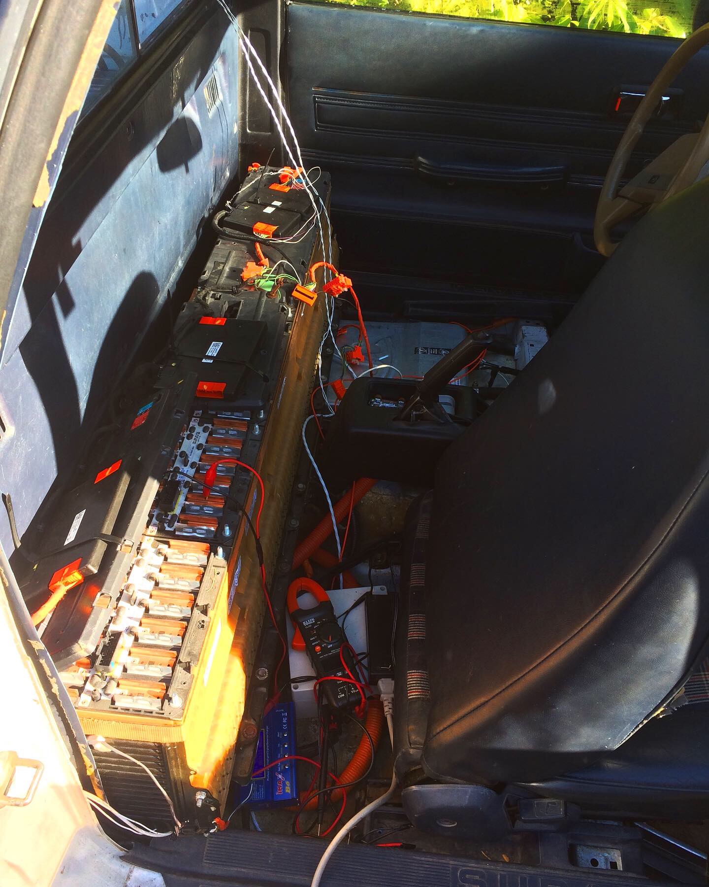

okay spent the last 24H at a budys place bringing up some of the low cells with my sky rc hobbie charger. my delta from highest to lowest cell is now about 140mv, down from about 220mv when at 80% or so.
the hobbie charger only outputs 5amps, so its sloooooow.
im currently charging up to as full as i can (highest cell to 4.2) and this is my road trip for the next 3-4 days as i chase some surf on the cost of Vancouver island. not marked on the map, is a ghost town where ill have access to a 120v outlet overnight. from this point onwards to port renfrew, then lake cowichan, are tight, winedy paved(ish) logging roads.
not sure with my large cell delta ill be able to pull this off safely, shall see how the trip to the ghost town goes.

What delta is considered "acceptable"?
Interesting trip, keep us updated with how it goes.

<20mv id say would be ideal.
anything more, and the divergence in state of charge grows quickly, like what i'm currently experiencing

What I saw on my Gen1 Volt packs was that once I brought the low cells up to the pack, they stayed pretty close. I thought I had killed them again when I got the pack super low and super cold, but was able to recover them. The Volt batteries in general seem rather resilient.

good to hear, iv been slowly pulling the pack back into balance, and yeah they seem to be holding just fine! quite amazed on how strong these packs are.P.S.Mangelsdorf wrote: ↑Tue Oct 25, 2022 4:04 pm What I saw on my Gen1 Volt packs was that once I brought the low cells up to the pack, they stayed pretty close. I thought I had killed them again when I got the pack super low and super cold, but was able to recover them. The Volt batteries in general seem rather resilient.

as expected torque and power is down, but at lower pack voltages (240v) torque is waaaay down. barley pulling. lots of tuning todo and i think 5.24 will really help.
cell delta is around 180mv currently so have some serious balancing todo.
few tweaks and the brat should make it up to a remote coastline around Alaska. few days to tighten everything up enough for the journey.
