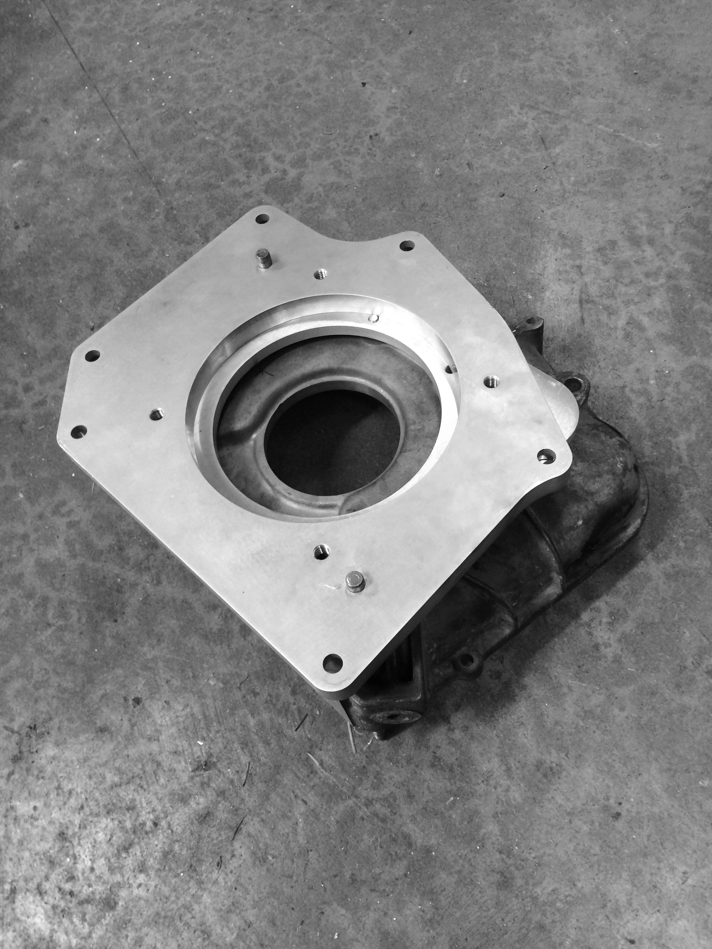

made v2 of coupler and adapter plate, test fit of adapter for a fellow vintage subi getting leaf swapped! v1 coupler clutch splines deformation this was an aftermarket clutch. v2 coupler has a larger surface area of spline contact, and is a oem clutch center. so hopefully that helps Leaf side splines look rock soild
looks like my real world range (mix of backroads driving) is about 80km. still don’t know the actual capacity of my 18kwh gen 2 volt pack.

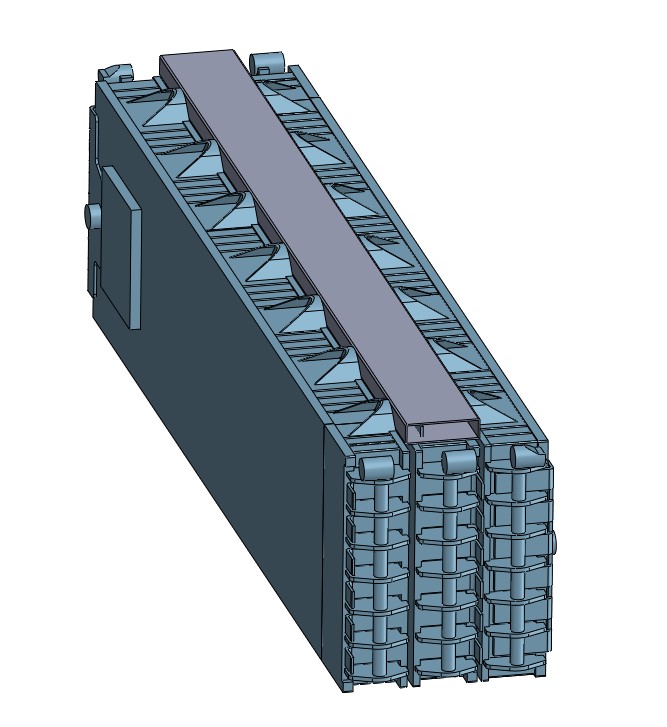

picked up the short M3 modules. got the pan aswell.
missing some coolant hoses sadly.
2 of the isospi connectors where torn off the slaves. but looks like there's pads to tap into on the board. may just repair the traces keep the connection OEM.
1 module weighs aprox 137 lbs. x4 = 548lbs for the 55kwh pack. my gen 2 volt pack is 480ish lbs. so full pack is a 68lbs weight increases. That’s impressive.
packaging and timeline pose a challenge. I have 4 weeks to get the new battery in and working befor i head up north with the brat.
trying to maintain the currently excellent center of gravity, by packaging the models behind the seats. looks very possible to fit all 4. the complexity comes in packaging. so im starting to think that for now, i may just use 3 of the 4. stacked vertically behind the seats. the pack would be 39kwh and 72s. 290v to 216v and weigh 60lb less. wild!
eventually would put the 4th module in. ether mount the 4th under the bed(or 2 under the bed!) or the 4th on top.
space vs weight vs center of gravity trade offs!

batteries fit nice, quite happy with how clean it is now.
a few cell taps have broken, so fixing those with a combination of magnets, conductive epoxy and silicon. "re potting" the back of the battery with silicon to fully seal it off and prevent any more cell tap breaks when moving the modules in place.
also didnt get all the coolant fittings when i got the modules, so iv started mocking out some replacements to make.
they seem to be a variation of a strange German part that's unobtanium. if theres interest maybe ill make a batch.
started with replacing the original part. with the barb fitting. im going to move to a threaded piece instead, this opens up different orientation options. and simpler to make. mock up prints came out great.
i would not recommend using a fdm for printing coolant fittings.
