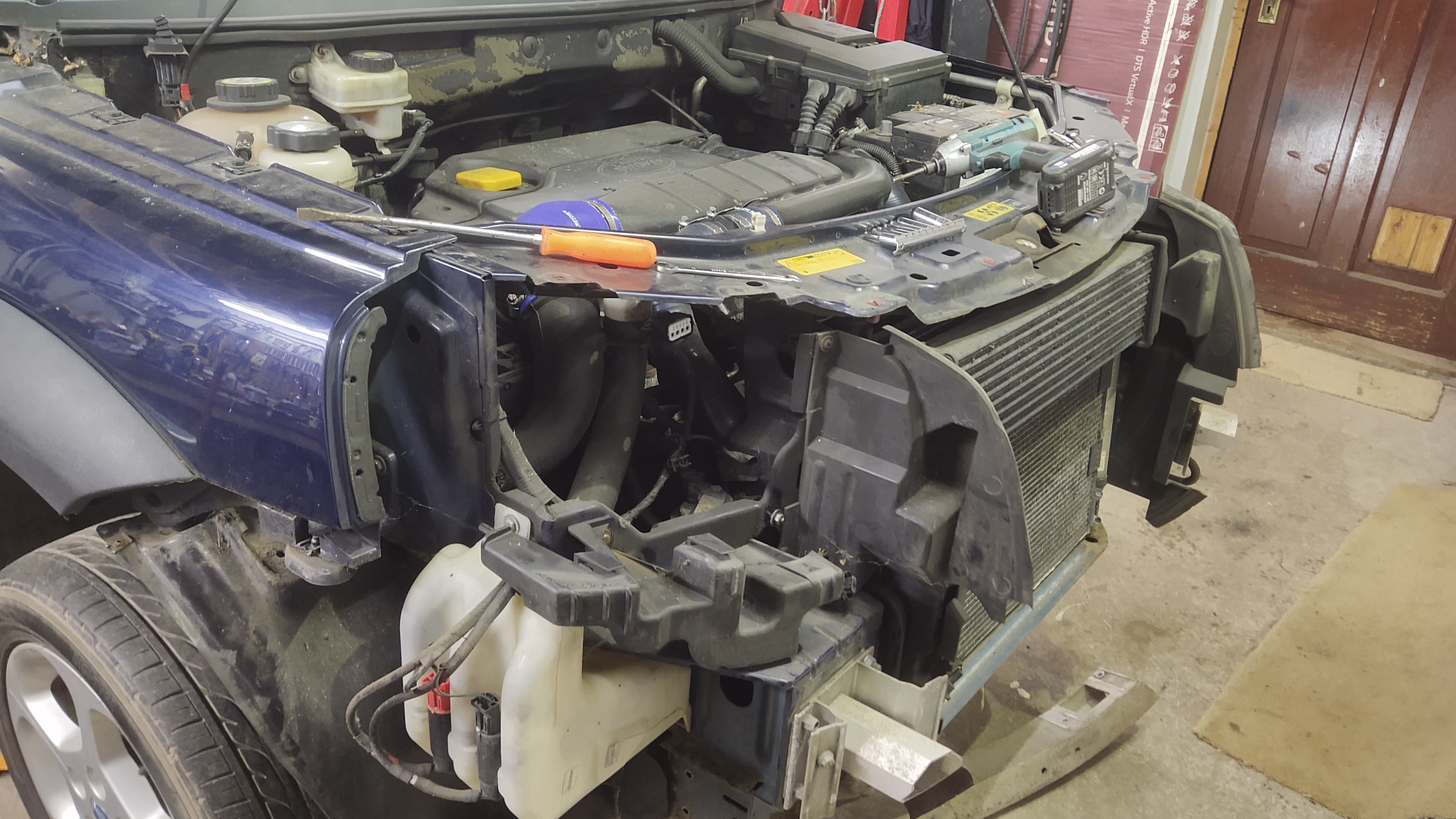

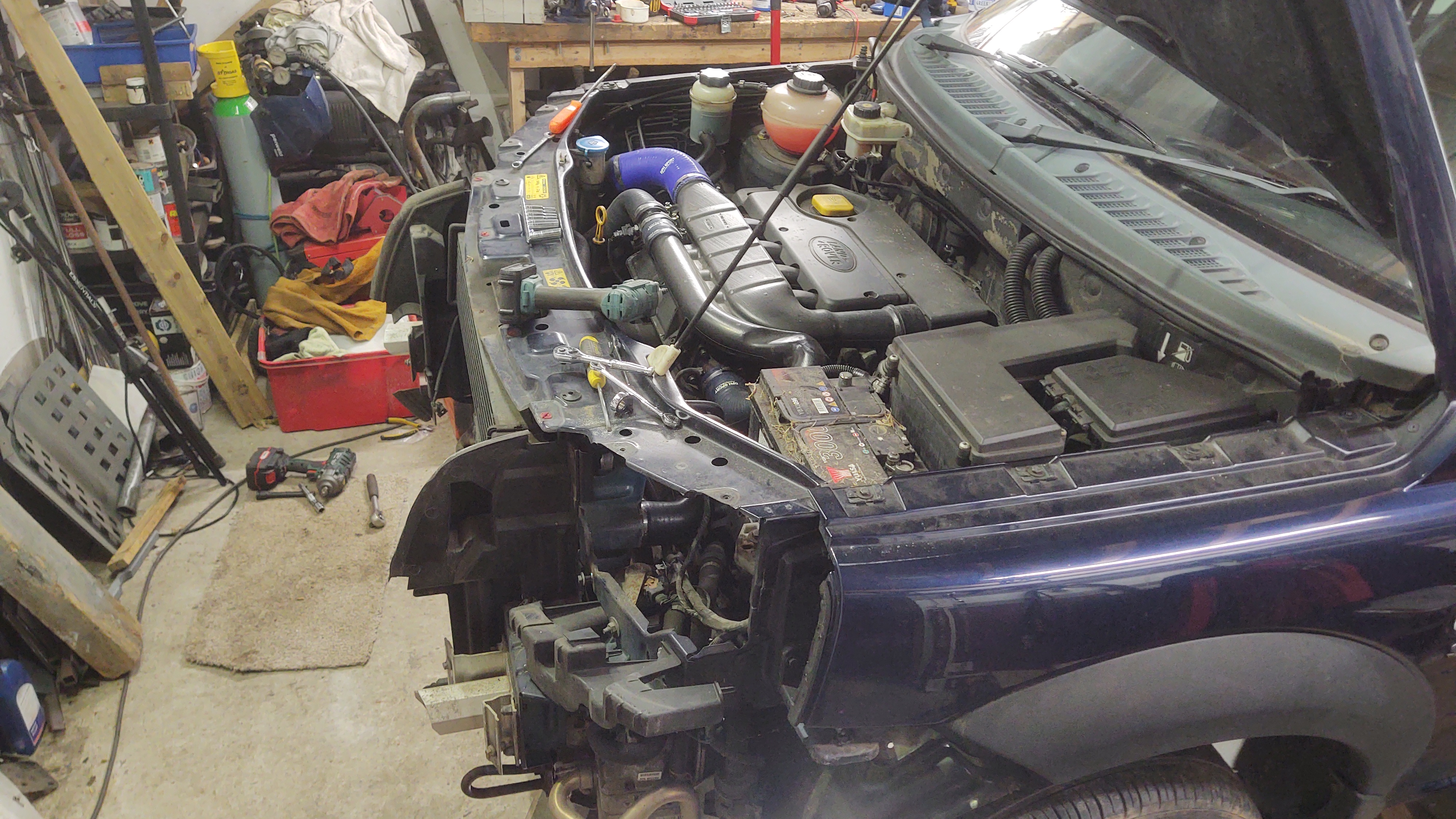

Trying to push as much coolant out as possible with a little compressed air. ;)
I'm removing the rads and disconnecting the PS pump before dropping the engine. Still a few more things to disconnect.

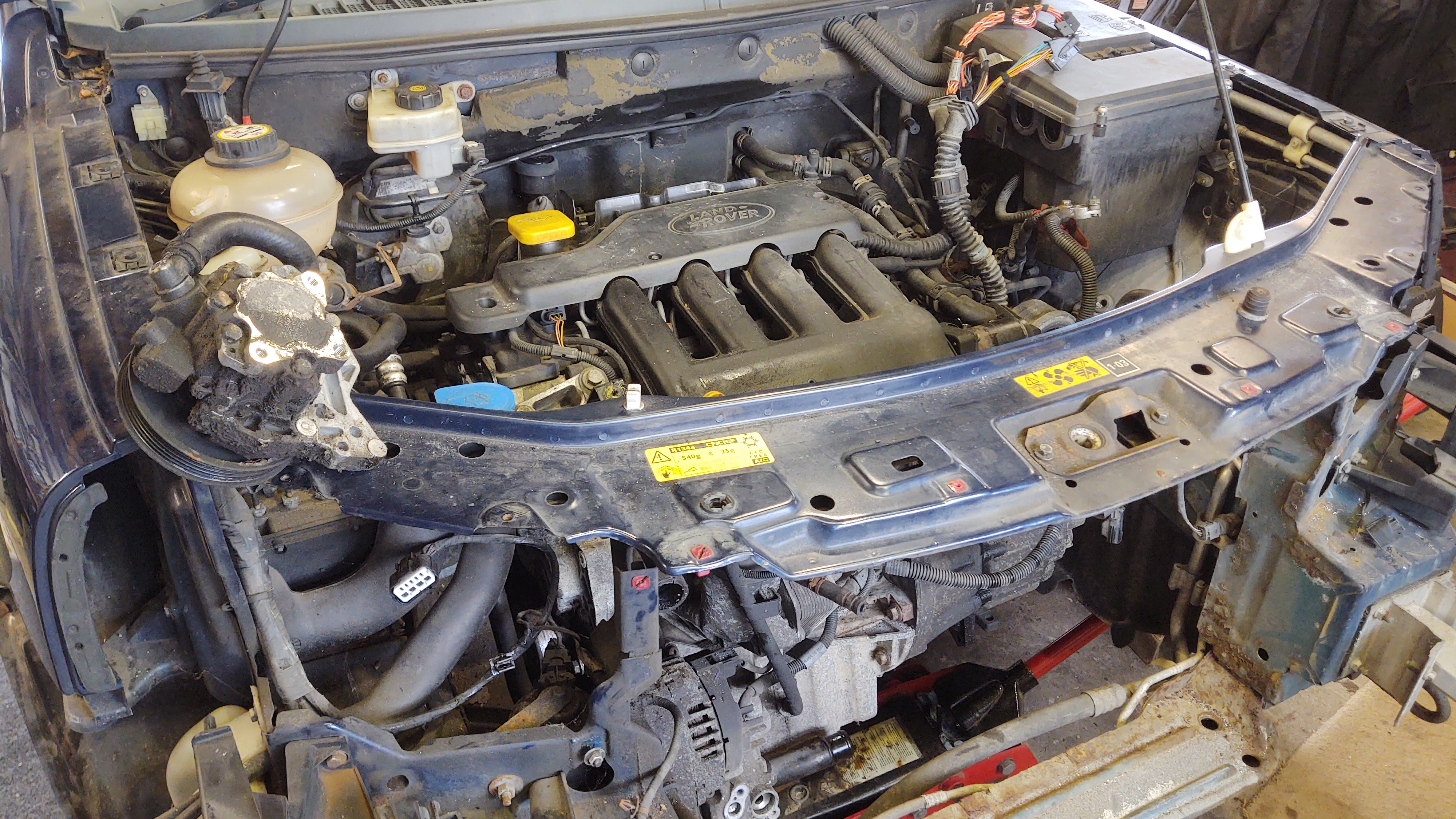

I managed to do a bit more stripping today.
I decided to remove the PS pump first so I don't need to mess about with the hydraulic hoses or drain the fluid. It was a bit awkward and I had to unbolt the OS engine mount to get it out but not too bad. The rads are out too and the wiring harness is disconnected at the ECU box.
So not too much more to do before the noisy smelly parts can be removed. ;)
